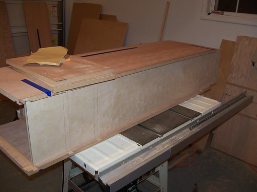

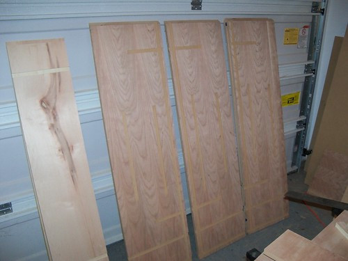

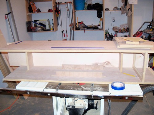

                                          Some build picks
                                          Here are some of my pics.... I went above and beyond for the sake of cabinet rigidity and resonance abatement.

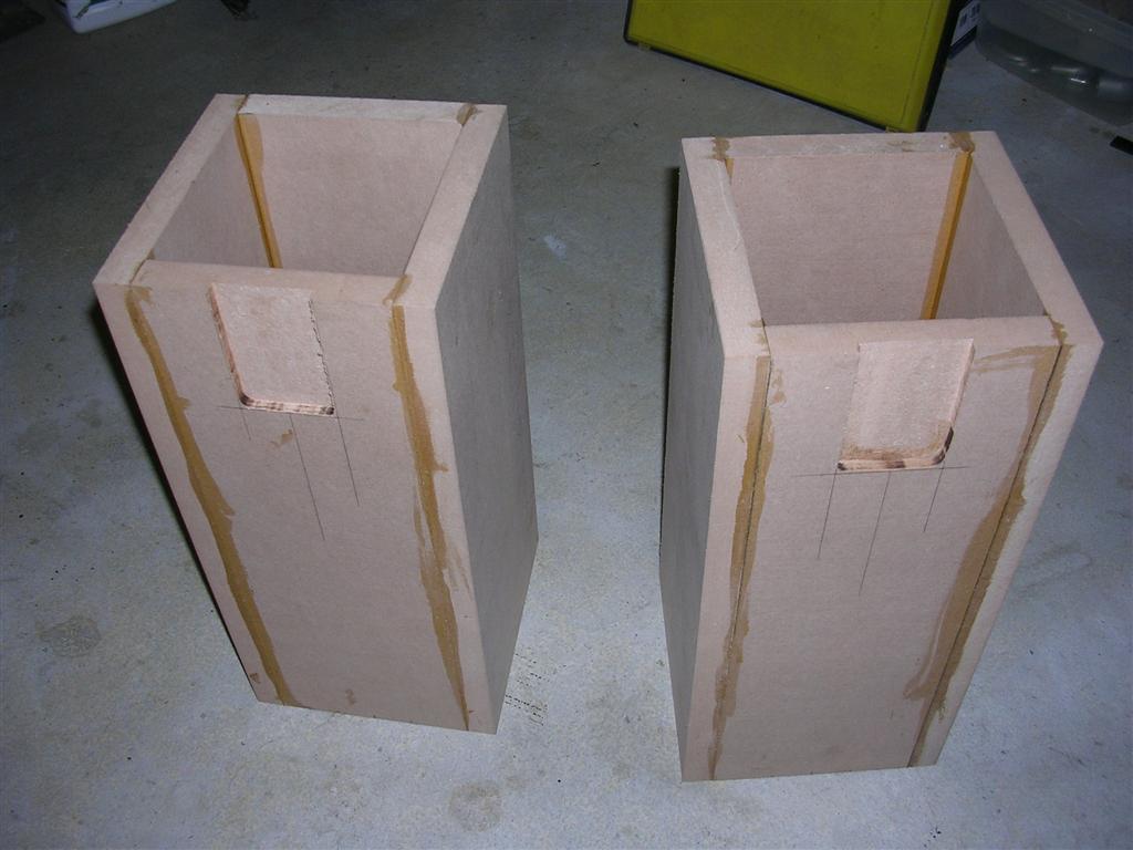

                                              Original, I hopped on the 225's when they were 1/2 off (PE was getting rid of them) and the TB's were on sale for X-Mas so I saved a good ~40% off the drivers.
                                              Did you have to dado out the mid tunnel out sides facing the tweeter for clearance?
                                                  John Trial's build. I just don't know if this is a requirement or if he was simply being meticulous. I probably will for good measure.

                                                    Is this done to make room for the tweeter?
                                                    Doesn't the tweeter fit in the original design then?

                                                      I have just come to measure my fountek and aparently it is indeed very slightly larger than the space between the tunnels is supposed to be.
                                                      Strange.
                                                      Was this also the case in the originals, Jim, or did they change the drivers or something?
                                                        Strange.
                                                        I went ahead free-hand with a 3/4" flush bit and router'd out the dados.
                                                        My thought exactly when I measured.
                                                          Strange.
                                                          Yeah, you have to do this:
                                                          This clearance cut is about 1/4" deep. It doesn't need to be that deep, but it can't hurt (notice the heatsinks on the tweeters...they'll need some airflow to dissipate heat).
