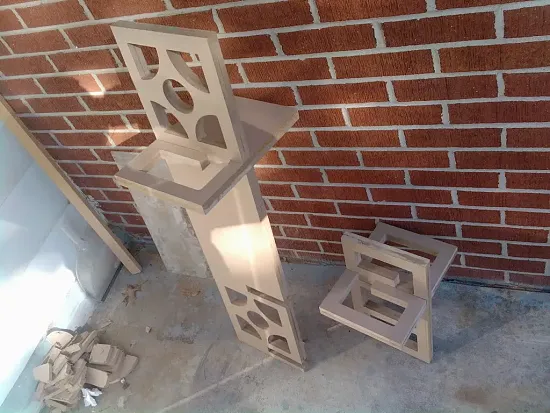

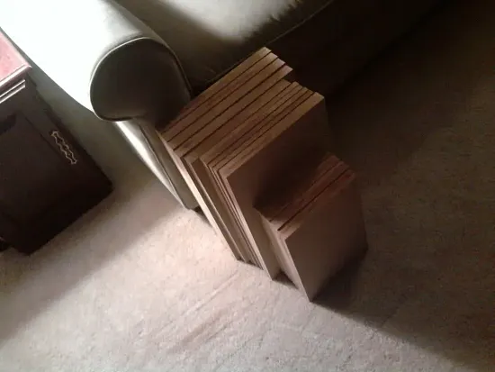

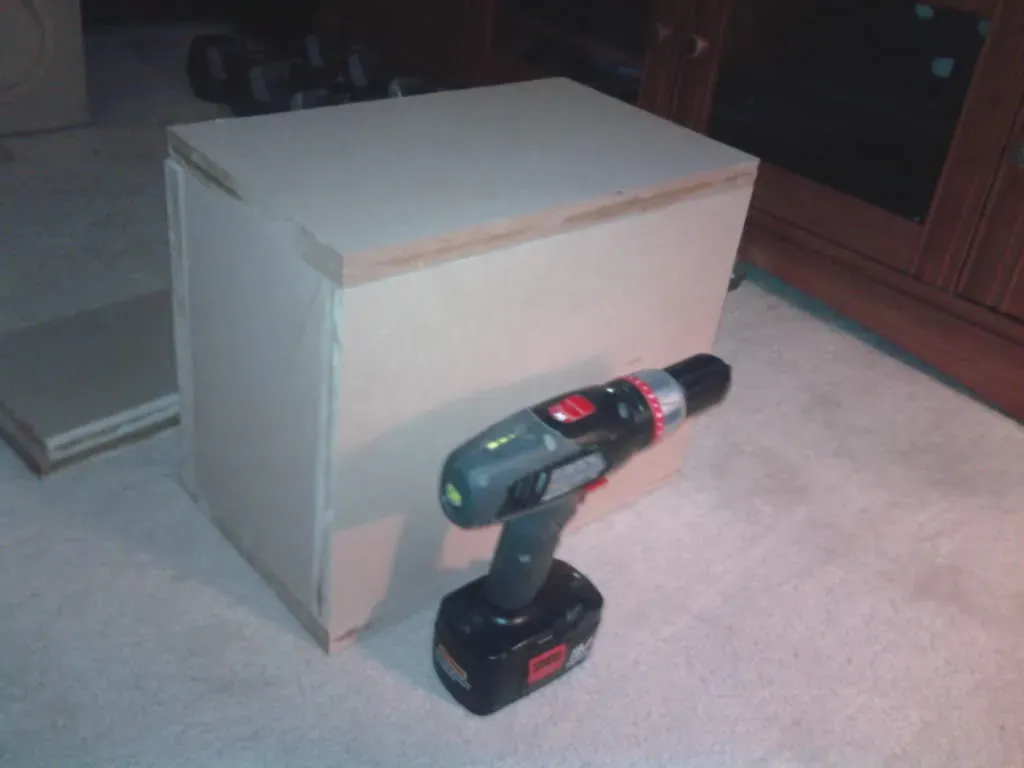

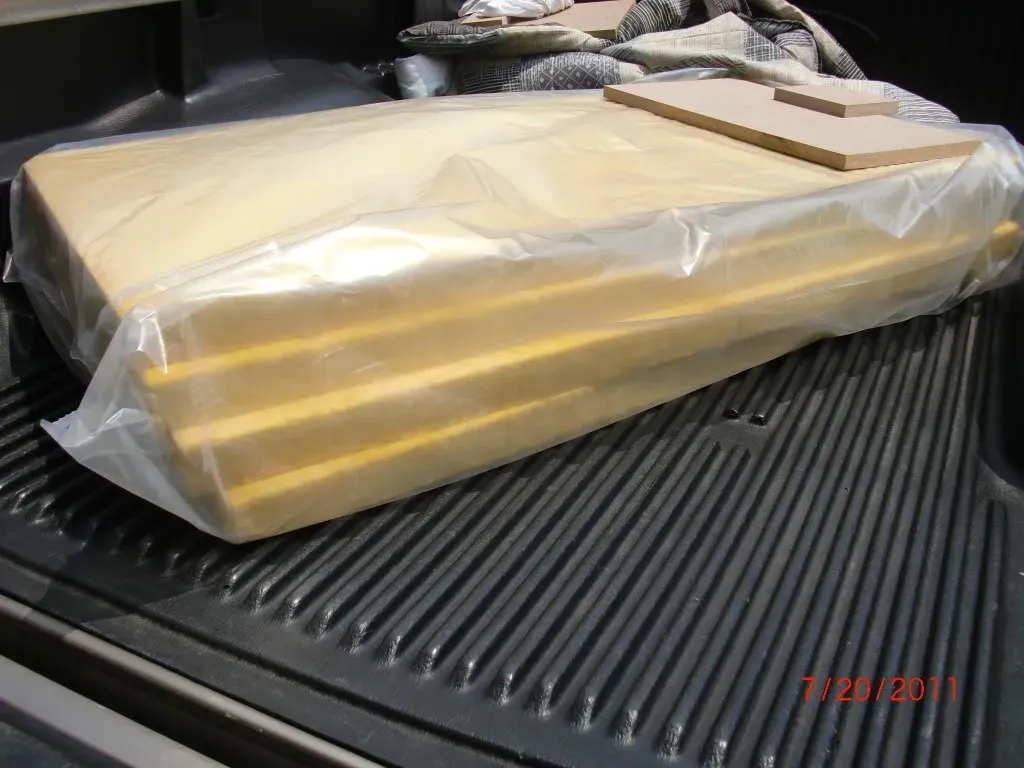

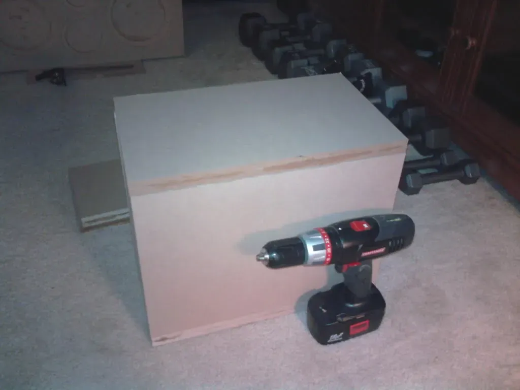

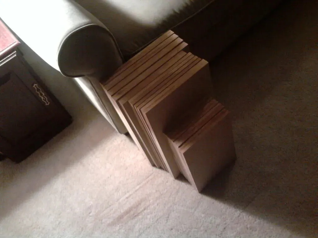

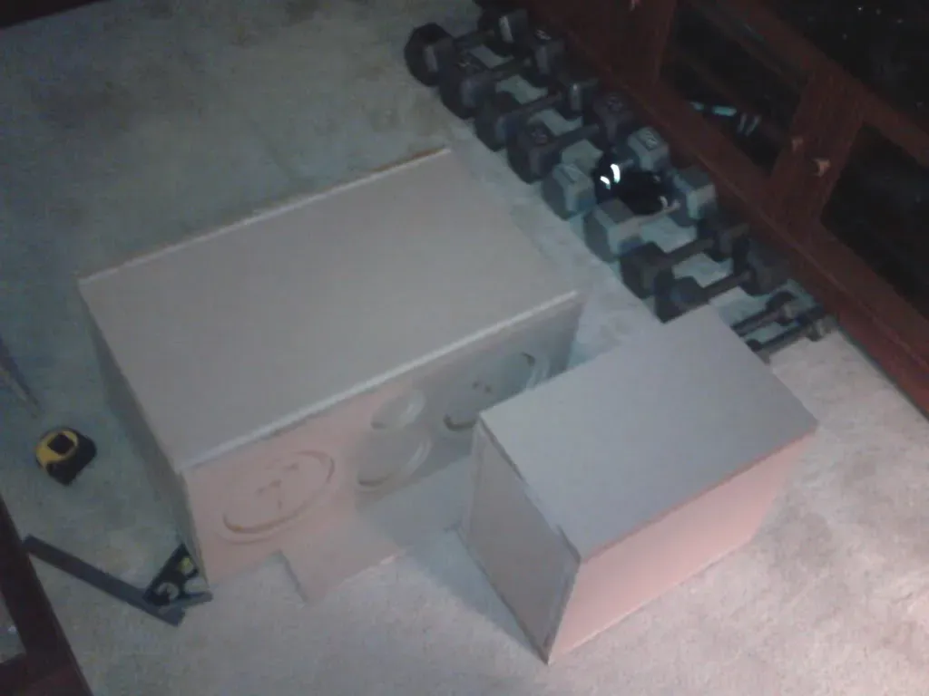

    All panels were cut from 1/2" and laminated together to be approx 1" thick. All panels are laminated, I just need to cut braces and am waiting for Mark to confirm the layout dimensions for the baffle.
    uhmmm....These are huge too.
    First though, panels....
    And then there were monster bookshelves. The baffle is on top for reference...

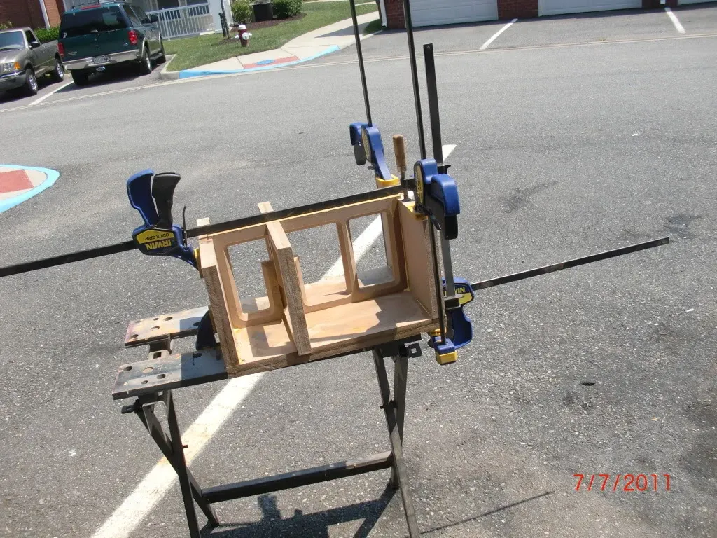

                • joeybutts
                  • 476

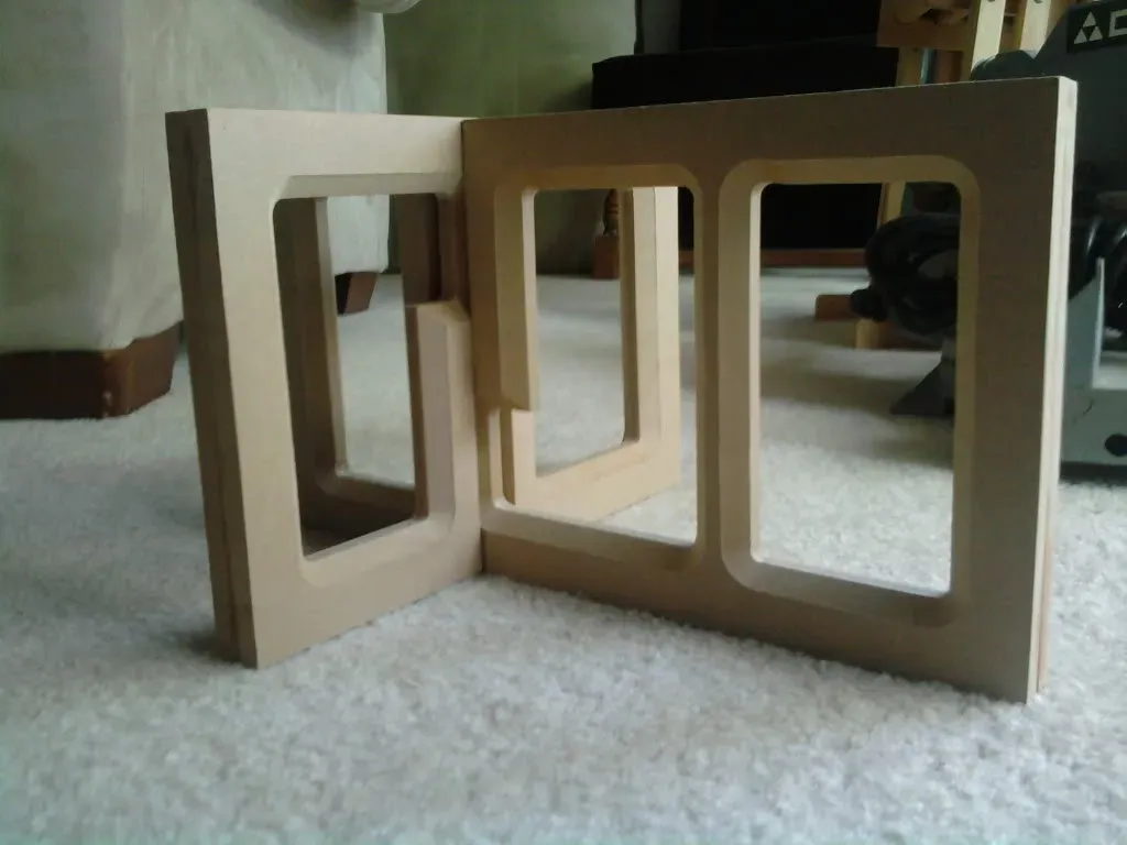

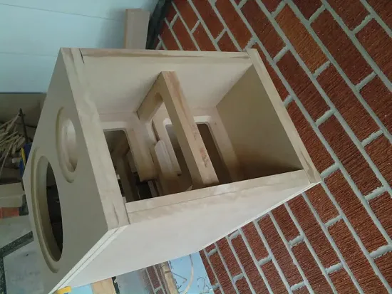

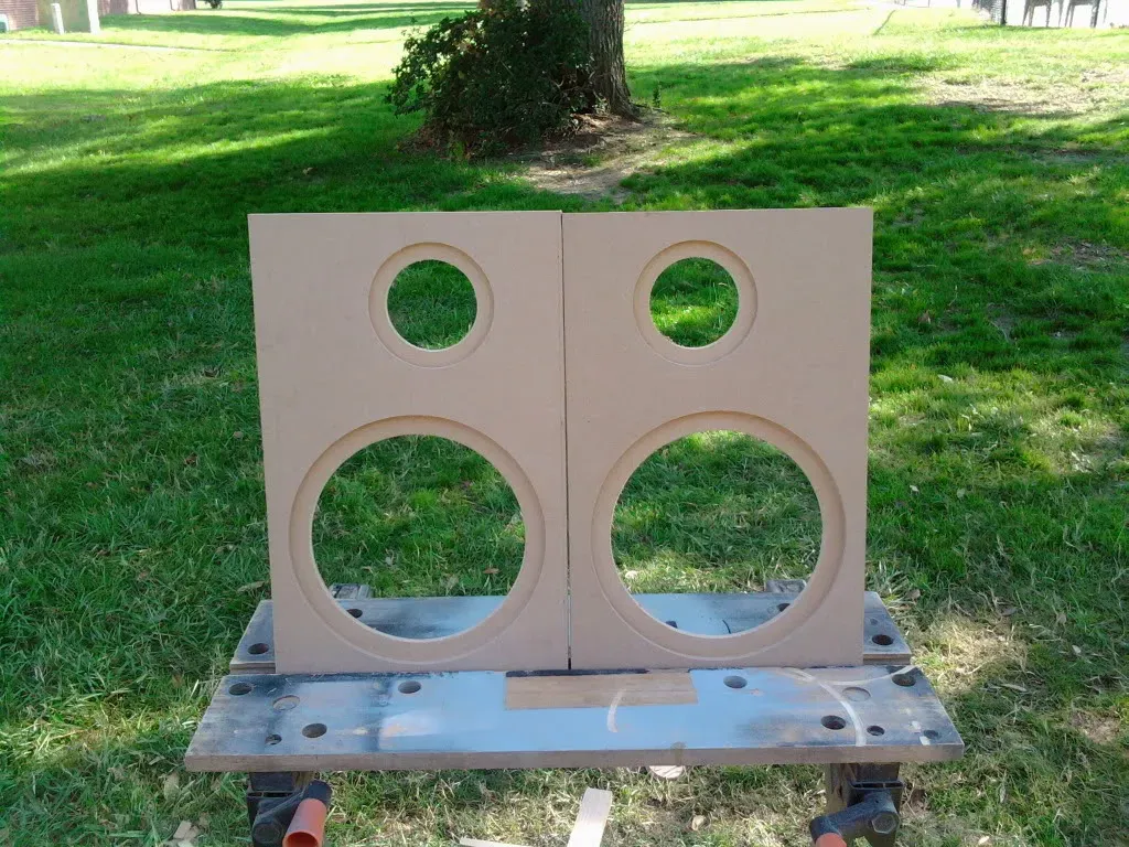

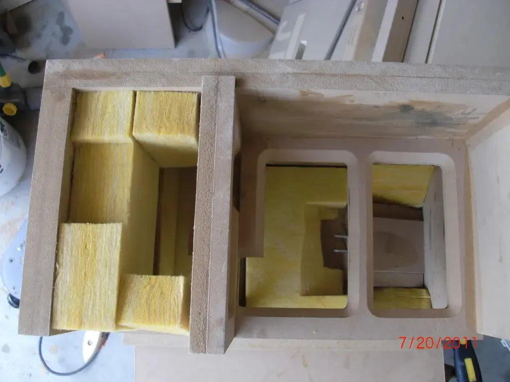

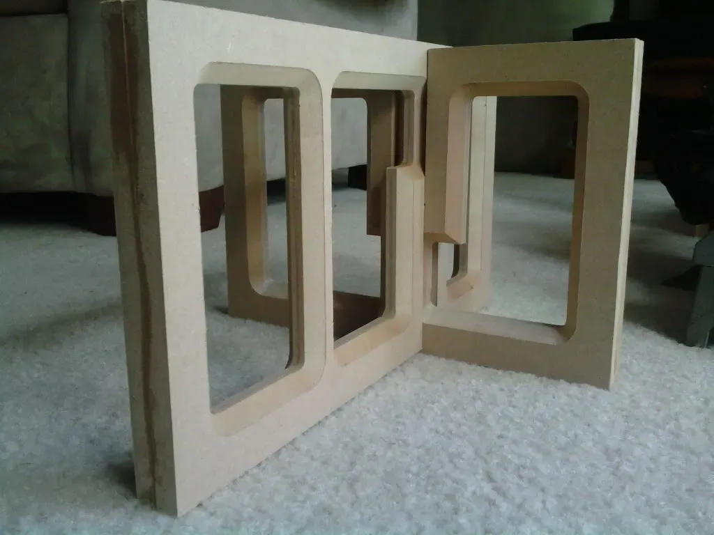

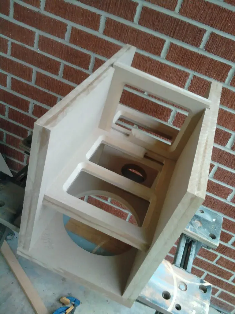

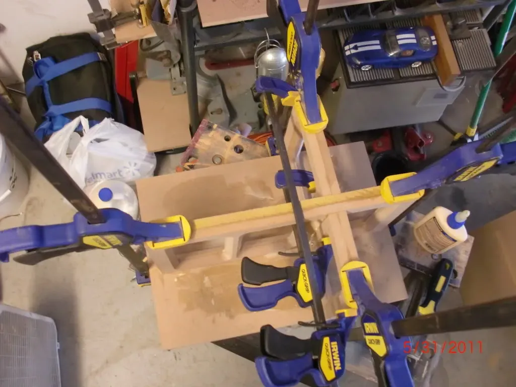

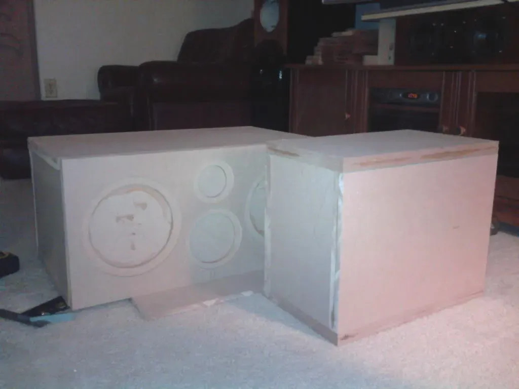

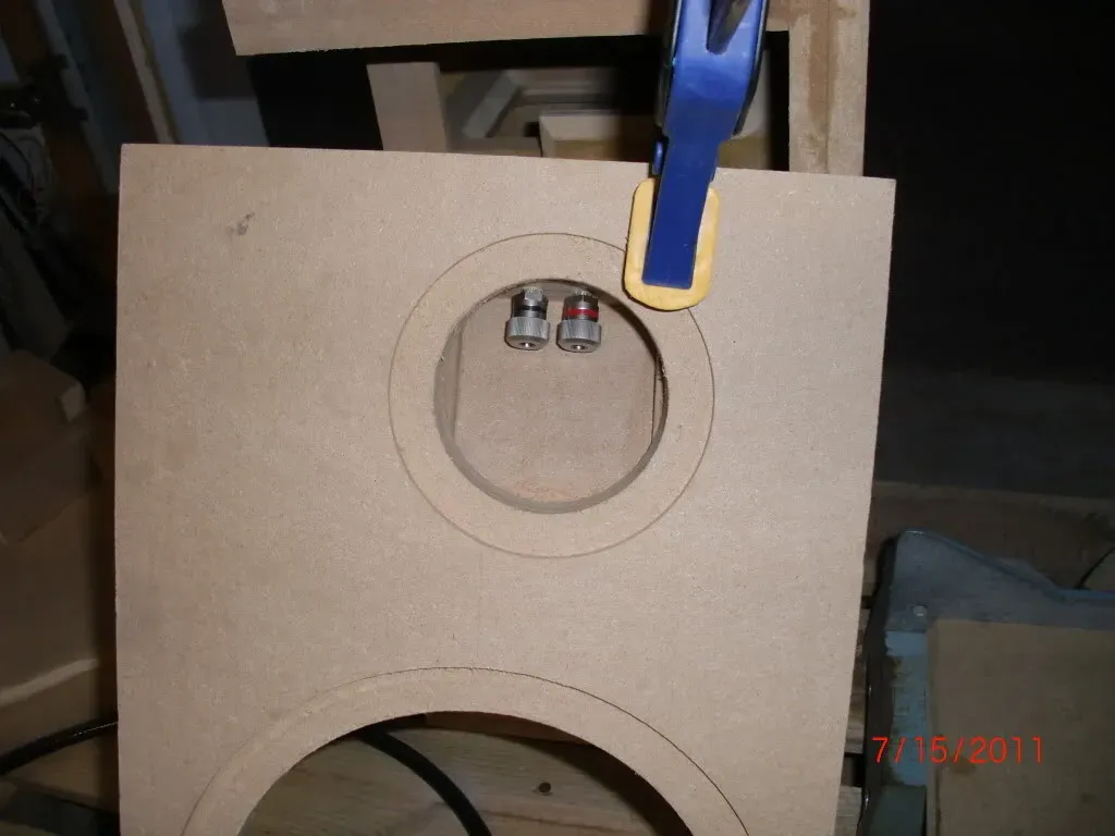

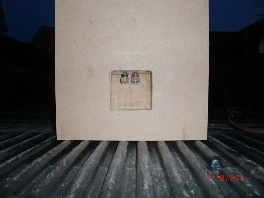

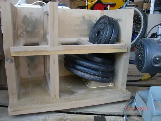

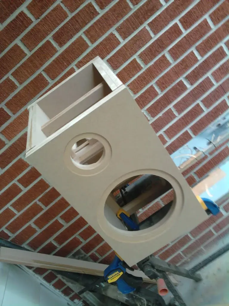

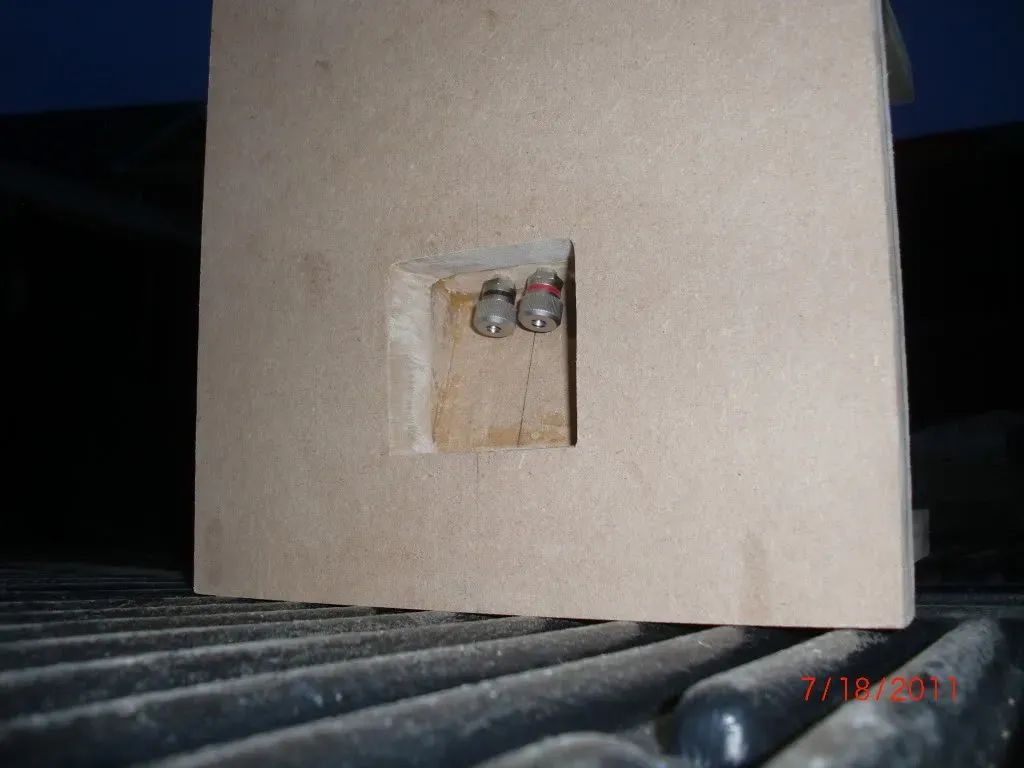

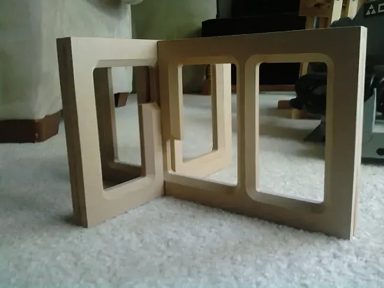

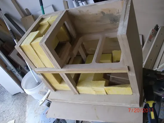

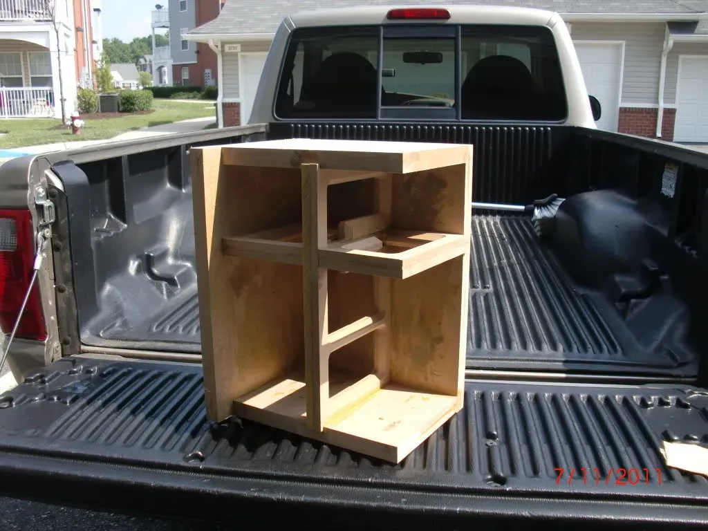

                  Baffles are cut out and laminated. Need to cut the bracing next.
                  Last edited by theSven; 14 June 2023, 20:06 Wednesday. Reason: Update image location

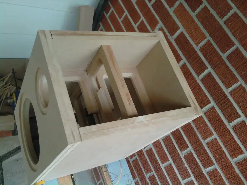

                  • joeybutts
                    • 476

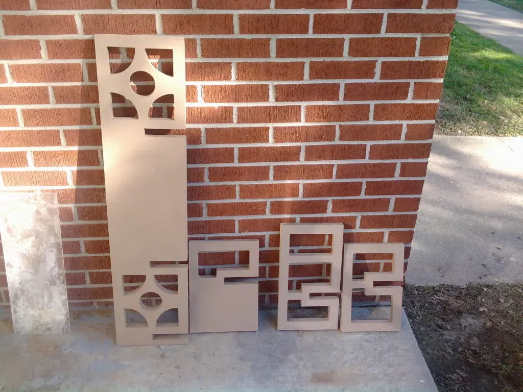

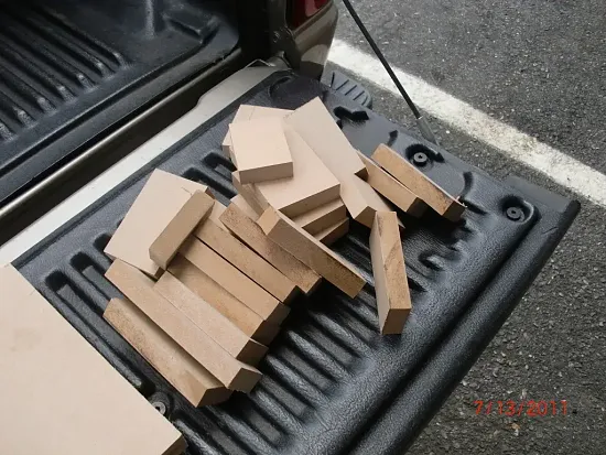

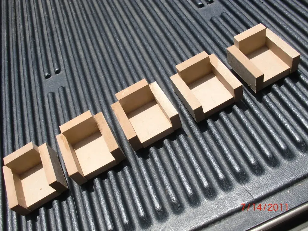

                    The bracing is planned, Thursday it will be cut....

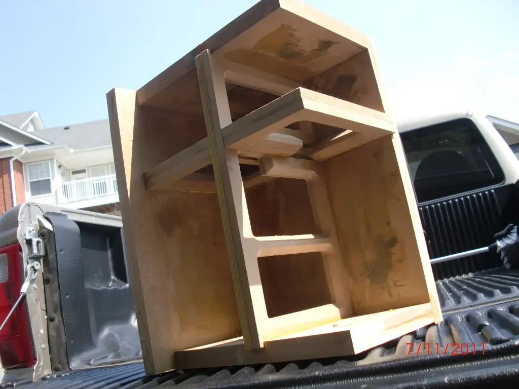

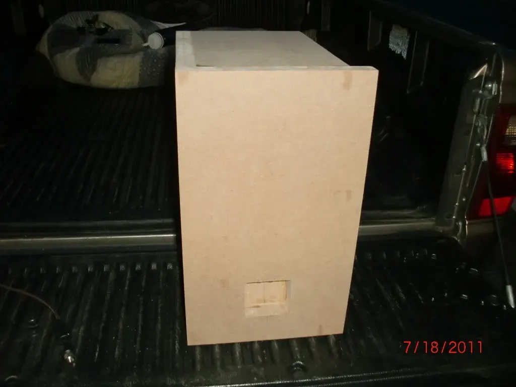

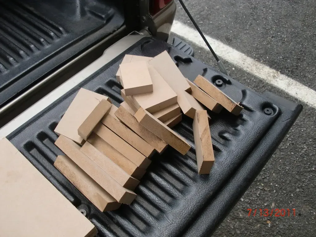

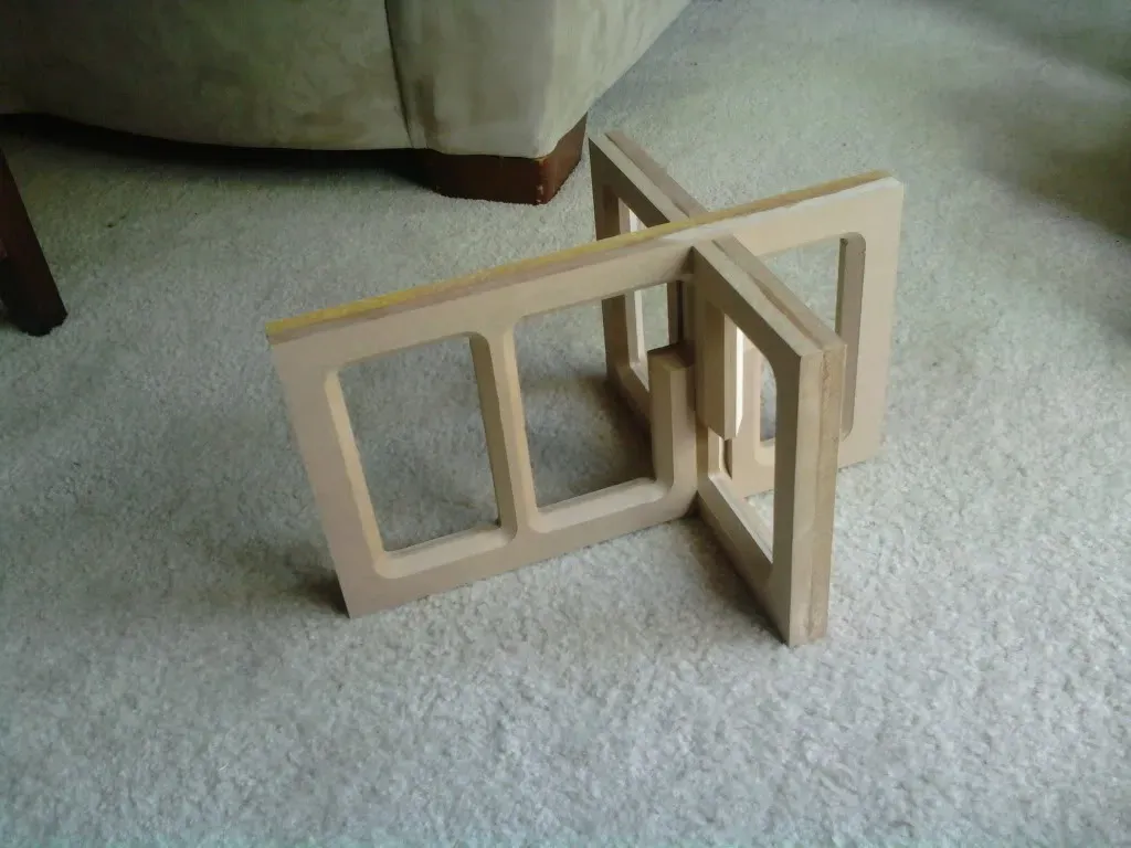

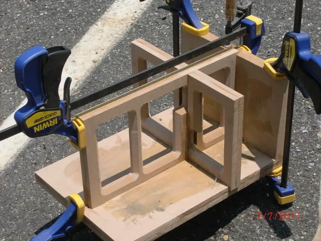

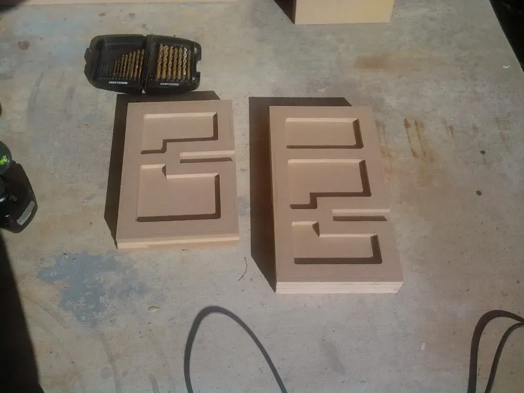

                    • joeybutts
                      • 476

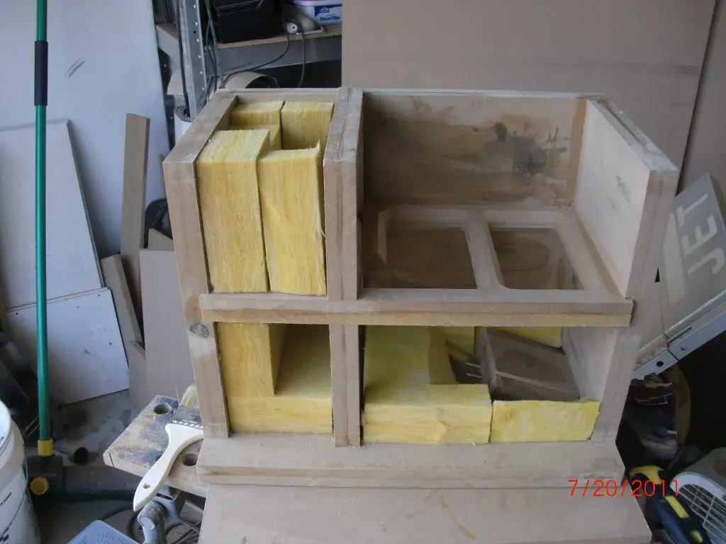

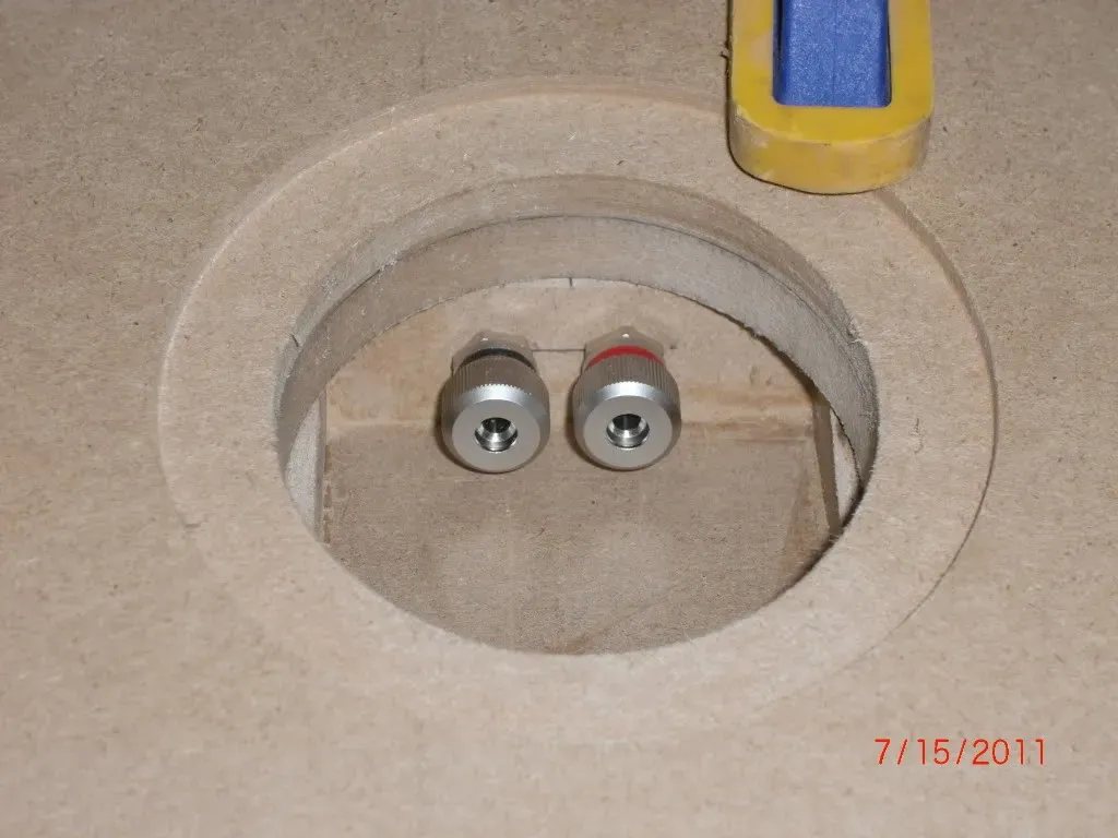

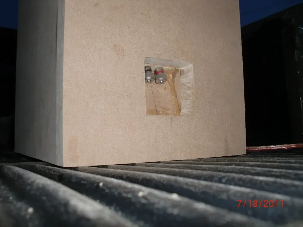

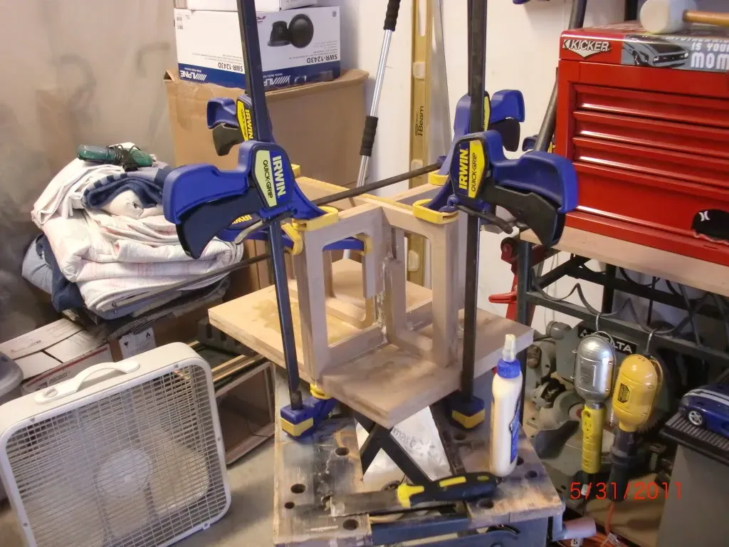

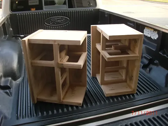

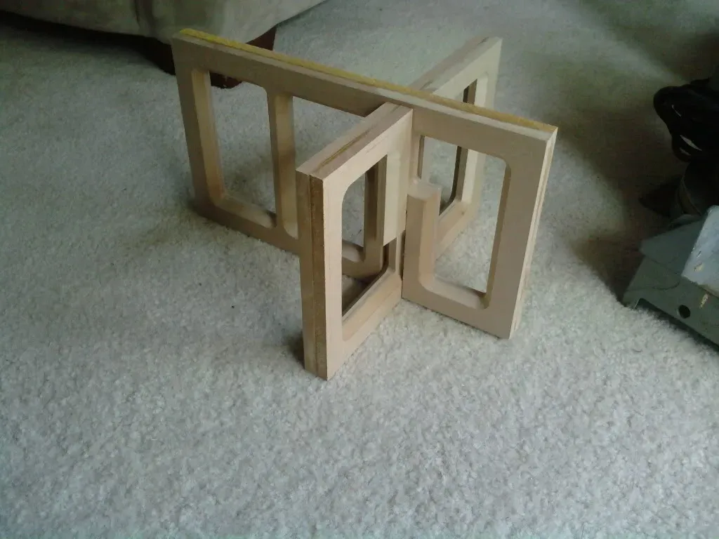

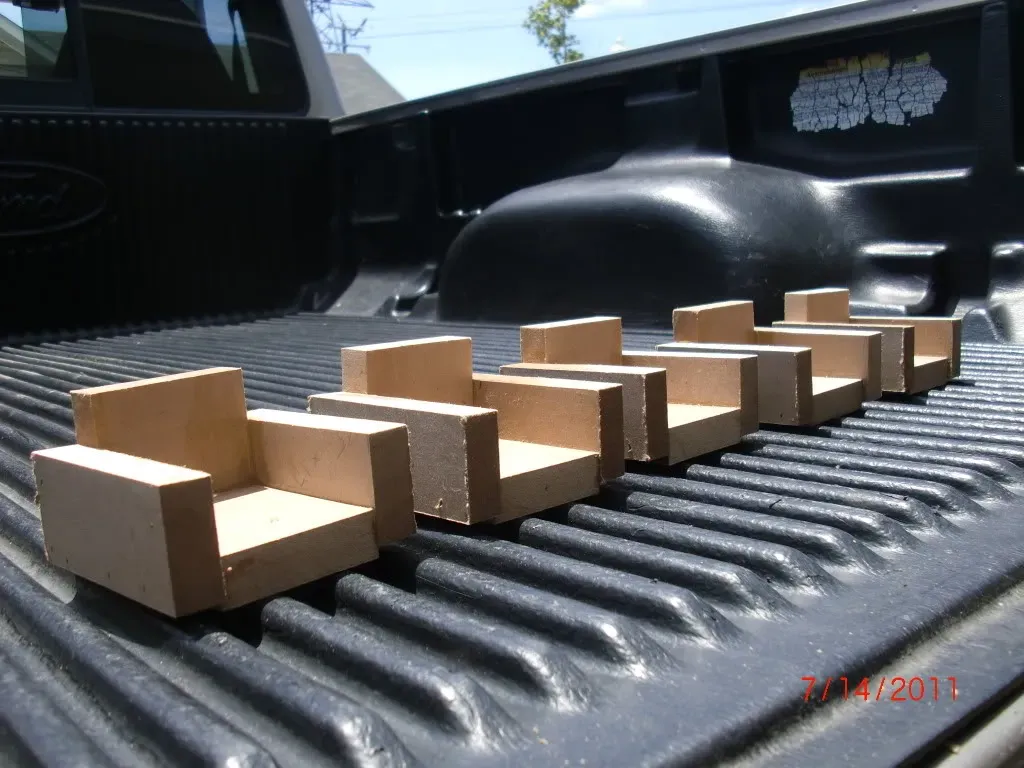

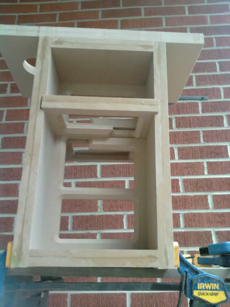

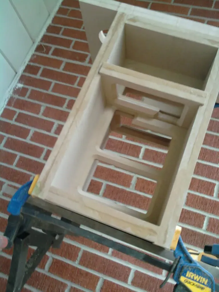

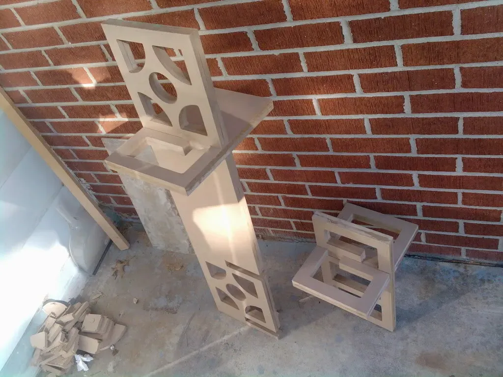

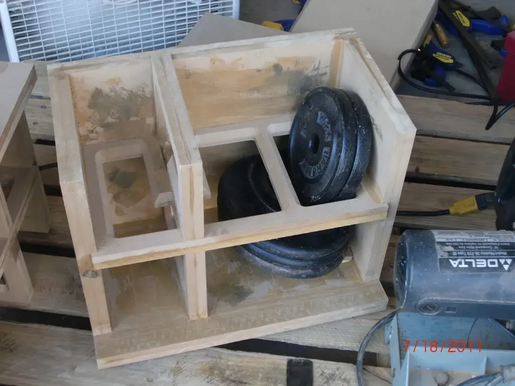

                      Brace complete
                      Last edited by theSven; 14 June 2023, 20:10 Wednesday. Reason: Update image location

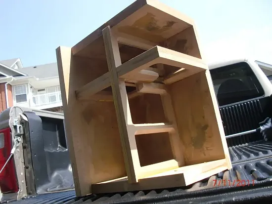

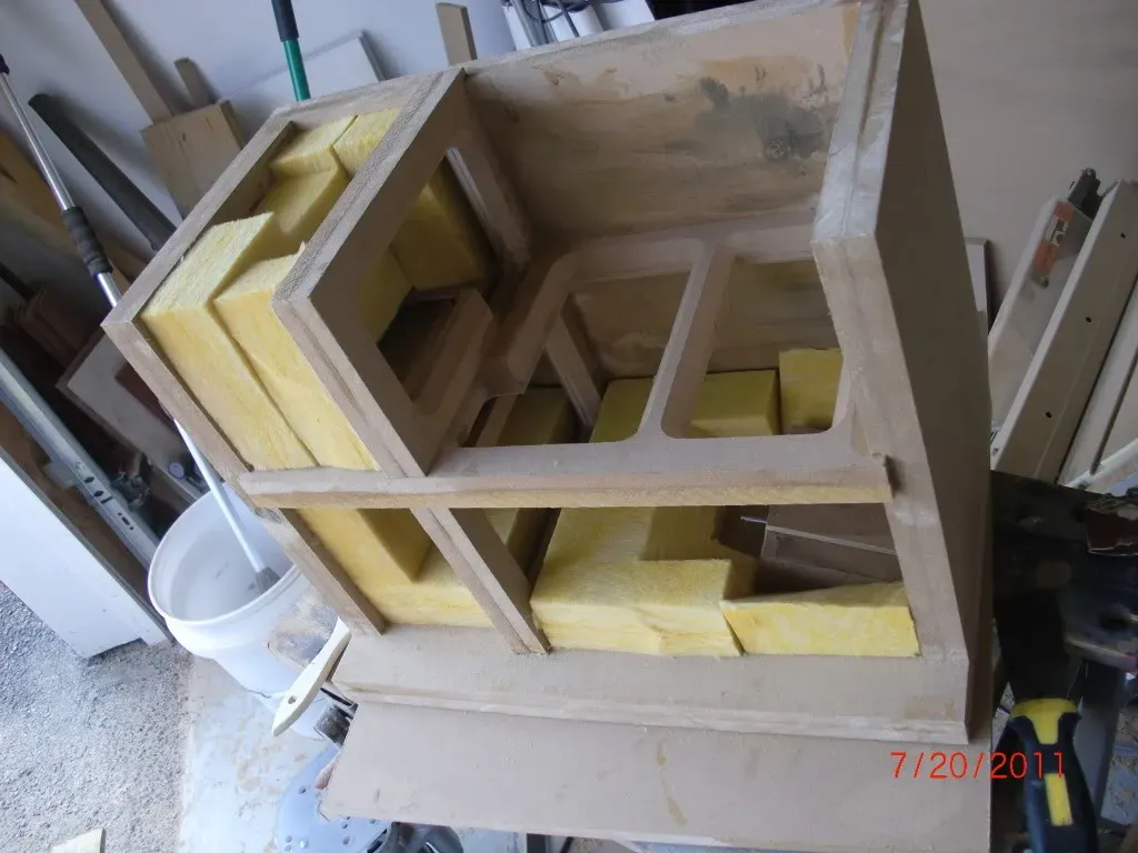

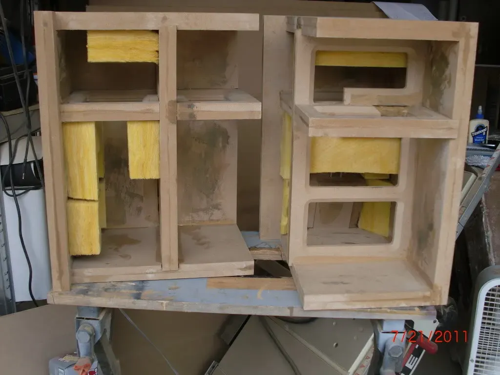

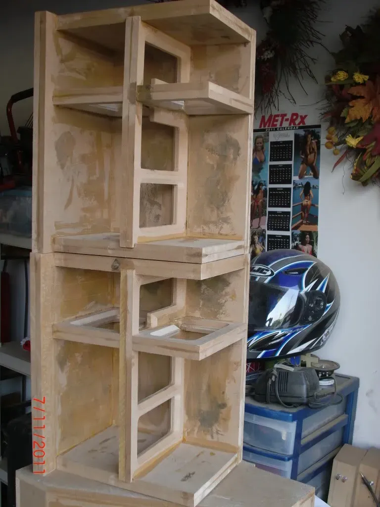

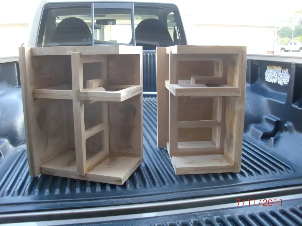

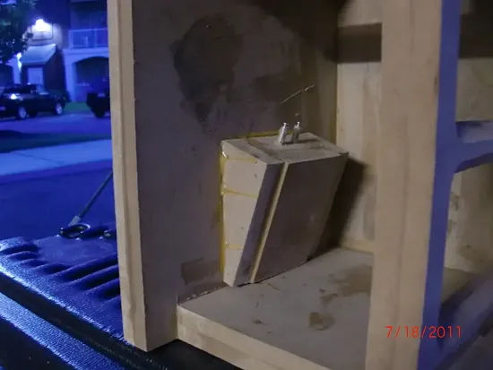

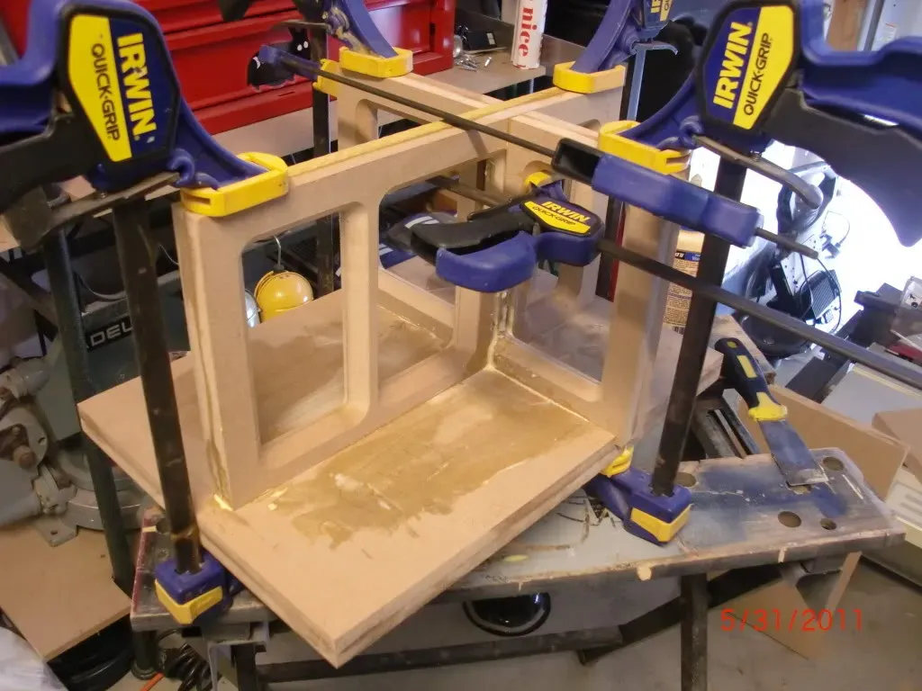

                      • joeybutts
                        • 476

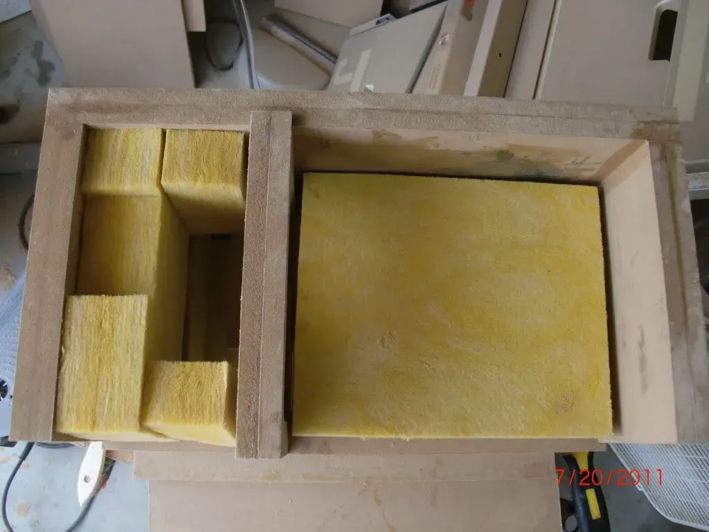

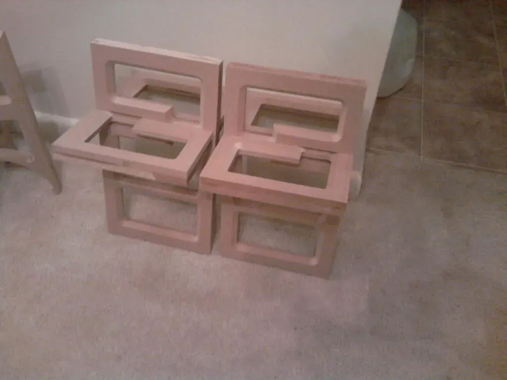

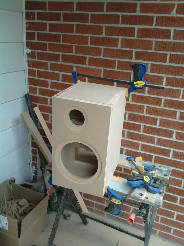

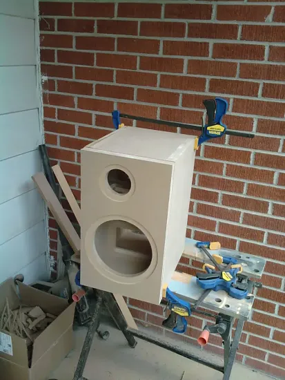

                        Bracing done!
                        Last edited by theSven; 14 June 2023, 20:11 Wednesday. Reason: Update image location

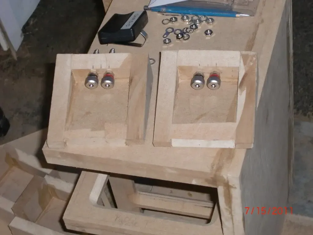

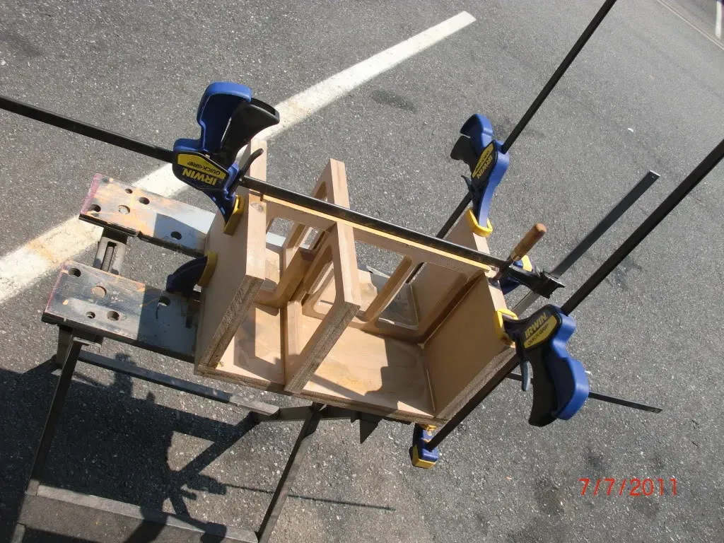

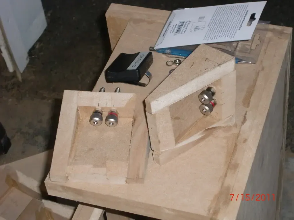

                        • joeybutts
                          • 476

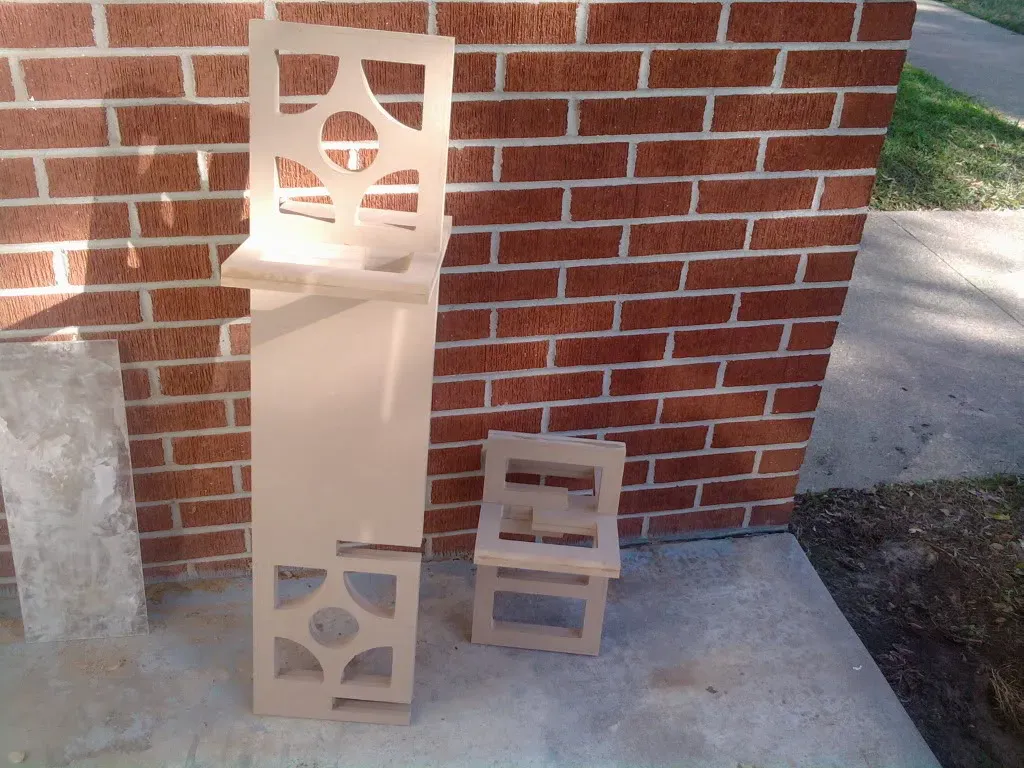

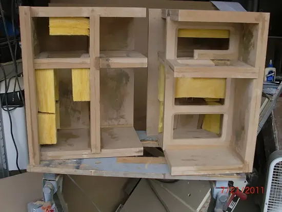

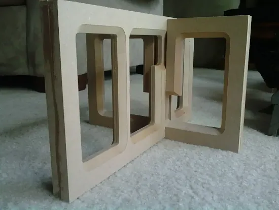

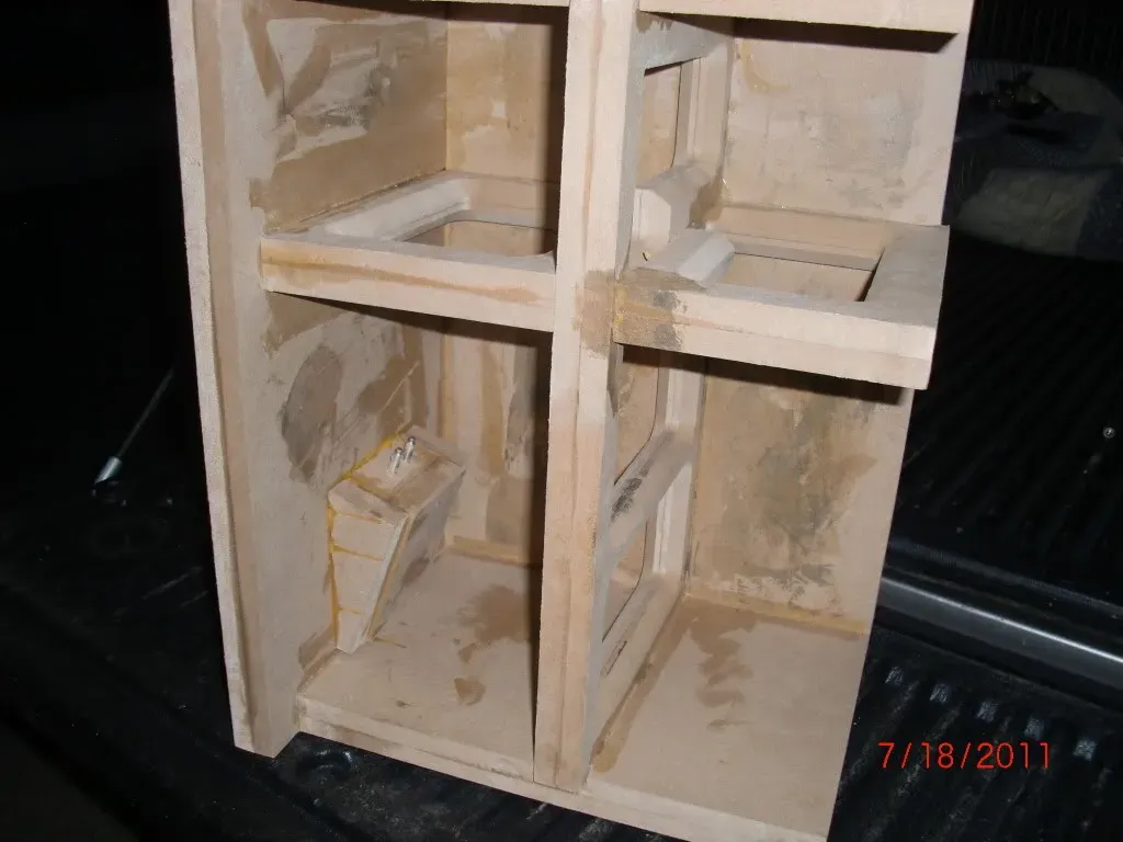

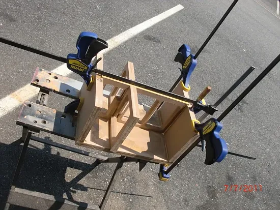

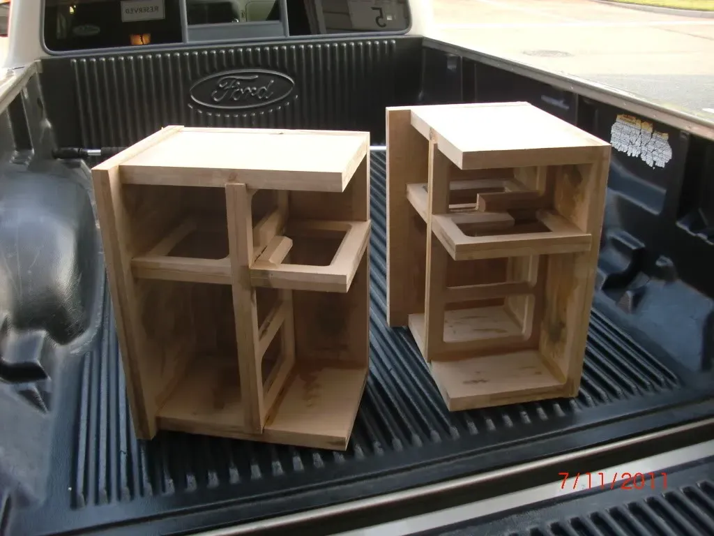

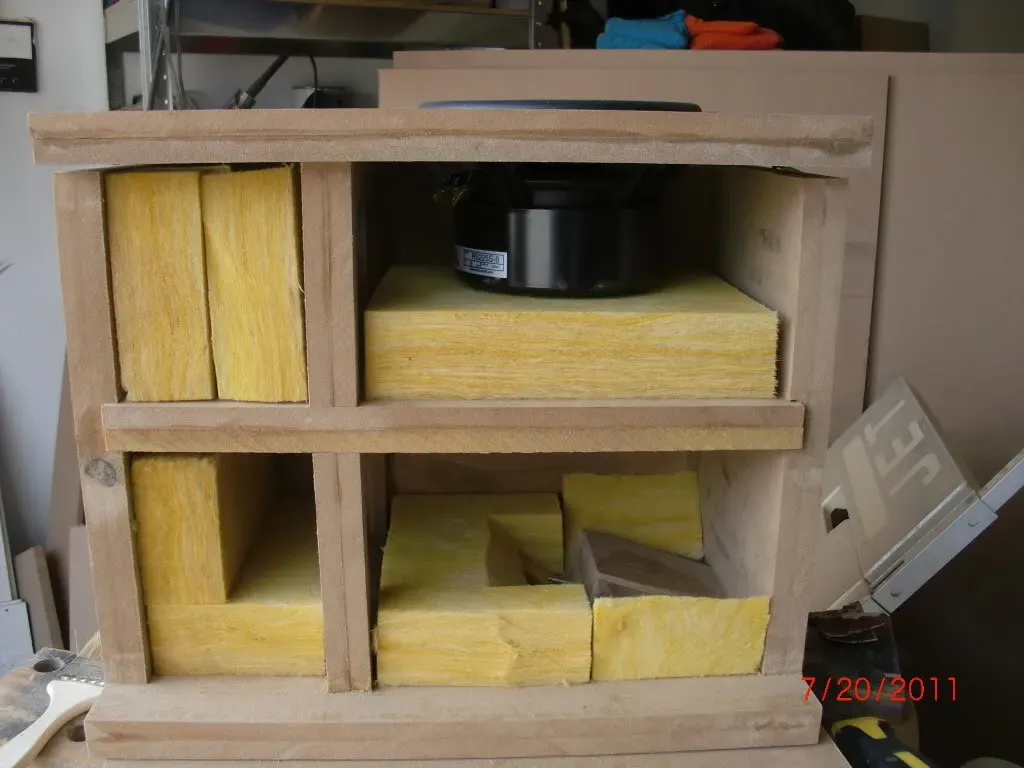

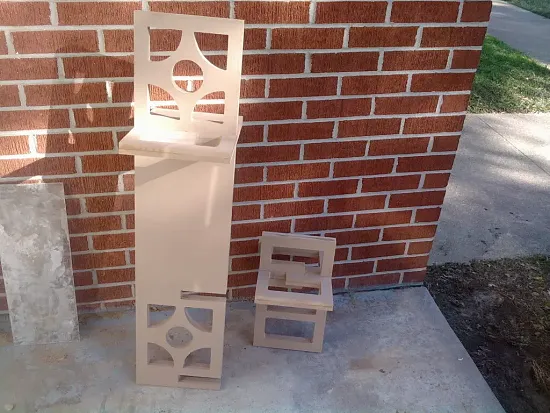

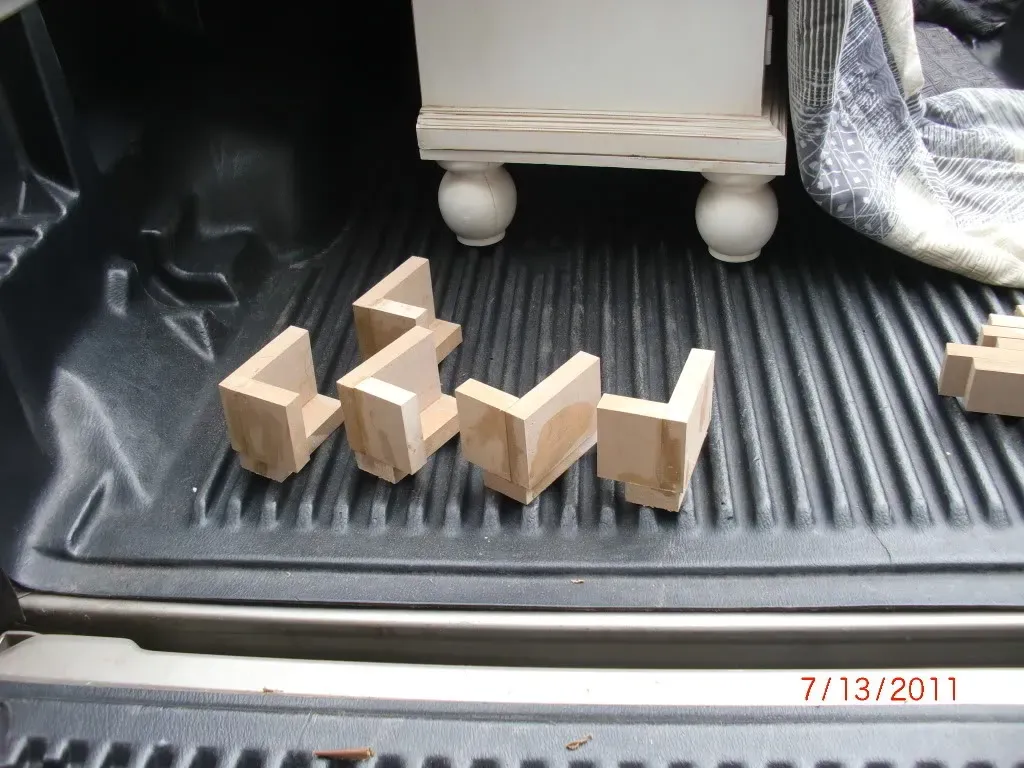

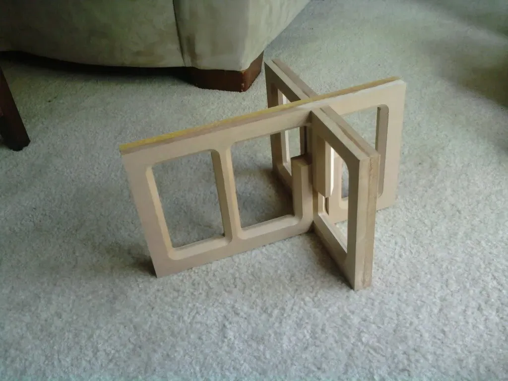

                          Pics of one surround bracing channeling done.
                          Last edited by theSven; 14 June 2023, 20:13 Wednesday. Reason: Update image location

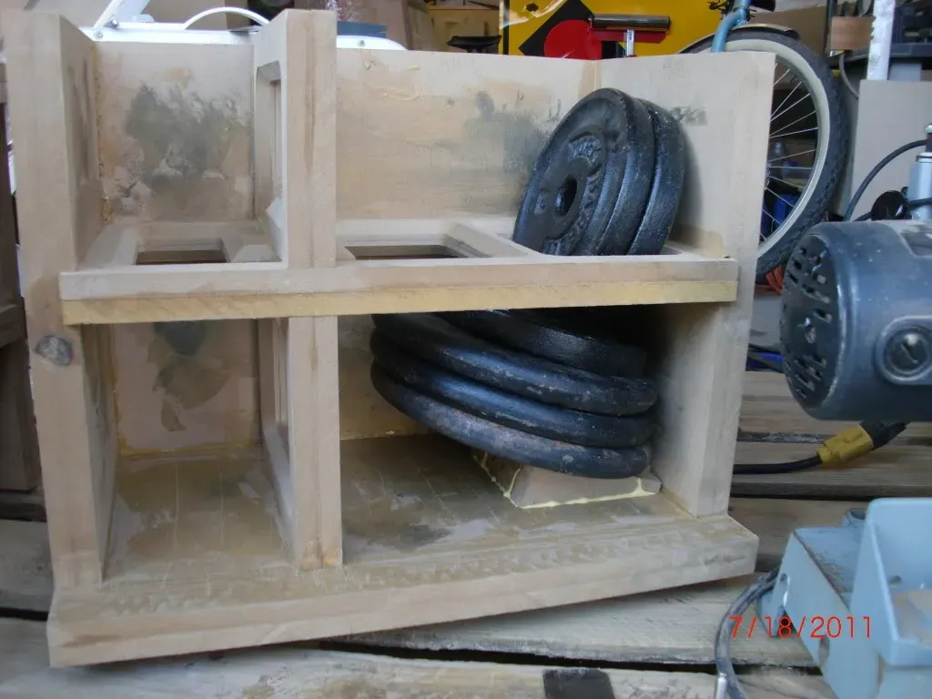

                          • JonP
                            • 692
                            Wow... double walls all the way around! Cool bracing, nice interleaving of the parts. Those boxes are going to be stiff, dead, and heavy... :T Watch your back!
                            I did a set of boxes the same (.75 cu ft) size, but 5/8" Baltic Birch (thinner and lighter per volume than MDF) only 2 layer laminated for the front baffle, and just a single height x width brace with much cutout. Even with the lighter RS180, they were still over 25lbs each when done. Wonder how much more yours will weigh?
                            • joeybutts
                              • 476
                              Thanks Jon! I have no idea and haven't even thought about that! I'll try and get a weight today of these and my center channel.

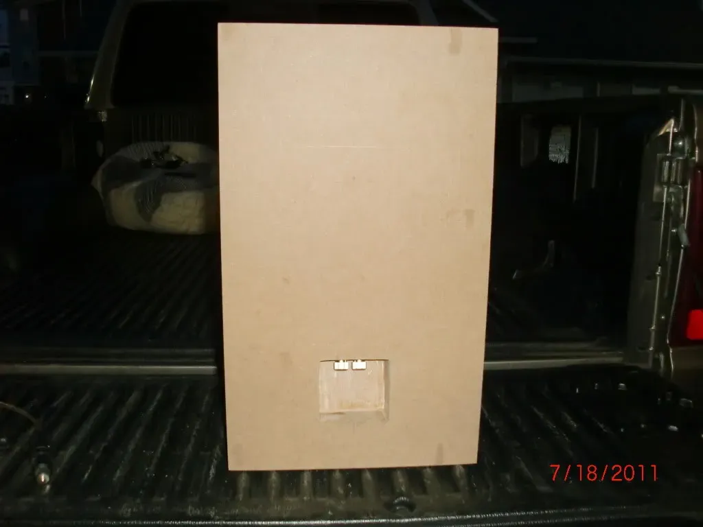

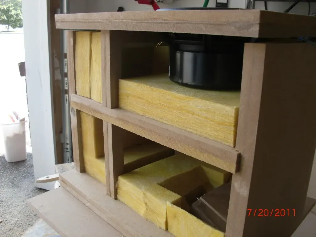

                              • joeybutts
                                • 476
                                Well, finally back up on this horse. Since I'm not having the surgery on my knee because my insurance told me I'm fat, I'm hoping to have these constructed by next weekend.

                                                          • joeybutts
                                                            • 476
                                                            Thanks fjhuerta! I've been under the weather as of late and haven't had a chance to work on these.

                                                                • joeybutts
                                                                  • 476
                                                                  Bracing and one side glued together on both. Hopefully tonight I get the top and bottom on both enclosures. I'm building this full HT set clamp/glue, so it will take some time. Should have these just about ready for OC703 and putting in the terminal cup in the back.
                                                                  Pics up tonight.
                                                                  • joeybutts
                                                                    • 476
                                                                    Clamps
                                                                    Last edited by theSven; 14 June 2023, 20:15 Wednesday. Reason: Update image location
                                                                    • joeybutts
                                                                      • 476
                                                                      Slow slow progress
                                                                      Last edited by theSven; 14 June 2023, 20:16 Wednesday. Reason: Update image location
                                                                      • joeybutts
                                                                        • 476
                                                                        Coming along......
                                                                        Last edited by theSven; 14 June 2023, 20:17 Wednesday. Reason: Update image location

                                                                          • joeybutts
                                                                            • 476
                                                                            Originally posted by krips
                                                                            Those will be some sturdy and weighty little TMs when you're done.
                                                                            Oh....you better believe it.
                                                                            I'm going to estimate them to end up around 50 lbs not even really thinking about it.... I'll try to weigh the enclosure some time this week.

                                                                                • joeybutts
                                                                                  • 476

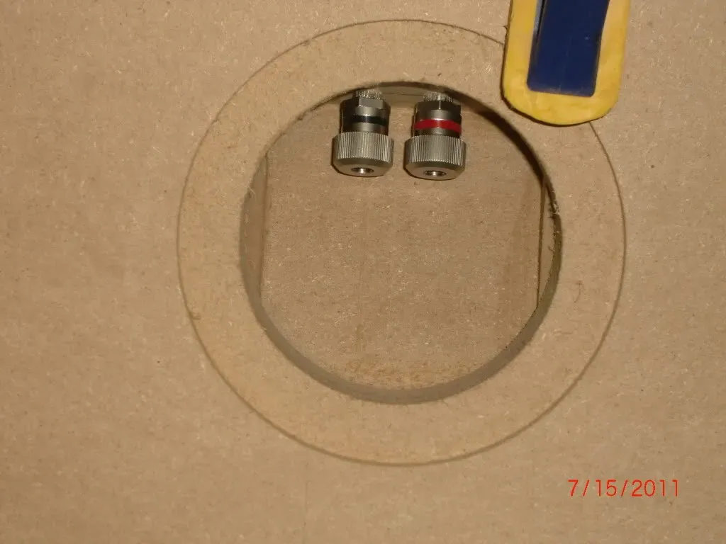

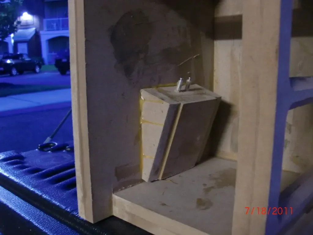

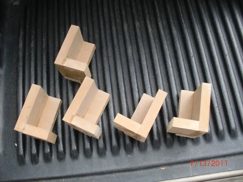

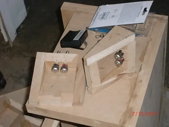

                                                                                  Got the terminal "cups" just about done. Need some detail work since my old but trusty miter saw isn't quite as precise as necessary. Going to pick up some belts for the belt sander shortly to clean up the mounting faces.
                                                                                  Parts for all five terminal cups cut and glued
                                                                                  Check out the awesome armchairs......
                                                                                  I wanted something different than just perpendicular to the cabinet and would streamline the cables coming out so that they were almost hidden so I went with a downward angled terminal style.
                                                                                  And here is an idea of what it will be like, using one of my waterlogged baffles I need to recut. I don't know if the pics really show it well but I tried.
                                                                                  Slowly but surely......
                                                                                  Last edited by theSven; 14 June 2023, 20:21 Wednesday. Reason: Update image location
                                                                                  • joeybutts
                                                                                    • 476
                                                                                    Terminal cups glued in. One of them almost done being sanded. Both done tomorrow and new baffles cut.

                                                                                    • joeybutts
                                                                                      • 476
                                                                                      Picked up the 703 and made the new baffles. Just need to make sure that I don't have TOO much 703 in the cabinets. Can somebody give me guidance on if I need more/less in there? My biggest question is if I need more room between the motor of the woofer and that piece of 703 on the bracing.....
                                                                                      Owen Corning 703
                                                                                      Cut up and in!! If this checks out going to seal up the cab's and then just need crossover components and do the finish! WOOT!
                                                                                      Last edited by theSven; 15 June 2023, 09:07 Thursday. Reason: Update image location
                                                                                      • joeybutts
                                                                                        • 476
                                                                                        Revised the 703 layout and amount, and am gluing on the remaining panels right meow!
                                                                                        Last edited by theSven; 15 June 2023, 09:04 Thursday. Reason: Update image location
                                                                                        • joeybutts
                                                                                          • 476

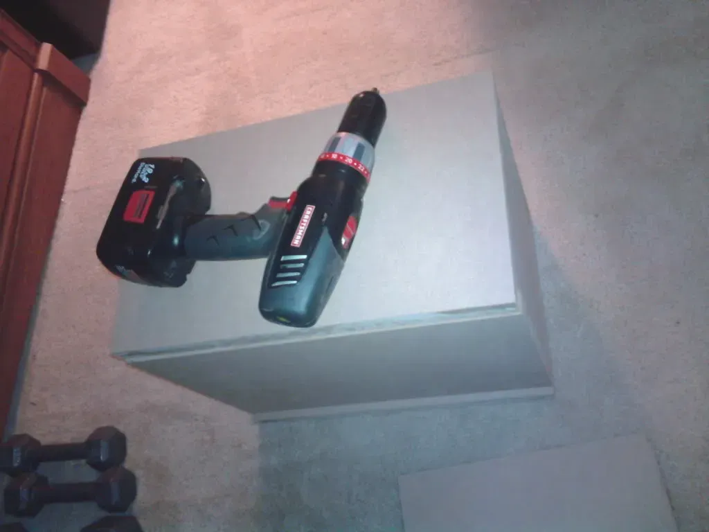

                                                                                          Enclosures are together! Baffles are drying up and should be good by now actually. Both cabinets are fully sanded except for the baffle edges. Need to figure out any accents I want to do in the cab's if any and then all that is left is crossover and finish work. Crossover is easy, the finish.........
                                                                                          Pics maybe later tonight and also might weigh in the cab's for sihts and giggles.
