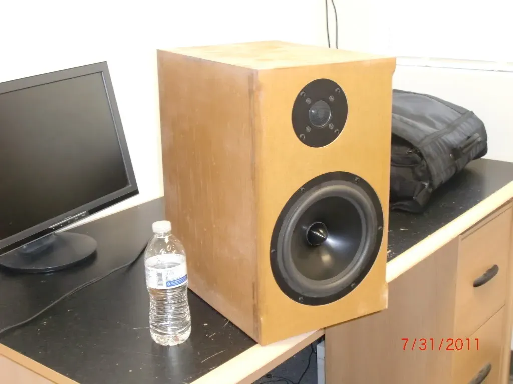

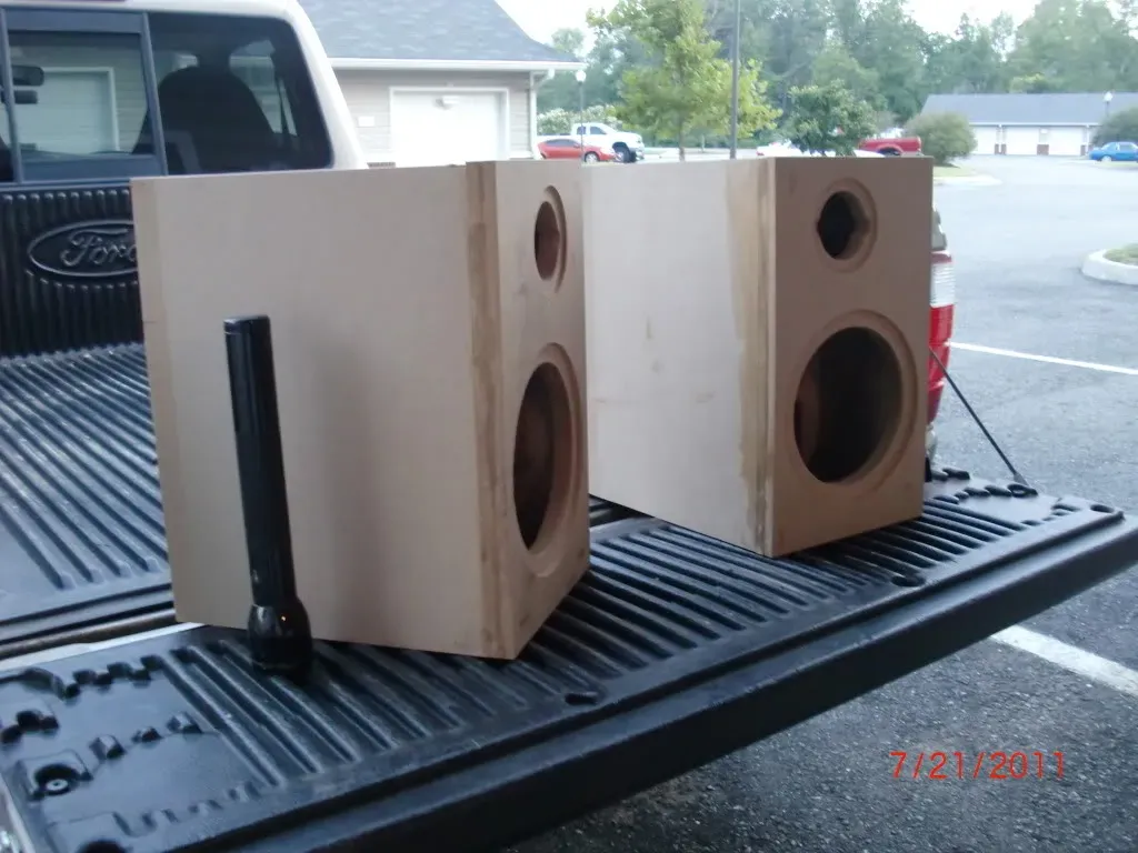

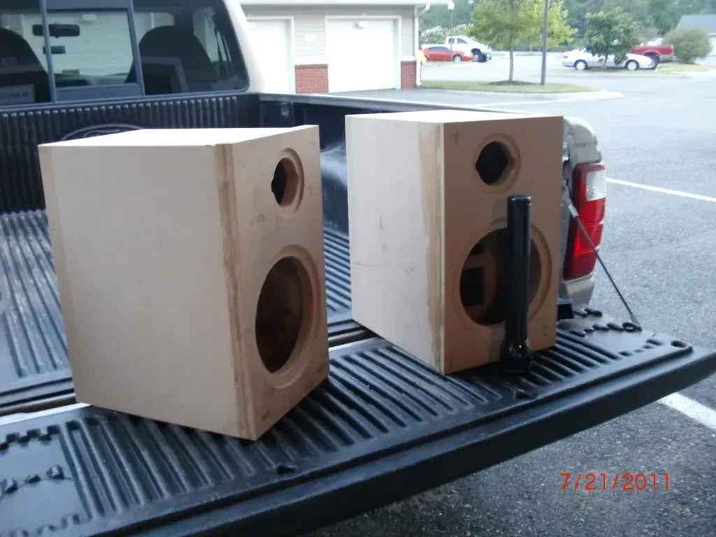

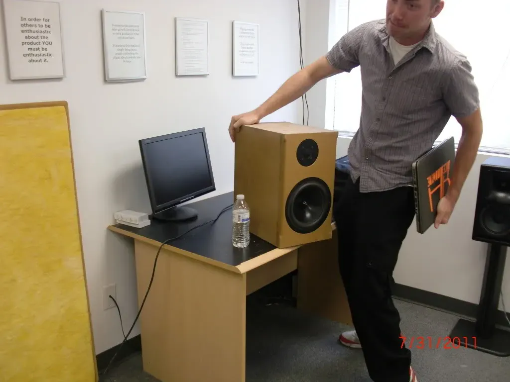

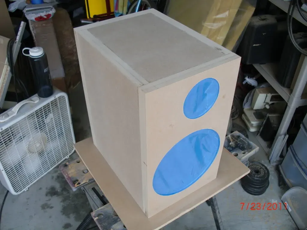

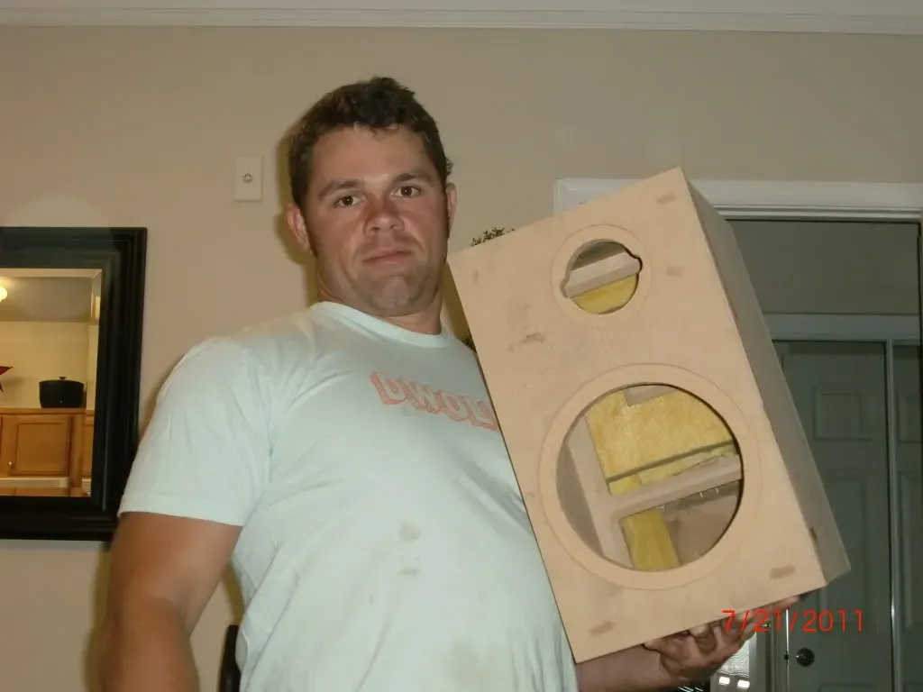

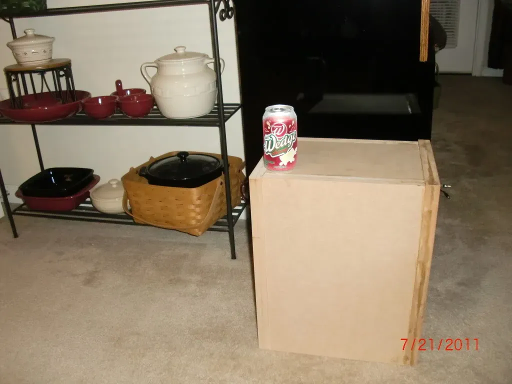

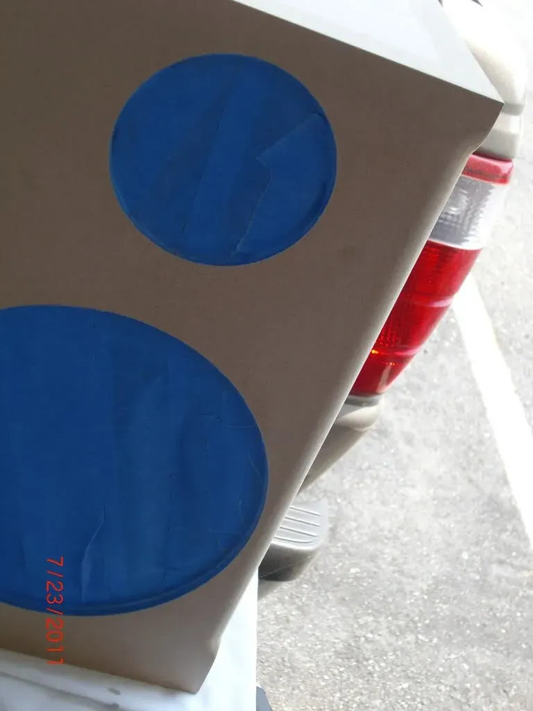

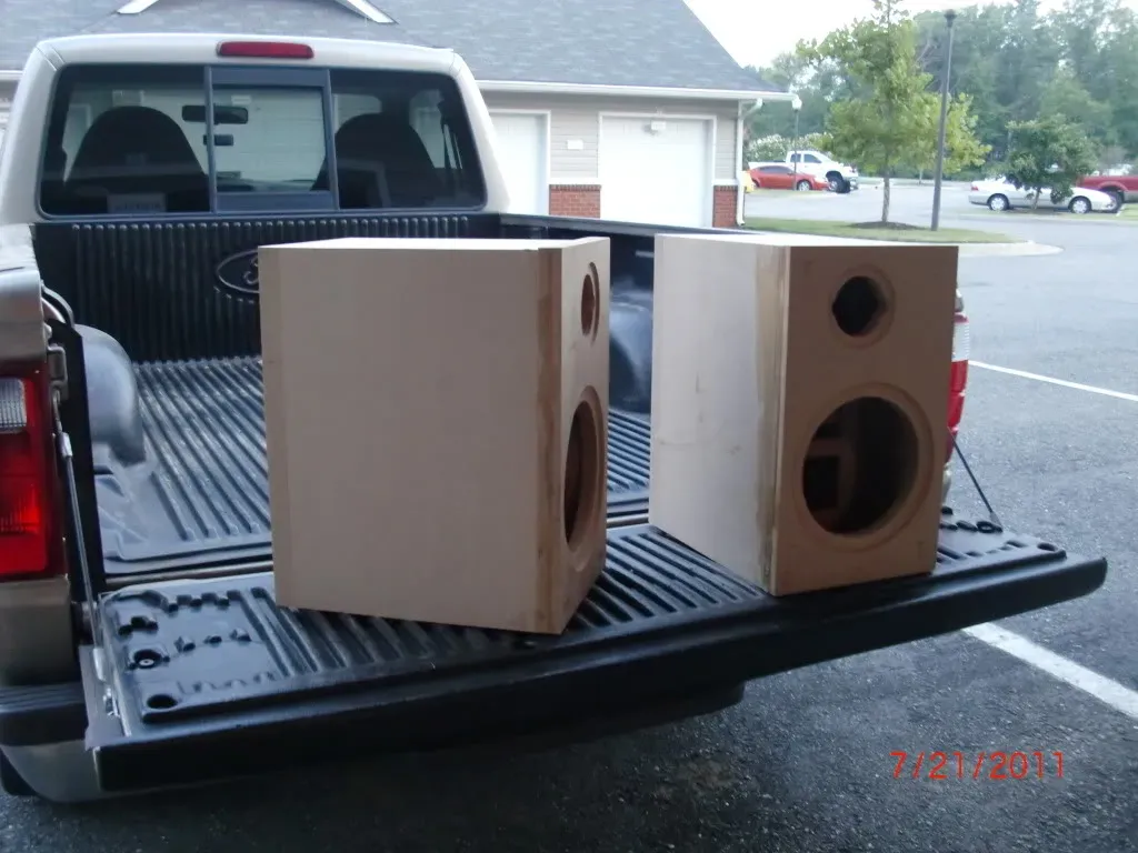

    Cab construction is complete! Need to round over the two vertical edges and flush the baffle edges, but other than that, good to go.
    Things are beasts for TM's. Weighed them tonight. 29 lbs unloaded.

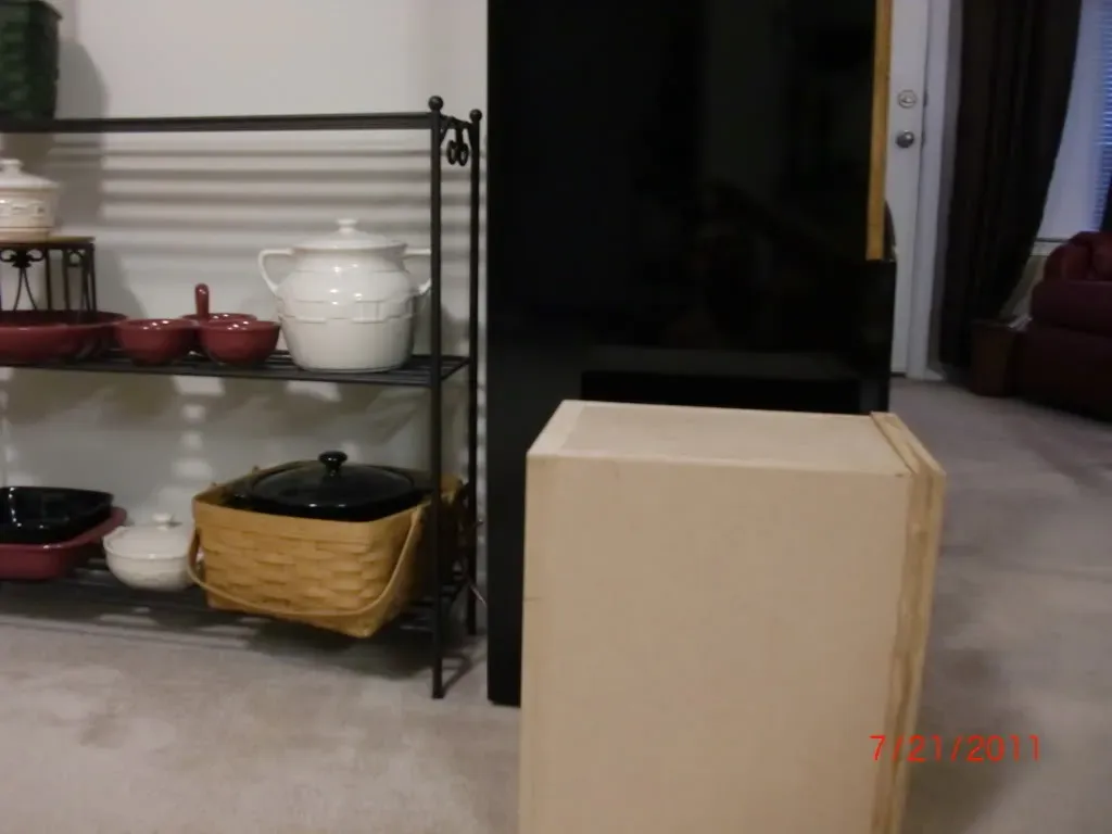

    Mag for size comparison

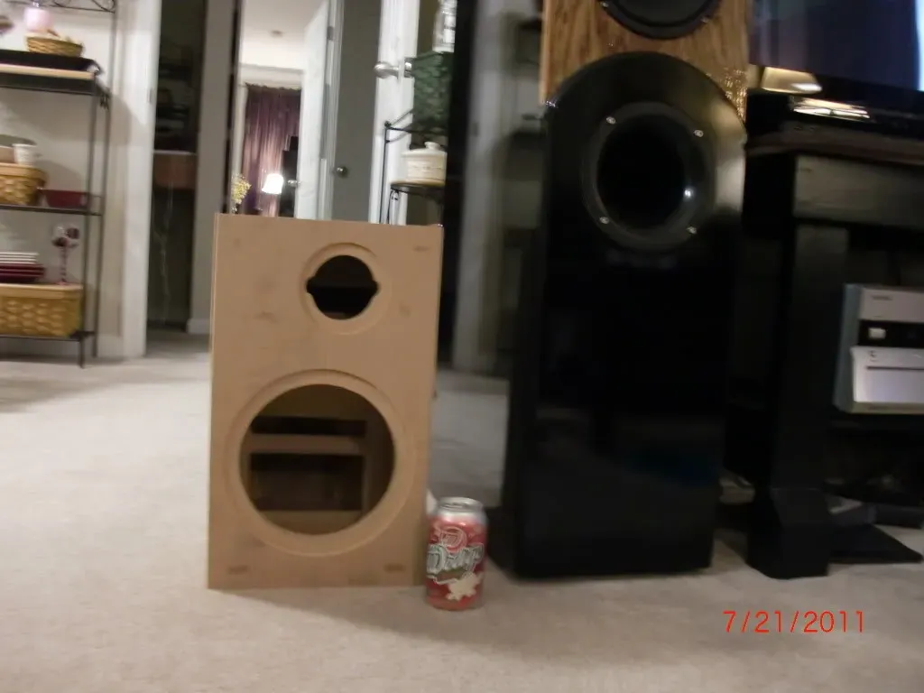

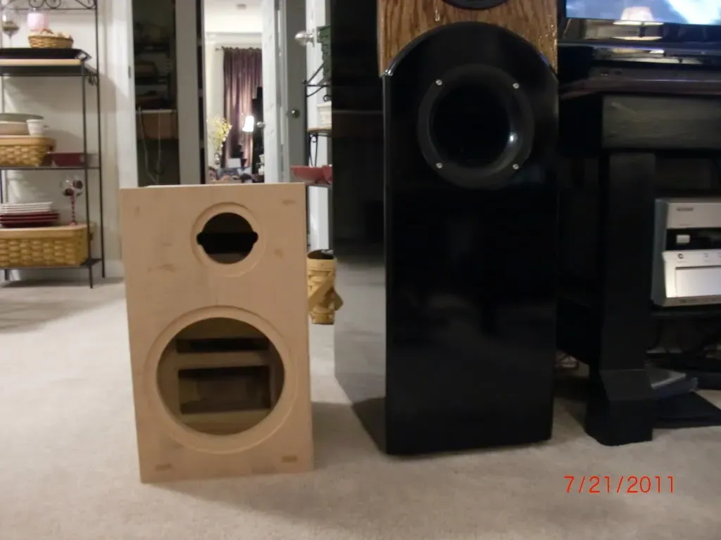

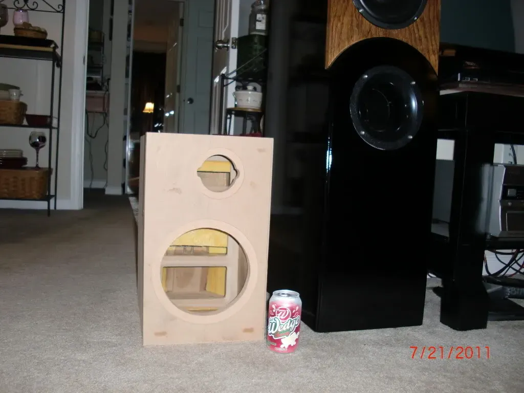

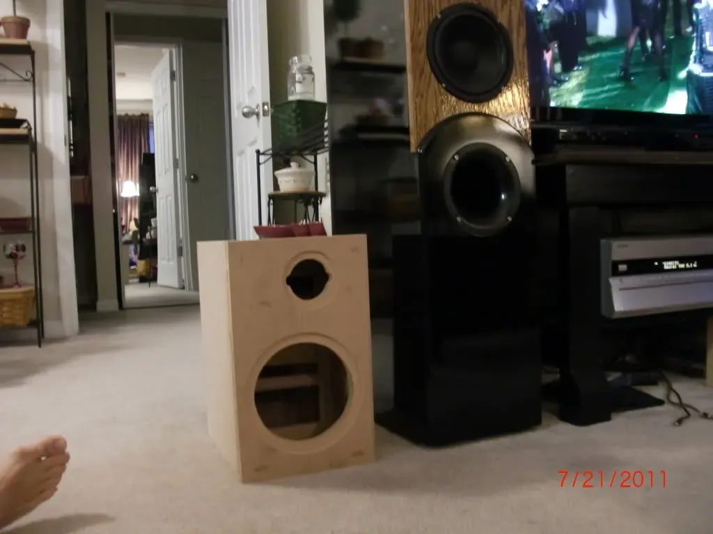

    Next to the D8's

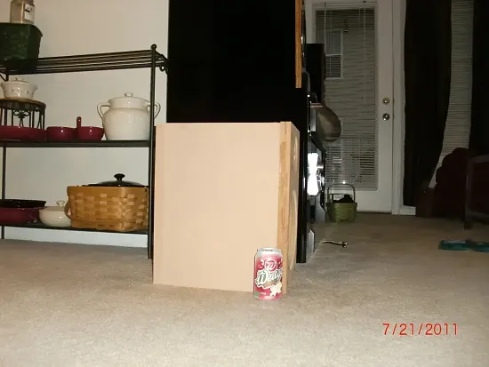

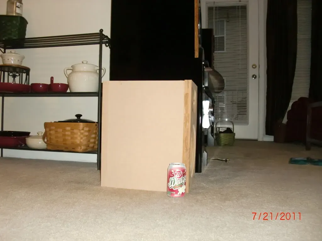

    Pop can size comparison

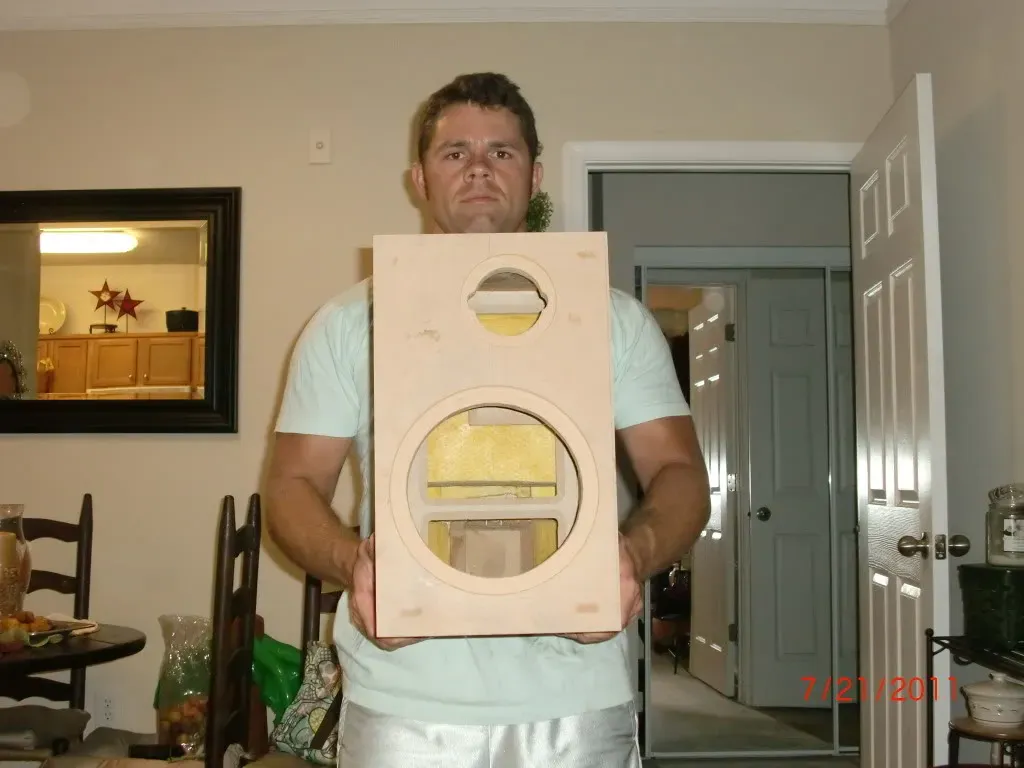

    Me for size comparison....Fiance thinks I'm crazy.

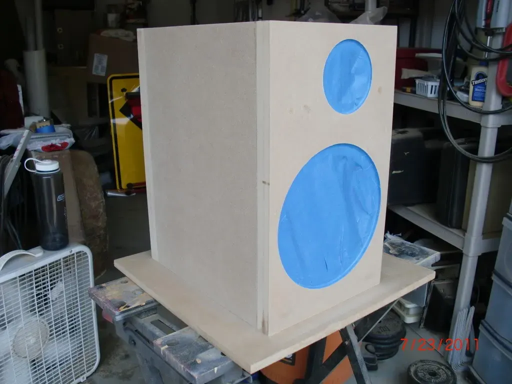

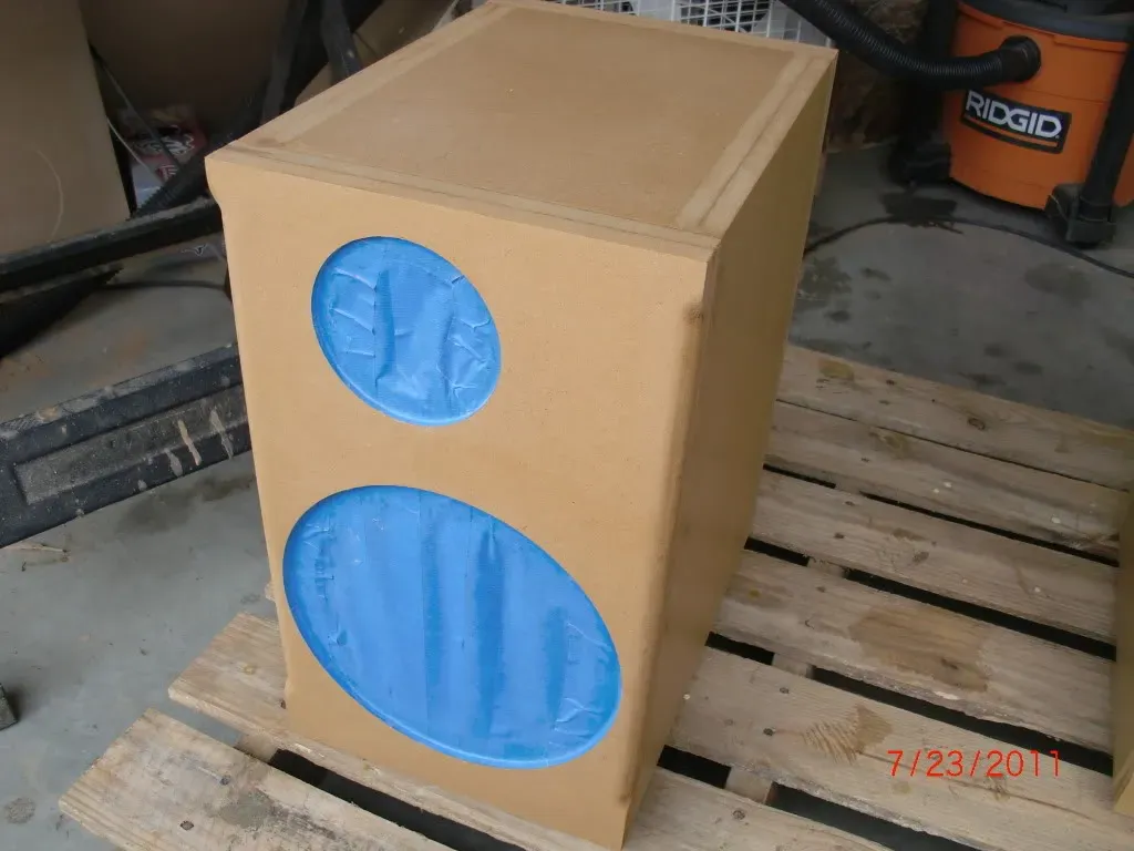

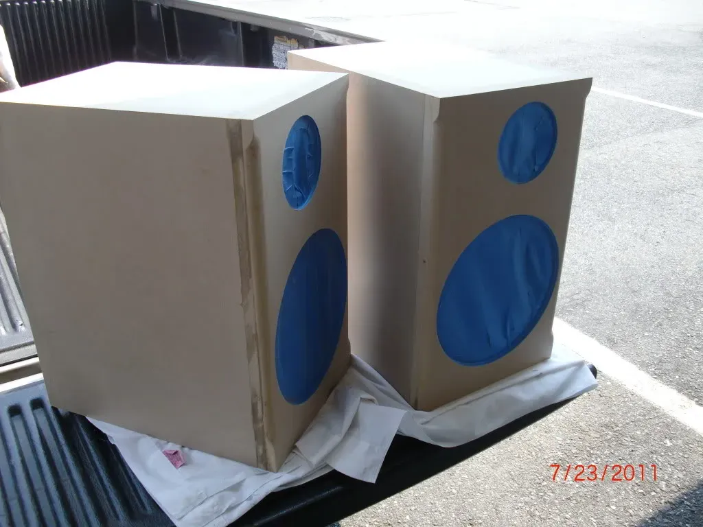

      Cabinets have one coat of 65/35 glue/water on them. Going to give them a nice scuff of 220 and give them a coat of resin, and prep them for priming!
      Fully sanded.

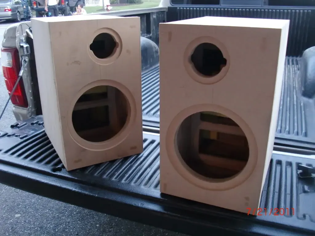

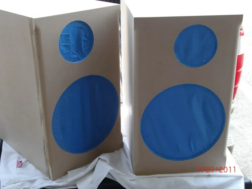

      Baffles routed and sanded

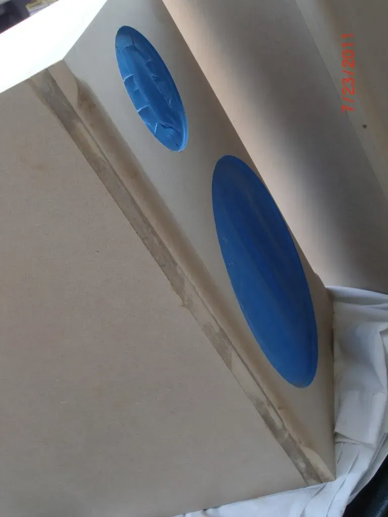

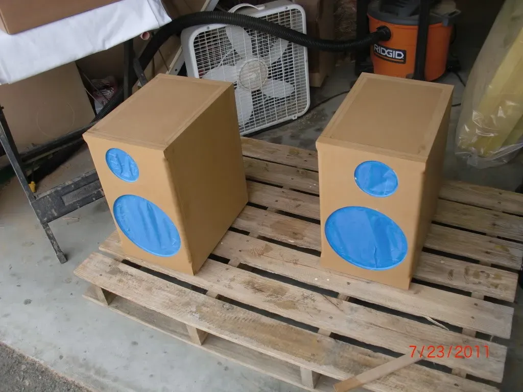

      First coat of "sealer"

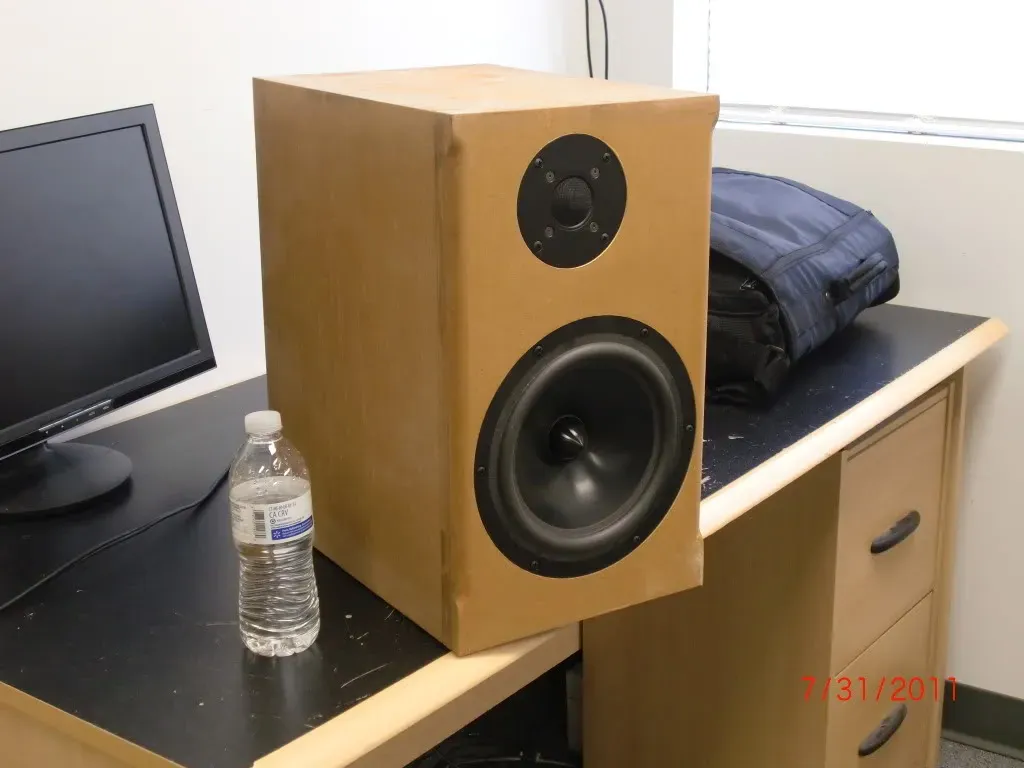

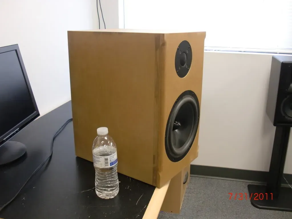

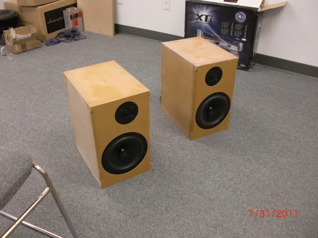

        So got a chance to listen to these without the proper crossover network in place but using some active processing, and ....well......
        LOVED THEM. OMG. I know that it was only a rough idea of what they will sound like when completed (due to the crossover not being in and only running on a combined maybe 30W and some leaks through the binding post holes where i ghetto-rigged it.....) but the extension and smooth tone and airiness was so sweet. I have some pics of the drivers installed and will post up later today.

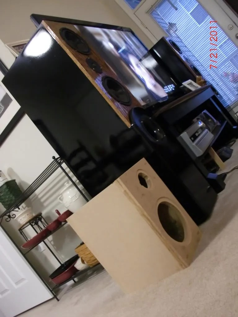

          What is the volume of the cabs? They look a bit bigger than .75 ft3
          • joeybutts
            • 476
            I think they are a bit bigger.....like .76 cubes. :W
            Seriously I think they come out a shade over .75 after displacement and what not.

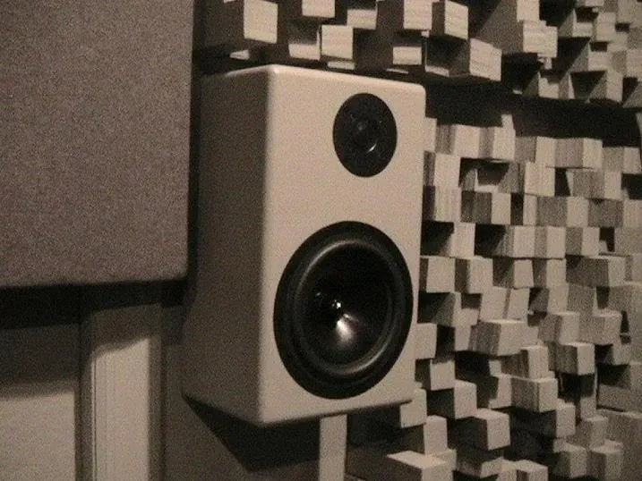

              • kgveteran
                • 865
                Here are my modified i built about four years ago. They are killer rear and back surrounds. I think they are 8" deep. That kinda ruined the bottom end, but i Crossover @ 80hz...no big.....they begin to rolloff around 50hz.
                Sorry to hijack

                      I'm curious: why did you stop the roundover short of the ends? On the woofer side, you probably won't get too much diffraction, but on the top near the tweeter, the pointed corners will almost surely be measurable (potentially audible to a non-trained ear). This is less relevant for surrounds, but if you go to multi-channel music, it may bug you later on down the road...
                      • joeybutts
                        • 476
                        Purely aesthetics. I thought that the roundover passed high enough from the tweeter that it wouldn't have too much impact on the sound.
                        Has there been any testing on at what distance does a variation not exist at the edge of the cabinet?
                          • 1044
                          You can play around with a baffle diffraction simulator (e.g., BDS is Excel-based or Edge is stand-alone). I'm not sure that either can model that type of edge treatment. I think both assume that a given face is uniformly chamfered, rounded or "square" (deep faceting like with Avalon-style cabinets are also not modeled well, though BDS probably comes closest).
                          • Ray_D
                            • 164
                            Hi Bear
                            I think that is unlikely. It is a very small angular subtense. I think edge diffraction is overrated in general. Most simulations are on-axis only and most listening is off axis which changes the effect. I don't think this is worth worrying about.
                            Regards
                            Ray

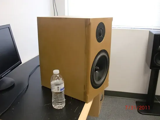

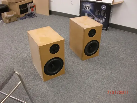

                              YES!!! Finally! Crossover parts will be here next week!! Sweet victory!
                              • joeybutts
                                • 476

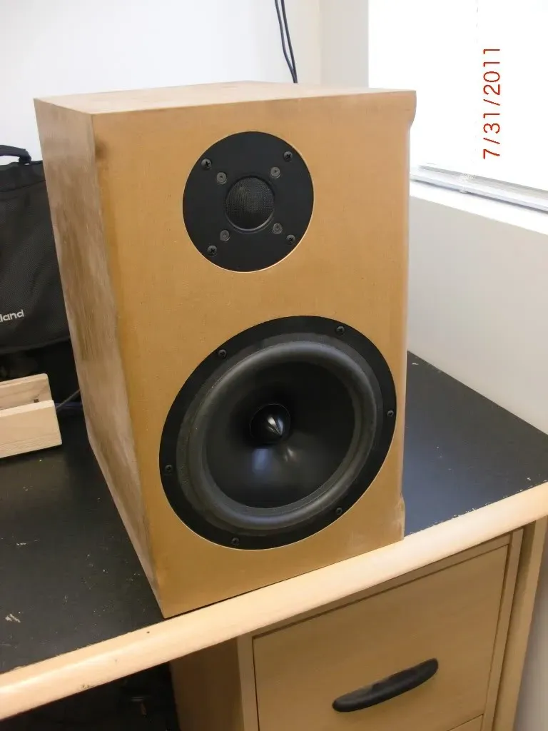

                                Got one enclosure wired up and playing.
                                I am so embarrassed that I am going to be having such amazing monitors as my surrounds. It is complete and total overkill and in my opinion maybe a waste of ability. Super clean. SUPER clean. No one should ever hesitate to build these. Ruler flat response. I am not exactly a fan of that type of eq but makes it easy to adapt. It is so easy on these to hear what was actually recorded in the studio by switching between different albums.
                                Most hip hop is recording trash. Sounds terrible on these. As soon as you put in something of a real music nature, not purely artifiical, they are UNBELIEVABLE. Just listening to one speaker I got goosebumps. Chills. I was moved. I may bring these to the meet for people to hear. The only negative is their size. Real big bookshelves.
                                I'll get an actual review up when I get the other one done tonight.

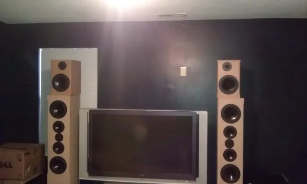

                                  So, have you finished the finishing on your Khans yet?
                                  Glad to hear you like them. One of these days, you should line them up all side by side, invite some people over and do a throwdown. Would love to see people's impressions of each.

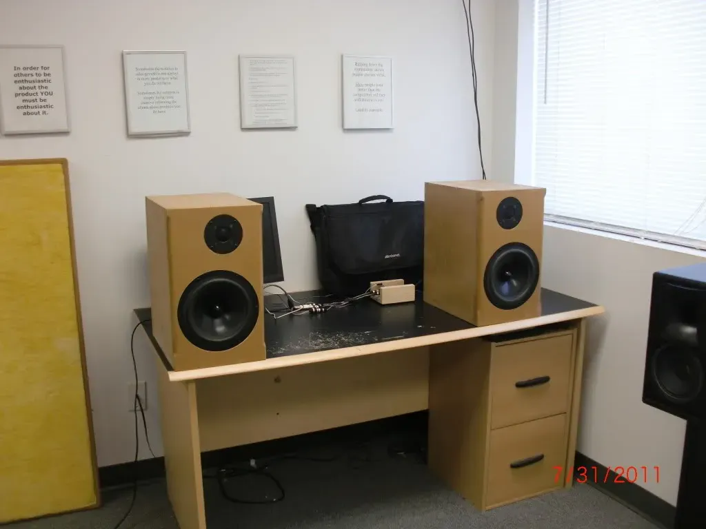

                                                Wrapped up the other loudspeaker last night, though couldn't really give them a thorough listening. Very quickly though, they have a very similar voicing to the Khanspires, but with some reallllly slight differences. I will double check these thoughts when I get to give them a thorough comparison. For my tastes, the Khan's edge out the RS22528A's by a small margin, and mostly due to the more capable ability to play the lower octaves. If crossed at an HT high pass, it would be a tough decision.
                                                The average listener would have a tough time distinguishing the differences between these and the Khans and I think the Dayton RS Center. Granted they are of the same drivers, but the crossovers are all a bit different.
                                                These are going to be some amazing surround speakers.
