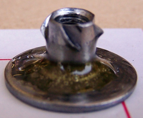

    You can probably use it as is. Put some gorilla glue or some other super epoxy around the outside edge of the hurricane or t-nut, then put it back into the hole as tight as you can and let it sit overnight. Once that epoxy cures they'll be stuck as good as possible.
    Like so:
    A guy here did a test a few years ago where he tried hurricane nuts and drilled various size holes, some holes the recommended size, some too big and some too small. Then he put gorilla glue on some and not on the others. The ones with gorilla glue held more weight even in the oversized holes than any of the ones without gorilla glue, even the ones which had been forced into the undersized holes.
    With the amp out it should be easy to force the hurricane nuts in either with a clamp through the hole, or by drawing them through with a bolt. Either way you'll want to put a piece of wood or something on the vinyl side so you don't mess up that nice work.
    Actually here is the hurricane nut evaluation thread if you want to read it. But I think this could save you from having to redo the baffle.

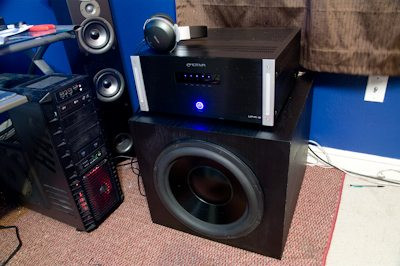

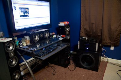

                  • thatguyyoulove
                    • Aug 2010
                    • 44
                    Here it is at my messy desk haha.
