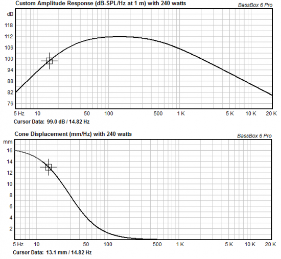

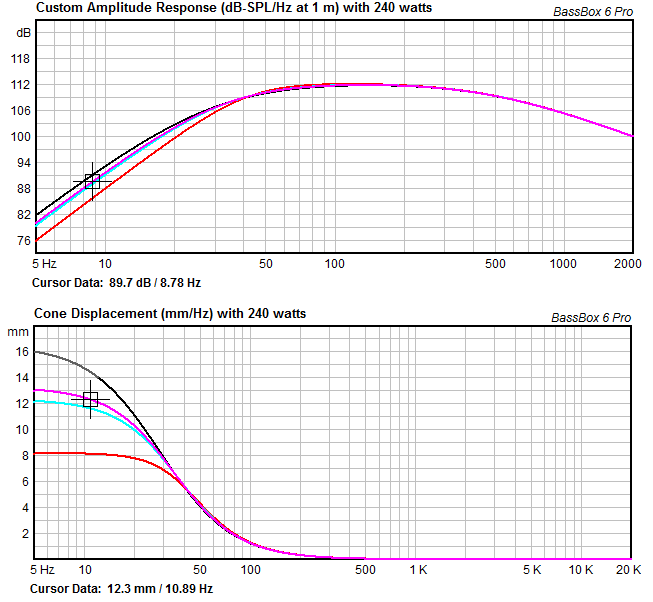

    Looking to build a sub for $400 or so to go with the RS Dynamic Series Jed is designing.
    I was thinking of pairing the RSS390HF-4 15"
    with the Dayton SA240
    in a 24" sealed cube (I can build the whole thing, with a double face and braces, with a single 4'x8' piece of 3/4" MDF for $30).
    Here is the graph (with a rough but close calculation of Vb after amp/brace is subtracted)
    xmax for this driver is 14mm. Should I worry about the xmax going over by 2mm at the very low end ? I had heard xmax + 10% was usually ok but this is slightly over that. Would keeping the volume down mitigate that when watching heavy LFE content? The sub will probably be turned down a good amount of the time. Are there any better drivers in the price range that I should look at? I thought about the Tempest-X2 but it kind of kills my budget. I'm not looking to create drywall cracking bass until I have a dedicated room. That being said I would like to see how much low end extension I can get back when I EQ with a little DRC(using convolver impulses and a PEQ).
    I'm mainly just looking to see if there is anything you guys may be able to point out that is a poor idea or that can be improved upon. I would like to order the parts this week so that I may have the box about done when they arrive. Also, what would you recommend for damping in the box?
    I plan on leaving this sub naked until I get the speakers done and then finishing them all at once. I'm assuming some speaker gasketing tape and screws will secure the amp well enough to keep a seal while still being easily removable later on?
    No problem, just ignore Xmax, and don't concern yourself with the amount of distortion being generated...

              Red - 18" cube
              Cyan - 20" cube
              Purple - 20.5" cube
              Black - 24" cube

                  Couple of things...

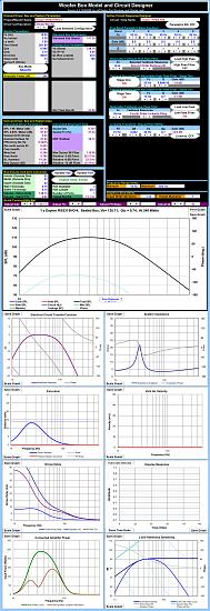

                  Down around 13-15 Hz is not a place where there will be lots of energy, in most music, though your movies will vary, and could have a lot. Real damage probably won't occur till the 20's of mm excursion, but you might not like the sound as much. Of course, LFE movie stuff doesn't have quite the hi-fidelity requirements of audiophile music listening... :W
                  The Dayton 240W amp has a high pass filter (infrasonic filter) that will limit the low end excursion somewhat. That will help protect the driver at the very low end. You will see that rising excursion slow down or even turn back around.
                  From the "Bass Boost" table on that amp: http://www.parts-express.com/pdf/300-804boost.pdf there's a filter with it's -3dB corner at 13 Hz. Not sure of the order, there used to be a technical review on that amp with more detail but I don't have it handy. Probably a 6 or 12db/oct slope. I'd suggest getting Jeff Bagby's excellent "Woofer, Box and Crossover Designer" spreadsheet (if you have Excel) and model it all out in that. http://audio.claub.net/software/jbabgy/jbagby.html
                  If you don't happen to have Excel, I think you can put a filter into the response in Bass Box.
                  Finally, I'd think more about what your box tuning Q will be, and try to aim for .707 or lower, for good damping. Off the top of my head, I seem to remember 3 cu ft was a reasonable volume for a sealed RSS390HF.
                  And Finally finally, the Dayton "speaker quality" foam tape is well worth it's slightly premium price. Much nicer than any weatherstripping you'll find at your local Lowes Depot or whatever. Great adhesive, firm material... Put it on the back of the driver and you'll be able to take it in and out as much as you want. For the amp, they do come with a thin gasket already on them.

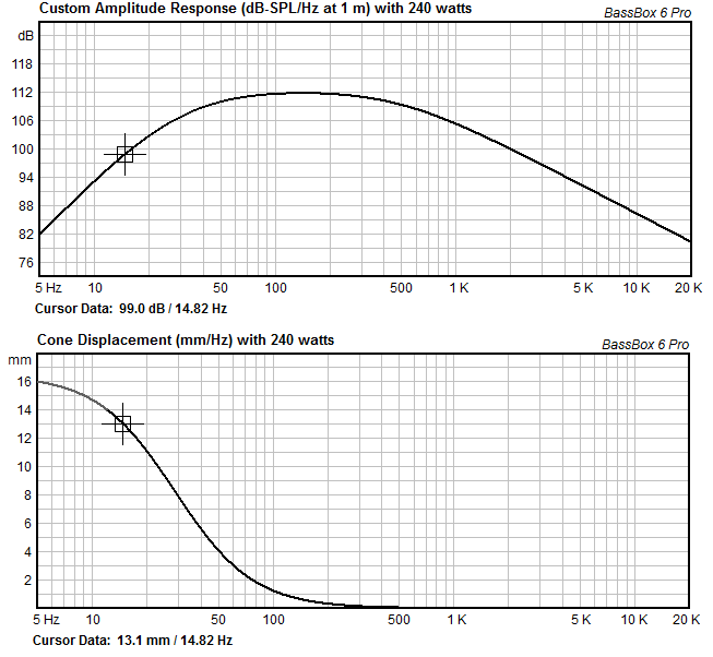

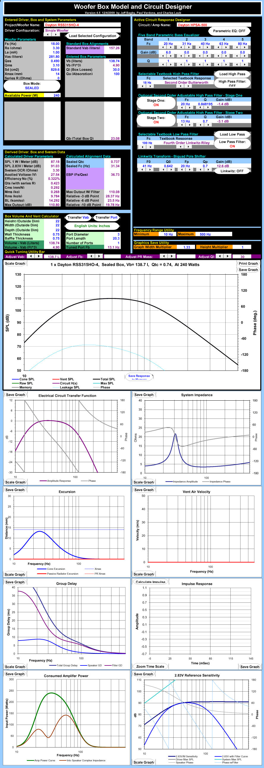

                          Jon, did I interpret the settings correctly for the subsonic filter? Ignore that the name at the top says HO and not HF. The settings are for the HF version.
                          *Warning large image*

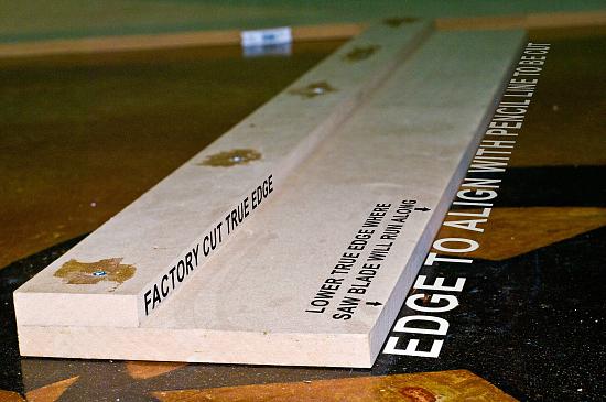

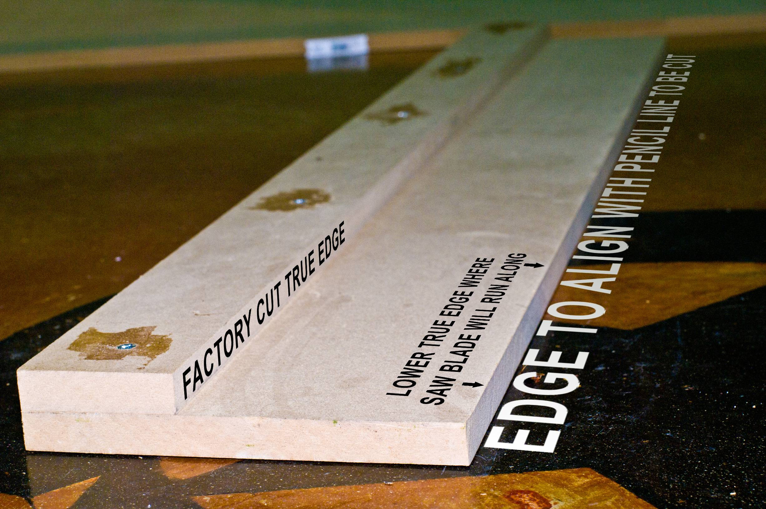

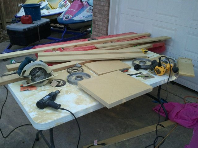

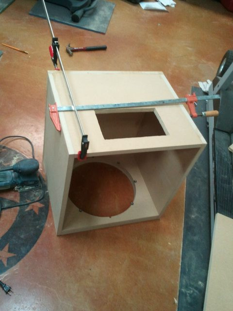

                                          I don't have a lot of woodworking experience and have made a couple mistakes already which prompted me buying another 4x8 sheet of MDF. The first issue was that I couldn't keep my jigsaw on the line I had drawn as I was using a piece of trim as a fence that flexed a bit in the center. Then the jigsaw blade twisted inside the tool itself so I switched to the big circular saw. Things went swimmingly here but my end results for the 2 squares I planned on gluing together as a front baffle were slightly off (probably by the width of the blade as I invariably cut from a different side somewhere). Then when I glued and clamped them anyway (thinking I could live with shaving 1/4" off each side and shrinking the whole design a smidge) I came back the next day to realize my two big clamps weren't enough and that the boards had hardened with a 3/32" gap on two corners.
                                          At this point I decided that I would try and come up with a more precise cutting system. With the new sheet of MDF I bought I made sure that the factory cut edges were all true. Since they were I cut a 3 inch strip, flipped it so that the true edge was now on the inside, and placed it on the edge of the MDF. I then put 5 small patches of epoxy (to hopefully prevent splintering) along the strip, made sure it was square with the perpendicular true edges of the main sheet, and drilled pilot holes followed by screws. I now had a true edged guide screwed square to my sheet. I then carefully put my circular saw against it and ran it down the length of the sheet. This gave me an exact mark as to where my blade would cut whenever I run it down the guide (as it will run right along the edge). In this way I Can set this guide on to whatever I need to cut and line the bottom edge (which is true as it was cut using a true edge as a guide) up with my pencil marks. Now when I run my saw along the upper true edge I know that the saw blade will run right along the lower true edge, cutting the line exactly. The only downside is that since the saw is riding on top of the lower board you lose 3/4" of cutting depth. Since my saw cuts deeper than 1.5" that won't be an issue here.
                                          Here is a picture to make things actually make sense visually.
                                          I am hoping to get things cut tomorrow. I only have two clamps that will fit this much wood. Since I would go crazy trying to wait 24 hours each time I glue a new board on would it be a good idea to line up the boards, glue them, square them, clamp them, drill pilot holes, screw them together, wait 30 minutes for the initial cure, and then move to the next piece? I plan to paint or veneer so I can always fill over the top of the screw with wood putty and sand down.
                                          • Bent
                                            • Sep 2003
                                            • 1573
                                            Do you have a router with a good flush-trim bit?
                                            If so, then inaccurate cuts will be a non-issue, just leave 1/8" overlap on the bigger piece of the but-joint and flush trim it with the router...
                                            Viola - perfect but joint on a leas-than-stellar cut.
                                            BTW - the saw DIY sawguide is also an excellent addition to a shop, but using 3/4" material is waaaayyyy overkill, and the fence you install on the platform will provide the first initial guide where you will establish the "edge" guide of the sawguide.
                                            EDIT: Nevermind, I re-read your post, and payed attention this time, 'looks like you're on top of it.

                                                You can also use wood screws (drywall screws work well) to help pull the but-joints together, then turn them out afterwords and fill the holes with filler.

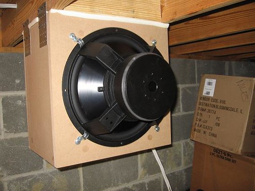

                                                  FWIW, I have an infinite baffle subwoofer with 4 of the RSS390HF subs (2 per manifold) and they are nothing short of stunning. Very low distortion. I've had many subs come through my house and this is the best I've ever heard. Clean, clean and clean. I've pushed them so hard it's not even funny and they keep asking for more. I would build as large of a sealed enclosure that you can, pair it with that SA240 amp and call it a day. You're worrying about too much. Just build it!
                                                  Monte Kay is a complete audio nut and used 24 of these in his dual dipole array subs. If they're good enough for Monte... :T
                                                  Be sure to check out the rest of his web site. Good stuff.

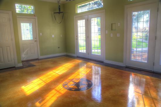

                                                    Click to enlarge.
                                                    Picture is obviously before we moved the furniture, TV, etc. back in.

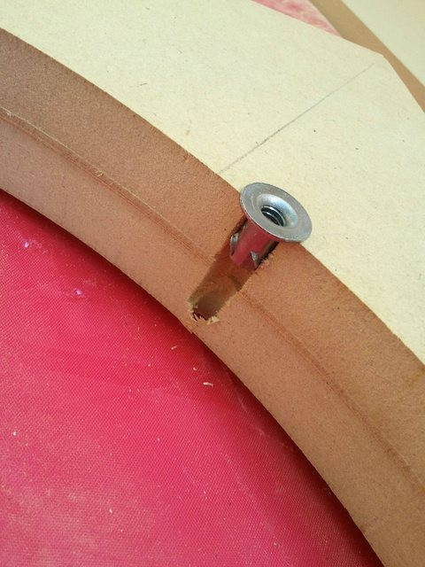

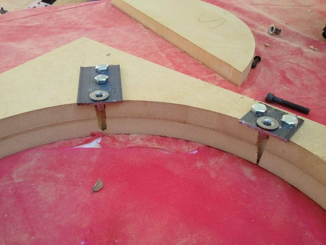

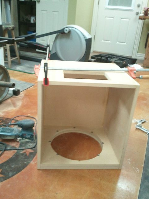

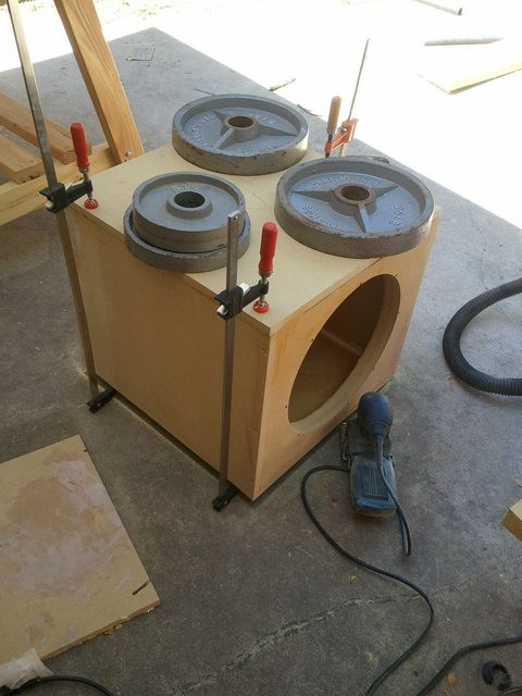

                                                              So after the failure of my first go at this project I nearly gave up on it. I was having a lot of issues keeping any things straight or square due to some flimsy aluminum saw guides that bent after a single pass and several failed attempts at cutting the first pieces. Before I knew it finals were here and I was constantly studying, working, raising my daughter, etc.
                                                              Almost a year later with the speakers and wood collecting dust I decided that I WILL FINISH THIS PROJECT. I got a stellar deal on a brand new router from a guy on Craigslist for only $120 (would be $200 retail). I rebuilt my saw guide with thinner MDF and it has worked out great. I cut out all the pieces over the course of several hours. Here is the first bit of them. You can see the baffle in the center and my saw guide behind it.
                                                              Click image for larger version  Name:	zYg5Hl.jpg Views:	4 Size:	86.9 KB ID:	935129

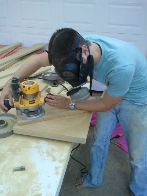

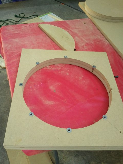

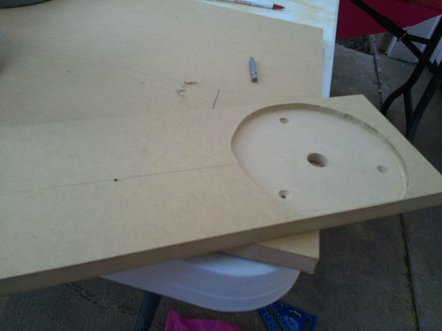

                                                              I then took one of the scrap pieces of MDF I had and made a circle jig for cutting out my driver hole.
                                                              ATTACH=JSON]{"alt":"Click image for larger version Name:\tGKXLMl.jpg Views:\t1 Size:\t45.6 KB ID:\t935130","data-align":"none","data-attachmentid":"935130","data-size":"full","title":"GKXLMl.jpg"}[/ATTACH]
                                                              A pic of me (with a NATO certified gas mask, a bit overkill I know haha) routing out the driver hole with my jig.
                                                              Click image for larger version  Name:	YXe4nl.jpg Views:	3 Size:	69.5 KB ID:	935131

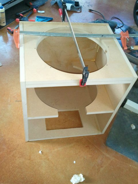

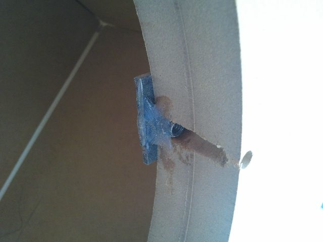

                                                              Here are most of the outer pieces being put together. The baffle is just dry fit in while I glue the back to the (already glued together by now) bottom and sides.
                                                              Click image for larger version  Name:	t3yfcl.jpg Views:	1 Size:	65.8 KB ID:	935132
                                                              Another shot. I actually accidentally glued my back piece in upside down without realizing it. I would prefer to have the controls lower so there isn't as much cord hanging down out of the back and the heat has more room to float up into the box and cool. I will just make sure that I fill in the few voids that were on the bottom piece (and made me choose to hide it under the sub) and flip the whole thing over (making it the top piece).
                                                              Click image for larger version  Name:	ohZGcl.jpg Views:	1 Size:	67.3 KB ID:	935133
                                                              I had another issue with the baffle. The driver hole was cut using the diameter from the spec sheet, but this cut into the screw path a bit so I had some hurricane nuts that wouldn't stay in as you can see. I tried to shift the whole circle slightly so only a couple were affected a lot versus all of them being affected moderately.
                                                              Click image for larger version  Name:	NsDDbl.jpg Views:	1 Size:	69.5 KB ID:	935134
                                                              A better look at the problem.
                                                              Click image for larger version  Name:	88TcTl.jpg Views:	1 Size:	80.4 KB ID:	935135
                                                              I bought a strip of iron and made a quick fix. Luckily this will be hidden inside the sub. I later added epoxy to the hurricane nuts so that they (hopefully) won't spin in place in the iron and I can actually screw the subs in. The epoxy is still curing currently.
                                                              Click image for larger version  Name:	CXJkvl.jpg Views:	1 Size:	74.9 KB ID:	935136
                                                              I made a couple braces to put midway in the box and routed out the same circle pattern for airflow. I then glued the baffle.
                                                              Click image for larger version  Name:	t6qMFl.jpg Views:	1 Size:	74.9 KB ID:	935137
                                                              I later decided that I just didn't quite trust glue only to hold the box together and put about 30 screws into the box. I drilled pilot holes to keep it from cracking since I was screwing into the .75" sides. I sunk all of the screw heads below the MDF (and ground down the stubborn ones that wouldn't sink that far) and started bondo'ing them tonight. I have a couple slight cracks (probably about 3/32 of an inch) that I will also be filling and am flush trimming any other niggling edges. I went ahead and caulked all of the interior edges that exist right now (four more will be created when I put the last piece on) so that I don't have to do it ALL through the driver hole later. That should cure overnight.
                                                              To-do list:
                                                              1. Glue on last piece
                                                              2. Flush trim everything
                                                              3. Bondo any holes/imperfections
                                                              4. Sand it smooth
                                                              5. Caulk rest of interior
                                                              6. Attach amp and driver
                                                              7. First test (WOOHOO)!
                                                              8. Disassemble driver/amp
                                                              9. Add feet
                                                              10. Apply fiberglass
                                                              11. Clean whole box
                                                              12. Apply vinyl
                                                              13. Final assembly
                                                              14. Connect to main system
                                                              15. EQ entire system
                                                              16. Enjoy!
                                                              As for budget, well, I'm pretty sure I'm way over $400 so far with all of the tools/epoxy/bondo/adhesive spray/fiberglass/etc. that I had to buy. Though, I will have a lot leftover for more projects later.
                                                              Last edited by theSven; 03 May 2023, 19:16 Wednesday. Reason: Update image location
                                                              • evilskillit
                                                                • 468
                                                                A few things, first of all congratulations on following through on the project, you're going to love a having a sub. You never know what you were missing but once you build it you'll wonder how you lived without it.
                                                                As for adding the screws, glue joints in MDF are stronger than the MDF themselves so adding screws doesn't add any strength; but don't worry I still used screws on my first build anyways too. It can speed things up if you use the screws to hold the mdf while the glue dries but otherwise no screws is better.
                                                                I seem to have missed it in the thread; you got the BASH 300 amp (thats what I use) but what sub driver did you end up going with?
                                                                Lastly, I've gone way over every budget I've ever set if you include the cost of tools, but the knowledge gained and ability to do other home improvement projects and fixes and becoming indispensable to your friends is really priceless, so write those costs off in your head and keep up the good work.
                                                                  Looks pretty good. The last two times I got a MDF dust in my sinuses, I got a full blown cold immediately afterward. MDF dust in the eyes isn't much fun either.

                                                                  • thatguyyoulove
                                                                    • Aug 2010
                                                                    • 44
                                                                    I settled on the Dayton 15" High Fidelity ( http://www.parts-express.com/pe/show...number=295-468 ). And yes, I am very glad to have the tools for other projects I lucked out and noticed a clearance deal at Home depot last year where they were liquidating VERY nice pre-cut pine panels (24"x48") for $7 a piece (they were $30+ retail) and plan to use them to make a nice toychest for my daughter. The router and saw will be used extensively so I'm happy
                                                                    Sounds terrible. My arms were getting coated in the dust and it just made me itchy. Plus the stuff is around 9% urea formaldehyde which is nasty stuff.

                                                                      Here is a shot of the fixed hurricane nuts with the epoxy. A bit ghetto, yes?
                                                                      Click image for larger version  Name:	CNz9Xl.jpg Views:	3 Size:	37.0 KB ID:	935138
                                                                      I also finally have the last piece glued in now. Unfortunately just about every side is slightly off, but Bondo can fix it up!
                                                                      Click image for larger version  Name:	UHqMSl.jpg Views:	2 Size:	76.1 KB ID:	935139
