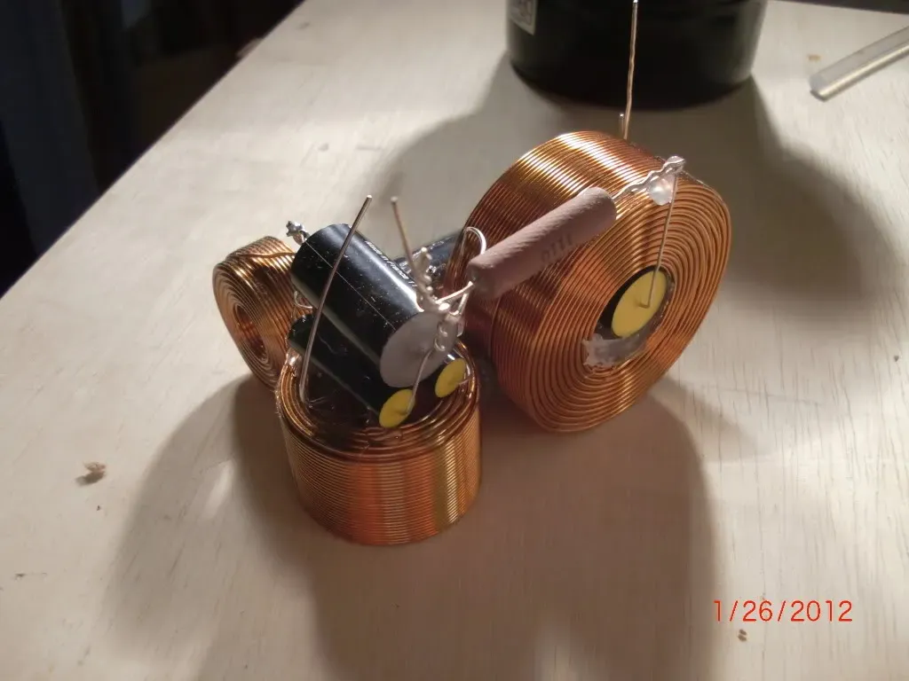

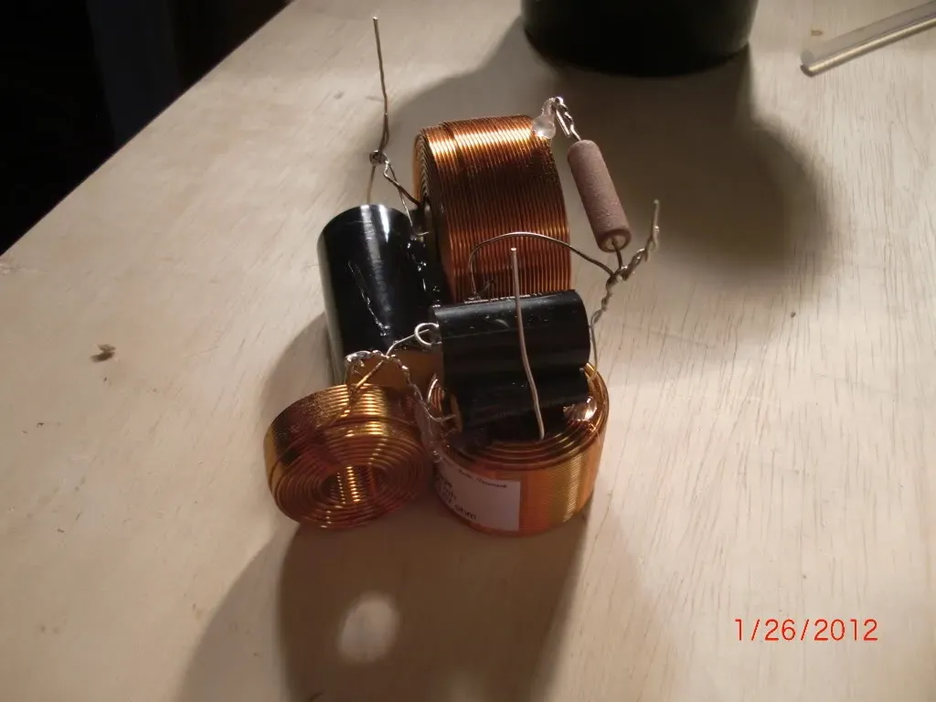

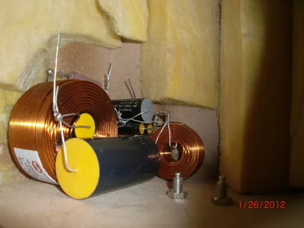

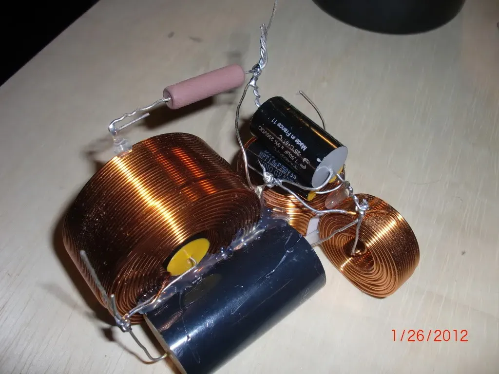

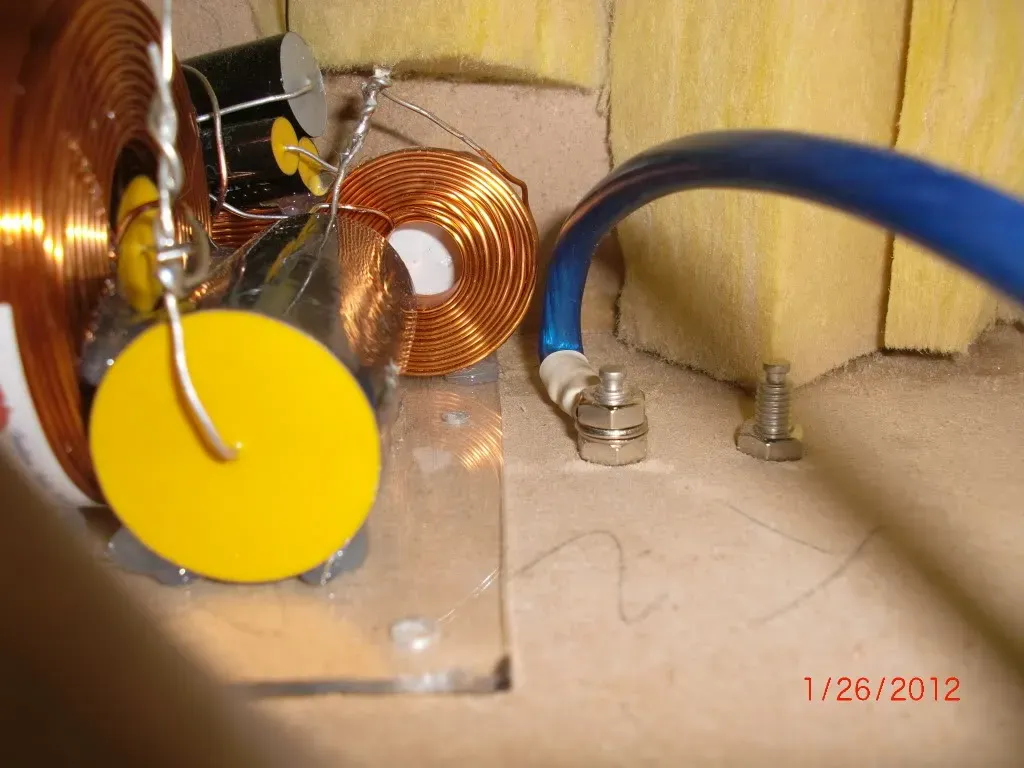

                                3 dimensional crossover stacking ... I like it
                                Doesn't a capacitor inside an inductor increase the inductance btw?
                                • joeybutts
                                  • 476
                                  #151
                                  Thanks! :T
                                  I've been told that no real measurements to date have shown either way that a cap in an inductor effects the inductance. I've done it on a couple projects and a few well regarded people in the PE forum have as well.
                                  I probably will never know the difference if there is.

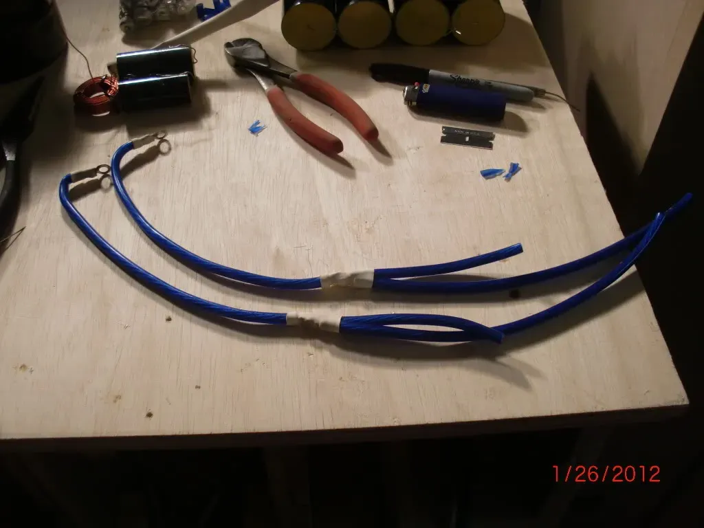

                                                                        Soldering 8 awg is a PITA!!!!

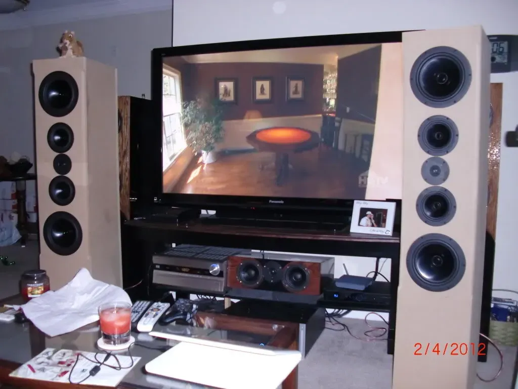

                                                                        These........are unbelievable. I wish the wife would leave. So I can really open them up!!! I've got unbelievable goosebumps. I was really nervous how these would compare to my Dayton 8's and that I wouldn't think they were any better. BWHAHAHAHHAHAHA. I am so dumb.
                                                                        These are so open and......refreshing. I know some of you are going to get the mob after me for saying this, but even dubstep sounds amazing.
                                                                        I listened to a few crooners and a few bands. I can't get enough. Even the wife, when I explained what "open" meant was astonished and in agreement. I know Ryan says these won't play too low, but they do an amazing job without a subwoofer. On music of course.
                                                                        These were well worth the time. Now to make them look as nice as they sound and get them into the man cave to let them really sing! :T

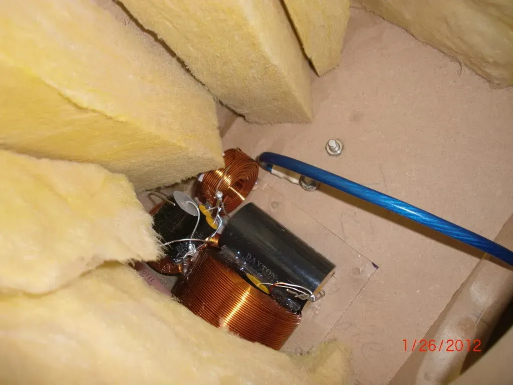

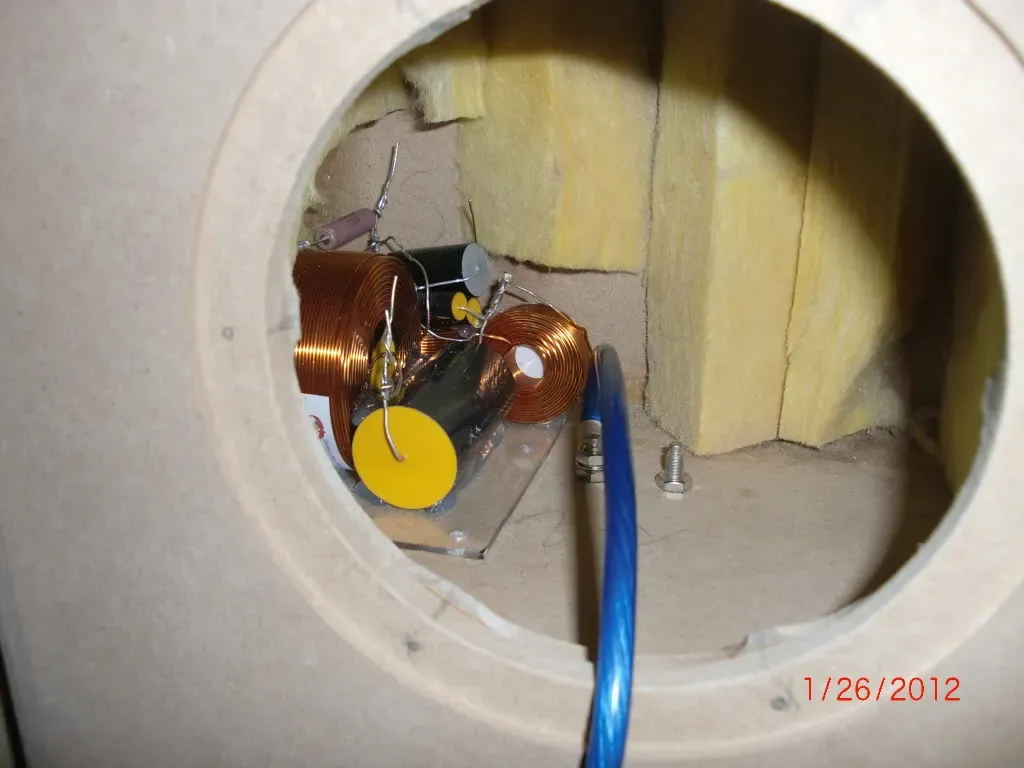

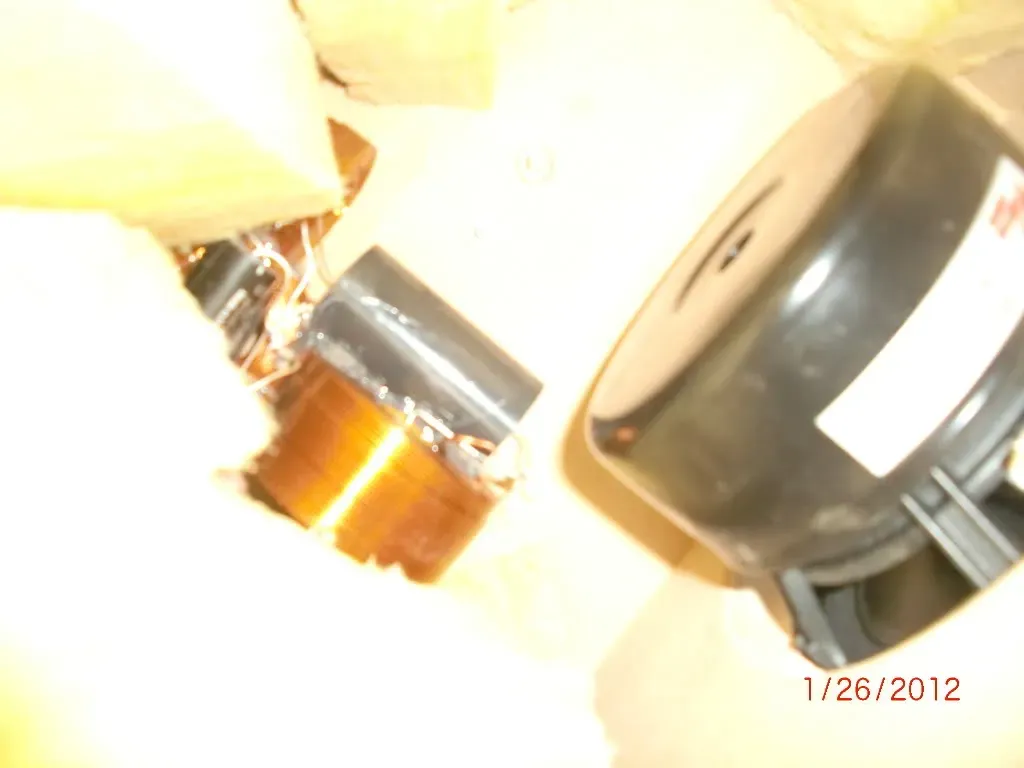

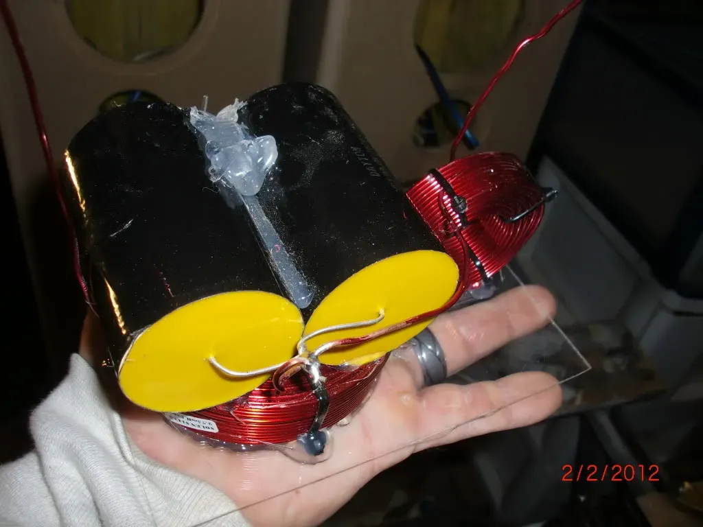

                                                                          Woofer crossover- I can't believe the size of this inductor.

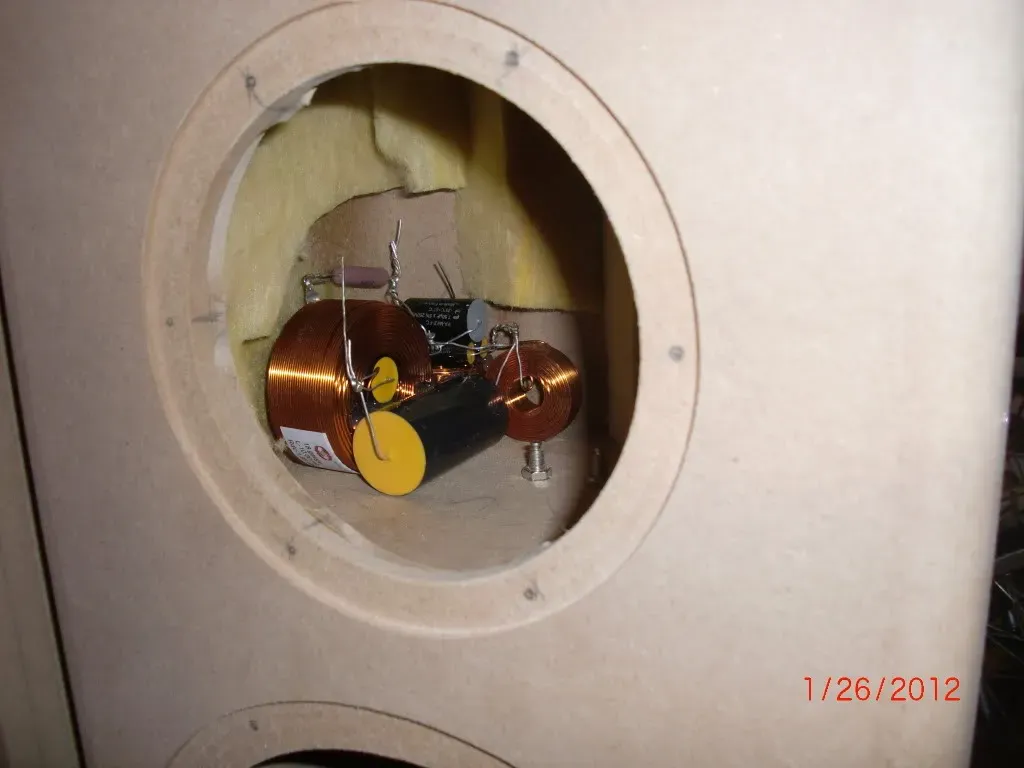

                                                                          Crossovers loaded and fully wired!

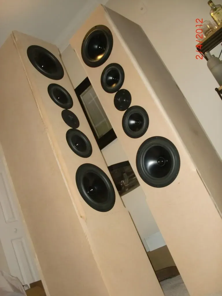

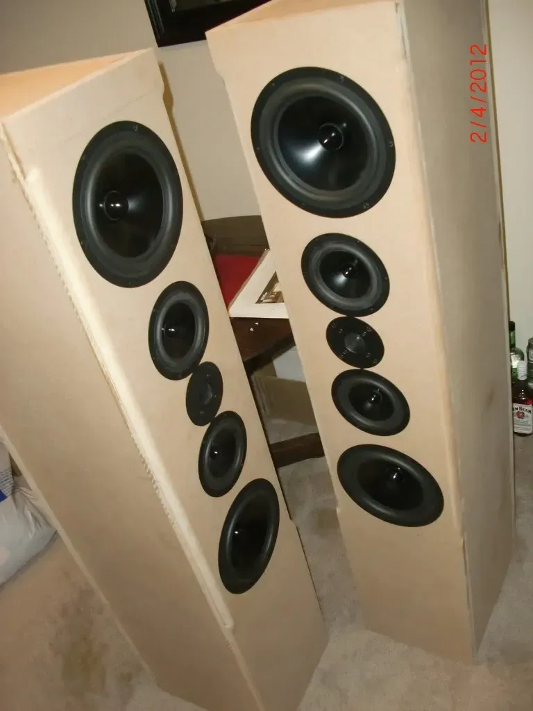

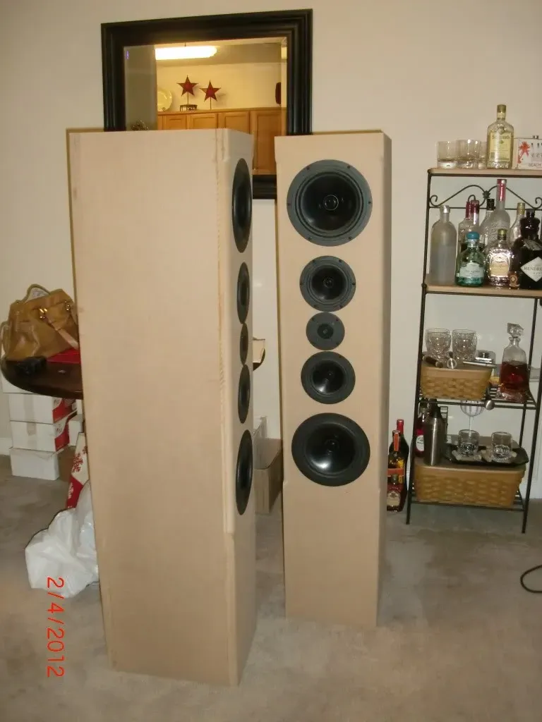

                                                                          Loaded!!!! Sorry you have to see my hideous sweater. :P I was so excited didn't even realize I was shirtless!

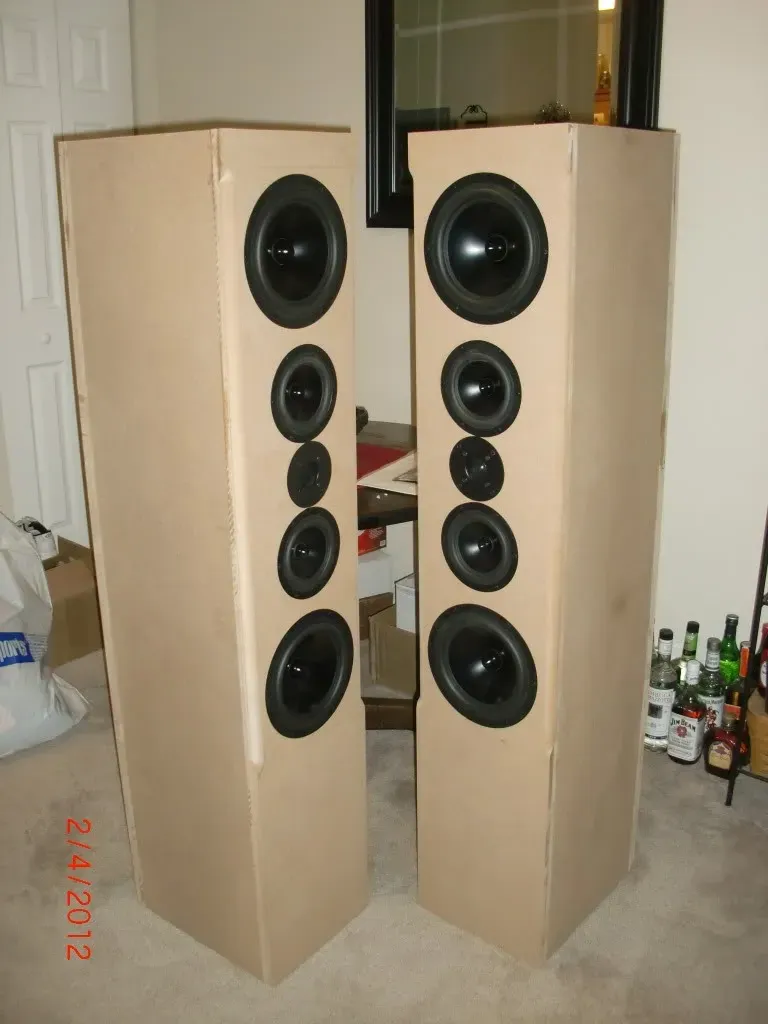

                                                                          Both done!

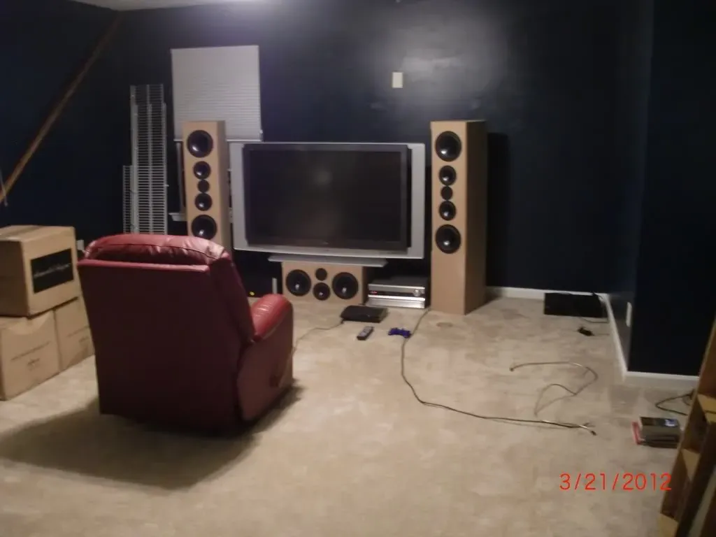

                                                                                      #177
                                                                                      Have had some time with these and a lot of different music and I haven't driven them to a level of noticeable distortion. These sound INSANELY good. Poorly recorded sticks out a bit. Love the clarity, depth and impact. the impact, oh the impact. Love it.
                                                                                      Can't wait to get these in the new space and with some acoustic treatments. Should be sexy on the ears.
                                                                                        #178
                                                                                        Glad to hear that you're enjoying them. I'm looking forward to seeing your finish ... if you can ever bring yourself to take them apart to do the finish. :P
                                                                                        • joeybutts
                                                                                          • 476
                                                                                          #179
                                                                                          Yes...putting the drivers in was the STUPIDEST thing ever. :T These are never going to get finished!
                                                                                          • joeybutts
                                                                                            • 476

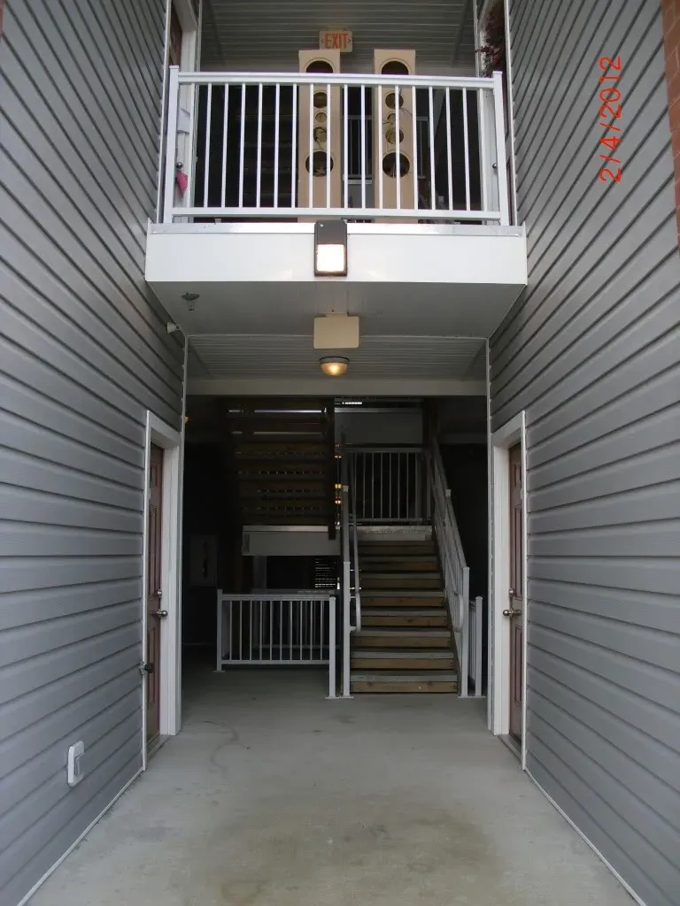

                                                                                            #180
                                                                                            in their new home waiting for some fresh duds! Amazing. Building these was the best idea ever. Almost time to start focusing on the Man Room.
