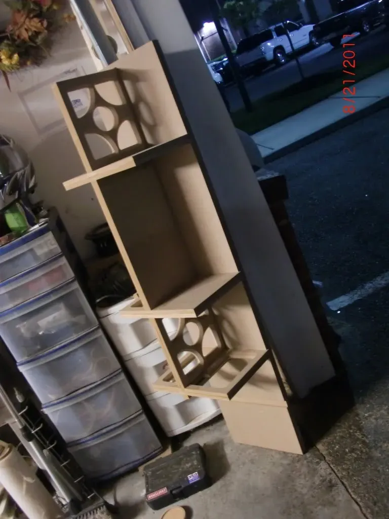

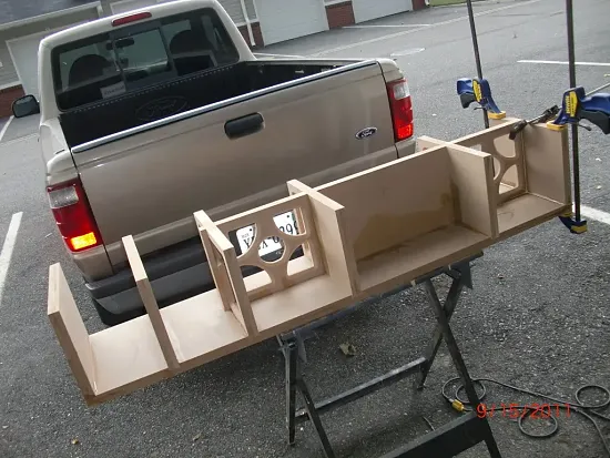

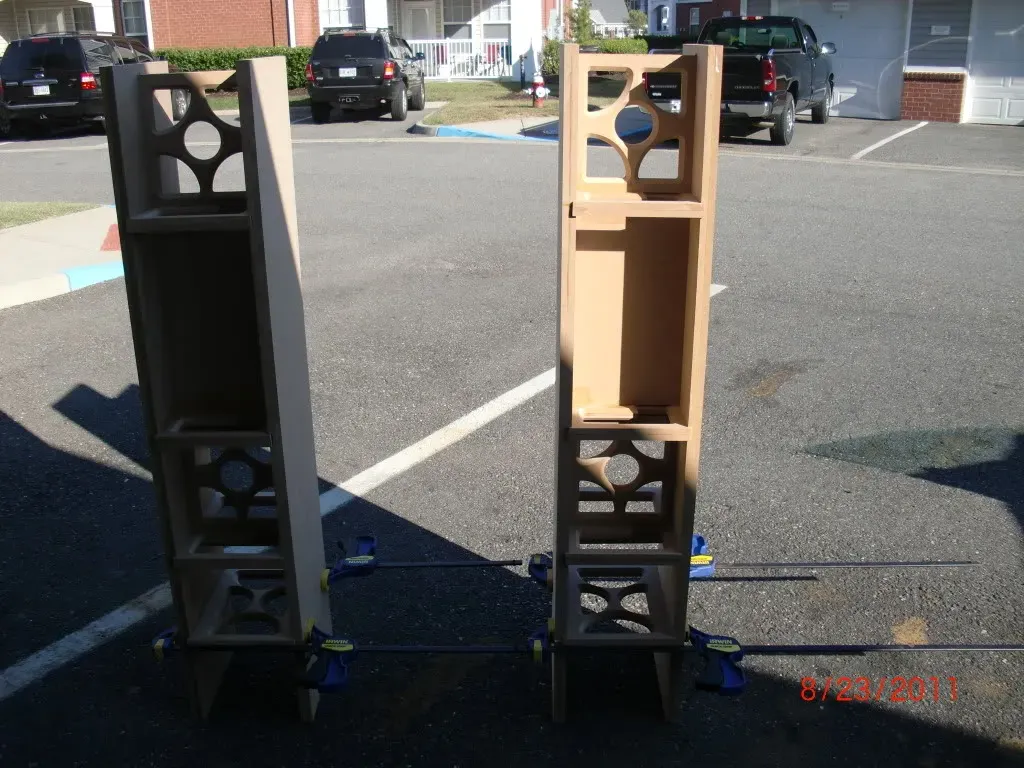

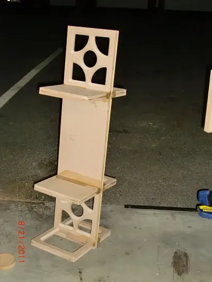

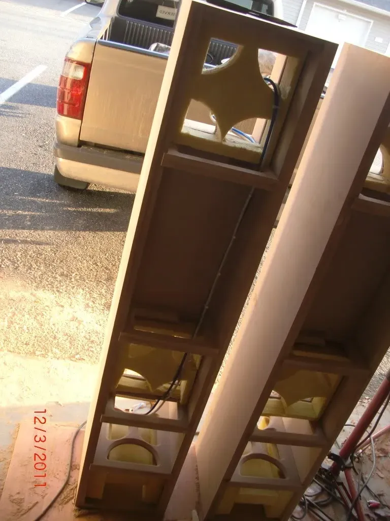

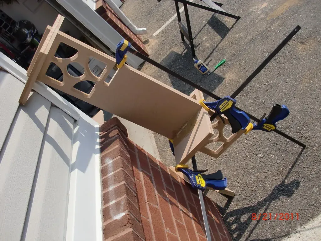

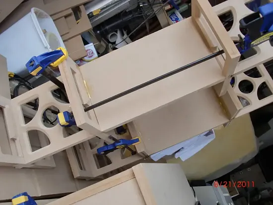

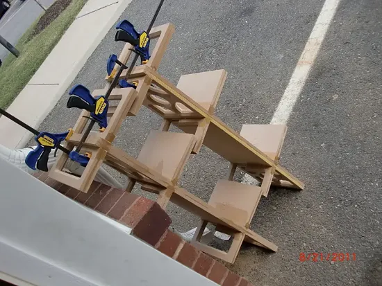

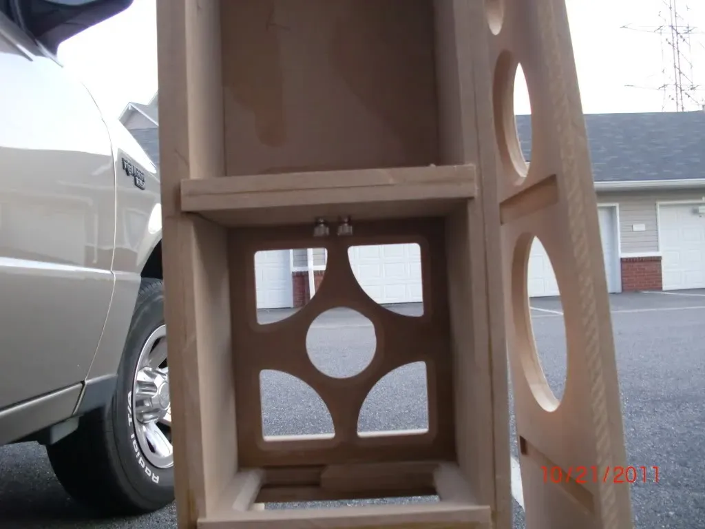

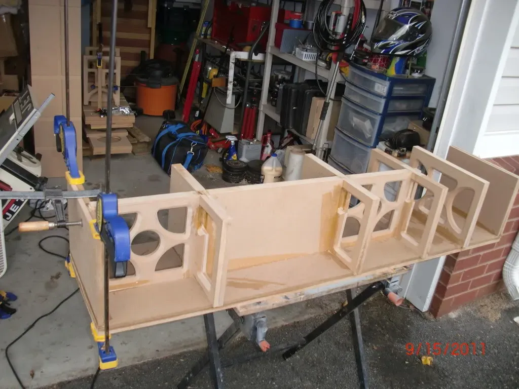

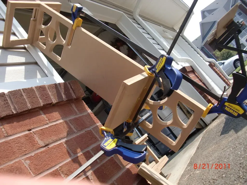

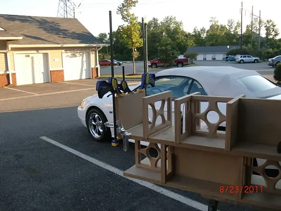

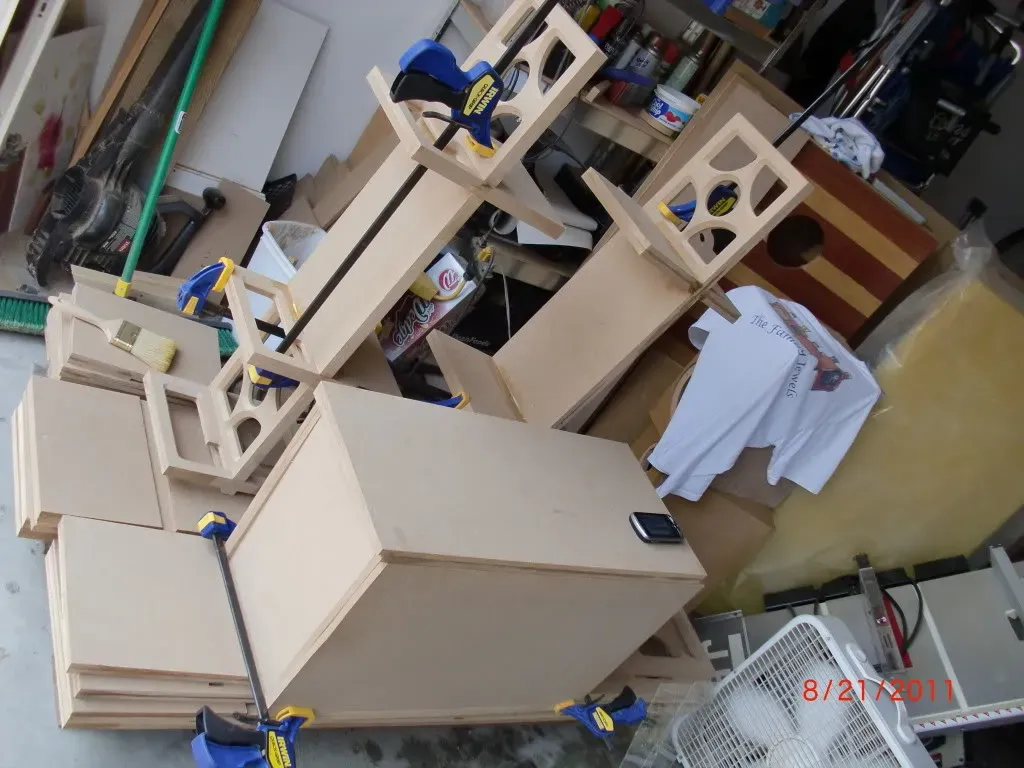

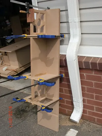

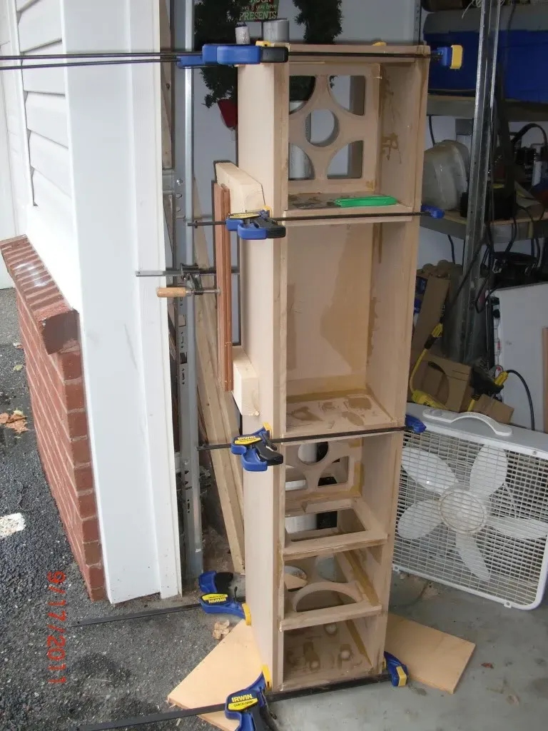

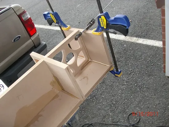

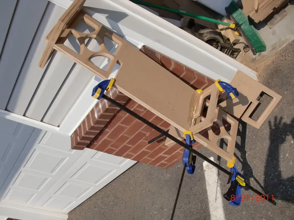

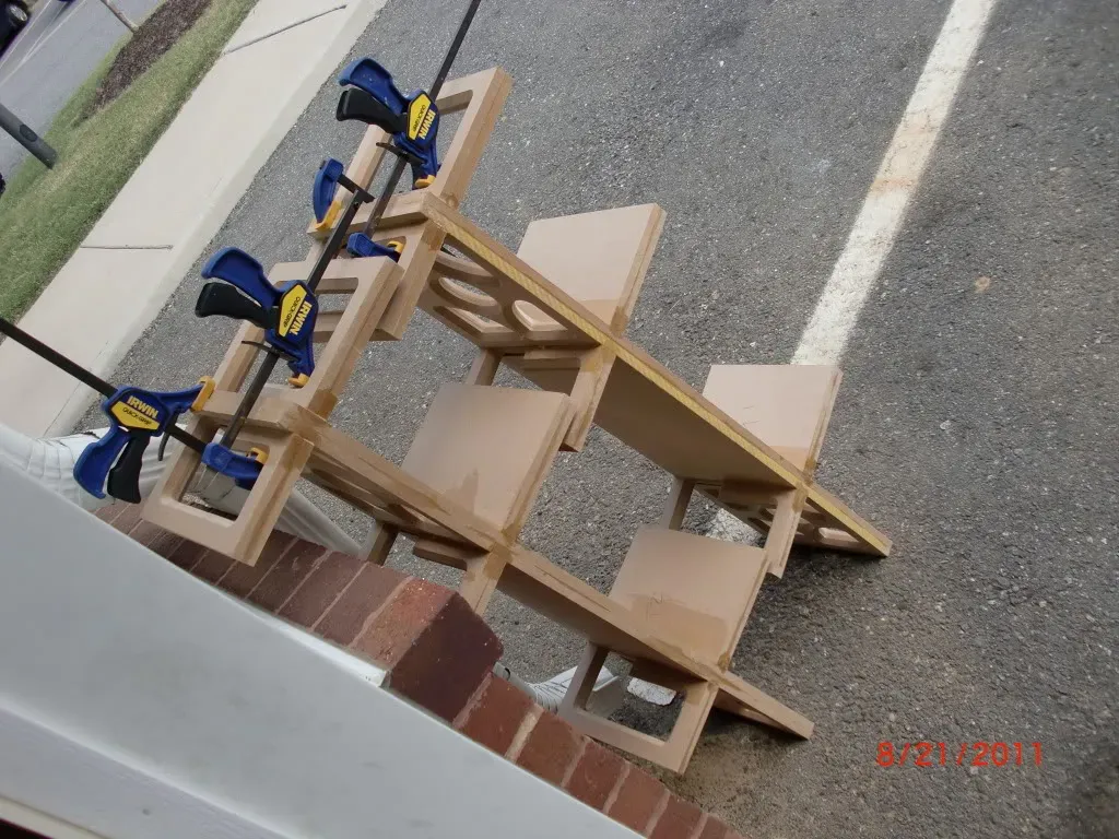

          Top brace/mid enclosure glued.

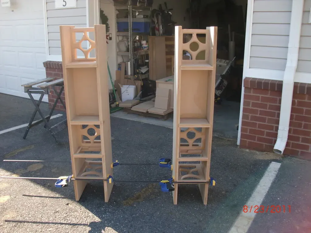

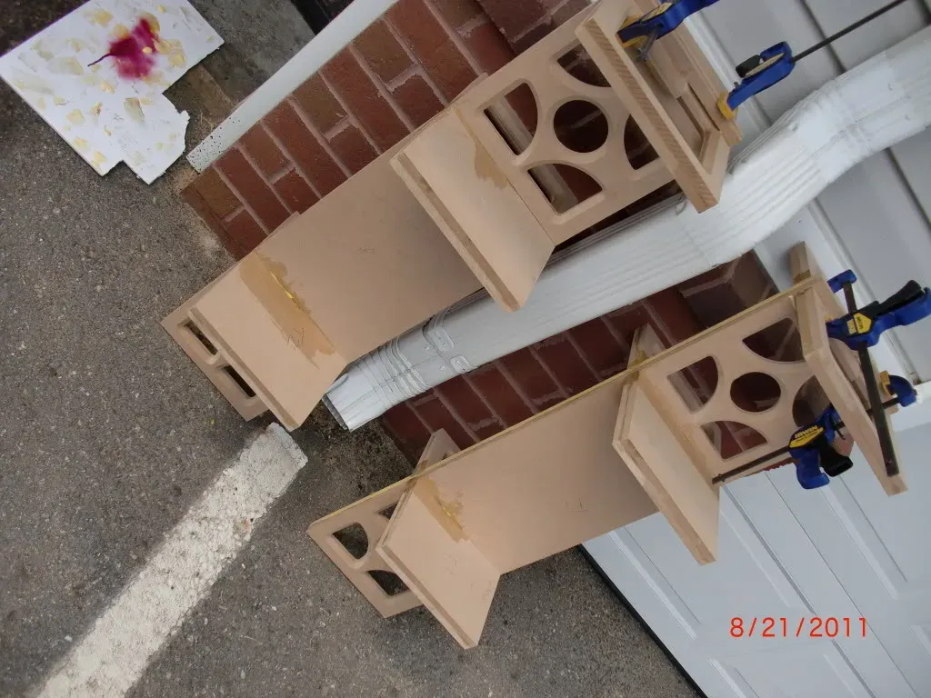

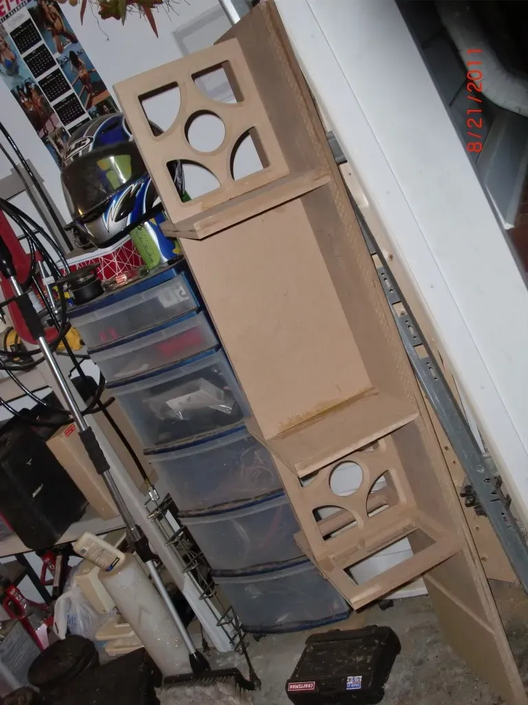

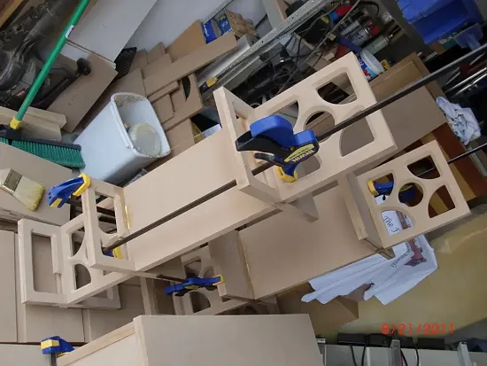

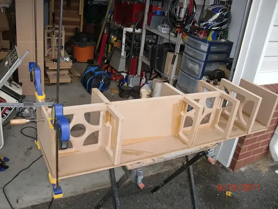

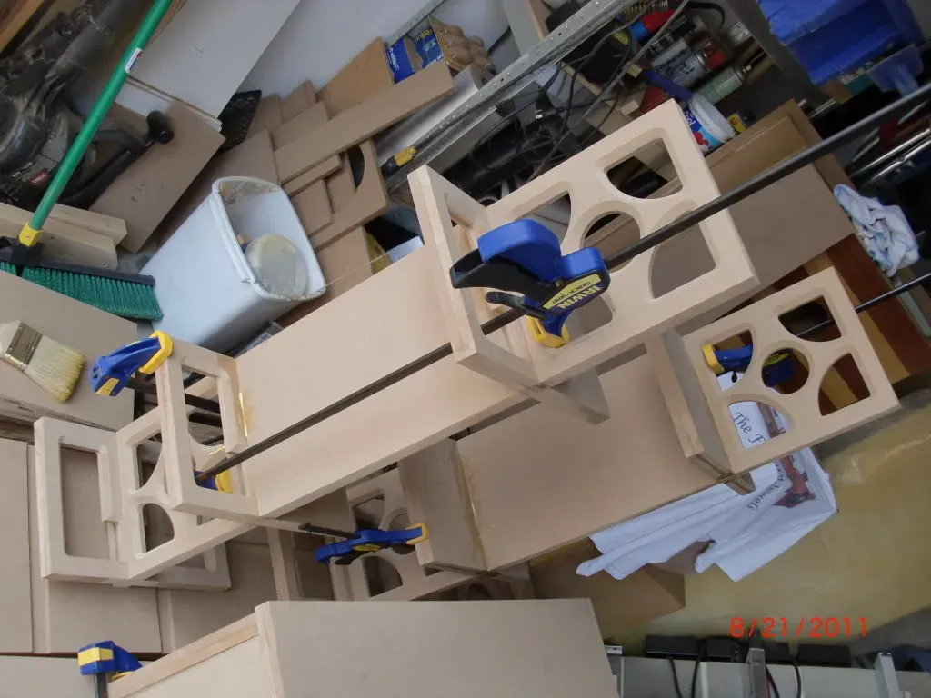

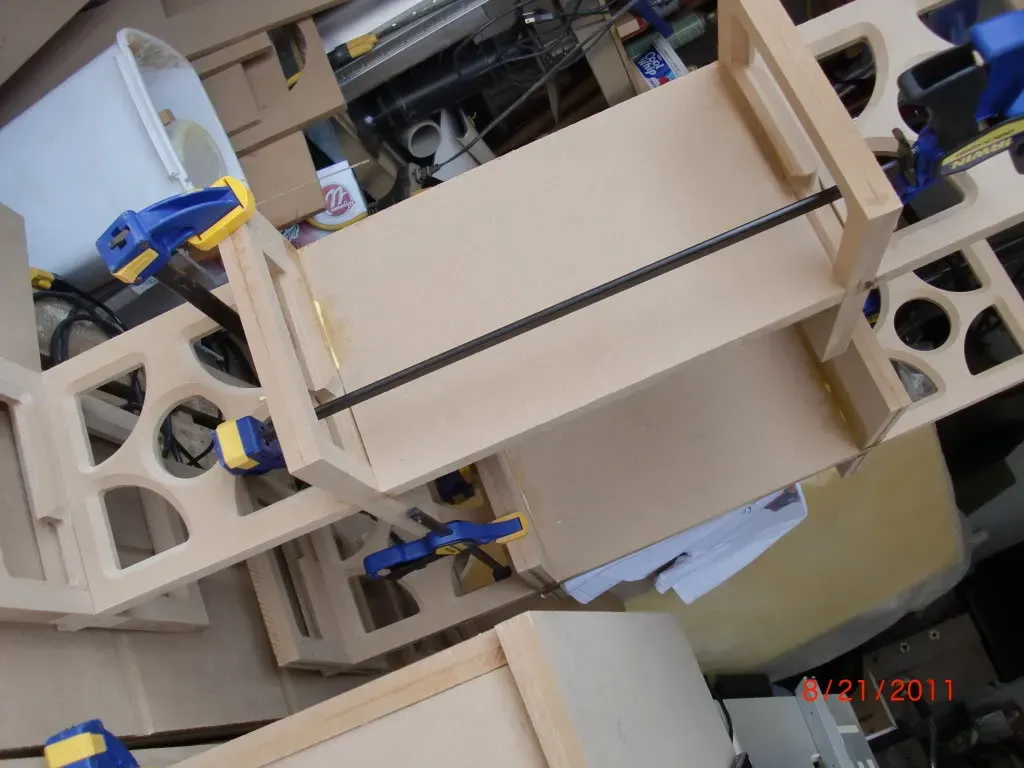

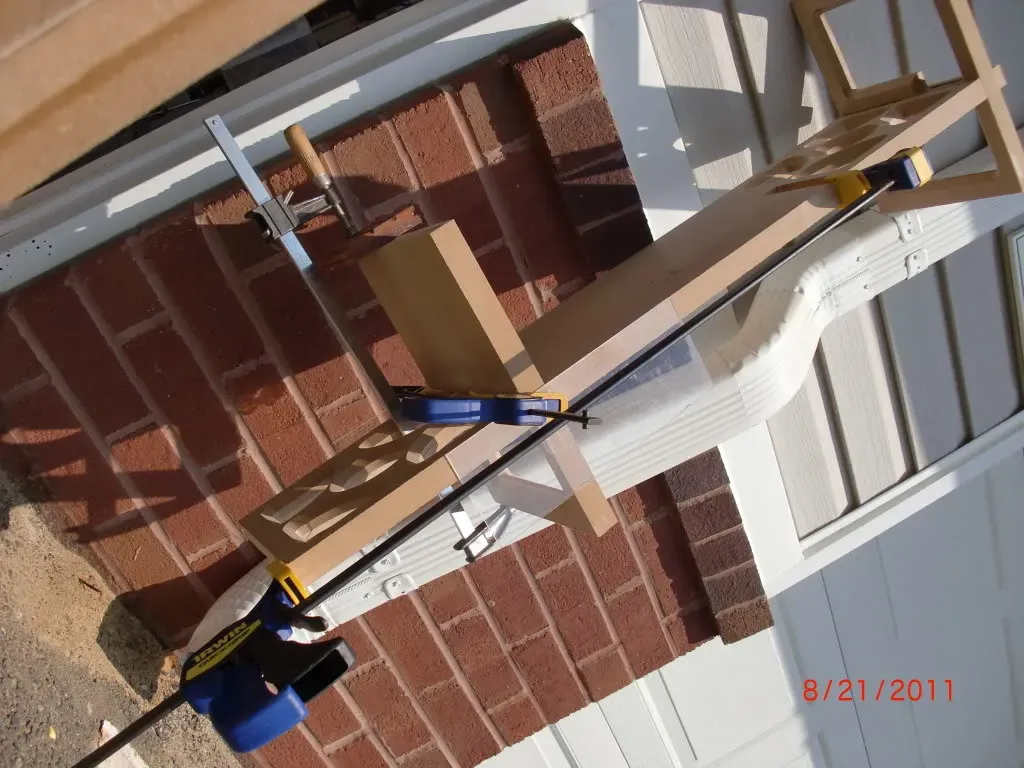

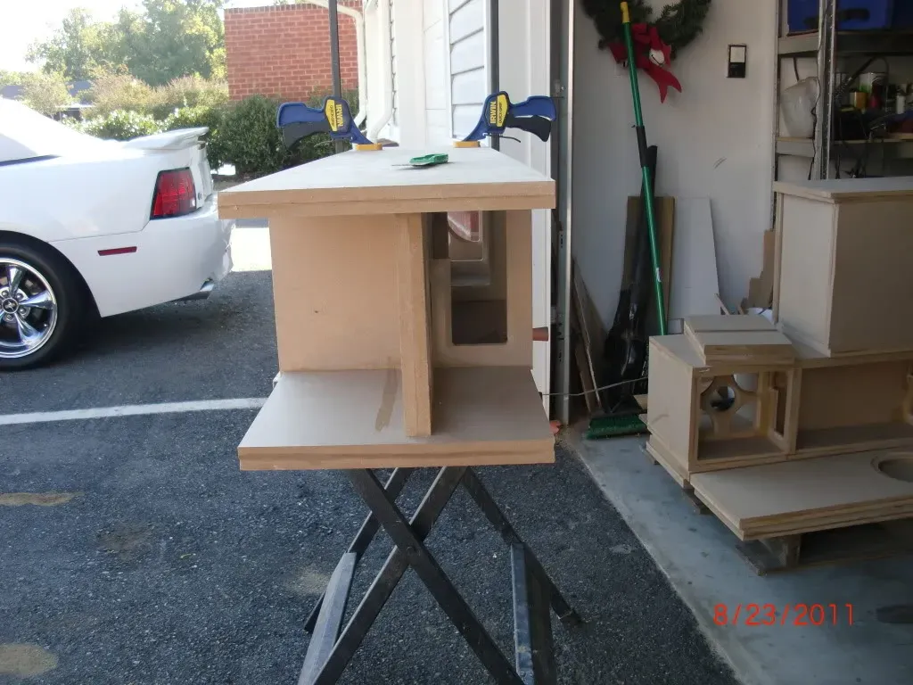

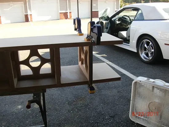

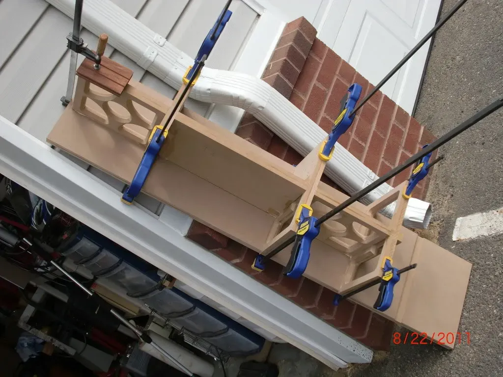

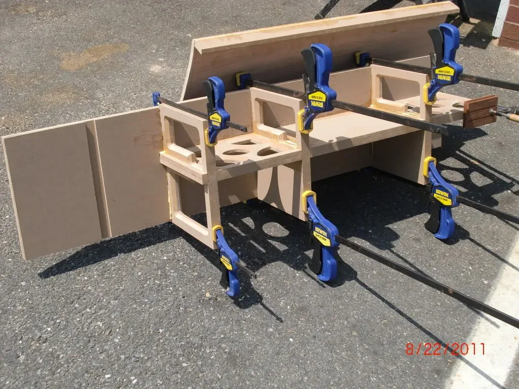

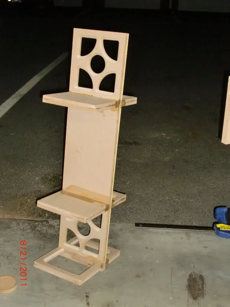

          Mid brace/bottom of mid enclosure glued.

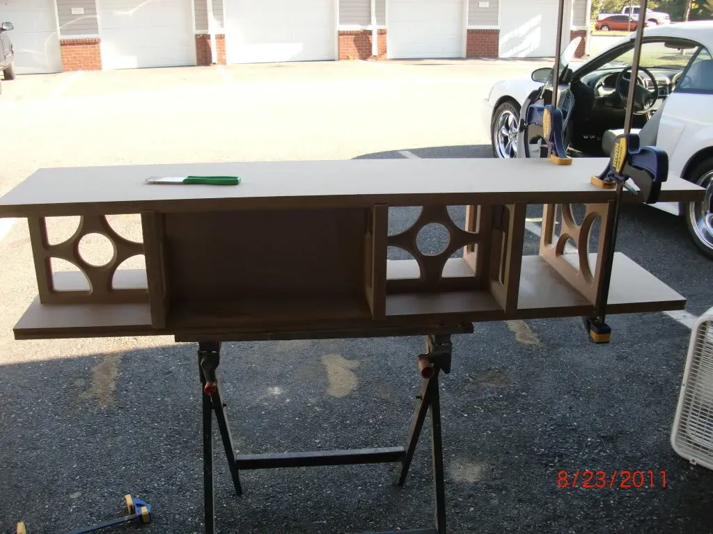

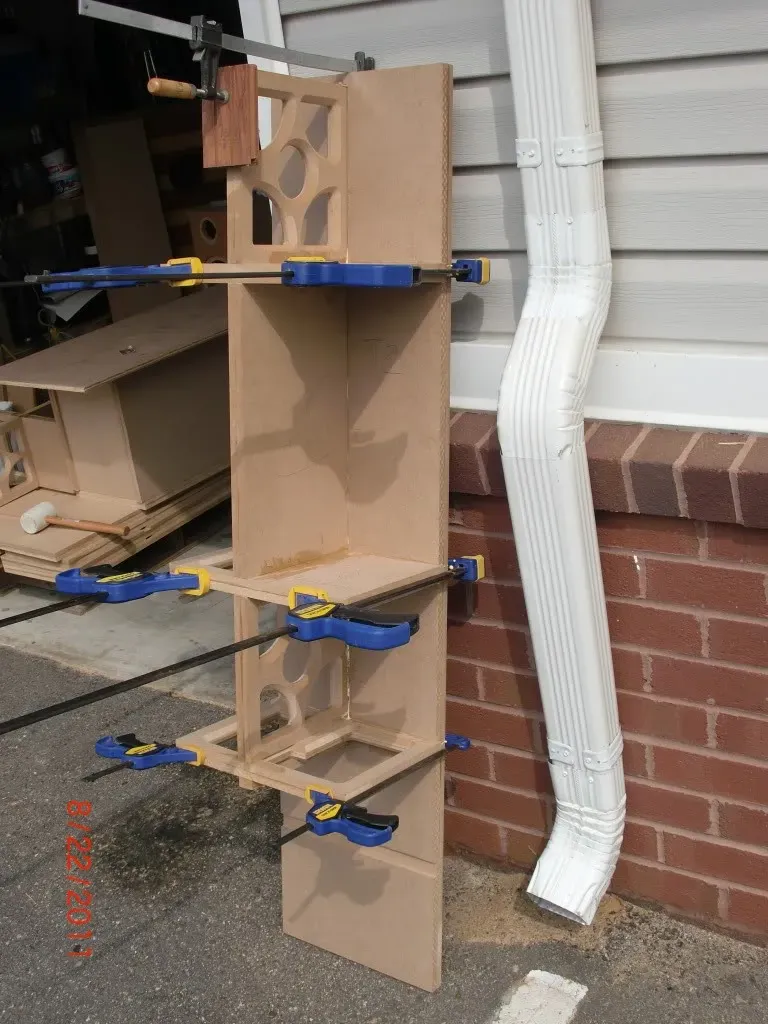

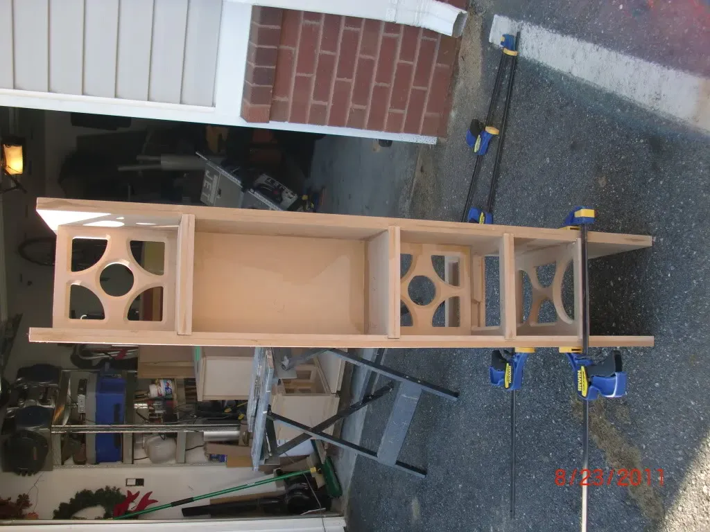

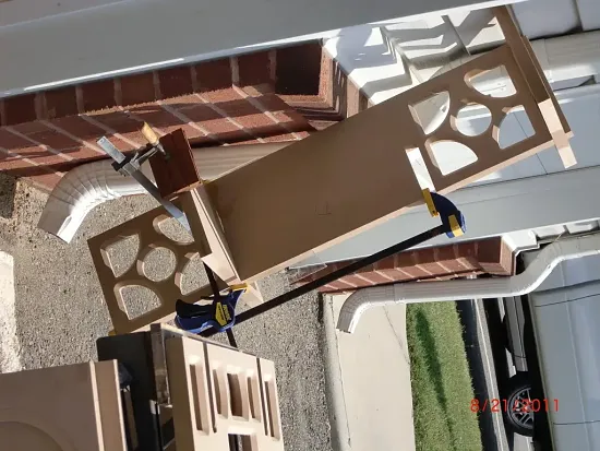

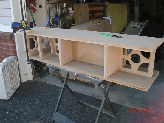

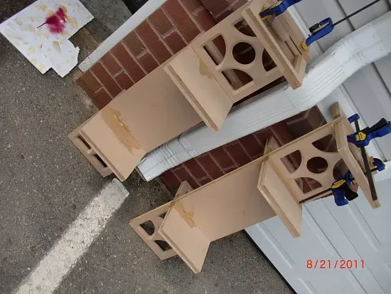

          Bottom brace glued!

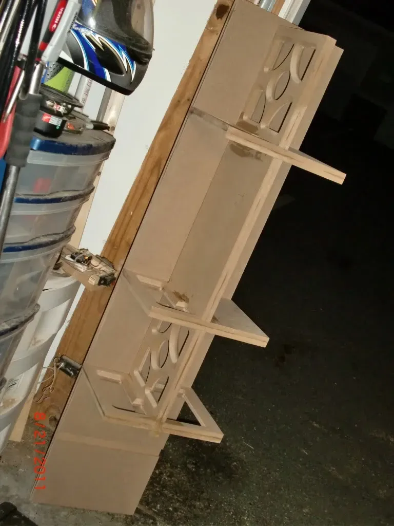

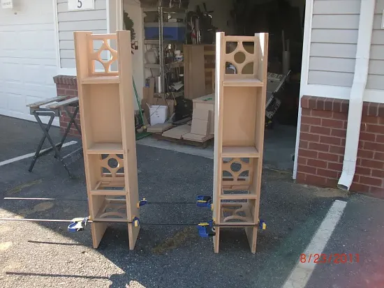

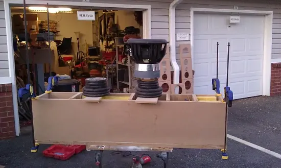

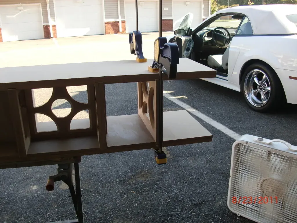

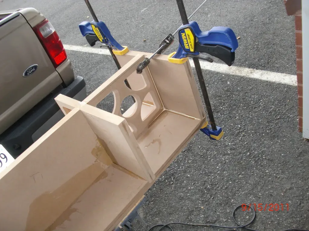

          All interwoven bracing glued and dried.

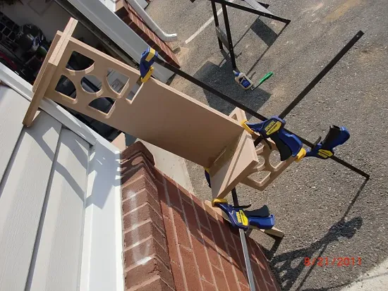

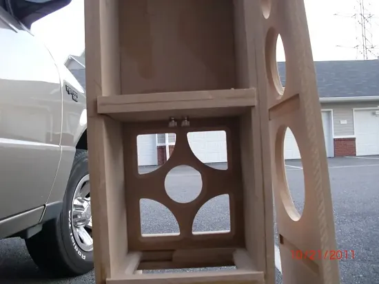

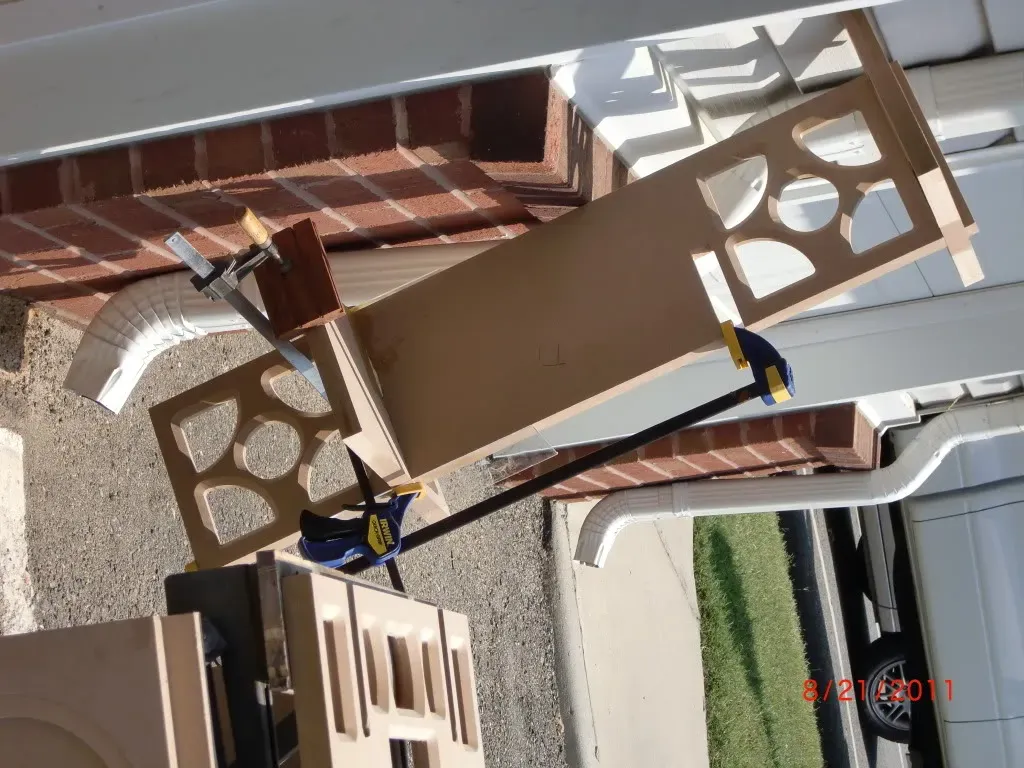

          Nice fit on the inset side panel
          Starting to get back on this build has me pretty excited to see it finally come together.

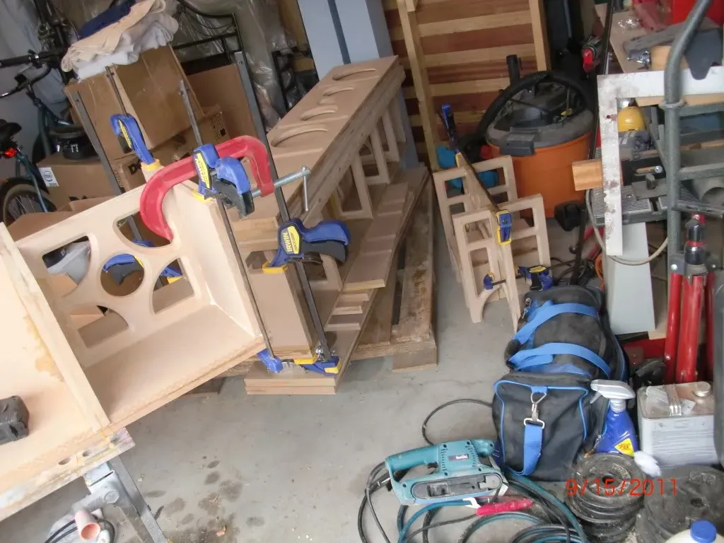

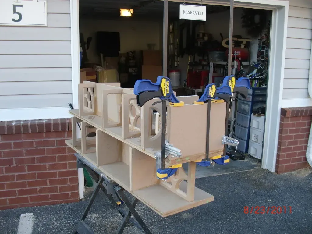

                    #99

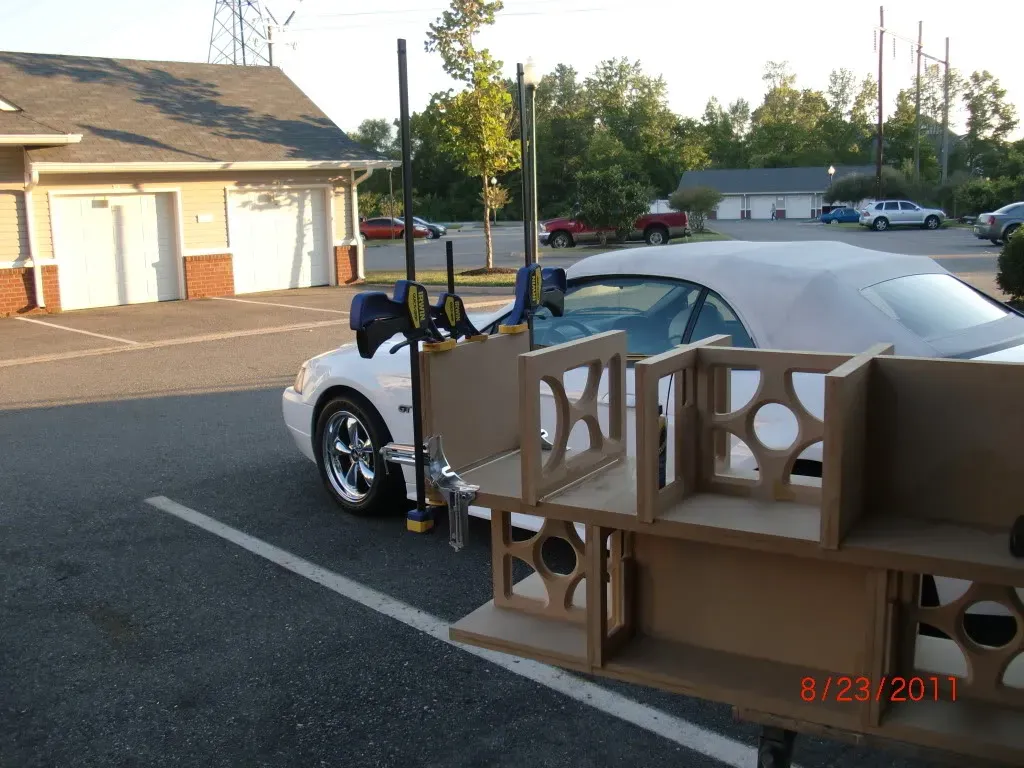

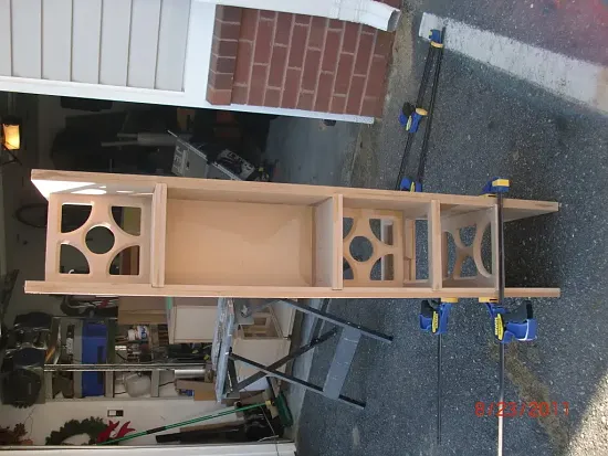

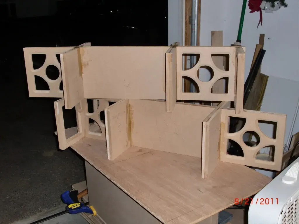

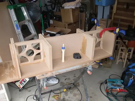

                    Different angles of the gluing

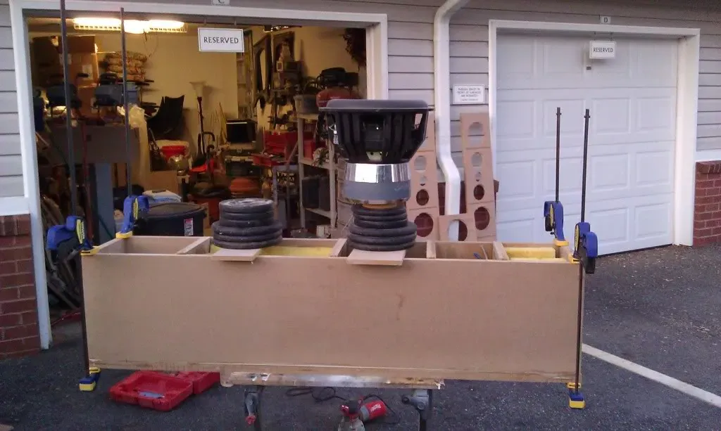

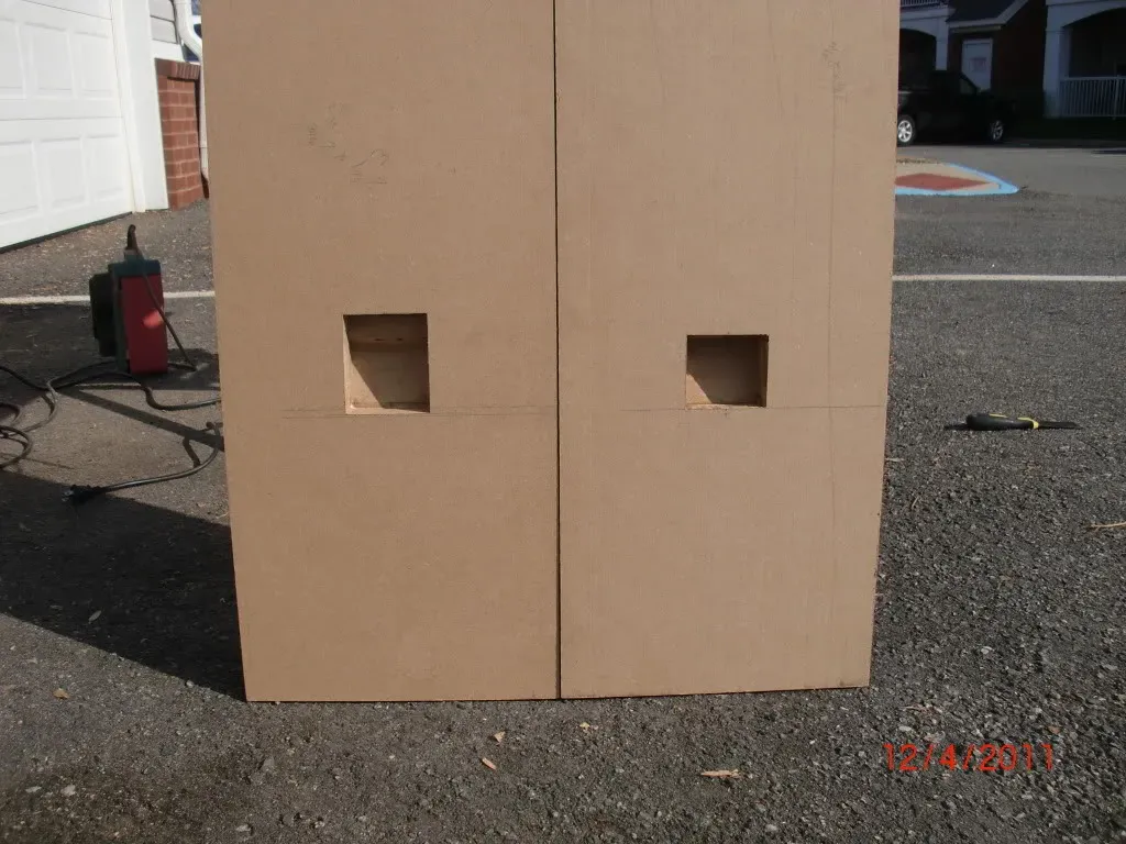

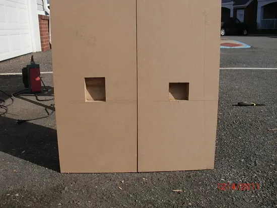

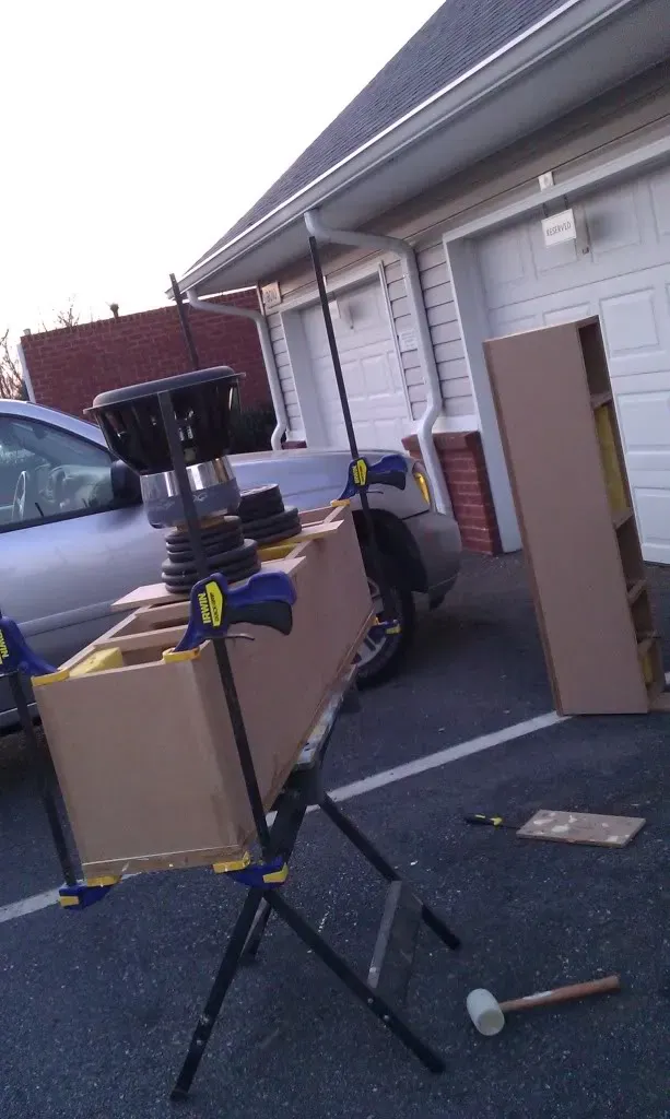

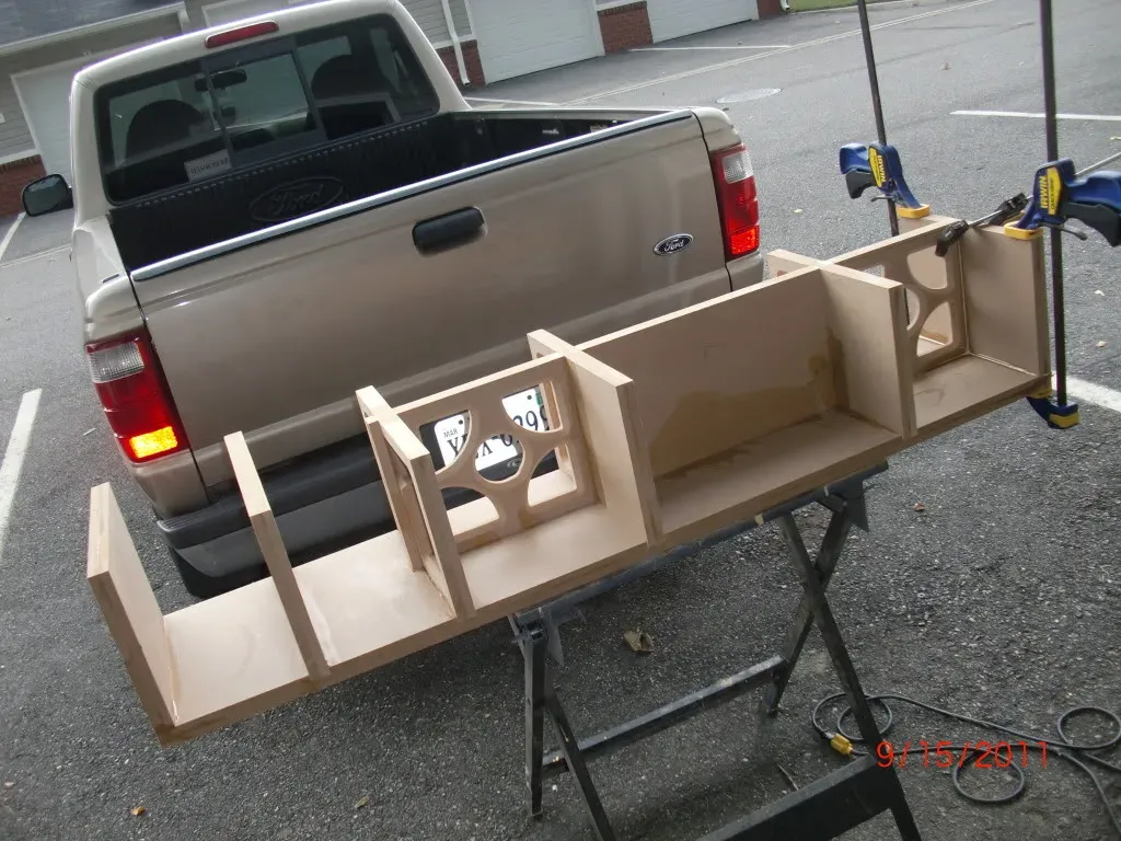

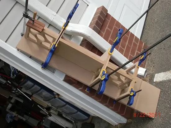

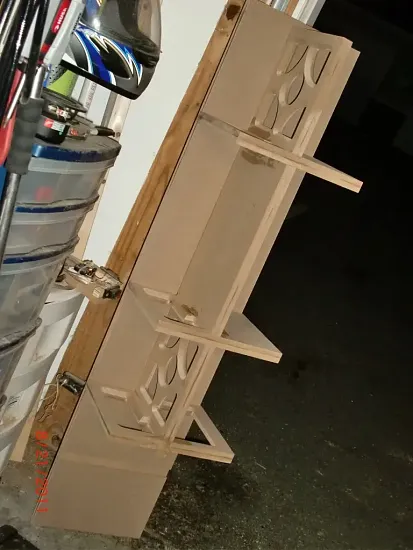

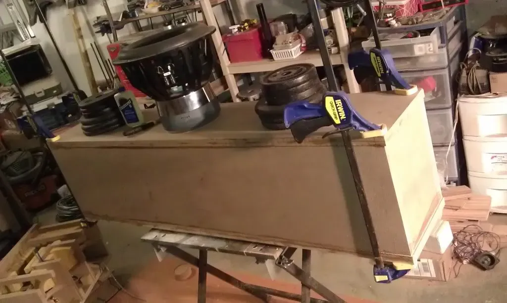

                      #100

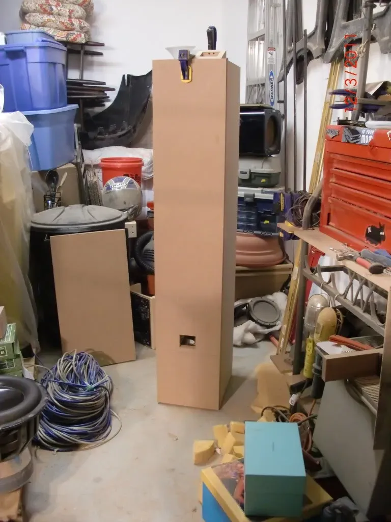

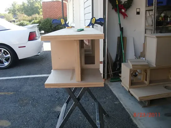

                      Bottom brace and bottom glued on to side....

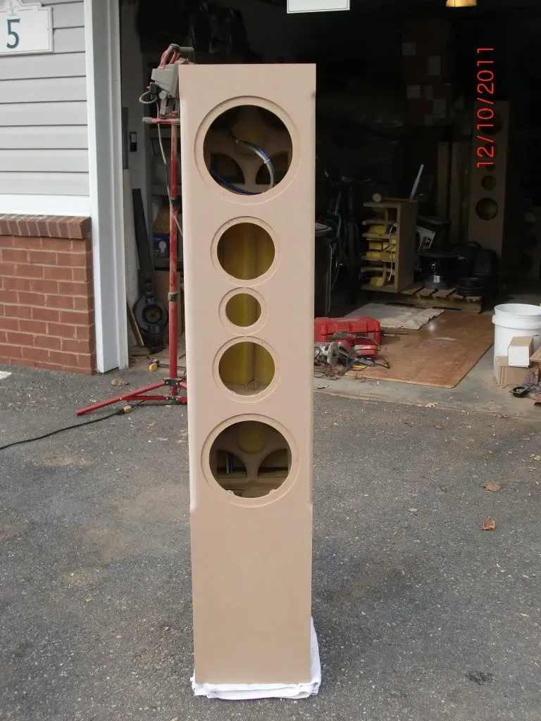

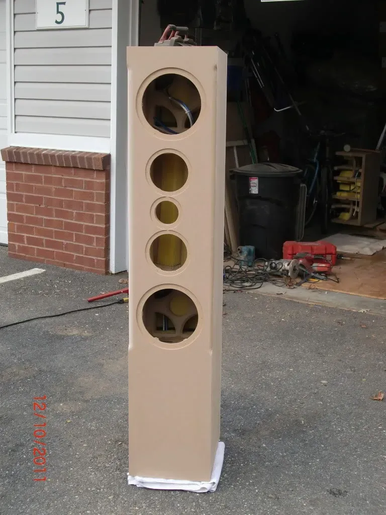

                      Now that work is starting back up, time is going to get a bit shorter to work....bah! I NEED MORE CLAMPS.
                      • joeybutts
                        • 476

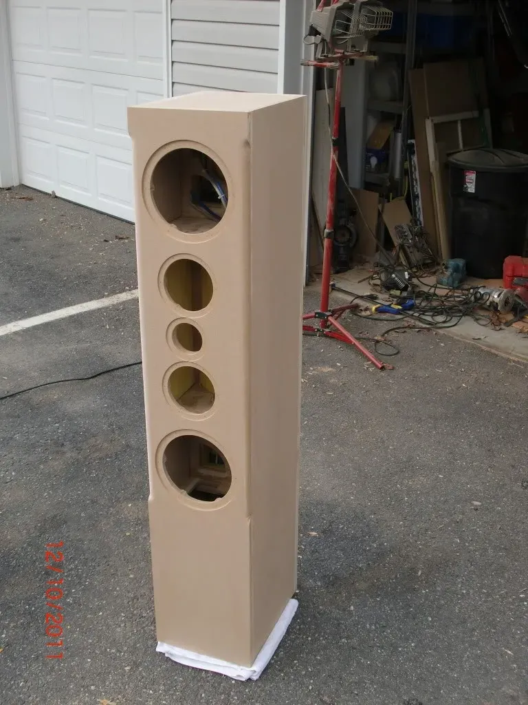

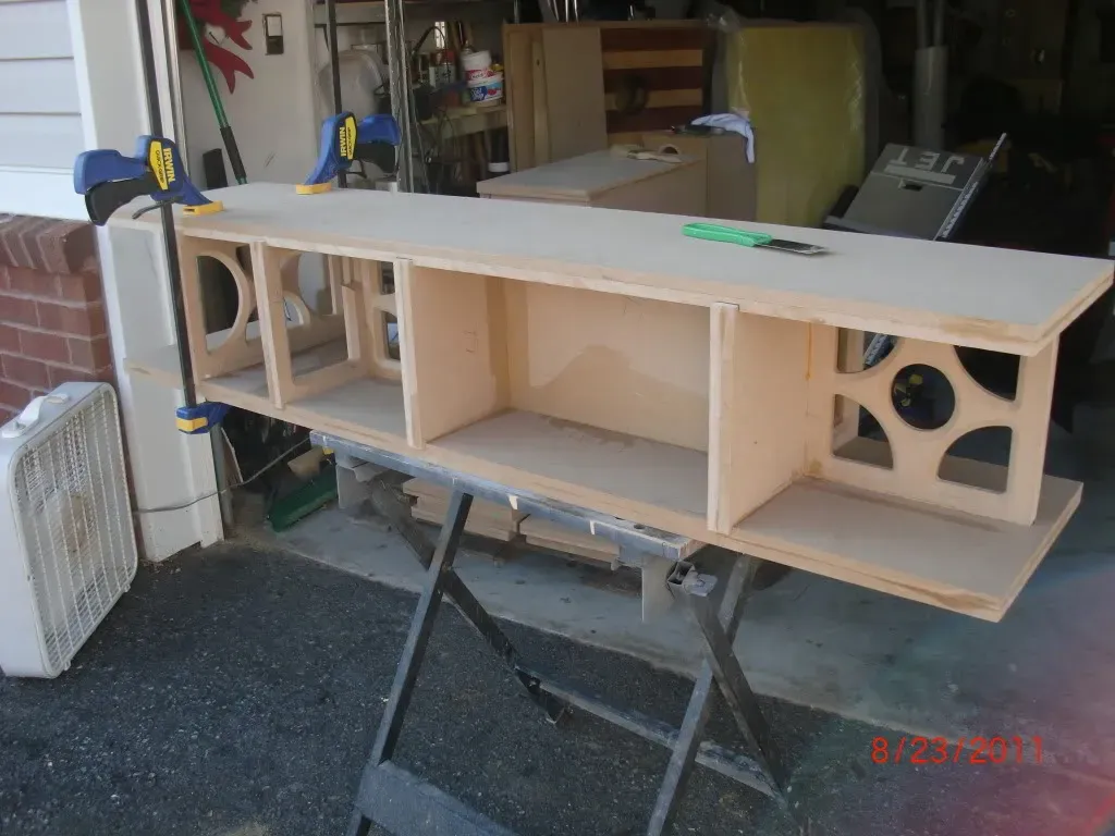

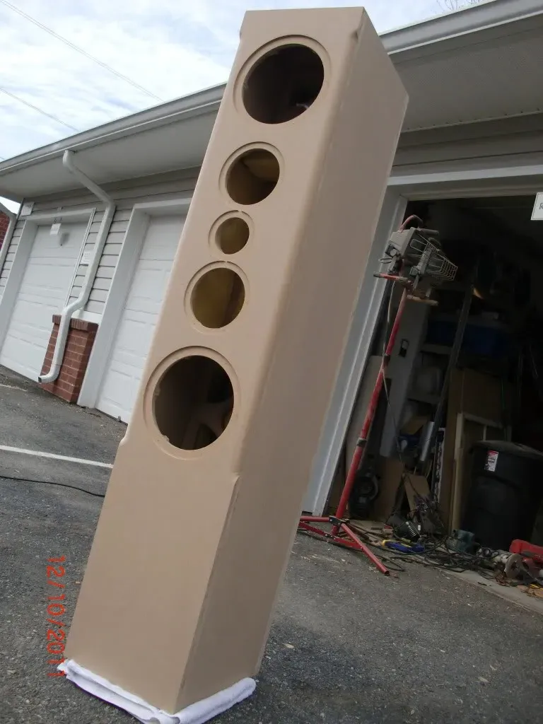

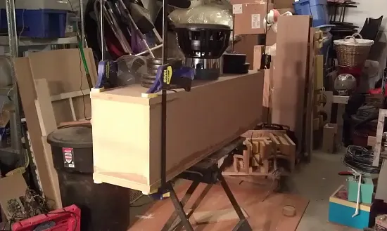

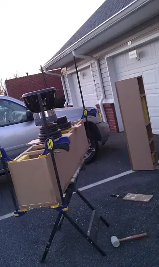

                        #101

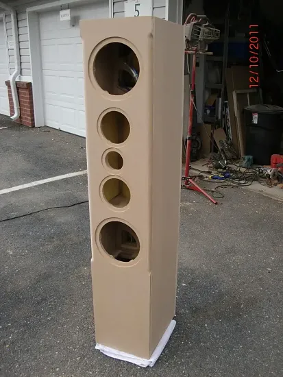

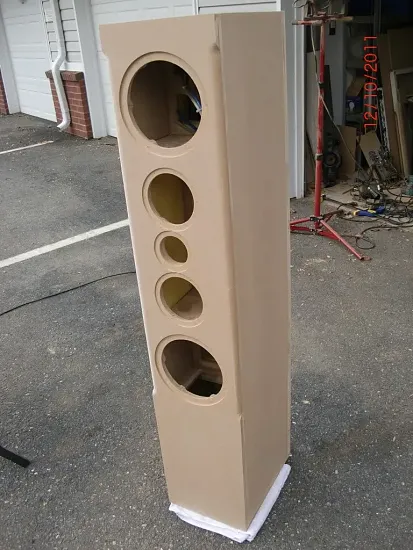

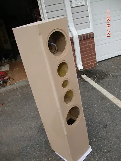

                        Tops are on. Other side will be on tomorrow.
                        • joeybutts
                          • 476
                          #102

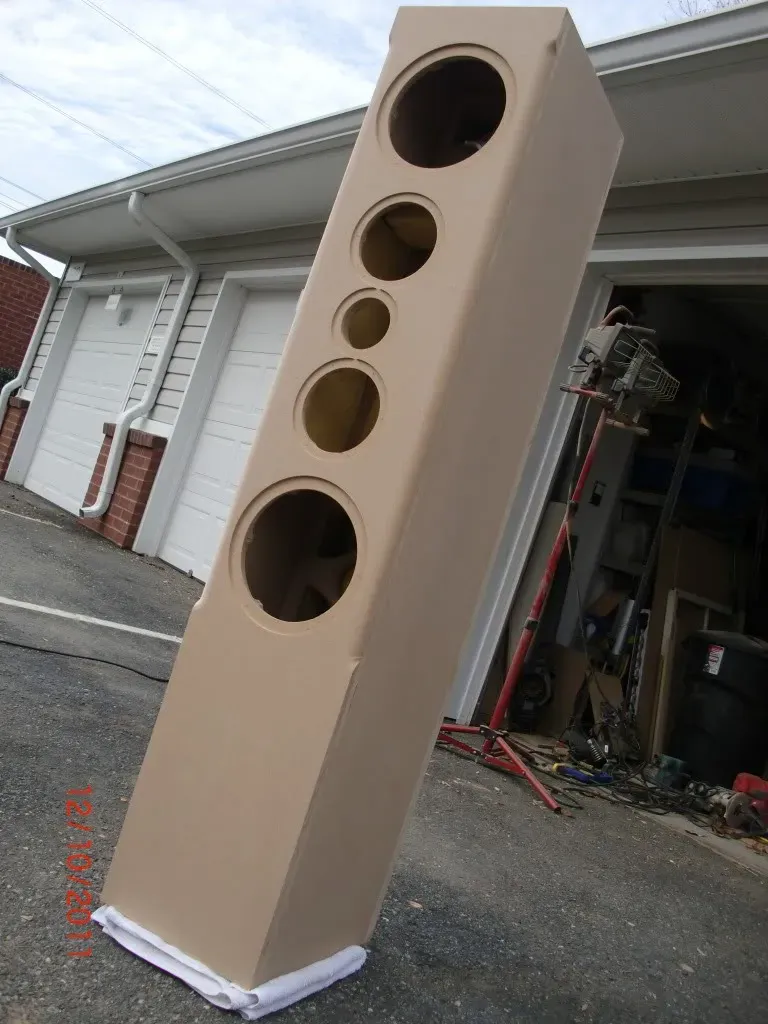

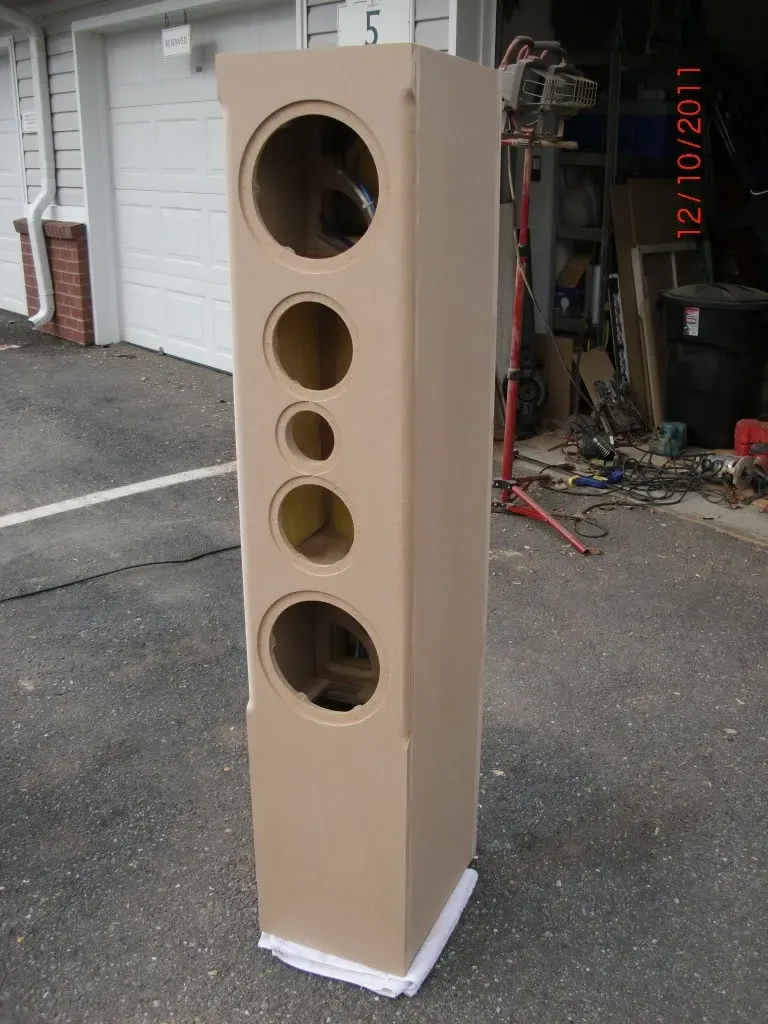

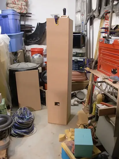

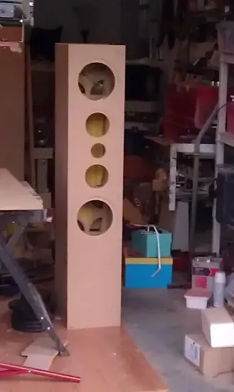

                          Sides are on. Hopefully by the end of next week they are completely built and awaiting crossover parts. Going to start putting in the 703 this week.

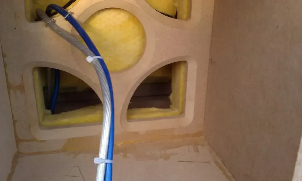

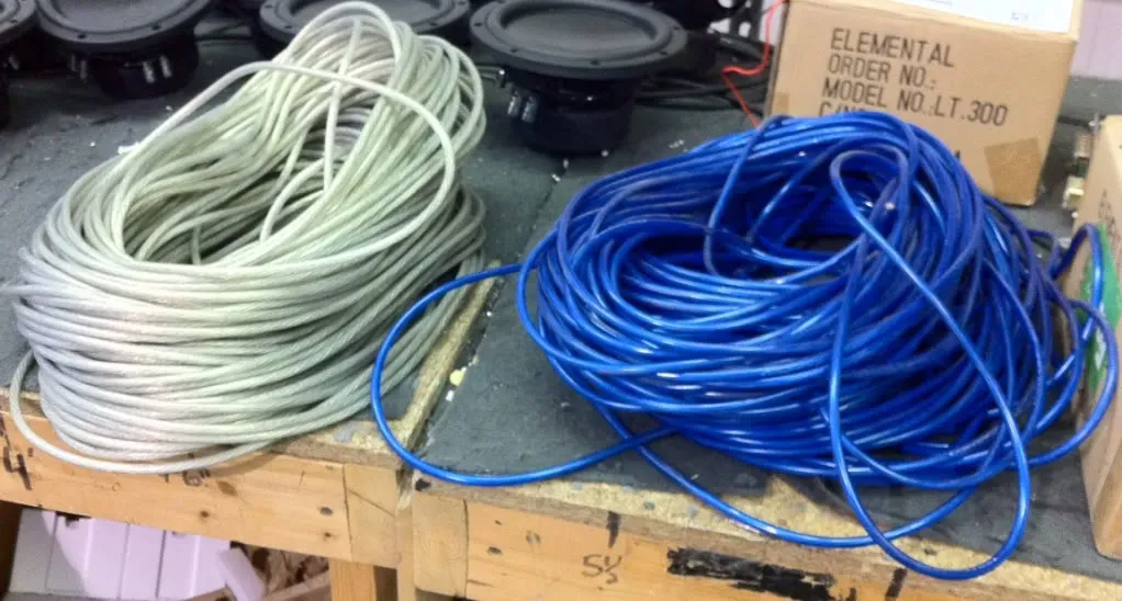

                                          Wire and binding posts should be here by the end of next week. That means wire and binding posts and insulation and the rest of the cabinets will be under way next weekend! WOOT!
                                          I think I may have gone a little overkill on the wire though..... :??

                                            Woot! Wire and terminals just shipped.
                                            OMG.
                                            No kill like overkill. Click image for larger version

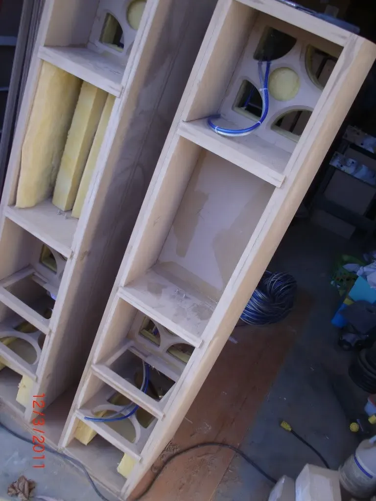

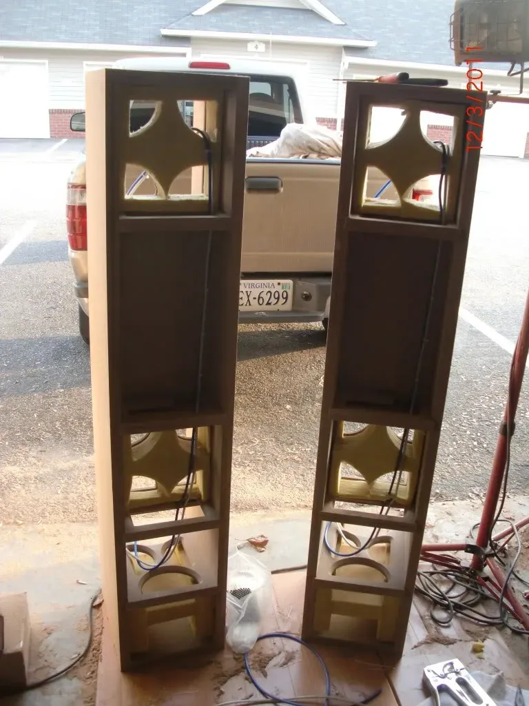

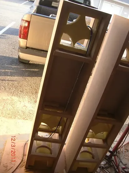

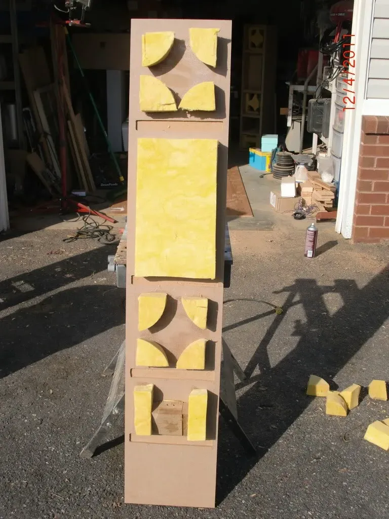

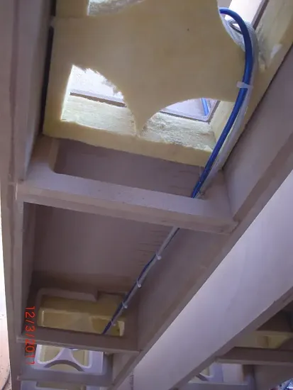

                                              Mid Chamber posts in!

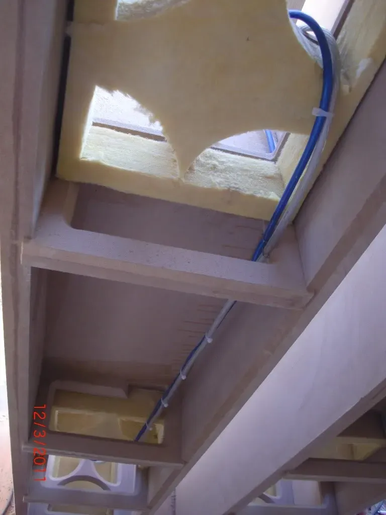

                                              Half the 703 in.....
                                              Hoping to have these glued up and wired by the end of the weekend as well!
                                              Someone please let me know what they think of the amount of 703 in here. Thanks!

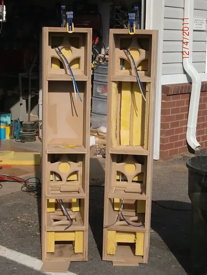

                                                #113
                                                That looks like a lot of 703.
                                                It could be too much in the mids. I know that I experimented adding accustastuff in my mid and found any added caused them to be a just slightly bright and harsh. With the mid being so oversize, I'm not sure why this was, but that is what I heard.
                                                I worry also about the piece right behind the top woofer. I understand what you're trying to do. But air isn't going to move as quickly through the 703. You might have just made a very small chamber with a aperiodic vent.
                                                I'm all for experimenting and overkill. But, if you're going to deviate from the original design, please only do it in areas where you can reach in and pull it out and put it back to the original.
                                                • joeybutts
                                                  • 476
                                                  #114
                                                  And that's why I asked, I wasn't sure what was too much. I know Pete on PE said that if I could suspend the 703 off a wall it would improve it's abilities. Maybe too much with 2" thick.
                                                  So you think I should just line the back walls with the 2" and that's it? I can always push that piece off the bracing and toward the back, not a big deal. The lower woofer has a large opening directly underneath it through that bracing so I think that will be good.
                                                  And I'll cut down the walls in the mid chamber to be only 1" thick.
                                                  And last, do you think I should push that suspended piece at the bottom all the way down?
                                                    #115
                                                    Pete might be right. I haven't done enough experimenting to know when it is too much. When Pete said suspend, I picture a piece hanging with a gap around it. Maybe ask Pete directly.
                                                    Taking the conservative route, if it were me, I would build it as close to mine, which would mean 2" on the back wall and 1" on all other surfaces. Get those up and running. Then experiment with suspending the 703 in the middle of the woofer top and bottom. Those are big woofer holes, so you can add an subtract quite a bit through.
                                                    I just don't want you doing anything that you can't undo. Once it is all glued together, there are going to be a lot of spaces you can't get to. You're not doing a removable baffle or rear right?
                                                    Maybe I worry too much?
                                                    • joeybutts
                                                      • 476
                                                      #116
                                                      Yes, no removable anything.
                                                      Yeah, I'll do what you said, might just add a little around the perimeter of the front of the bracing in the corners.
                                                      I try to plan ahead as much as possible, so no......you don't worry too much. :T
                                                      • joeybutts
                                                        • 476

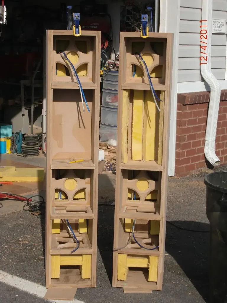

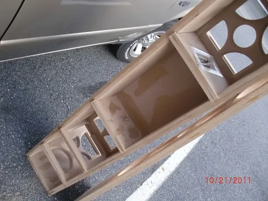

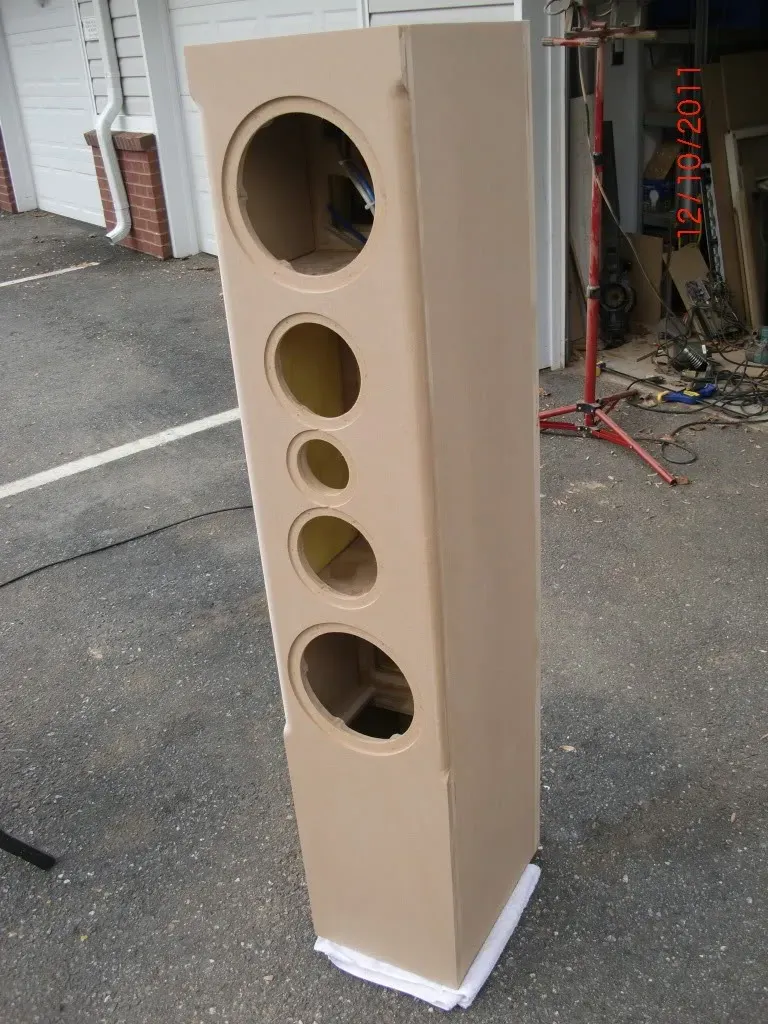

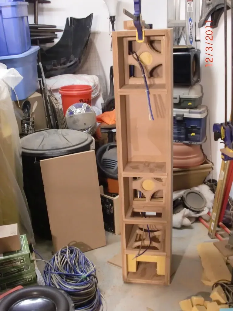

                                                        #117

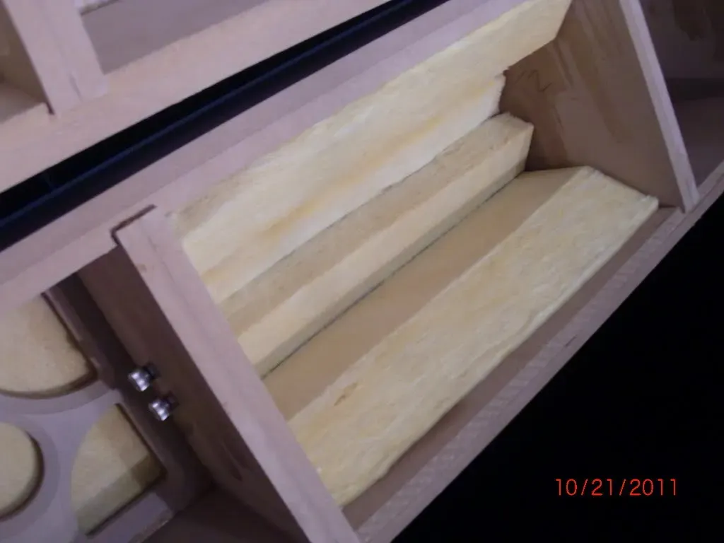

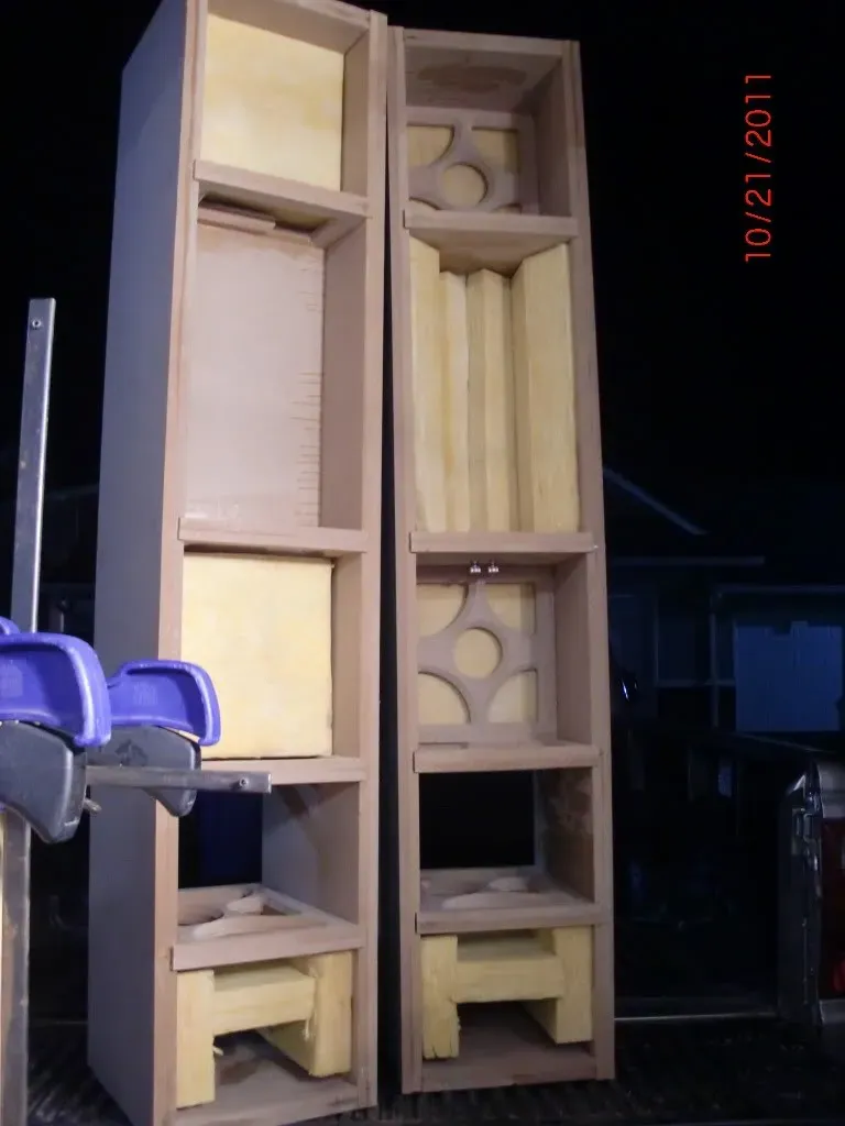

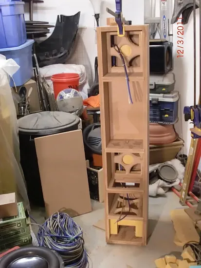

                                                        Insulation installed
                                                        • joeybutts
                                                          • 476

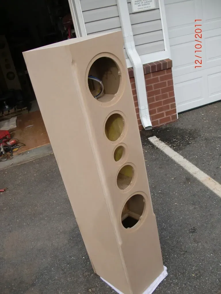

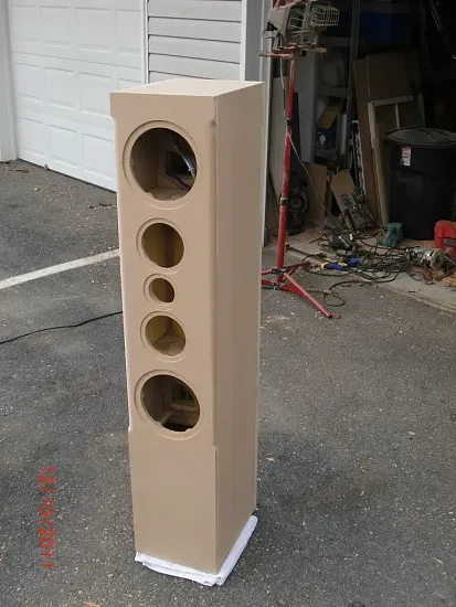

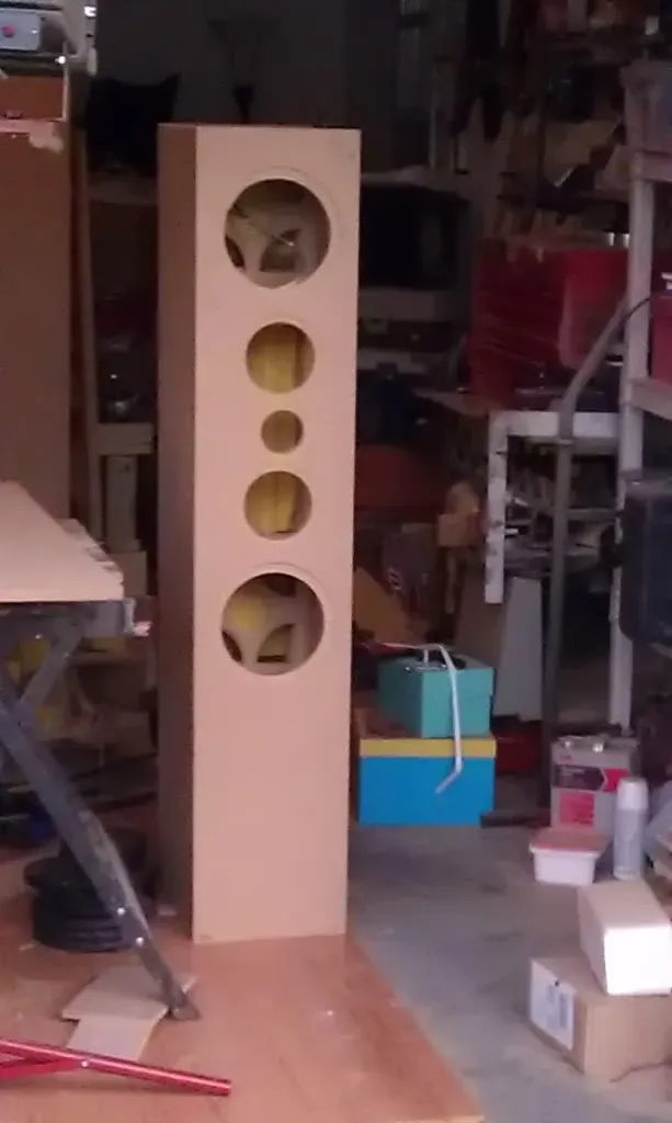

                                                          #118

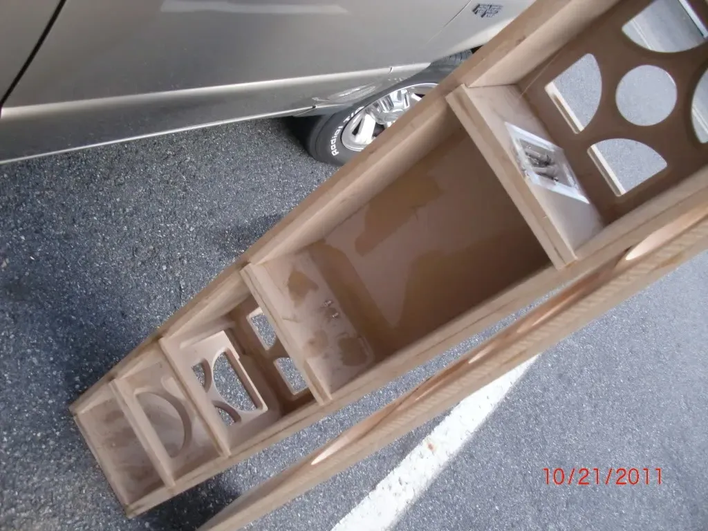

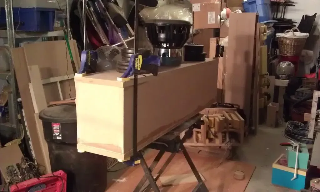

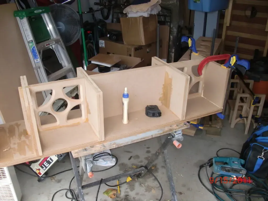

                                                          These will get done as fast as the glue can dry.
                                                          Something look funny?
                                                          Yup. Oops. Going too quickly I forgot to add an inch to the measurement of where the brace position. Going to have to cut a piece to fill in there and fix that up. I think this is my first big mistake on this entire HT build. I'll take it.
                                                          703 on the back panel

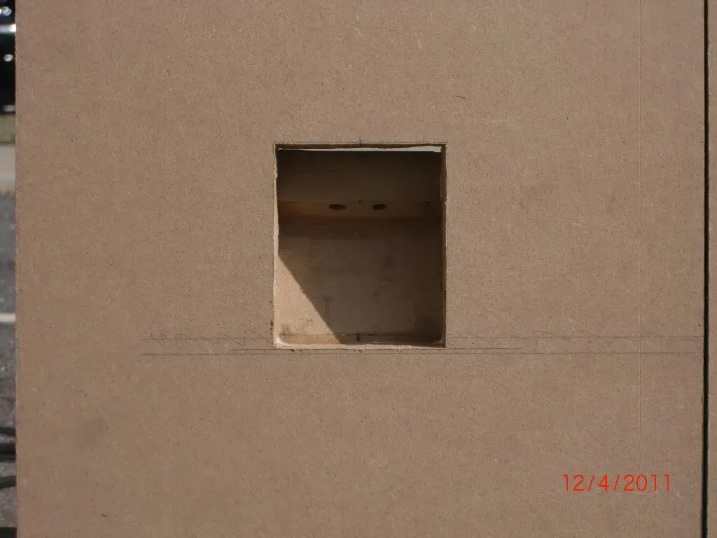

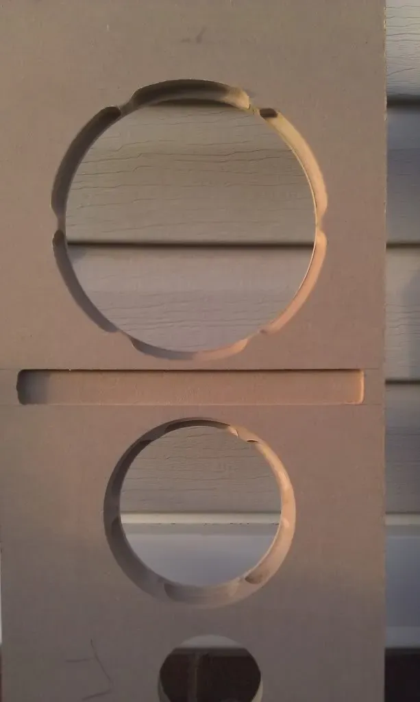

                                                          Cleaned up the 703 opening behind the top woofer for a bit easier air flow through to the bottom chamber.

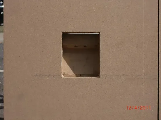

                                                          Opened up the backs of the cutouts for the mids and woofers.
                                                          Begin the agonizing process of gluing up massive panels.

                                                                    Uh oh.....one tower all glued up!!
                                                                      #124
                                                                      Why is that monster sub being used as a clamp? lol I'll take it off your hands and put it to use
                                                                      • joeybutts
                                                                        • 476
                                                                        #125
                                                                        hahahah. Cause I don't have enough clamps. That 13Av.2 weighs 60+ lbs, so it does a nice job of adding some pressure. I'm going to be trying it in my Ranger over the 16Ov.2 that is in there now. See which I like better. If it doesn't get used in there, then it will go in the family car that I buy at the end of 2012/beginning of 2013.
                                                                        Oh snap! One tower constructed!!!
                                                                        Tomorrow or Thursday I'm going to get it all finished up (which includes sanding and routing the front vertical edges). Probably won't have time tonight but will get the back panel of the other tower glued on.
                                                                        I can't believe this is happening.

                                                                                            One cabinet ready for finish work
