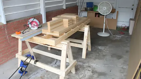

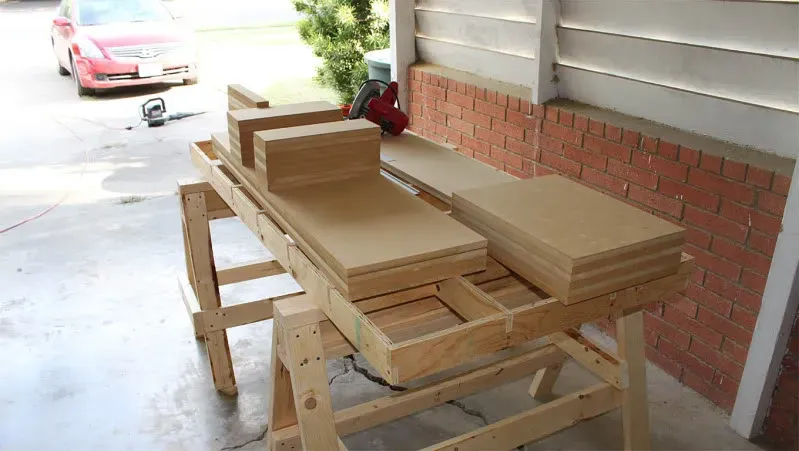

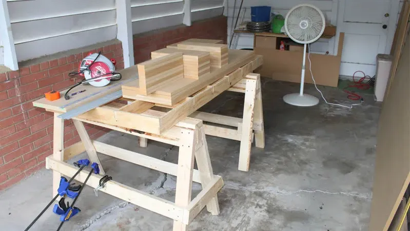

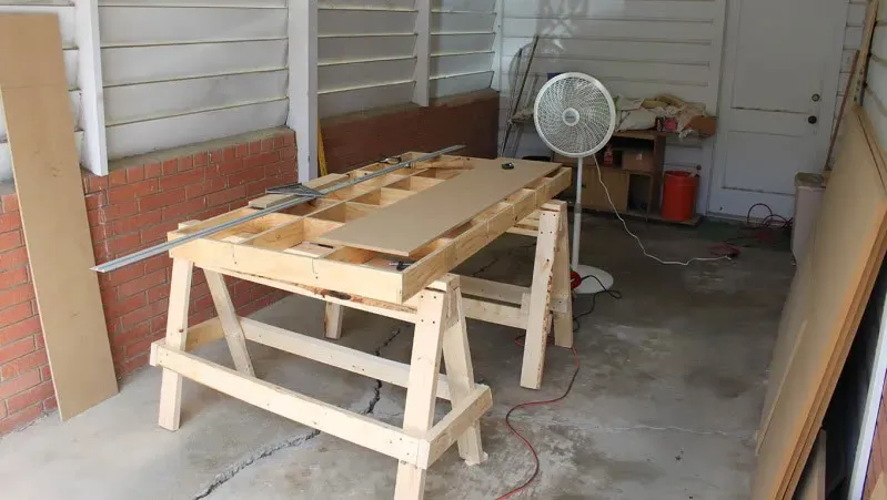

                                                              Got Some Cutting Done Today, First Photos Too
                                                              Well, I am off and running. I spent most of the day cutting the MDF sheets into the panels and whatnot. It was 101 degrees in the shade down here near the Mexican border with 55% humidity. I drank at least 10 large glasses of water, two cups of coffee, an extra large Barq's Root Beer from Jack In The Box, and three Coke Zeros. I'm still thirsty. It is amazing how much sweat a body can put out.
                                                              It took me a lot of time to cut two of the three sheets using a portable saw, but as the pictures show, I am short on storage space so I don't have a table saw. I used a carefully clamped edge guide, and worked slowly and carefully. I was rewarded with cuts as accurate as I would have gotten on a table saw. I got hot, thirsty and extremely filthy, but I had a blast. Few things are as enjoyable to me as doing work with wood and building something.
                                                              Just beginning:
                                                              Two of the three sheets cut:
                                                              My World Class Shop...My Carport:
                                                              Last edited by theSven; 12 August 2023, 10:56 Saturday. Reason: Update image location
                                                              • john trials
                                                                • 449
                                                                Those saw horses and cutting table look great. You built yourself a really nice working area (a lot nicer than mine! I cut my MDF on some 2x4s placed on my driveway). Judging by the quality of your work table, I imagine your speakers are going to look great.
                                                                Only 55% humidity? That seems low for TX! Our humidity in CT has been near the 70% mark for the past few weeks. I'm always nervous about sweating on the MDF.
                                                                It looks like you're off to a great start. Keep the photos coming!

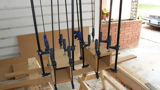

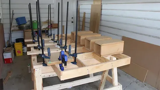

                                                                              I was off yesterday and today, but did not get as much done as I would have liked. We got a new dog yesterday that we adopted from the local humane society, and I wanted to spend as much time as possible getting to know her. I did manage to work on the Statements today. I got the tunnels glued up along with the two baffles. I am off again Sat and Sun, so I hope to make a lot of headway getting the cabinets glued together as much as possible. I still have not received my crossover parts order, but I hope to have everything by early September, when I go on vacation. I hope to have the speakers finished by the end of my time off then.
                                                                              Tunnels glue-up:
                                                                              Baffles glue-up:
                                                                              Last edited by theSven; 12 August 2023, 10:57 Saturday. Reason: Update image location

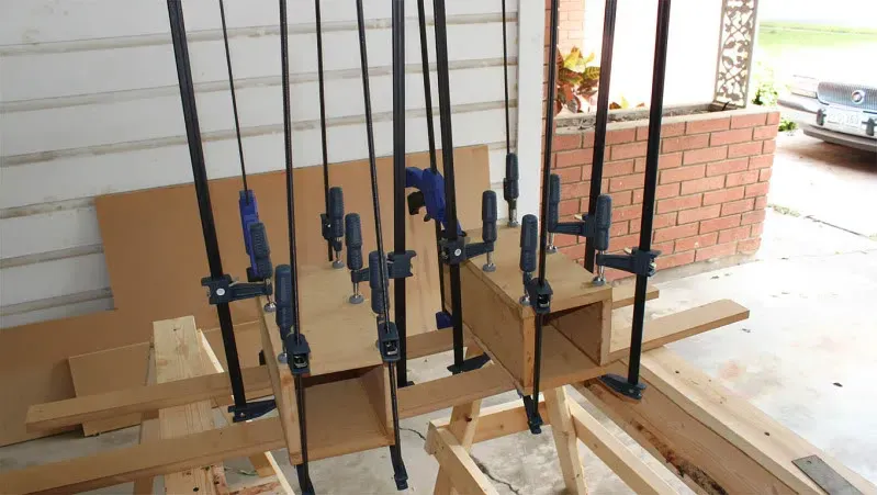

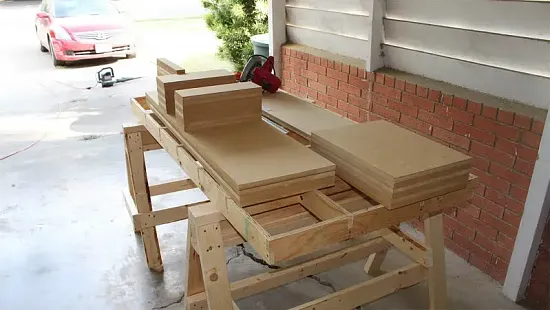

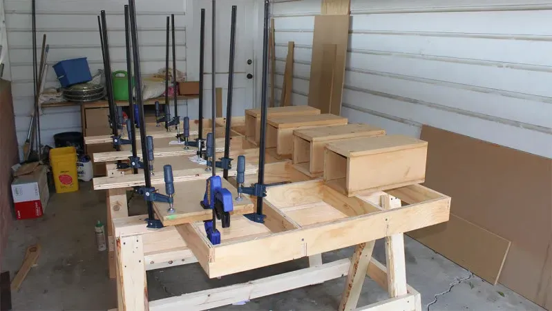

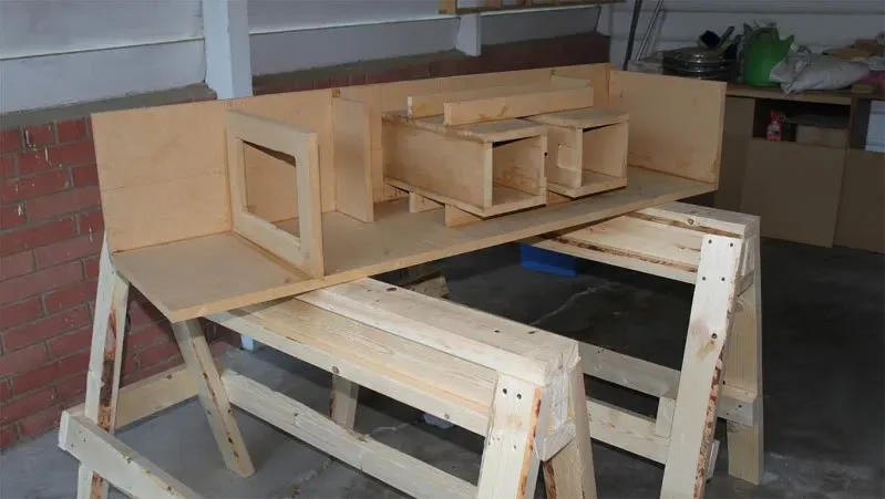

                                                                                I worked on the Statements today. I laid out lines and began gluing, and cutting the tunnel holes in the rear panels. I got one cabinet almost together, sans base and baffle. So far everything is going without any problems. The downside is that it comes at the expense of speed. Seeing them come together, I am getting more and more excited! I want to hear them so bad.
                                                                                Almost one cabinet down:
                                                                                Unfortunately, I have to work the next seven days straight. Then vacation for nine straight days, and hopefully these babies will be done.
                                                                                I have decided to paint the baffles and rear facings black and veneer the sides, plinth and top honey oak. This will match my Digital Phase speakers that will be my rears in my 5.1 home theater. When I build the Statement CC, it will be matched to these as well.
                                                                                I have a question about mounting the crossovers. I like the idea of using the industrial strength velcro to mount them. I know Jim's original had the crossover mounted below the bottom woofer on the inside of the baffle. I believe this was done on one board if I am not mistaken. I have also seen some done with three separate boards. Where were they mounted when using three separate boards, or what would be the best option? Thanks.
