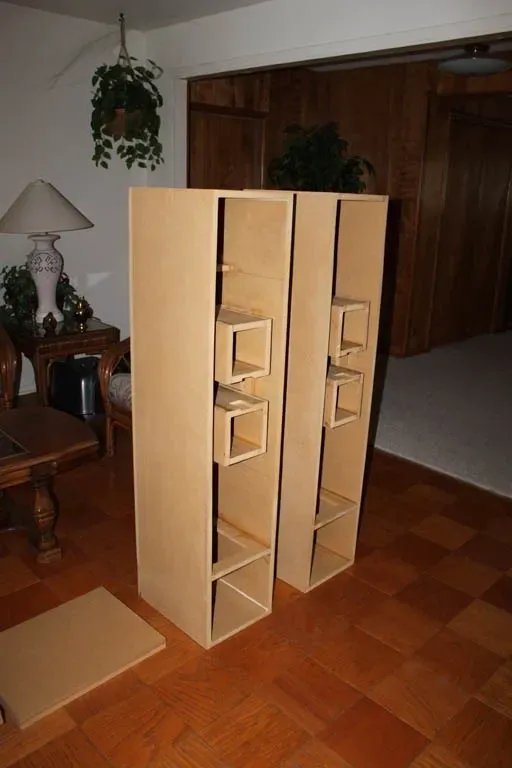

            Well, I ended up going out of town for a few days on my vacation, so I have not done as much work as I had anticipated. Yesterday, I rough sanded the cabinets and today I put in the terminals and lined the speakers with fiberglass. Tomorrow, I hope to cut out the openings in the baffles and begin work on the crossovers.
            Here is a picture of where I left off yesterday.

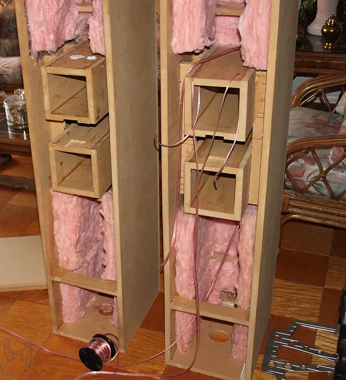

                          Sorry I have not been Johnny on the spot with with photos, but here are a few:

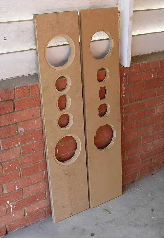

                          Baffles front and back:
                          Running the wiring:

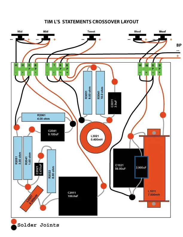

                                  Finally back to work on my Statements
                                  Hey all. I'm back. Just have not found enough time to get my Statements finished. Now I'm on vacation however, so I have finished my crossover layout. I drew it up to scale using Adobe Illustrator. Board size is 9.25" x 9" and should fit attached to the baffle below the bottom woofer and the lowest brace. I believe I have drawn it up right, and this I hope will work, but could you good people be so kind as to give the attached image a look and tell me if I am good to go or not? Thanks.

                                      Most people design the crossover to be on two boards so they can make it narrow enough to fit through the woofer cutout. Then you can install (and remove) the crossovers after the cabinet is built if necessary.
                                      Not necessary, buy I figured I should mention it.
                                      Hi, Chris. Thanks for the reply. That is good advice. Especially since my biggest fear is fouling up on the crossovers. I can cut the board in two and place the woofer net 1 on a smaller piece so they will fit through the woofer cutout.
                                      Is the wiring correct as I have it laid out? That is my main worry.
                                        I would suggest putting the woofer and the tweeter networks on the same board and the mid on it's own board, since the mid has the most pieces. You should be able to get both boards down to ~5x9.
                                        I'll try and check the diagram against the posted crossover later this evening.

                                          Tim, check the crossover wiring at your mids. It looks like the orange solder joint / node between R2051 and R2061 is connected to the negative side of the mids which is correct, but is also connected to the negative signal wire or signal ground.
                                          That negative signal wire should land on the black solder joint / node between R2061 and C2041 on the plus side of the mids instead. It's late, so forgive me if I'm looking at it wrong! I think the (BP-) wire at the terminal block is the only problem.
                                          Matt

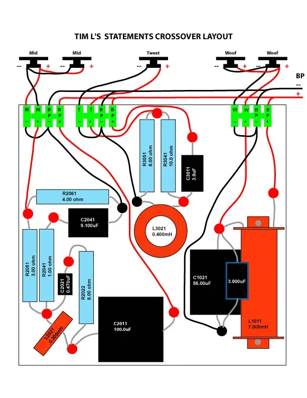

                                            Whoops!
                                            Matt
                                            Thanks Matt. I really appreciate your help. I have revised the diagram. This should be right now I believe. Always good to have more than one set of eyes to look at something like this when I have no experience with assembling crossovers. :T
                                            I am also going to do as Chris advised and place the woofer and tweeter nets on the same piece and the mids on one by themselves.
                                            Last edited by theSven; 12 August 2023, 11:00 Saturday. Reason: Update image location

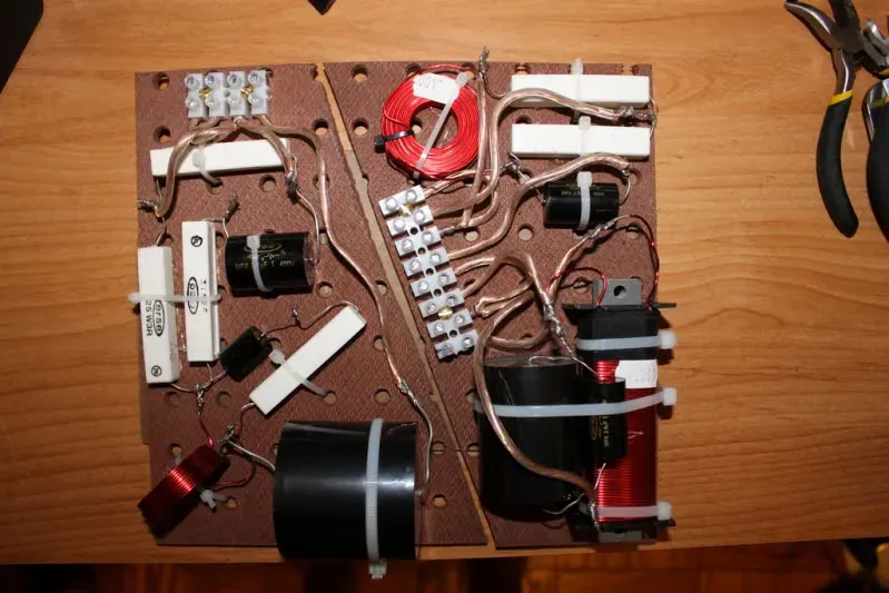

                                                        Thanks all. I finished both speaker crossovers today, with the exception of soldering the joints, which I will do first thing in the morning. I like the way they turned out, and I think everything is spaced well enough that heat should not be an issue,at least I hope so. No fiberglass should come into contact with them either. I took your advice, John, and decided to go without the terminal blocks, and I will solder wiring directly to the device leads to cut down on connects. I will post pictures first thing in the morning or later this evening. My camera battery was dead.
                                                        I ended up using two boards for each speaker. One for the mids, and one for the tweeters and woofers. The single board I had cut would not fit through the woofer holes, so I basically just split the original boards into two pieces. Therefore my finished layout looks just like the layout in my revised illustration, minus the terminal blocks of course.
                                                        My Emotiva XPA-2 arrives tomorrow as well. Man I can't wait to hear the Statements with that amp. 8)

                                                          Okay, I finally have my crossovers complete. They took a lot longer to do than I thought, but I guess having no recent experience with soldering and working with these types of parts, its understandable. In order to have good spacing between the resistors and the caps, I had to deviate somewhat from my original layout to accommodate those giant resistors. Here is a picture of one of the finished crossovers.
                                                          Now, to finally test to see if these babies will play.

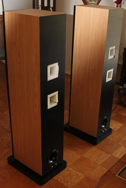

                                                                    Well, after a long day of work on the Statements, everything is done except rounding over the baffles, mounting the drivers, designing and attaching the base, and hooking them up and listening to them. I will paint the baffle and apply the veneer hopefully a week from today.
                                                                    I made a couple of last minute changes, including replacing the fiberglass with the 2" foam, and going with a rear firing port instead of the downward firing one. The fiberglass was fine, but it was just not aesthetically pleasing enough. I know I won't see it, but I just wanted cleaner, more tidy cabinets. I will post pictures tomorrow.

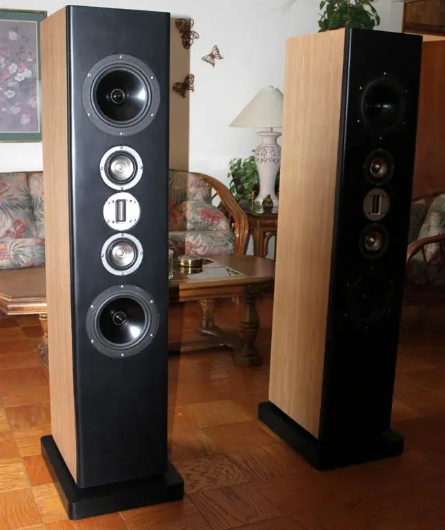

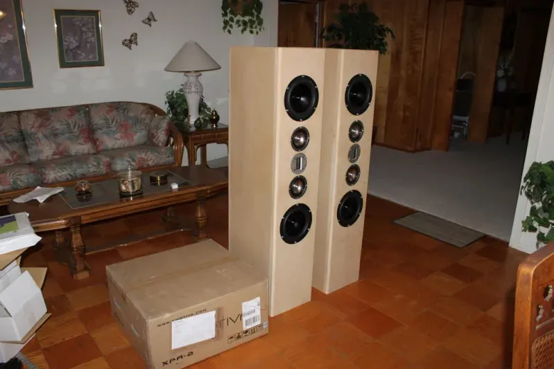

                                                                      After another long day of working on the Statements, I finally finished them to the point of being able to set them up and see how they sounded. Here is a picture of my progress, with listening impressions to follow:
                                                                      As you can see in the picture, I still have not unpacked my new Emotiva XPA-2 amp. I was just too darn tired, so I hooked them up to my Emotiva XPA-3 amp / USP-1 preamp / ERC-1 CD player system. For those not aware, here is the specs of the XPA-3 amp: 200 watts RMS x 3 into 8 ohms | 300 watts RMS x 3 into 4 ohms. I switched out my old Klipsch KG-5.5 floor standing speakers with the Statements.
                                                                      The first CD I played was Dead Can Dance's "Toward the Within" which is a live recording. My very first thought was, "this is not a live recording, I am there in the audience." My old Klipsch speakers were very good quality, and still to this day sound fine, even though I bought them new back in 1994. They would compete with speakers today anywhere from $1500 to $3000 per pair. I can state unequivocally that the Statements completely blow the Klipsch away.
                                                                      These speakers have a big, full sound, that is completely unboxy and neutral. There is no harshness in the highs, the mids are superb as many others have stated, but they also shine in the low end with smooth deep bass that packs punch without the boominess.
                                                                      A while back just before I decided to go the DIY route, I auditioned speakers from Paradigm, Magnepan, Martin Logan, Klipsch, B&W, Dynaudio, PSB, Definitive Technology, Vienna Acoustics, and a few others that ranged in price up to $5000. Many of them I was very impressed with, but these Statements sound better than every pair I auditioned back then. Now there are speakers that will rival or beat these Statements, but I did not bother to listen to them because I could never afford them. The only speakers I have heard that I would say outperform these would be an $11k pair of Quads I heard a while back, but even they did not have the rich, deep bass that I am now hearing, although the mids and highs were simply stunning.
                                                                      I chose to go with DIY to take the chance that I could get true audiophile quality sound on a budget I could afford. I succeeded beyond my expectations. I want to give special thanks to Jim Holtz, Curt C. and co. for giving me the opportunity to own speakers I can love and be pround of for many years to come. I also want to give thanks to John Trials, Sefferdog, BeerParty and all the others that contributed to my build thread with their help. I should also credit Emotiva, as there is just no audio equipment available that beat them at two or three times the price if not more. As soon as I can, I will build the Statements CC to complete my 5.1 home theater. I will also post pictures after I put the final finish on.
                                                                      Now, I just need to unpack that XPA-2 and really crank these babies...
                                                                      Last edited by theSven; 12 August 2023, 11:01 Saturday. Reason: Update image location
                                                                        Hi Tim,
                                                                        Glad you like the Statements. I do too! :T
                                                                        Here's the good news, they'll sound even better after about 20 hours of play time. Seriously....
                                                                        • Tim L.
                                                                          • Jul 2010
                                                                          • 42
                                                                          Hi Tim,
                                                                          They sound any better, I might be moved to tears of joy.
                                                                          • AdelaaR
                                                                            • Dec 2010
                                                                            • 480
                                                                            Thanks for that review and congratz on your statements Tim!
                                                                            Will they remain MDF or are you going to give them some finishing?
                                                                            • Tim L.
                                                                              • Jul 2010
                                                                              • 42
                                                                              I still need to add the plinth. I have not yet decided on a design. Also, I will paint the baffle satin black with the rest being veneered with golden oak or honey oak. That will match my Digital Phase speakers that I will be using for rear channels.
                                                                              • Drew_V
                                                                                • Jan 2011
                                                                                • 63
                                                                                Looking good! It's results like this that keep me motivated to build my own set of Statements (minis). Hearing the phrase "They sound better than $5000 commercial speakers" never gets old. A testament to Curt/Jim's design prowess.
                                                                                By the way, what radius are those roundovers? They look awfully small, less than 3/4" (full roundover).
                                                                                • Tim L.
                                                                                  • Jul 2010
                                                                                  • 42
                                                                                  Yes, the roundovers are 1/2". I thought I had purchased a 3/4" roundover bit, but when it came time to do the baffle edges, I could not find it. I used a 1/2" bit as a stopgap measure until I can get a new one or find the missing one, as I do want the speaker cabinets to specs.

                                                                                    From time to time, I thought I may never reach this point, but I did and I am very pleased with the results. I thought my paint job looked very good. I used several coats of Krylon spray primer, followed by around six or seven coats of Krylon satin black from the rattle cans. I followed that with several more coats of Krylon flat clear acrylic. I pretty much got just the look on the black paint I wanted.
                                                                                    Although not perfect, and I made a few mistakes I wish I hadn't of, I feel I did pretty doggone good for a first time speaker build. As hard a job as it was, I would do it again in a heartbeat. They sound awesome. Here are a couple of pictures of the finished pair of Statements.
