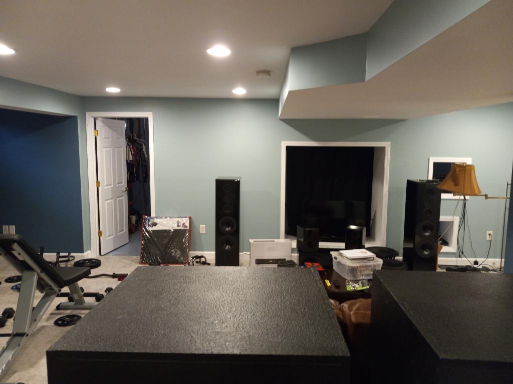

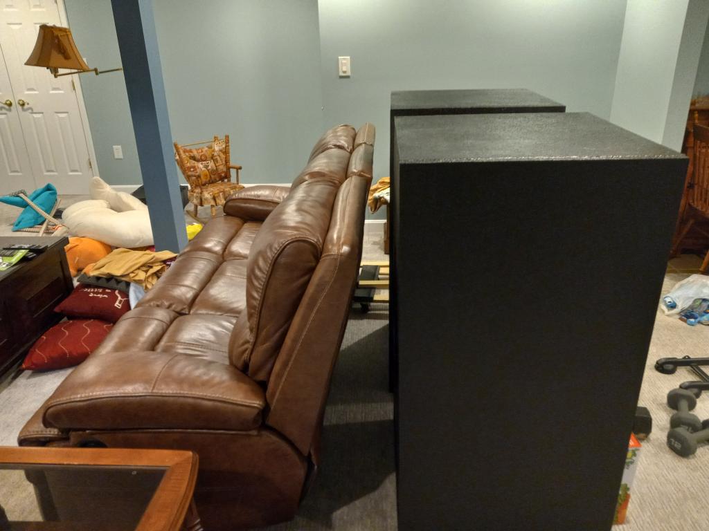

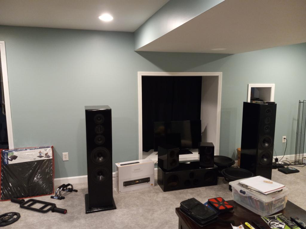

    Here’s what I have and a picture of the room I’m working with - please excuse the mess. The door and audio cutouts in the wall are going to be framed back in to create one large wall:

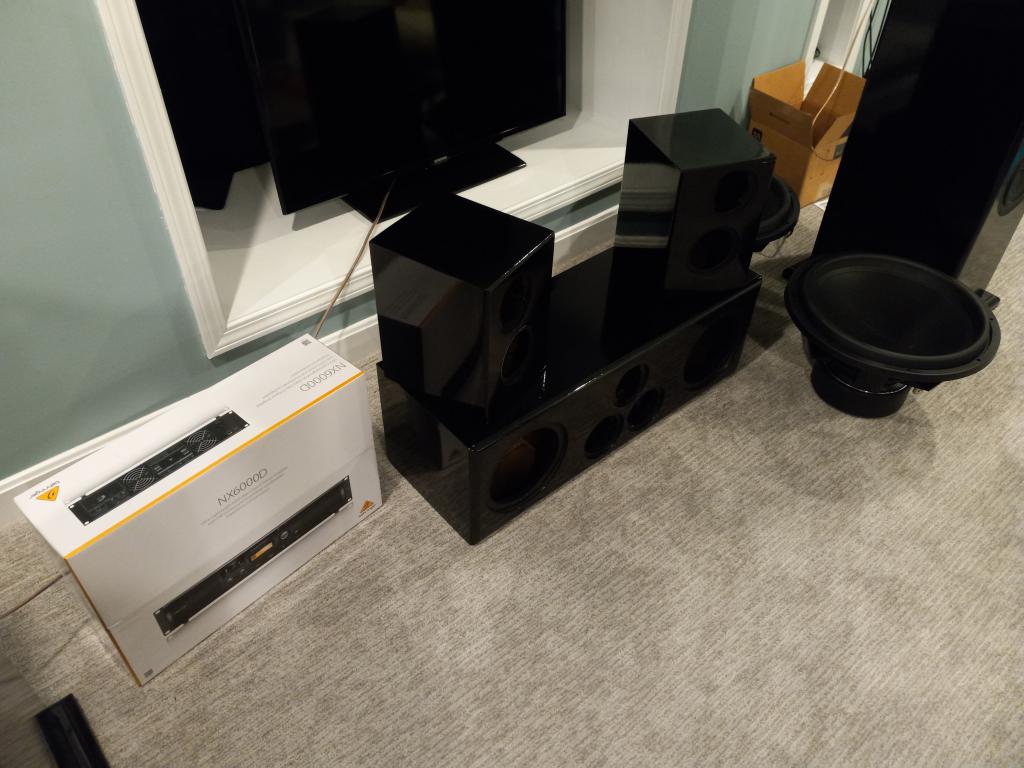

    Statement II Front Channels: Complete and working – they are awesome even though my setup is awful!
    Center Channel – painted and just need components
    Left Right Rear Channel – painted just need components (Micro-statements)
ID:	872613Click image for larger version
    Denon InCommand X4200W (not upgrading)
    2 Full Marty cabinets - never been used – setup not complete
    2 Stereo Integrity 18 woofers - never been used
    Amp - NXD6000D - never been used
    Say hello to my little friends :twisted:

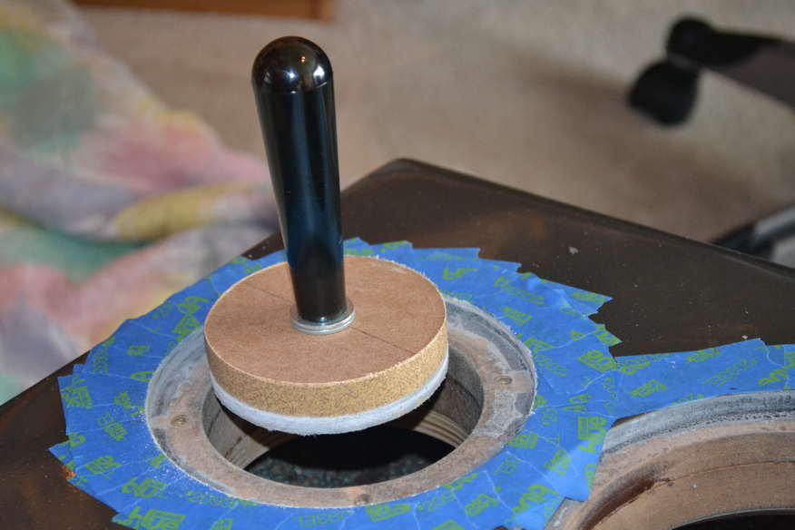

            Actually if you need to remove a small amount of material to get the drivers to fit it can be done. I had a guy paint a set of speakers for me that went rather heavy on the paint, the drivers no longer fit in the cutouts. I built a little sanding jig and with a little work got thing fixed. Just have to tape off areas you don't want sanded accidentally.
                [ATTACH=CONFIG]31527[/ATTACH]
                That's pretty neat. I scrapped my very first attempt at a build for that very reason.
