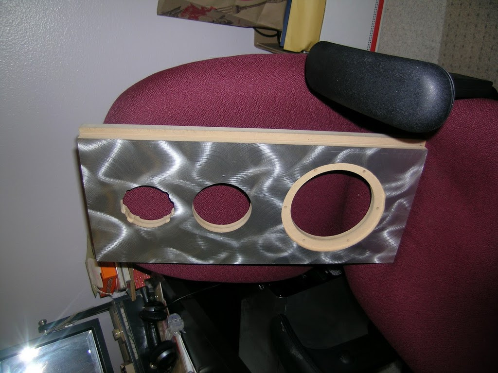

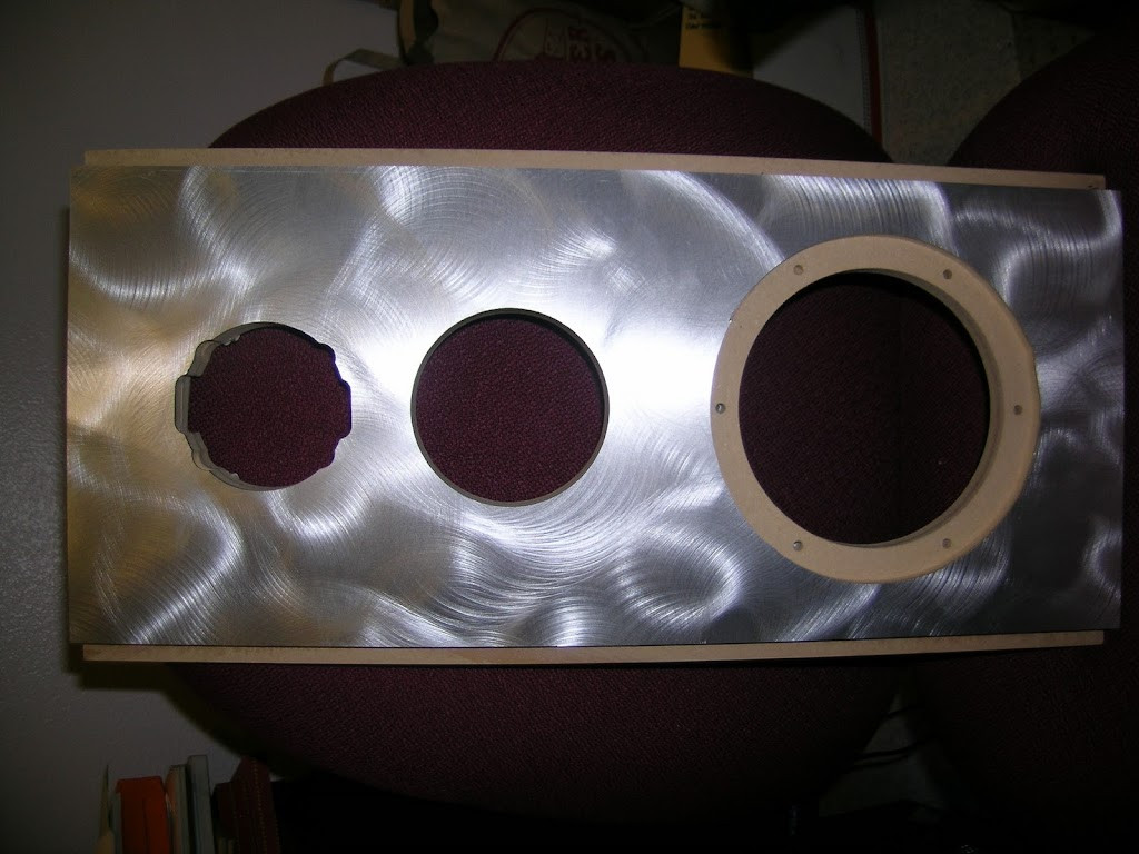

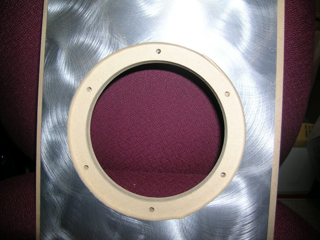

    Well, I finally have some pictures, but sadly its of a mistake.
    The router was dull, the bit moved off the bearing, and not only did we have to scrap that front baffle [it was already glued down to the box, cut it off with a band saw.] But now we have to remake the template for the flush mount hole.
    Fail.
    Anyways, it looks really awesome, much better in really life.
    I didn't really want shiny speakers at first, but I think this is going to turn out great.
    The slots cut out on the left/right side of the piece of aluminium would have been filled with a piece of maple, which is then going to be flush trimmed to the box, and then given the 1/2 round over.
    The box will be a shiny black.
    So far the biggest out of wack tolerance that we have is the height. Its supposed to be 22" and its actually just under 22 and 1/32". We are long about 1/64th a foot.

      I'm interested in a few things. How thick is that aluminum? How are you bonding it to the MDF? Is the aluminum your template, or is it going to be part of the finished speaker cabinet?
      Are you making the driver cutouts without a circle jig? I'm just wondering, because another option is to make the rebate cuts first with a circle jig, then the through hole cuts. There is no worry about router bit bearings with a circle jig.
      It's also easier to make all of the cuts to the baffle before it's glued to the cabinet. That way you can also make the cuts on the back of the baffle to allow the drivers to 'breathe' better, too.

        We made the inside diameter cuts, the back bevel, the pilot holes to mount the driver, and the counterbore for the tee nuts all before we glued the front baffle to the box.
        The aluminium is pretty thin. My guess is that the aluminium + formica backing is about 1/32". Used aerosol contact cement. We sprayed it on both surfaces. it gets tack dry and then you just push them together.
        We made the driver cut outs with a template made using an expansion bit on a drill press.

          Sorry for your mistake, I know how it feels I threw away a couple of boxes during my build.
          The aluminum looks pretty awesome! Your router had no problem cutting it? I wonder if Jim or Curt have anything to say about it affecting the sound (my guess would be no, but they are the wizards here).
            The flush trim was incredibly easy. Carbide tip router bit. It's not that thick. But yeah, I don't think high-speed steel bit would be a great choice.
            Really, the aluminium looks even better in person. The pictures just don't do it justice.
            We already had a 3rd baffle built, it was going to be for a center channel, but since we didn't plan on actually building that 3rd speaker anytime soon, we will just be using that baffle to correct this mistake.
              I use high speed steel end mills on aluminum in my job (machine shop). Aluminum is cut with a high cutter speed similar to wood, so HSS router bits would work great, if you need to use them.

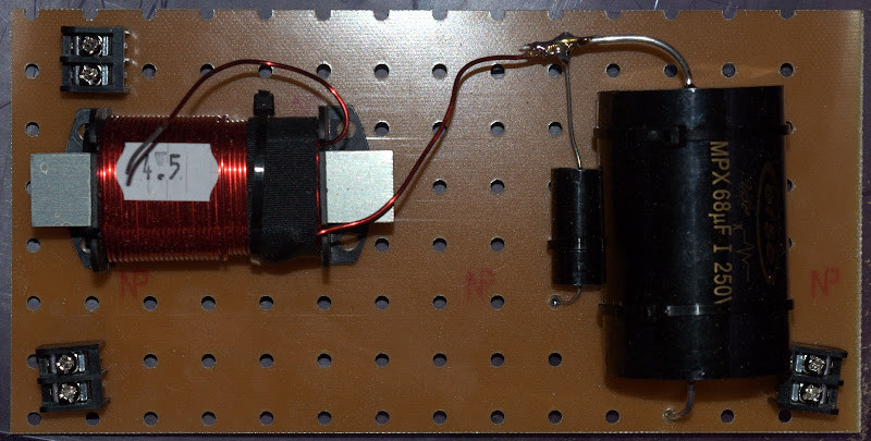

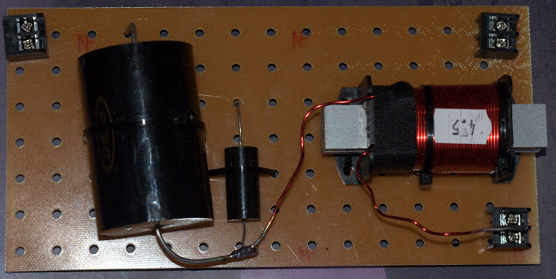

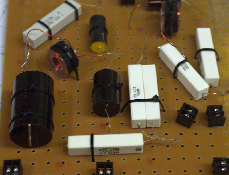

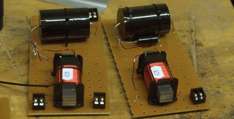

                      Here is a picture of my partially completed circuit boards.
                      I'm going to be moving the 2uF cap on the woofer crossover closer to the 68uF cap. It got mounted too close to the inductor.
                      Last edited by theSven; 15 April 2023, 05:00 Saturday. Reason: Update image location

                        Looks good, except for the pair of resistors that are held together with a cable tie. Separate them. It'll give them more open surface area to dissipate heat.

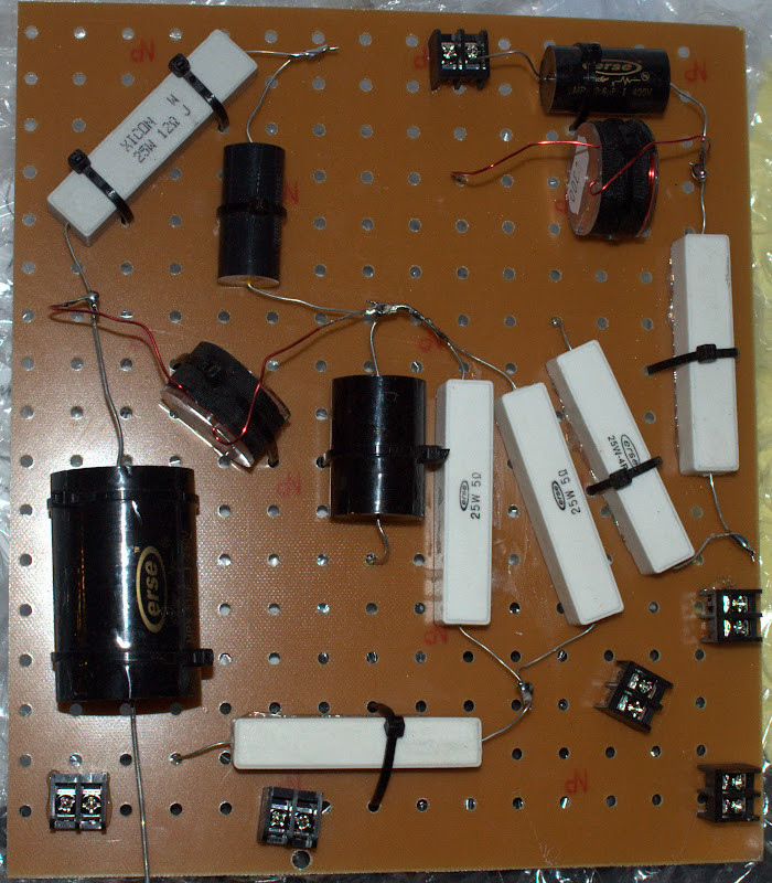

                            • Fdas
                              • May 2010
                              • 98
                              Ok.

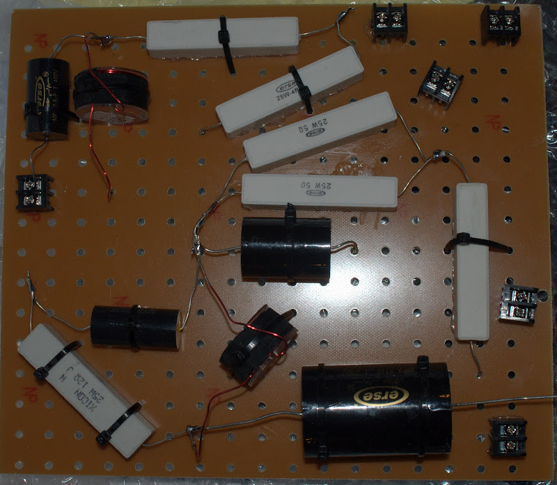

                              Got it all soldered up. Please have a look and let me know if it looks bad somewhere.

                                Pretty sure you want to have a good seal between the chambers. I drilled the holes close to the back of the tweeter then sealed with caulk after running the wire.

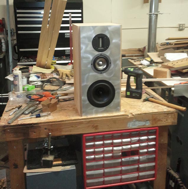

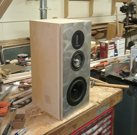

                                            Small update. Got the front of one box done.
                                            Sorry about the picture quality, 100k limit on pictures is pretty small, and unfortunately, i didn't bring my camera to the shop today, so these are cell phone pictures.
                                            In any case, they are starting to look cool.
                                            Can't wait to hear them.
