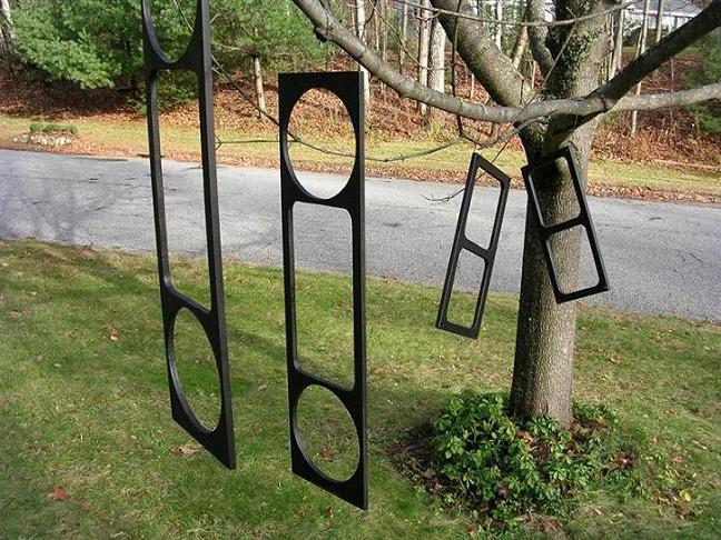

    So far we've cut the MDF (Wow what a mess!), but we're stymied on the small baffle holes. Warren's router does a great job with holes over 4", but has no way to cut circles smaller. And the Jasper jigs don't fit the Triton routers. Warren has several ideas for work arounds, but they're still to be tested. Any suggestions appreciated.

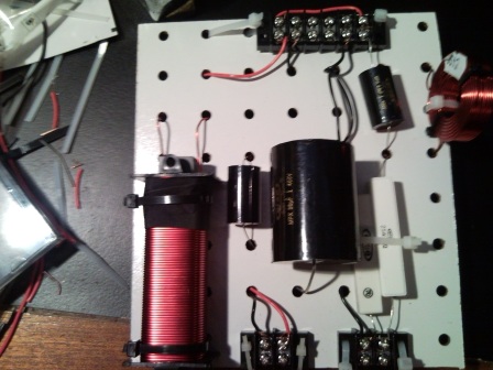

    I'm going to try and assemble the crossovers this week. If I make three separate boards, am I correct that I can wire them in series with the wire from the source going first to one board, than to the next and then to third? Also, if we go with the 2" foam that Jim recommends to line the woofer parts of the box, how much will we need? I'd like to order it with the 1" for the mid tunnels, but I can't guess how much I'll need.

    Ideas for cutting circles? Get a knife and start whittling?
    You could re-drill the jasper jig to fit on that router. Borrow a router from somebody that does fit the jasper jig. Put the router in a router table, drive a nail into the router table to use as a pivot and spin the board around? A bit crazy bit it does work.

        Crossovers are wired in parallel. Run three pairs of wire from the binding post to each crossover board.
          If the work around isn't successful, I'd suggest you consider renting or borrowing a router that will work with the Jasper Jig. Another option is to get a cabinet maker in your area to cut the holes for you.
          Nope, you can not wire them in series. You can wire them in parallel with each section of the crossover positive leads and negative leads joined together with the other positive and negative leads at the binding posts.

            Why not a hole saw with a good drill. Buy a multi-use auger, get the size you need and cut a precise hole if you take your time. MDF stinks when burnt.

                It's the same idea... wiring all the leads to the binding posts or at the xovers "INs" is the same thing.

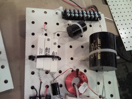

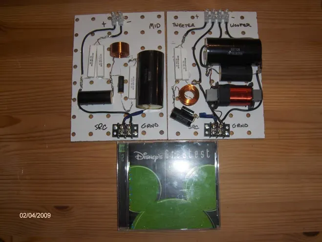

                  Is there a specific reason for three boards? When I made mine, I found that I only needed two boards and could still fit them through the driver hole:

                    No good reason to make three boards except that I'm nervous and it makes the component placement easier, or so it seemed. But attaching two leads to that little tab seems a lot easier than three. Did you solder your lead to the binding post or use a connector?

                      Actually, I made my Statement xover on one board, which fit very nicely through the woofer hole, and mounted on the inside of the baffle beneath the woofer hole, where there is no fiberglass/foam anyway.
                      Less boards=less interconnects=less chance of connector failure. I've been in manufacturing for years. The less connections, the better.

                        I soldered my wires on the plate, but just used the connector on the crossover boards in case I have to remove them. If you are going with three boards just make sure you can mount them in the area behind the Dayton RS180s. If you review my build thread you'll see that there isn't a lot of space back there after you put in the brace and the foam. I even had to change the brace from horizontal to vertical so I could put my boards on the sides of the cabinet.
                        I also used a large recessed speaker terminal plate, like this one, which had a long leads on the back for soldering the wires.
                        [EDIT]Hmm, I could have sworn that you were building the Monitors. Ignore the space warning, the full sized Statements have plenty of room behind the RS180s.[/EDIT]

                          I used the Router Buddy jig
                          The Router Buddy jig will allow you to make little circles.

                            If you aren't sure you want to spend the money on a really solid plunge router, Harbor Freight sells two very reasonable priced ones. The one that's $10 more also accomodateds half-inch bits and is well worth the upgrade, I think. Additionally, they are compatible with the jasper jig (at least the ones that I have).

                              I like the idea of two (or even one) crossover board and I'll try to find a reasonably sized layout that respects the proper inductor spacing and orientation.
                              For the circles, we found a letter on Amazon from a user complaining about it being hard to mount the Jasper Jig to his Triton router, but he did manage to do it. So we feel pretty sure that we can too. We'll try it this weekend.

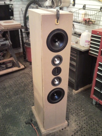

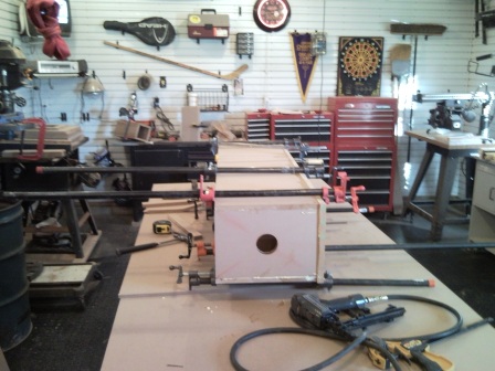

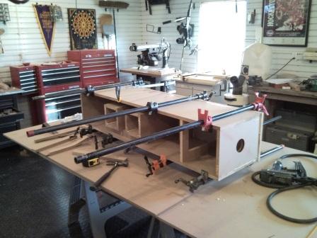

                                Sorry for the long delay, but we have made some progress. As you can see from the pictures, we have one working speaker, though we haven't attached the baffle yet. Sounds very good, though I know it will sound better.
                                Some of the problems we encountered:
                                I don't know why I didn't figure out that a 3" port wouldn't fit in a 3" hole, but I didn't. So we had to enlarge the already drilled hole, which was tricky to do precisely. Also, getting the port flare to fit in the base so it could be screwed to the underside of the top of the base was very tricky. In fact we couldn't get it all the way down and settled for sliding in some shims and screwing through them to the base.
                                Also, for some reason, the tweeter wouldn't fit in between the mid-tunnels and finding a way to cut away a little of the tunnel material to get it to fit was difficult.
                                We had hoped to just use screws to attach the drivers, but a screw into MDF seems to be a one shot opportunity, and we have already had some reason to want to remove them. So it looks like we'll go back and use one of the t-nut or hurricane or barbed or whatever. I know I saw a thread about them a few weeks back, so I'll read that before we decide which way to go.
                                Finally, for finishing, my wife was very supportive about bringing these big guys into our library (which sounds a lot fancier than it is- a 28' x 24' x 8' cinderblock room on a concrete slab. But it is lined with filled bookshelves around the entire perimeter, so sound is pretty good.) until she saw the picture of the one nearly finished one and it sank in just how big. So she wants them as unobtrusive as possible, so I think we'll cover them in black matte laminate, which will pretty much match the A/V stack they'll be beside. I mention this because the roundover on the front baffle will make the front non-laminatable, or so it seems. So, I need to be sure- the roundover is for audible purposes, not just appearance, right?
                                Sorry if this is too long. I've got another question, but I'll put it in a new post in case it shouldn't even be in this thread.
                                Thanks again for all the suggestions. We did borrow a router that would take the jig, and I did get the xovers down to two boards.

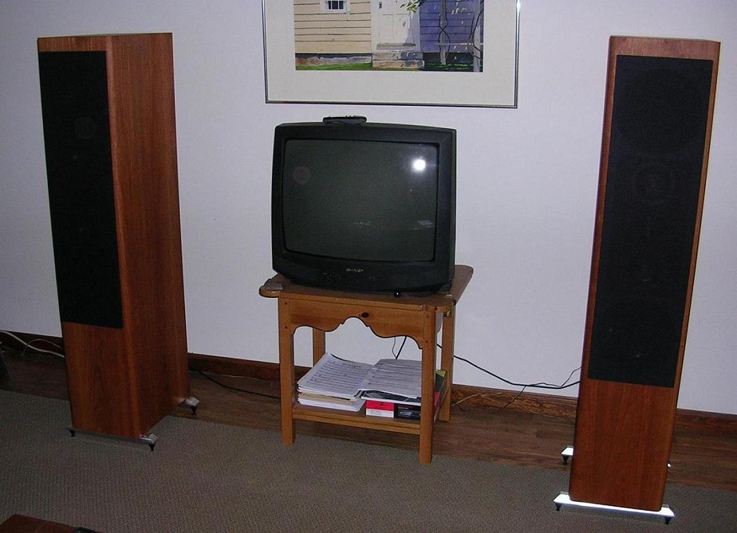

                                        Hi Kevin,
                                        Yes, the roundover helps smooth the frequency response. You can use a 45 degrees bevel on the sides rather than a round over and get just about the same effect. That would allow you to use the laminate and paint the baffle. Worst case if that doesn't work is to do square corners. Round or bevel is better but square will work as a last resort.

                                          I've found that using screws into MDF for retaining the drivers is fine. Make sure you use the correct size pilot hole for the screw you've chosen. The threads seem weak in the bare MDF, but once the MDF is sealed, the threads get strengthened. I've sealed my speakers with Seal Coat, and 50:50 wood glue:water. I prefer the glue/water mixture. It doesn't smell as bad as Seal Coat, cleans up easier, and is probably a better substrate when veneering (if using the iron/glue method).
                                          Get some of the 50:50 glue:water mixture into the threaded screw holes, and they will be plenty tough enough. You can always try it in a scrap piece of MDF, if you are in doubt. Drill the proper diameter pilot hole for the screw, then drive the screw in. Remove the screw, and seal the MDF (at least 2 coats). Don't worry if the hole is totally filled with the fluid. It soaks in, and doesn't build up much at all. The threads will be very tough.
                                          Maybe a note should be added to the Statement build thread regarding the tweeter cut-outs in the tunnels (if it isn't already mentioned in that long thread...I cannot remember if it's mentioned). I looked at many build threads before building mine, so I knew to cut about 1/4" from the tunnels (where the tweeter would intersect) prior to assembly. If you look at the original Statement plans, and do some math with the Fountek mechanical drawing, you'll find that there isn't enough room for the tweeter...but you've found that out anyway!

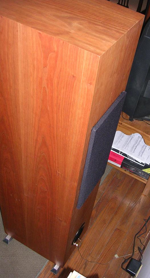

                                              For the hidden grill mounts, I mounted the Parts Express magnets (they sell them in an 8-pack) into both the speaker enclosure and the grill. Keeping track of the polarity is very important. Also, keep the magnets as close to the surface as possible. They will have more attraction to each other if they are closer to each other. I used 4 magnets per grill. They've been holding on fine, but if I could do it again, I'd add more magnets. I'd hate to have the grills slide off and shear the surrounds.
                                              I'm joining the Statement family. I've been working on mine for about a month or so now. Progress is slow, due to all the other things summer brings along with it (and my wood shop is quite limited, so I'm slow). Thanks to Jim, Curt, and Wayne for the excellent design and plans. I've been having a lot of fun building these.
                                              I've been leaving my grills off, unless people are coming over to the house. My cherry veneer is darkening with the sunlight hitting it, and it was remaining lighter colored where the grills were blocking the sun. My family knows enough to keep their hands off the drivers, but guests don't seem to understand. I don't think most people have ever seen what's behind the grills of a speaker, so when they do, they want to poke at them, for some strange reason.

                                                    The pictures were great, thanks! I didn't appreciate how much you'd cut away. Our ideas aren't so different after all. I do like the look of the grills when they're on. Did you worry about what cloth to use? Can you hear a difference when they're on?
                                                    Those are some good-looking speakers. Really like the base, but I think we're going with the usual MDF stack with the cones on the bottom.

                                                      I used the black grill cloth from Parts Express to cover my grill frames. I don't hear a difference, but I am not the best critic. I'm not sure I can hear subtle differences like that. I went to DIY New England and listened to many speakers, but I don't think I have a good ear for picking out problems (which is probably good...people who can hear the difference between grills/no grills must go nuts with subtle imperfections...I don't think I want that curse!).
                                                      I made the outriggers because I don't like the look of the fat-bottomed base of the Statements. I wanted to make mine without any base/outriggers, so it would be tall and thin all the way to the floor, but I couldn't find a veneer sheet big enough to cover that.
                                                      I'm glad you can see the attachments and they were helpful. I tried to do some attachments on a different post, and I could see the 'attachments' but no one else could. Hopefully soon I'll go back and repair my build thread. Let me know if you want to see any more photos.
