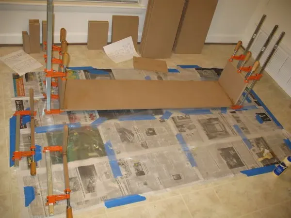

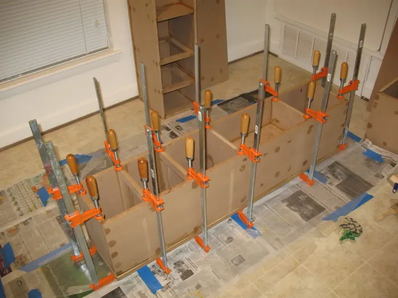

    Gluing on the top and bottom panels:
    Click image for larger version  Name:	IMG_0354.webp Views:	1 Size:	24.7 KB ID:	942171

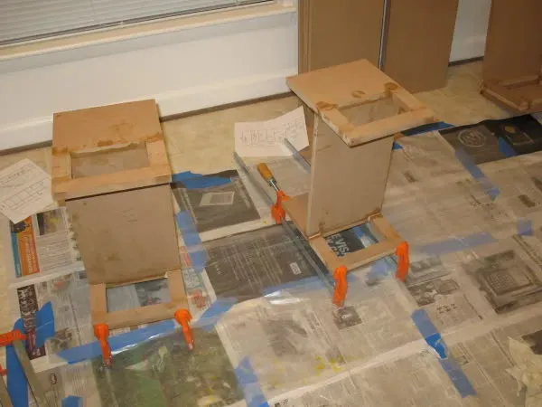

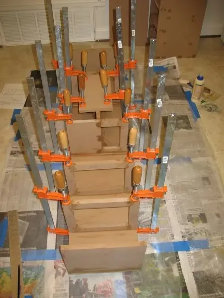

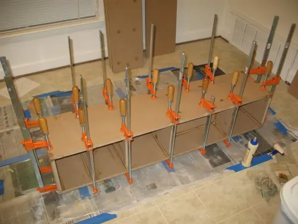

    Gluing on the top and bottom for the second cabinet as well as for the mid chamber:
    Click image for larger version  Name:	IMG_0355.webp Views:	1 Size:	25.3 KB ID:	942172

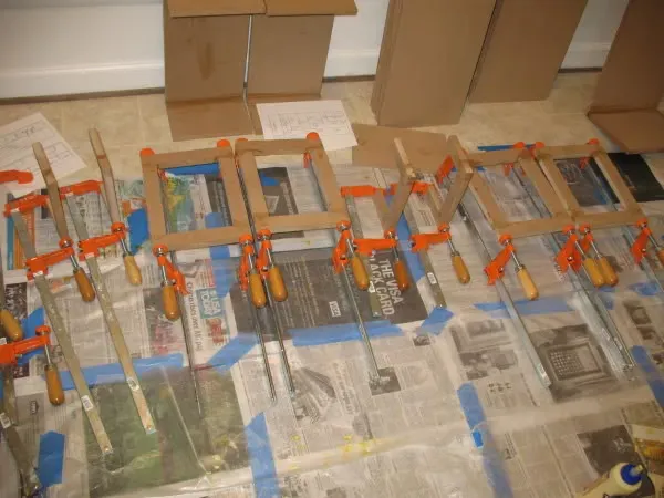

    Gluing together the braces:

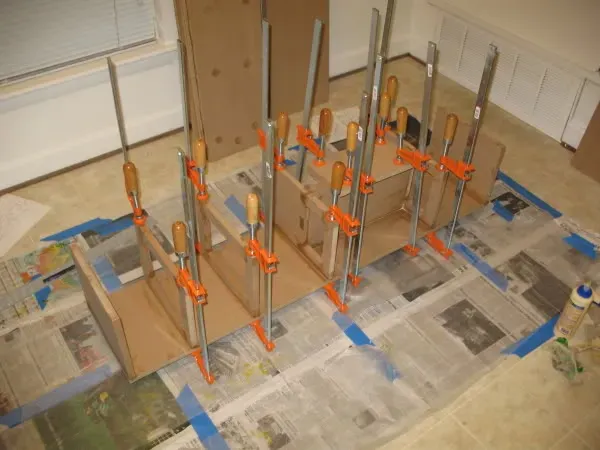

    Click image for larger version  Name:	IMG_0358.webp Views:	1 Size:	31.3 KB ID:	942173
    Attaching the rear braces to the mid enclosures:
    Click image for larger version  Name:	IMG_0359.webp Views:	1 Size:	22.9 KB ID:	942174

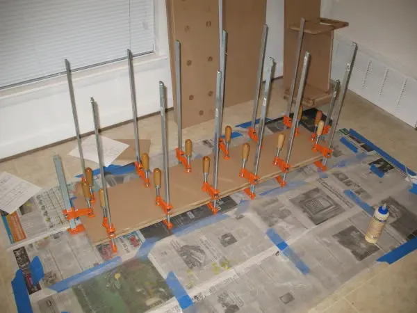

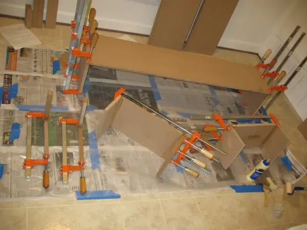

    Gluing the braces onto the cabinet side panels:
    Click image for larger version  Name:	IMG_0363.webp Views:	1 Size:	26.0 KB ID:	942175
    Click image for larger version  Name:	IMG_0364.webp Views:	1 Size:	29.7 KB ID:	942176
    Attaching the opposing side panel:
    Click image for larger version  Name:	IMG_0365.webp Views:	1 Size:	25.5 KB ID:	942177

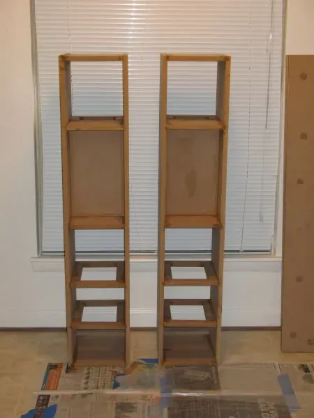

    Current state of the enclosures:
    Click image for larger version  Name:	IMG_0369.webp Views:	1 Size:	13.8 KB ID:	942179
    They look a little crooked in the photo but I think that is just an optical effect. The measure square.

          Back and time for an update. Unfortunately I haven't accomplished much yet as I've been doing more work on my WTMW, but I have been working on them.
          Gluing on the rear panels:
          All of the panels have also been flush trimed and I've cut all the veneer pieces to size though I didn't take pictures of that.

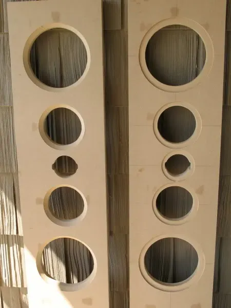

            It's been a highly productive weekend.
            The baffles have been routed including the chamfer for the mids and woofers (kinda hard to see in the photo). It seems I drilled the holes a little off for the mids and tweeter as the span of MDF between two of them cut out during routing. Thankfully I wasn't so far off as to need to file down the flanges at all. That is some tight spacing Ryan! Oh well, once it is painted and the drivers are installed I don't think anyone will notice.

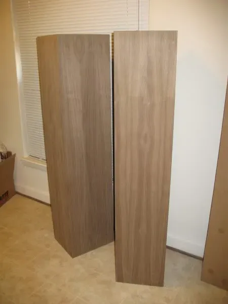

            I finished veneering the cabinets.

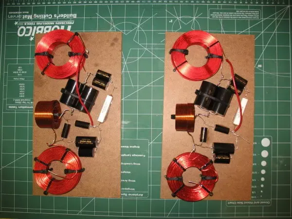

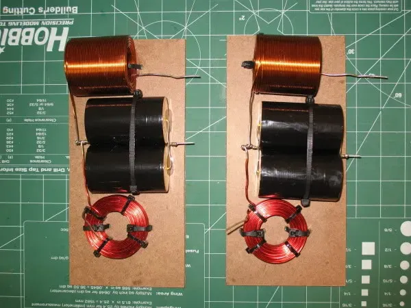

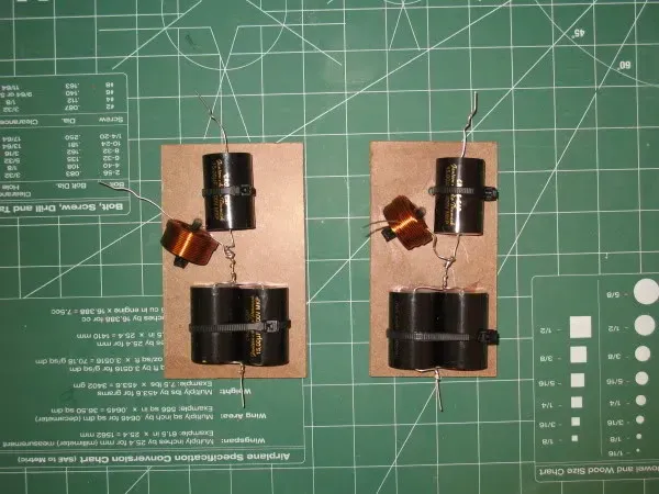

            I also finished all of the crossovers!
            Tweeter:
            Mid:
            Woofer:

              Looking good. Looks like you went with some fancy caps. What gauge are those woofer inductors?
              • kirknelson
                • 89
                I just went with the Jantzen Crosscaps except for the woofer which uses the basic Daytons. Not too fancy but good caps.
                The 2.75mH coil is 15 AWG and the 400uH coil is 14 AWG. A DCR wasn't included on the crossover schematic so I figured the lower the better. :P
                It's good to know that my MTM spacing is "as designed."
                  Yeah, Jim Holtz really likes the Jantzen. The difference in price is not much. I've been tempted to pick up some for the tweeter to see if I can hear a difference. maybe one of these days.
                  Sorry I didn't put the DCR of each coil. I guess that makes sourcing from different people difficult. Chris designed using the 14 awg perfect lay. The DCR is .39 vs. .59 for the 15 awg. Not a huge difference. Probably be ok. Just will lower the bass a tiny tiny bit. Push them closer to the wall.

                      I used a paper-backed Cherry veneer and will be staining them with Walnut to match my NatPs.

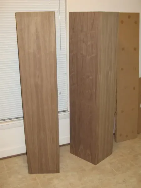

                            It's been a long couple of weeks as I worked on the finish of the speakers but I am very pleased to finnally be able to say my Khans are done!
                            Left Speaker
                            Right Speaker
                            ...and of course the obligatory Mission Accomplished snap.
                            They are still breaking in and I'll wait to comment on their sound until they do, but I can already tell they will be fantastic.
                            Last edited by theSven; 24 June 2023, 14:28 Saturday. Reason: Update image location

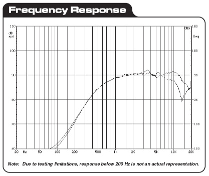

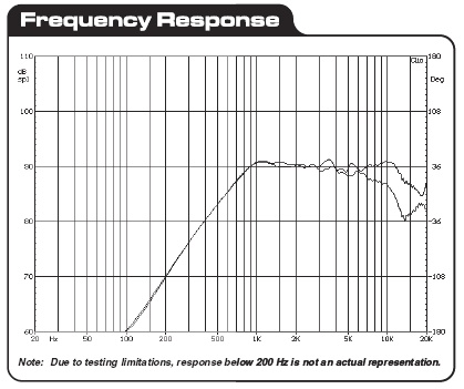

                                    One quick question, actually for the designer. I noticed in the BOM you used the shielded tweeter rather than the unshielded version. I wonder if it would make an audible difference?
                                    Duc
                                      Good question. I'm hoping that was just a typo by Kirk.
                                      Mine DEFINITELY use the NON-shielded version. I believe that the tweeters are different enough that they aren't interchangeable. CJD has a warning on his RS150MTM page that you can't switch them.
                                      CJD will hopefully add more detail soon.
                                      • hoxuanduc
                                        • Jun 2008
                                        • 5
                                        Yup, I found the link for the rs150 MTM designs where there are separate crossovers for the shielded and non-shielded versions. So that answers the question - the change would be audible.
                                        Duc
                                        • kirknelson
                                          • 89
                                          Originally posted by hoxuanduc
                                          Very nice!!!
                                          Duc
                                          Oh, my...wonder how I missed that. I guess I was a little too hasty in adding things to my cart. ops:
                                          Well the correct tweeters are now on order and looking at the Parts Express FR plots I think you may have located the source of that upper mid-range tilt I was hearing.
                                          Shielded version:
                                          Unshielded version:
                                          Thanks for catching that for me. Unfortunately that was a pretty expensive mistake since I ordered the drivers more than 45 days ago. :cry:
                                            Don't forget to compare impedance, which compounds the issue.
                                            There may be a bit of extra energy in the mids as well, with a fairly simple resistor-tweak to work it out.
