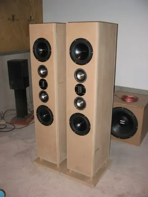

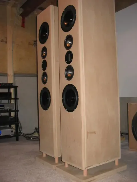

                  Finished the build! (except veneer, and excluding the center :W )
                  I've got them in their temporary location currently, soon I'll be building the room for them. In this room, so far, without any run in at all they sound EXCELLENT!!! I was really quite honestly expecting to have to pull them appart to debug crossovers, but these sound amazing right out the box! (so to speak...)

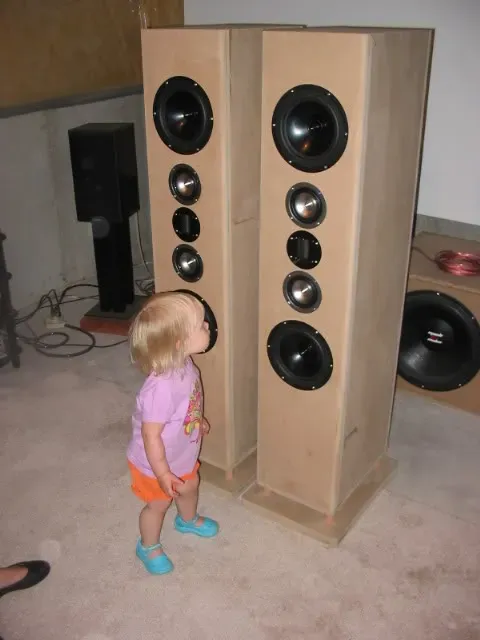

                  Some pix:
                  daddy build speakers!
                  shot of them both:
                  Looking up...
                  backs: (foams a little rough, to be tidied after some position experiments...)

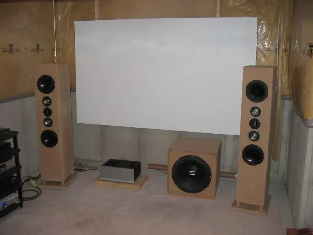

                  and finally, in place:
                  Veneering is going to wait a bit, at least untill I get the center done, and possibly (probably) untill I get my room built.
                  Thanks again to Jim and Curt for their design!

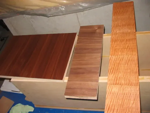

                                                I'm about to start veneering my cabinets, I'm going to go with a nice walnut that I got for pretty cheap off E-bay, because it's only 5" - 6" wide. I've veneered quite a few sample pieces and I think my technique for edge matching is getting to the point where I'm comfortable starting the job.
                                                I'm still looking at a 1/2" roundover on all my cabinets. I wonder if there's anyone in the GTA with a router and 3/4" roundover bit who might give me a hand turning my 1/2" roundovers into 3/4"? I'd make it worth your while (case of beer, bottle of your choice etc) TIA!
                                                Here's some of my samples, 2 of walnut with different stains, and on of a waterfall "anigre" I bought because it was cheap and I was already paying for shipping...

                                                  It's a little bit of labor, but the 3/4" roundover can be sanded, if you can't find someone with a router and bit.
                                                  I chamfered my edges (with a small router, but a circular saw would work, too), then used a hand-sanding board (automotive body tool shown in the photo) to remove the remaining material. The roundover is very uniform. I never would have thought the roundover could be this good by sanding it, but it is really nice.
                                                  I just started working with some test pieces of veneer, too. I'll probably start veneering my Statements this weekend. Your walnut looks nice (I like the darker stain).

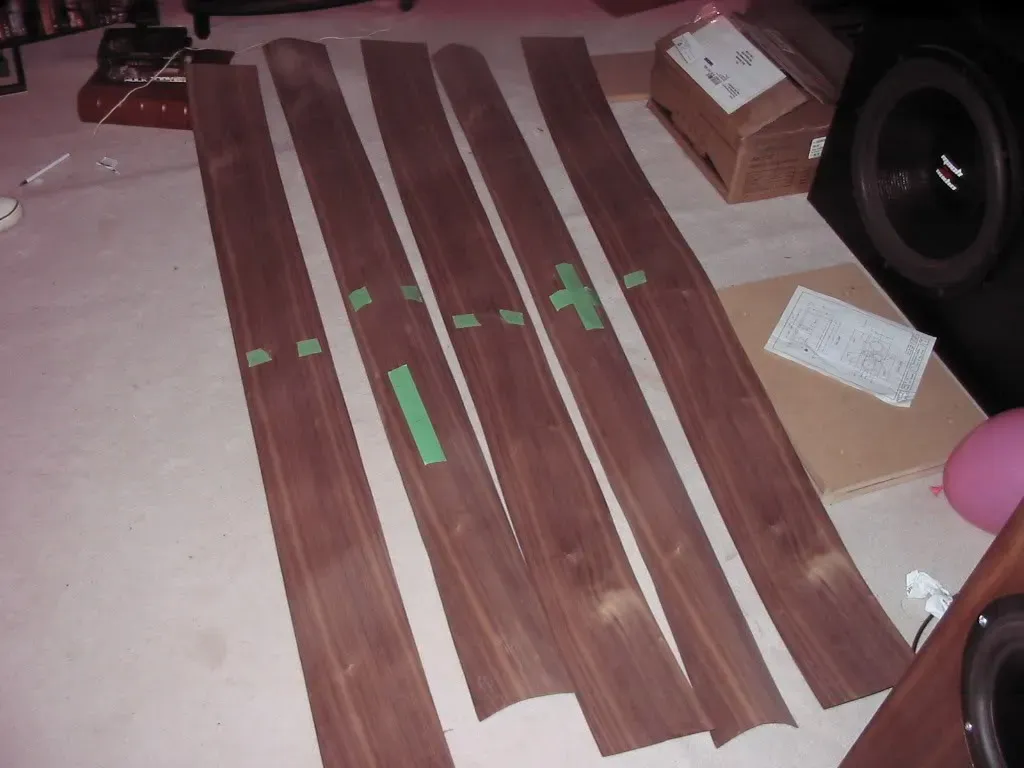

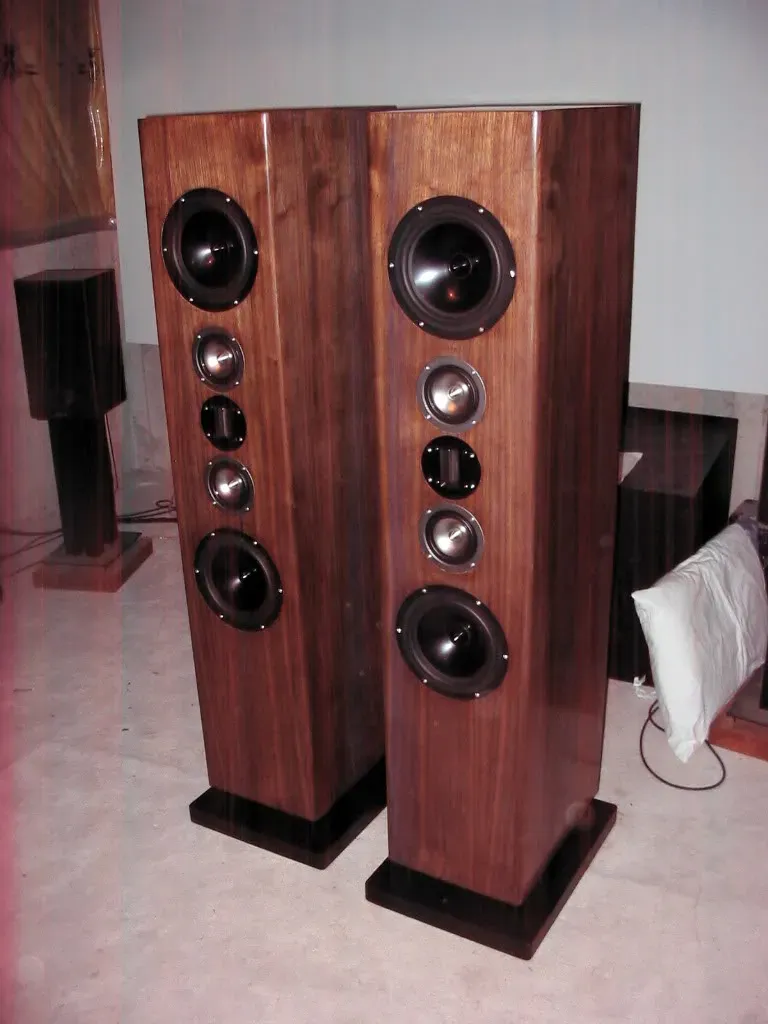

                                                    At long last I've finished the veneer for this project! I used Walnut veneer, raw realwood veneer, non paperbacked. I also got it in 6" wide sheets off E-bay. This made the job pretty difficult, but not terribly expensive. Enough veneer for a full LCR cost me $25 including shipping. (the glue cost me more than the veneer... :roll: )
                                                    Laying out the sheets to check for grain matching: (this many plus 2 more for the 3 sides of one speaker, not including top)

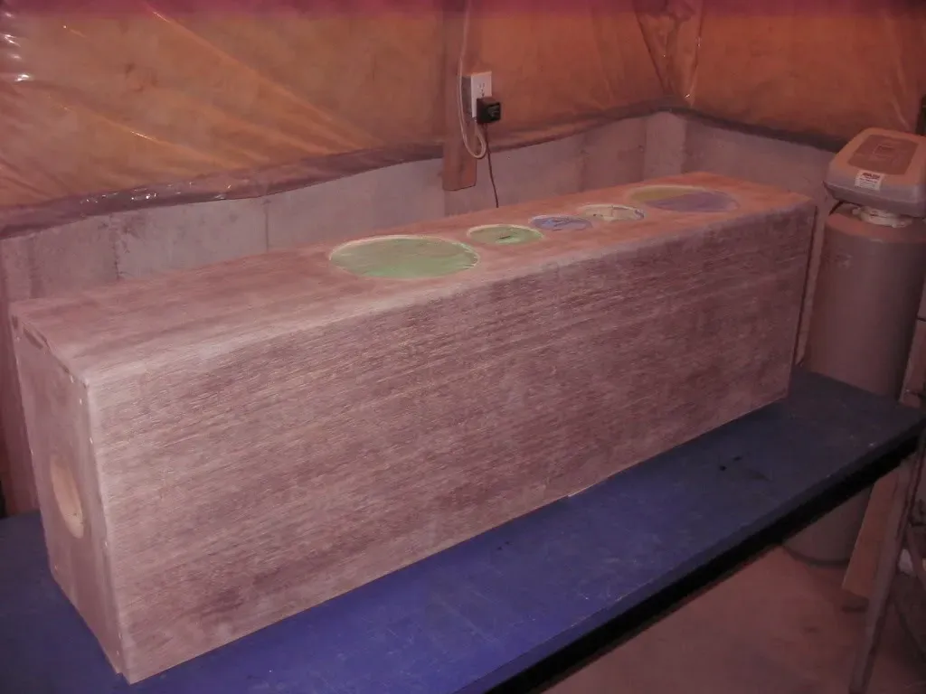

                                                    I sanded the whole cabinet agan with 80 grit paying special attention to the 1/2" roundovers.

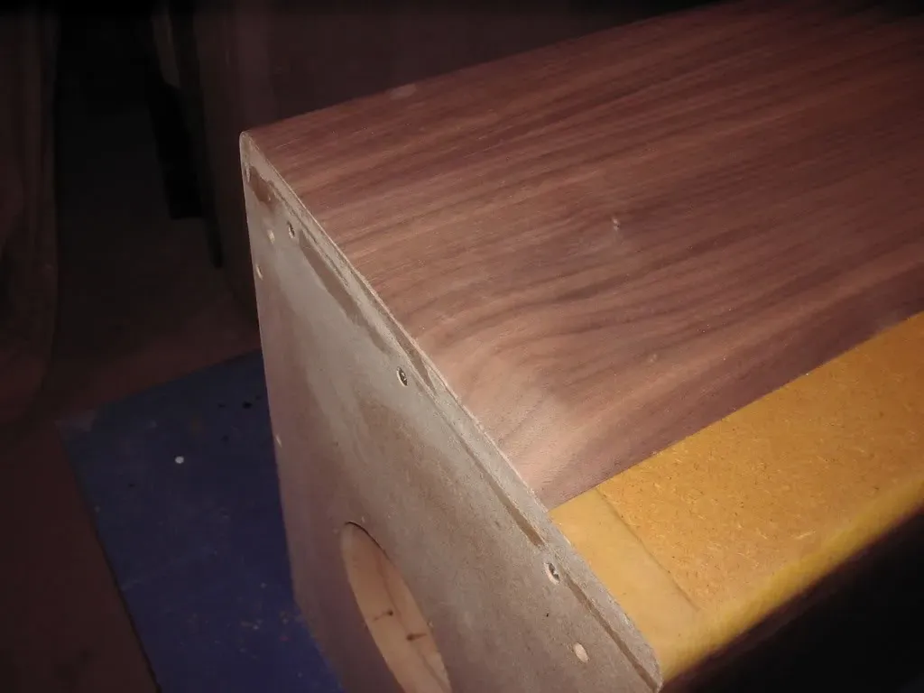

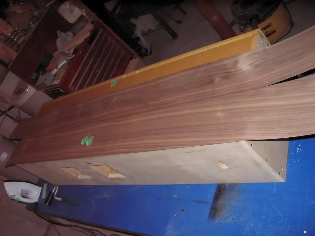

                                                    I found that good technique for working with the raw veneer was a pretty thin layer of glue on the veneer itself, and a much thicker layer on the cabinet. Too much glue on the veneer and it would warp and curl, and also crack very easily. Also getting a good thick layer of glue close to the edges of the cabinet is of paramount importance. I'd put a layer on, and then add another layer to the edges.
                                                    Getting started:
                                                    around the bend:

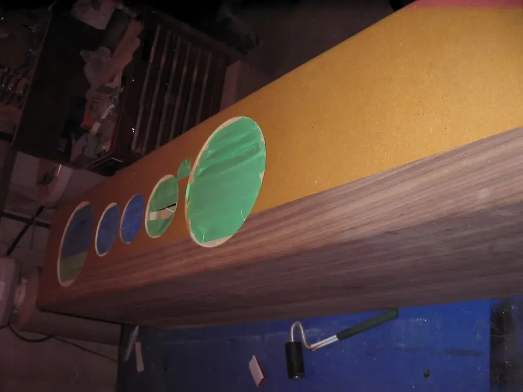

                                                    I found that trimming each piece after application was much easier than waiting till the end. Trimming neatly was one of the major hassles in working with raw. I'd trim close and then use a (non powered) palm sander to match it up.
                                                    Application done and first sanding with 240 grit

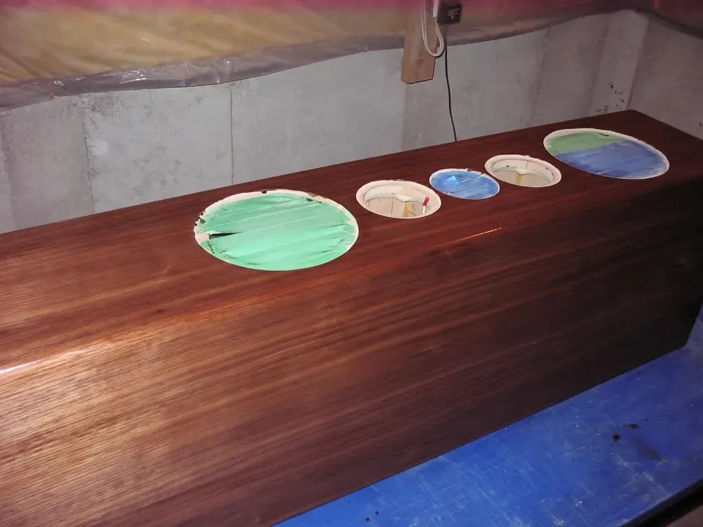

                                                    For finishing I did a ton of experimenting and found a polyurethane that had stain "built in". I did a coat of poly with stain, sanded with 240, another coat of poly w stain, scrub with double-zero steel wool, then an application of regular semi-gloss polyurethane, and finally a scrub with 0000 Super-fine steel wool.
                                                    after the first application

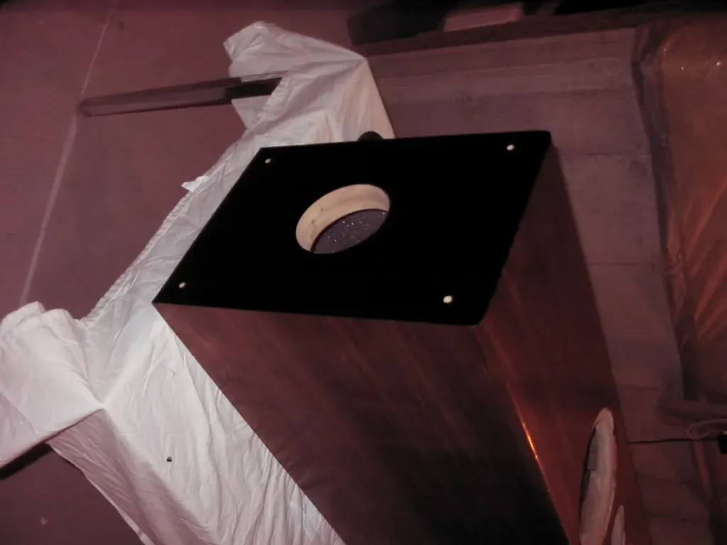

                                                    bases and bottoms are peel-and-stick flat black from PE
                                                    I was going to veneer the bases but my wife convinced me to go all black. with dark carpeting, it will look like the speakers are floating. (I dig that)

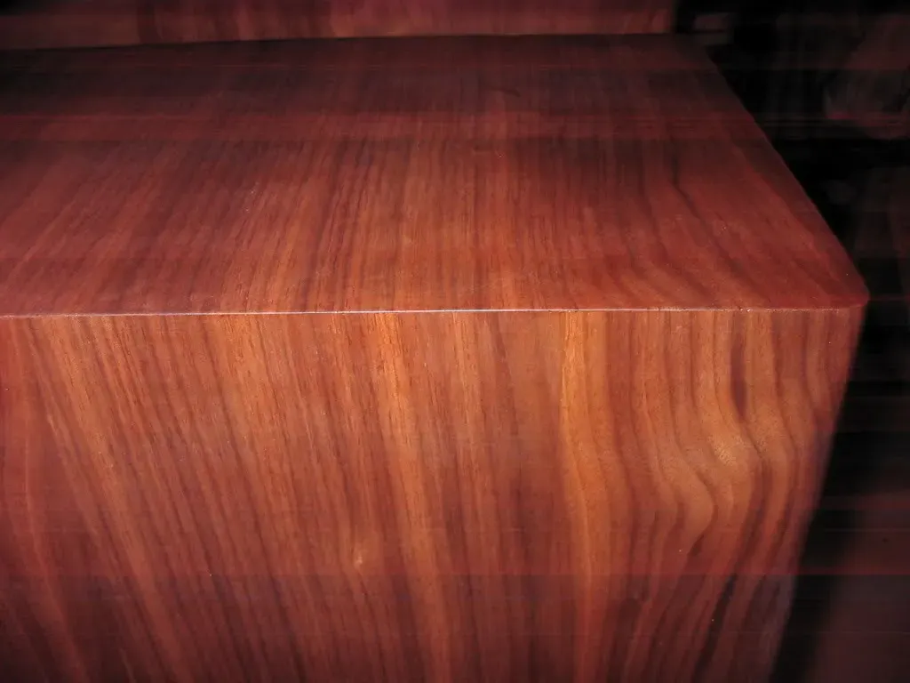

                                                    Finished: (sadly my camera is terrible, they look way better in person)
                                                    edging: (also looks better in person)

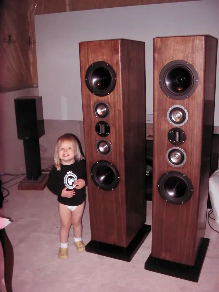

                                                    with my Daughter. She doesn't like pants. I'm in trouble.

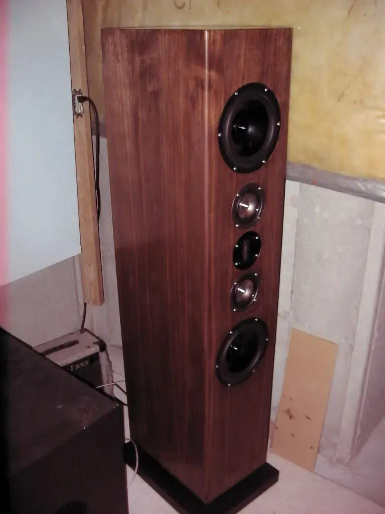

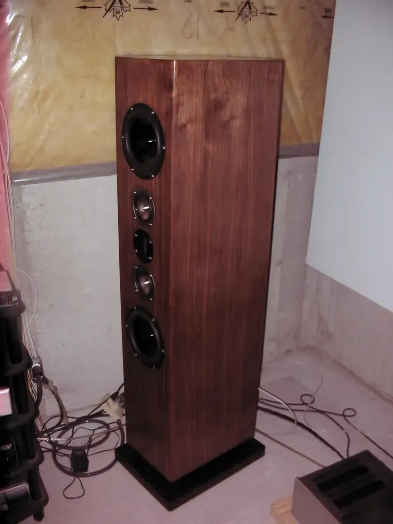

                                                    and a couple of them in place:

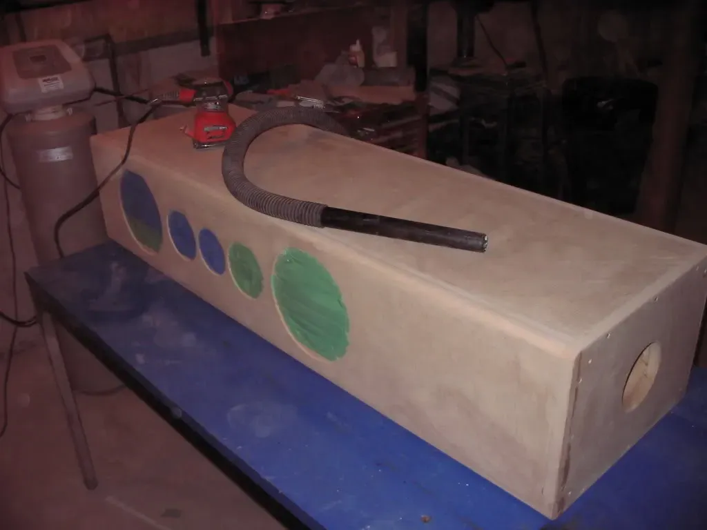

                                                          Click image for larger version  Name:	veneer001.webp Views:	0 Size:	23.5 KB ID:	940970
                                                          Getting started:
                                                          Click image for larger version  Name:	veneer008.webp Views:	0 Size:	35.5 KB ID:	940971
                                                          around the bend:
                                                          Click image for larger version  Name:	veneer009.webp Views:	0 Size:	29.5 KB ID:	940972
                                                          Click image for larger version  Name:	veneer013.webp Views:	0 Size:	28.5 KB ID:	940973
                                                          Click image for larger version  Name:	veneer018.webp Views:	0 Size:	51.8 KB ID:	940975
                                                          Click image for larger version  Name:	veneer019.webp Views:	0 Size:	23.3 KB ID:	940976
                                                          Click image for larger version  Name:	veneer020.webp Views:	0 Size:	43.7 KB ID:	940977
                                                          Click image for larger version  Name:	veneer025.webp Views:	0 Size:	33.7 KB ID:	940978
                                                          Click image for larger version  Name:	veneer039.webp Views:	0 Size:	32.0 KB ID:	940980
                                                          Click image for larger version  Name:	veneer041.webp Views:	0 Size:	27.5 KB ID:	940981

                                                          Excellent work, and a most worthy signature...
                                                          • Silversmoky
                                                            • Nov 2007
                                                            • 178
                                                            Beautiful! Nice Work Your seams on the veneer look really smooth and tight.
                                                            • dumaresq
                                                              • Mar 2008
                                                              • 96
                                                              At least your daughter wears underwear... both of my are constantly nakkid drives me nuts!
                                                              • john trials
                                                                • 449
                                                                Wow. Those look so nice. I like the long straight grain of the veneer. It's amazing that you joined the pieces of veneer. I don't think I could do something like that without leaving gaps.
                                                                • locojones
                                                                  • 8
                                                                  I particularly like the choice of the chromed screws holding the drivers in place! For whatever reason, it looks fancier than black ones.

                                                                          wow, clean work. they look beautiful! congrats.
                                                                          this might sound tacky but... I imagine golden screws would look the best. i come about with this conclusion from googling antique furnitures and finding the ones with golden inlays look the fanciest and just 'right'. the swing arms on grandfather clocks are usually brass, not chrome- i'm guessing cosmetics being no small reason of it. definitely not an easy find but brass screws perhaps? this is what i'll be trying with my statement monitors build along with hardwood cabinets. parts arriving next week- all jentzsen supreme caps for non woofer circuits! :B it was costly but will be glorious.
