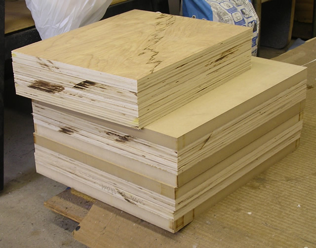

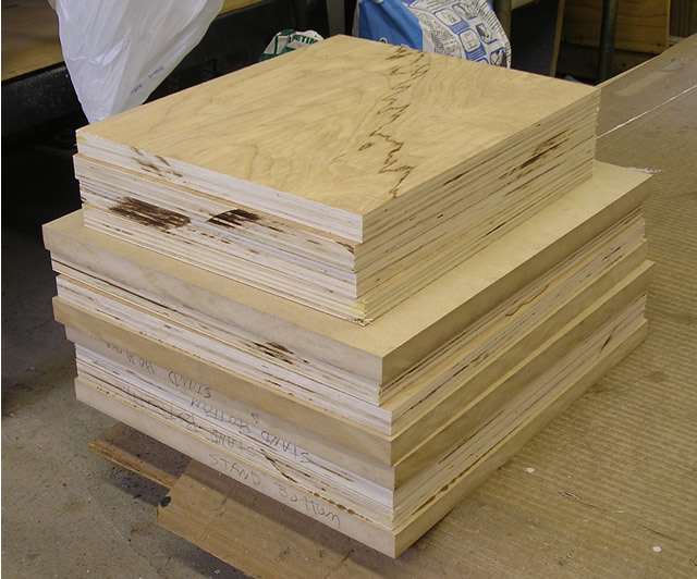

    Having finished the front LCR speakers with the full size Statements and the 2rCC modified Statement center channel, it's time to start building DIY surround speakers for my 7.1 system.
    Four Mini Statements will be built with modified cabinets. Also instead of building bases, I'm building stands for them. The finish on the cabinets will be like my Statement towers as in the picture below, but instead of doing glossy black by hand I'm going to use a glossy black laminate as described in this thread. Just a fair warning; I'm building these at my leisure so it's going to be a slow process! 8)
    I purchased all of the parts needed to build these last year around this time. Also around this time last year the wood for the minis cut using a huge table saw that I was fortunate enough to have access to. Each cut was done after setting the fence one time per side, so identical pieces were cut. The birch sides were cut slightly oversized so they can be flush trimmed to make things appear straight.
    Click image for larger version  Name:	rawWood.jpg Views:	4219 Size:	93.5 KB ID:	869980
    The spec'd height for the Mini Statements is 39", but my cabinets will be 28.5" tall. And the spec'd depth of the Mini Statements is 13.75", but mine will be the same depth as the Monitor Statements at 12". This makes the modified cabinet volume almost identical to the Mini Statement Center's cabinet volume. I'm going to try them ported, but I'm not going to rule out stuffing the port to go sealed if there are any placement issues. They will be crossed over at 80Hz, so I'm not worried about bass extension below 50Hz. Some Google Sketchups are below; note that the driver spacing isn't accurate but everything else is:
