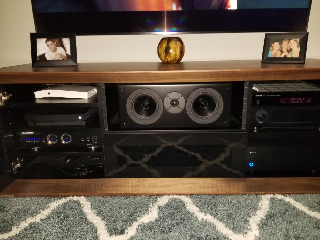

                    This is my center channel. Please take a look and let me know if you think I need to replace my existing before moving on to the towers. Again, I appreciate the help.

                      So, I cant fit the height of this center into my entertainment center. I have the width room, but not the height. Is there another option?

                        If not, could I upgrade my drivers in my existing cabinet to make for a better center if the ones already loaded won't work?

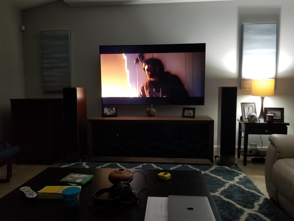

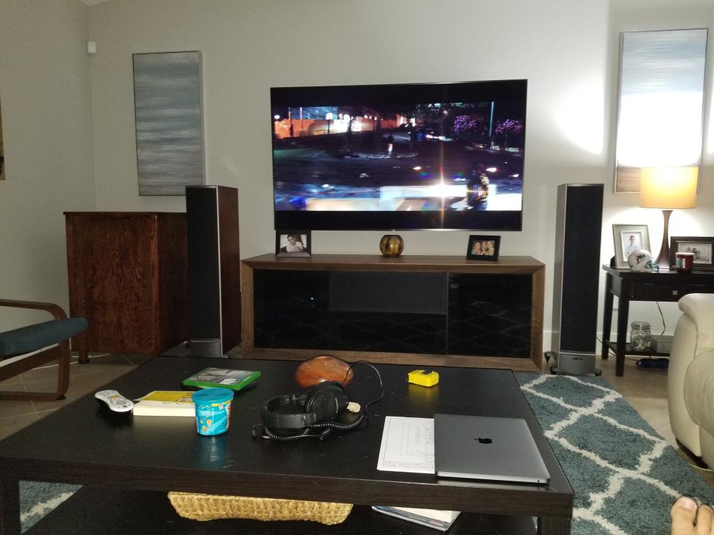

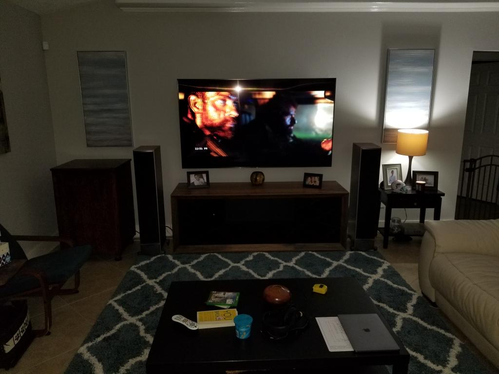

                            Can you show us a picture of your current setup so we can see how your center fits? Also, how tall can you go?

                              25 wide by 9 high. I will try to upload photos
                              • rick844
                                • Jun 2019
                                • 232
                                Photos

                                    Receiver is Yamaha rxa 2070
                                    • rick844
                                      • Jun 2019
                                      • 232
                                      Photos
                                      • rick844
                                        • Jun 2019
                                        • 232
                                        The giant box on the left is a 15 inch ported sub with more than 800 watts, so I dont need sub. I just like to feel the bullets punch into the chest

                                          Sorry, the Statements II center is too large and simply can't be reduced in height enough to fit your space.
                                            Problem number two is the center is inset into an entertainment center. Unless it's specifically designed with an on wall crossover, it's not sounding as designed.

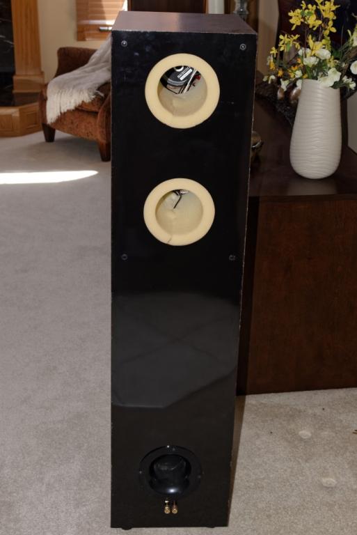

                                                The Anthology's are also an open back mid design and need 18" clearance to sound as designed. They will work with as little as 12" clearance but the sound stage starts to "flatten" and they sound like a conventional closed back speaker.

                                                  I can get as much as 14 inches off the wall. Also, are there any photos of the back on these? Cant tell by the drawings if the midrange ports exit the enclosure via the PVC tubes

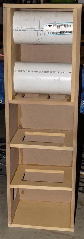

                                                    Also, how do you run the wires to the drivers? Do you cut small holes in the tubs?

                                                      Disregard my last two questions. I found a few threads on here where others have built these. I have enough ammo to get started.

                                                        Yes, it's a straight shot out the back of the mid tunnels. I'll try to get a picture later today and add it to this post.

                                                          The simplest method is to buy the parts kit from Meniscus and add the option for them to assemble the crossovers for you. https://meniscusaudio.com/product-ca.../speaker-kits/ Their prices are the same as what you'd pay elsewhere and its a one click shipping experience with everything you need except a cabinet. They will customize to your specs. Just for clarity, Curt and I don't get anything out of this. It just makes it simple for builders to get what they need.
                                                          BTW, I drill two 1/8" holes in each mid tube about in the middle for wiring. Choose the hole size based on the diameter of the wire you're using.
