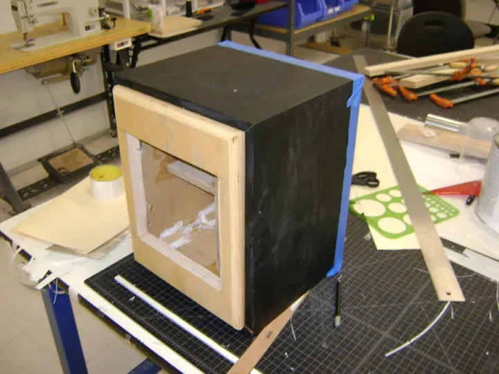

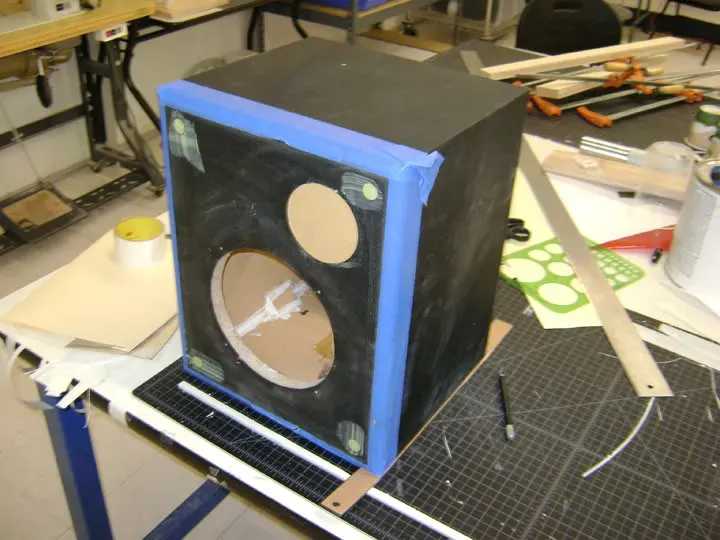

    Forgot to take any photos before I took the thing apart, but I think you get the gist of what it was... 8" driver, forward-firing 3" port... here you can see how I plugged the port with a disk of mdf... the green stuff is where I bondo'd in some holes that the grill used to attach to...

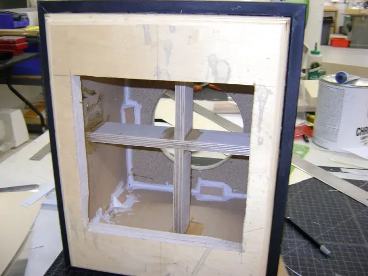

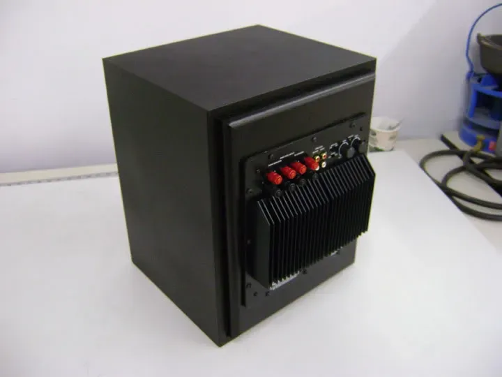

    Here you can see what I did on the back... I had a piece of 1" plywood lying around, so I made an adapter out of it to fit the new amp... there was a recess where the old amp used to sit, so I just glued the new piece to it... also routered the corners of it...
    Here you can see how I added a "cross" of braces to stiffen up the walls... seemed like a good idea, since the walls are only 1/2" thick... perhaps I should have done more bracing?... oh well, good enough... you can also see where I calked all the inside corners for good measure...

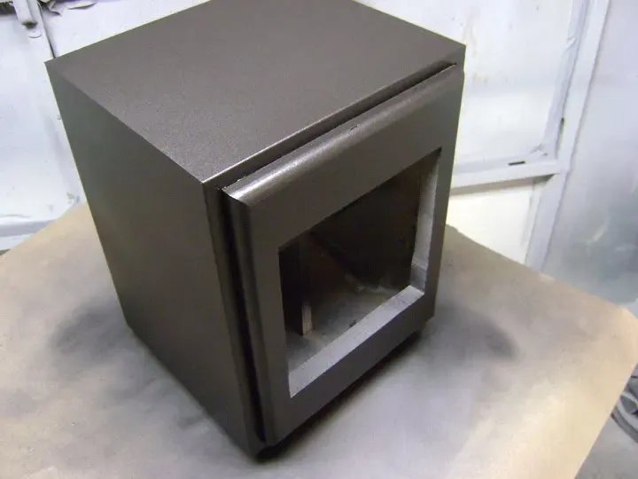

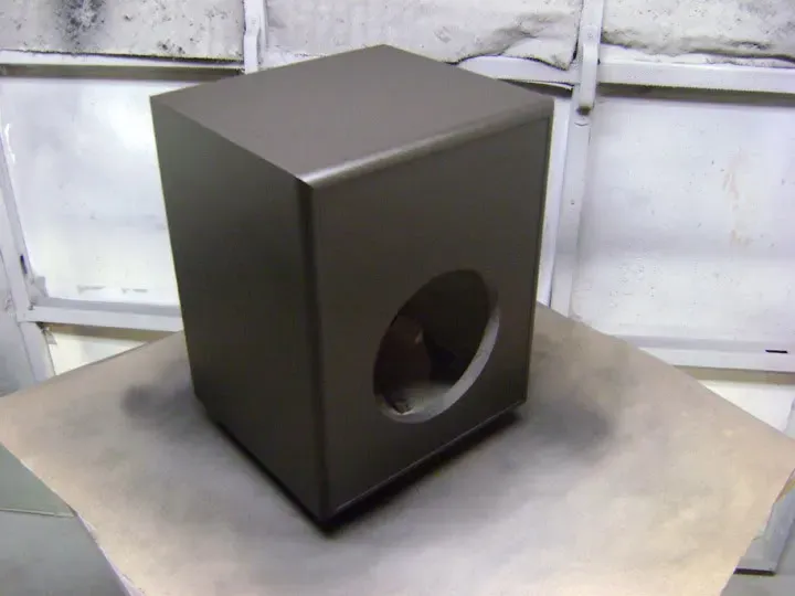

    Then a bit of sanding, 4 coats of heavy build primer, another quick sanding, and then 4 coats of black paint... the 4th coat done with the spray gun held at a distance of about 3 feet to achieve some texture... this trick works wonders for less-than-perfect surfaces...

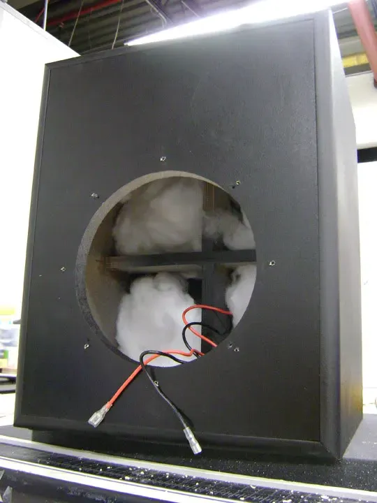

    Here I stuffed in about 3/4 lb of PE stuffing... the braces worked nicely to hold the stuffing away from the driver...
    Then I used some weather-stripping to seal the driver (why don't drivers come with gaskets? ), soldered the wires to the drivers (I don't believe in those cheap clippy things)...
    And... done. There ya have it. The world's blandest looking subwoofer. Although I think it's kindof bad*ss looking for that very reason... all sealed up with no ports... kinda cool IMHO ... like a mini Darth Vader sub... yeah... come on, work with me here

        Excellent point. You're absolutely right. Starting with a known enclosure with a known volume made it quite a bit trickier than starting from scratch. I spent more time in WinISD than I did actually building it.
        Got a chance to listen to it, and I'm absolutely thrilled. It plays very low, very tight and clean, and plenty loud. Remarkable for a sub this small.
