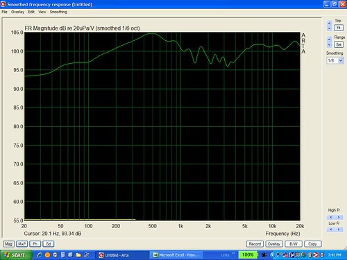

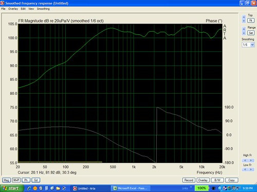

    The response looks OK to me, but what's up with the phase?
    You need to remove the time of flight on the impulse window. It will guestimate it pretty close by setting the marker (right click) at the peak of the impulse and then clicking 'get'. Then move the marker to where you want your gating to be.
      LSPCad manual shows how to do that... although you might be ok with the ARTA pink noise and not have to splice data like MLS.
      He isn't using random 'pink noise'. It's a periodic signal with a pink spectrum that in many ways is superior to MLS or chirp signals for measuring the impulse response. Floor bounce will still be alive and well but ARTA has the tools to splice in the nearfield. The manual is your friend.

            If you use minimum phase you have to set the driver coordinates of each measured driver in your crossover modeling program to represent the location on the baffle. You would also want to measure on axis of each driver at a set distance for each driver.
            The nice thing about the fixed mic measuring is you set all the driver locations to 0; however, you don't get the added benefit of modeling the power response.
            That's why it's good to do it both ways. Fixed mic, and on axis- minimum phase and compare the results.
            As Dennis mentioned, correcting the excessive phase rotations can be done by adjusting the time of flight.
              Hi Paul,
              Looks good. :T I found getting good measurements to be the toughest part of plodding through my first design project. You've got good help here from the resident experts. In case it clarifies things any more...
              The phase of the driver is the phase of the driver. It's pretty simple. What you've got to do now is have the computer see it in it's simplest form. I'm using LspCAD and in there, there is a distance box where you type in how far the microphone is from the driver. Start with 100 cm. If you see wildly wrapping phase like you have, just try typing in other numbers close by. 98, 103, etc. Get it to the point that the phase looks the smoothest, with the flattest plot and the least wrapping around. (This will not change the frequency response.) Then you're good.
              Now move to the mid driver. Do not touch the microphone. Do not change any parameters in the software. Just change the wire connections so you can measure the mid driver. Take the measurements. Then move on to the woofers. The woofers will be more complex because, as Jed says, you may need to merge near field data. But start by taking a regular measurement without changing anything. Once you move the microphone even 1 cm from it's original position used for the tweeter measurement, everything will be off (with regard to phase).
              Essentially, what you want to do is get pretty looking phase for the tweeter. Then take all measurements referenced to the tweeter. That way you have a complete set of measurements and when you change things in your crossover model, the phases will all move together or apart as they should.
              I hope that helps. Good luck. If you can get by these measurements... and you've already built your complex cabinets... then you're on to smooth sailing.

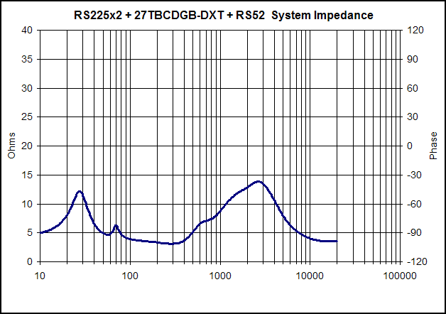

                            I've been using PCD to do some modeling using the measurements I've taken. One concern I have is that the system impedance seems weird (see attached). Will the peaking above 400 or so be a problem? I can get rid of it by deleting the HP on the tweeter. Nothing else I've experimented with has impacted it.
                            If this is problematic, does anyone have any suggestions?
