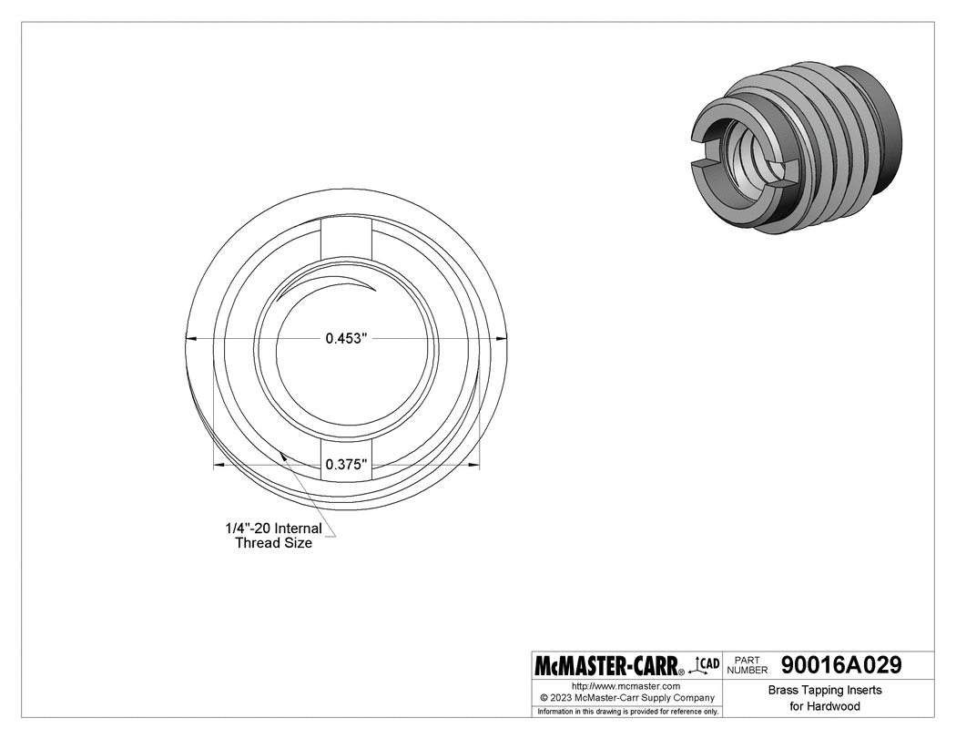

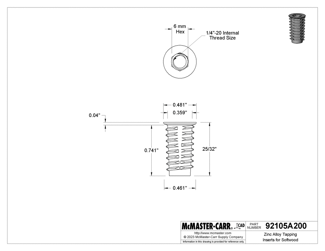

              There's a huge difference between zinc inserts and the brass or steel inserts. The zinc type has gaps between the threads and very limited holding power. The brass type holds much better, with continuous threads, although the threads are pretty fine. Also the brass type have a slot drive, which you definitely don't want to drive with just a slot screwdriver. Much better to either get the special tool (called a power driver), or install these with a cordless drill and a machine screw inserted inside the insert, with a couple of washers as bond breakers. The washers allow the screw to back out from the insert without binding and backing the insert out as well. I've installed brass inserts (sometimes called Roseannes) in MDF without using any glue, and they work very well. The washer also lets you install the insert to a consistent depth, because it puts the brakes on the driver. But you need a tough washer to survive more than a few hits this way. There's no substitute for case hardened steel for situations like these.

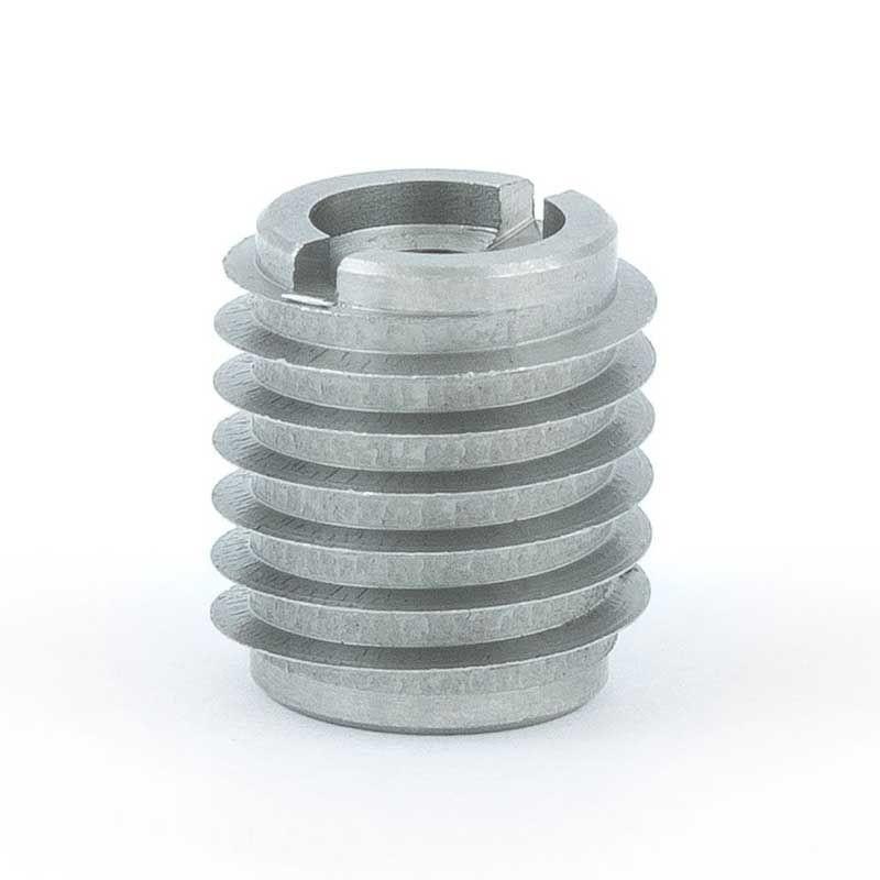

              The best type is probably the steel insert, which has coarser threads than the brass. These use an allen drive, which is user friendly.
