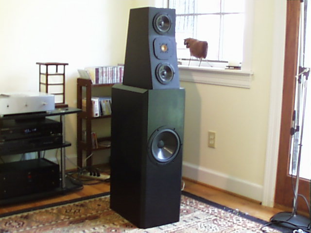

        The speaker above I built for a friend, since he helped me a lot on projects with my house. They turned out pretty nice, but I bet they would be better if we used RS drivers like you will be using.
        There is definitely something nice about having dual midranges. Perhaps it is the lower distortion, and when crossed low enough, lobbing is a non-issue.
        With Dual RS225 in a ported enclosure you are looking at 100-120L though. That's a big speaker so you might want to go sealed and add a sub @ 50HZ or so. This all depends on your size requirements, however; and how the lower bass bin integrates visually with the top MTM section. Since the MTM section won't be too large, a massive 120L box below it might be visually obtrusive. One RS225 ported might be enough as well.
        I've never used the RS225 in a sealed enclosure, so I can't comment on the subjective bass qualities. I've heard them in 50L (1 RS225) and 60L ported, and I'd say I preferred the slightly larger volume.
