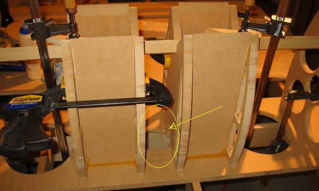

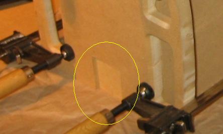

                                        Thanks for pointing that out. Probably not a big deal but one thing I have noticed is that the statements built are using a total of 8 1.75''x6.5'' vertical braces along the mid line tunnel passages. The difference comes while looking at the CAD drawing and it shows to use 4 1.75''x16.25'' vertical braces that connect the two tunnels together. (these are noted as K on the cut list) Again this probably isn't a big deal but when you brought up that area in your post I was just browsing through to check it out and see what you were talking about and noticed this. BTW, back on topic, so would stuffing the 3.5'' R13 fiberglass down the sides of the tunnels in the area of question constrict the airflow too much for the RS225s? I was going to try and follow this:
                                        but it is impossible to see what is done along the sides of the tunnels.
                                        Again, sorry for all the questions but I'm one of the guys who probably wouldn't know any better so I'm just trying to make sure everything is planned out so I don't screw anything up.
                                        Nate

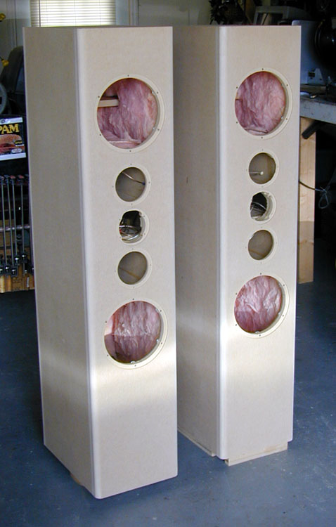

                                          Nate,
                                          That is a pic of mine during construction, here is a shot of the fiberglass without the front attached, maybe this will help.
                                          Let me know if you need any other pics, I took a ton.

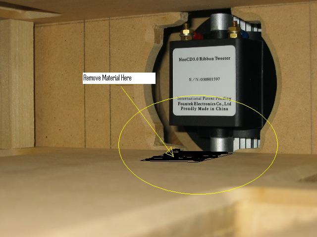

                                            Would it be a problem if I removed the lower base ('D') from the cut list and instead open that base up by just adding lenths to the baffle and sides a total of 3''? This would be used instead of the base, only for asthetic reasons, but would open up the 9'' port hole to a 10''x14.5'' hole instead with the back completely open to the room. In short the base would consiste of 3 .75'' sides and would look like a U from the bottom view.
                                            I'm not so sure if spikes can be used in my application. If the height of the tweeter can be moved a little I would just sit the entire speaker on the ground and forget about the spikes. This would result in the speaker being 2'' shorter though.
                                            Nate

                                              Hi Nate,
                                              You can use the U shaped base rather than the way I constructed it. If it's open at the back, make the base what ever height needed to get the overall height of the speaker up to 60" tall. The drivers can be adjusted up or down on the baffle to position the ribbon at ear height when seated but don't change the spacing between the drivers. Actually, the over all height can be adjusted in the base to help get the ribbon at ear height. Just don't change the cabinet volume or width and you'll be fine. You can also port it out the back if you prefer.

                                                Did Jim and I ever mention that Wade it the 'official' photographer for the Statements?
                                                I like the way Wade lined it, leaving ample breathing room around the mid enclosures. Looks like 1" batts from here. just about perfect in my book.
                                                Lengthening the sides, and forgoing the base is no problem. The tweeter is presently situated 38" above the floor, which is optimal. If the spikes are an issue, I'd just make the sides 5" longer to maintain the same height.
                                                From your favorite listening chair, measure from your ear to the ground. -That's the tweeter height to shoot for. If the room is reasonably large, and you will be sitting at least 10 feet from them, an inch or two either way will make no audible difference. You can always port out the back at the bottom as well, if that better serves your situation.

                                                                                      Thanks for the tips guys. Now not to beat a dead horse, but I went out to the local hardware stores again today to pick up a trim bit and I found a 5/8'' chamfer and 5/8'' round over bit. Just to make the process as easy for my dad and I we would really like to do this with the router instead of the wood rasp or jig saw, though these are still options. With that said, I couldn't even find a 3/4'' router bit at any of the places I went to. So, would one of these 5/8'' options work instead?
                                                                                      Also, its looks like the tunnel to the midrange drivers is going to get in the way of a large chamfer/round over, do the sides of the tunnesl need to be chamfered or anything?
                                                                                      Nate

                                                                                        Nate,
                                                                                        If you have a 5/8" round over bit, try it and see if it's enough when you test fit the drivers. If it's not enough, the rasp idea sounds like it would be a good inexpensive solution. You'll need it to knock the edges off the tunnels so the ribbon will fit. You can also knock off any edges in the mid tunnels with the rasp too.
                                                                                        • tpremo55
                                                                                          • 114
                                                                                          Nate,
                                                                                          ...You'll need it to knock the edges off the tunnels so the ribbon will fit. ....
                                                                                          Since I took a bunch of pics, I've attached a few here to clarify Jim's point about making room for the ribbons...
