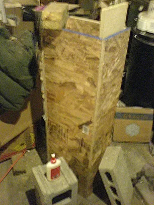

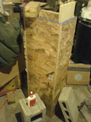

    I started construction o the towers to Zaphs specs. I am buying wood clamps tomorrow but for now I am stacking various sized cinderblocks and placing them in interesting ways, four two by fours will be placed inside for bracing, I might do a 5th one screwed into the back oriended differntly.
    I plan to glue carpet onto the back and side walls for dampening, its about 3/4 to an inch thick, anything wrong with that?

    The RS225 is quite a nice driver, although it doesn't stay clean high enough to cross to most tweeters. How many did you buy? The "Statement" three-ways use it, as well as Mark K's MT with the RS28a tweeter.
    I think that the RS225 could be great in a big three-way tower with a narrow-ish face. It would be a step down from the three-way towers the guys around here have done with the RS270, but it could also be narrower. The driver likes a big box, though, so if you make it narrow it will need some depth to get enough volume.
    Also, I don't see anything wrong with using carpet. Carpet pad might be better, but it's not likely to do anything *bad* to the sound.

            Yea if your using particle board you will want to use the carpet. I built a sub box out of particle board instead of MDF, had it given to me for free, and I plan on only using this as somewhat of a temporary box for a few years. Anyhow it was a severe pain trying to get them finished properly, especially on the corners since it chips up so easily.

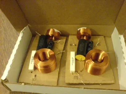

                So I did allot of work last night. I finished the crossovers

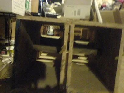

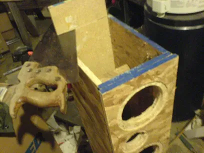

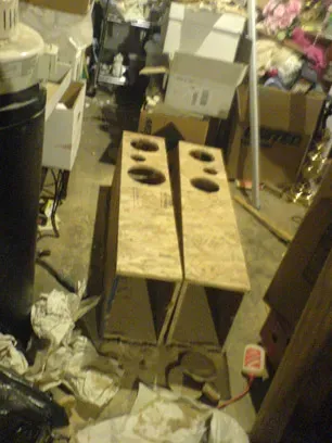

                I have the speakers firmly braced with 4 2x4's across

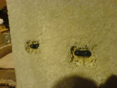

                I cut the backs to size and glued and nailed carpet to the back
ID:	942709 Click image for larger version

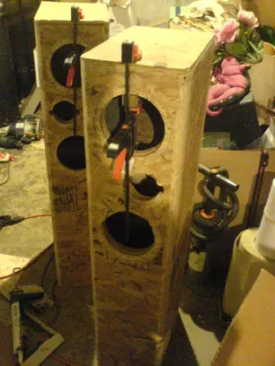

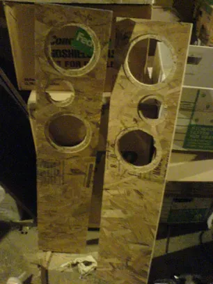

                Cobba on here lent me his router so I routed and attached my baffles, they are such a snug fit that the speakers will stay in without screws. I am pleased. Last but not least I rounded the sides
ID:	942711 Click image for larger version
ID:	942712 Click image for larger version
                I gave them a first listening even though the bottoms are incomplete. they sound a bit muddy on the low end but my guess is they just need some batting.

                some of the boomyness will go away with an airtight seal and a proper bottom. Biggest problem right now are the interconnects. They keep free spinning, and when they do that they break the solder (that was hard to do holding up half a cabinet).

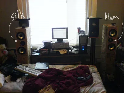

                        On a different note the h1212's came in the mail. I am listening to them side by side with the silks. I have to say its hard to say an outright preference. the h1212 seems to be less "rounded" then the silk if that makes any sense, more sting maybe. It seems to have a bit more airiness which is good on classical but I preferred the silk on a few songs. Its weird looking at all the graphs and gee-wiz stuff on zaphaudio and then seeing for yourself what those lines actually sound like. To me, so far, the h1212 seems crisper yet less forward.
                        I actually like the hex cover because it's idiot retarded: I was using a different electric screwdriver and it did not have variable speed, (I was not aware of this) and it plowed into the silks surround. I was not pleased but the damaged as near as I can tell is thankfully cosmetic ops:

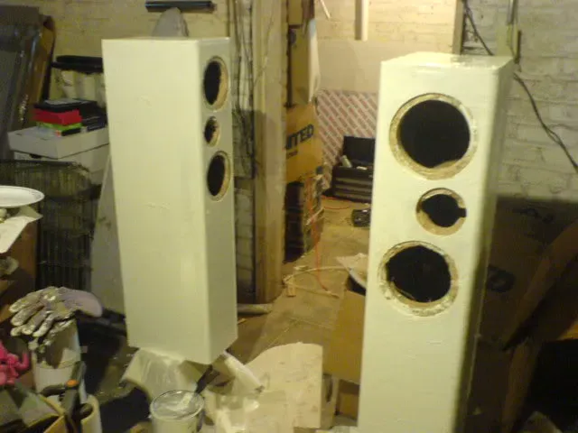

                                  They Are Alive!!
                                  Okay, I finished them. My friend is really excited after hearing them, currently he is re-orienting his room to accommodate them.
                                  Women have now christened them "Tom's Sexy Beasts".
                                  The OSB was a B@$% to work with but now I kind of enjoy the texture with Silver. It looks like beat up metal. The owner has warmed up to it too. it makes them interesting, more to look at. Here are the pictures:
