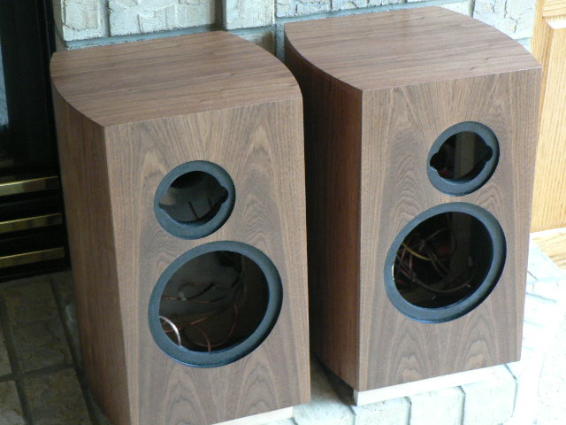

                          Nice work outfitter !! I am also doing a rounded version, just about ready for the black walnut veneer. I still have to roundover the port but that will be done after the veneer. I am debating if I want to add a maple stripe off set on the front like Sam's Orchids presented at the Iowa DIY, nice job Sam http://home.mchsi.com/~dpeterson/Iowadiy.html. This is my second round of Modula's, the first made out of cherry and seas, this one will be rs28. Thanks Jon for your excellent work/design.

                                        Outfitter looking very good ! I had the ply tear out problem also and found it easier to apply that 1/8" layer of HDF before applying veneer. I finished applying my black walnut veneer today and painted all cutout holes black. The 1/8" HDF helped by keeping very true square edges when applying veneer, will post pictures soon. I like your curved design better than mine but the damage is done.

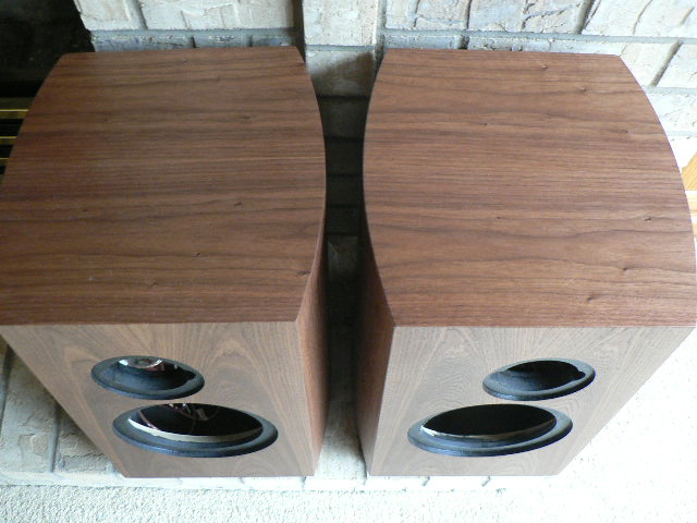

                                          • 21
                                          curved modula

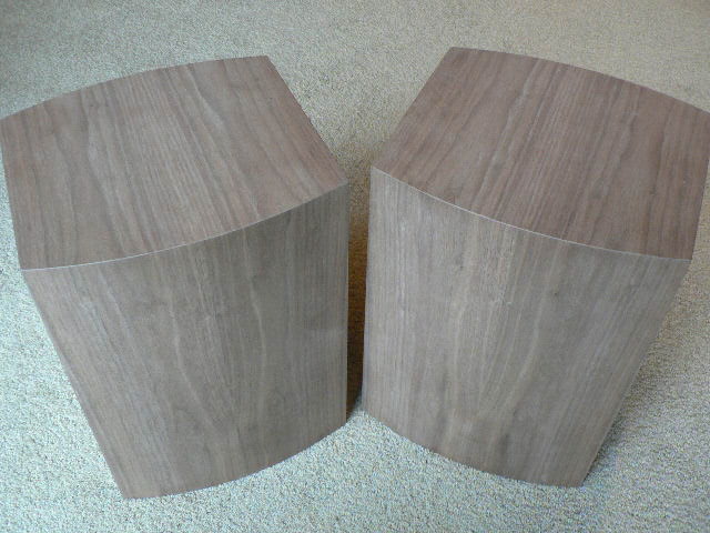

                                          Made some progress on my curved Modulas today. Finished sanding the black walnut veneer and applied one coat of BLO. The boiled linseed oil really brings the walnut to life, this can be seen in the before and after pictures below. I will apply a coat of shellac followed by two coats of varnish (not poly). I also finished my crossover assembly and installed them in the cabinets. Can't wait to fire them up, but will probably wait till the cabinets are finished.

                                            • technimac
                                              • 233
                                              TDV,
                                              That Walnut is beautifully done! :T
                                              Nice job on matching the veneer - that adds hugely to the "professional" finish look that you have achieved.
                                              Outfitter,
                                              You must be pleased to have those baffles glued on. Everything looks "good to go" for the last layer. :sn
                                              You guys have done such a nice job that now I'm wanting to build another pair of Modula MT's, but this time they'll be curvilinear! :W
                                              Cheers, Bruce

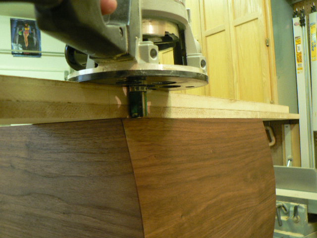

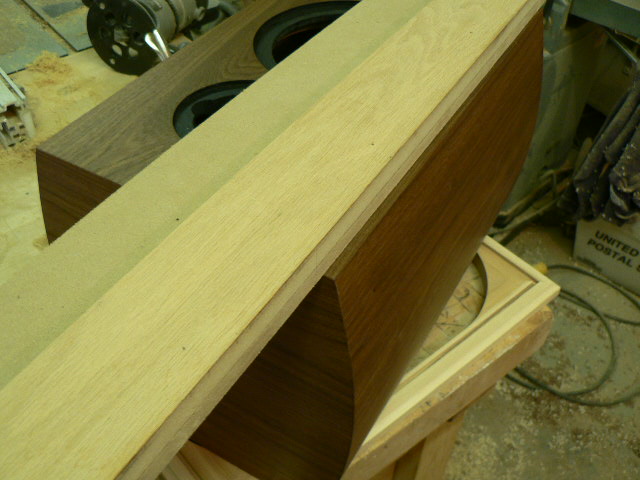

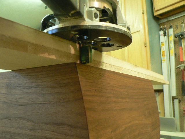

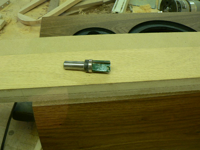

                                              • kano32
                                                • 56
                                                I'm just curious how you flush trimmed the curved sides to the front baffle. Looking good so far.
                                                • tdv
                                                  • 21
                                                  How To
                                                  I can't answer for Outfitter but I used a 3/4" top bearing straight router bit. Used a 1" high straight edge for the bearing to follow and set the depth of the router to 1". Place the straight edge across the top and bottom panels of the baffle and run the router down the sides to be trimmed. Maybe hard to understand, I can take a picture if needed.

                                                    Yeah, I think a pic would be very helpful, at least for me!
                                                    • kano32
                                                      • 56
                                                      Yeah, a picture would be helpful.
                                                      • Outfitter
                                                        • 66
                                                        What I did was use a piece of 3/4" MDF, and placed my router on top of that. I set the depth to a hair above 3/4" and trimmed the excess off the top. It may not be the best way, but it worked for me.

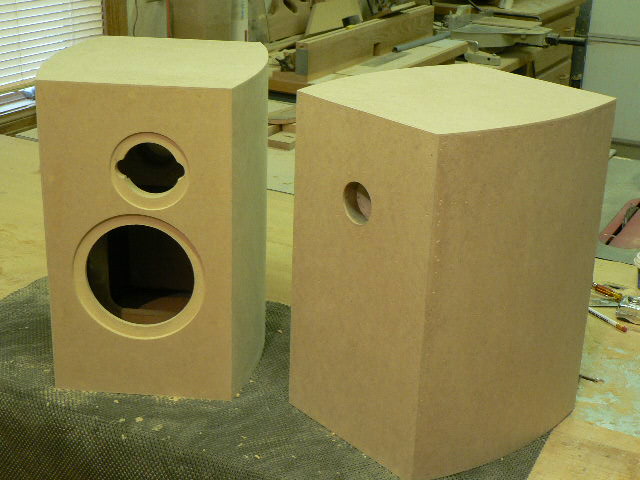

                                                        • Outfitter
                                                          • 66
                                                          I was able to get the baffle glued, and rounded over the baffle. It was a bit more challenging than I had thought. The side walls taper away from the baffle, so I was unable to get the proper roundover across all 4 sides. It took a little hand shaping with some sandpaper, but I think the extra work was worth it.
                                                          It's kind of hard to see in this pic, but the bearing sits on the curved side at a wider point than the baffle edge.
                                                              I'm still a bit confused. What I wanted to know was how you were able to hold the router/router bit perpendicular to the inner front baffle in order to trim the excess overhang from the sides before gluing on the outer baffle.
                                                              • tdv
                                                                • 21
                                                                trimming
                                                                hope the photos help explain.

                                                                • Brian Bunge
                                                                  • Nov 2001
                                                                  • 1389
                                                                  DUH!!! OK, I get it now! Thanks!
                                                                  • Ecir38
                                                                    • Oct 2006
                                                                    • 130
                                                                    I had no clue either, thanks tdv and outfitter
                                                                    BR
                                                                    • yousuredo2
                                                                      • 206
                                                                      I dont understand, & I have done it...
                                                                      the front is straight, the sides are curved (noy 90 deg.) the bit is straight (90 deg.)
                                                                      I had to make a spacer/Jig for my router to sit slanted, and sand or plane it to perfection...
                                                                      I never thought about doing it the way you did, glad it worked for you...

                                                                          • Outfitter
                                                                            • 66
                                                                            After a busy couple days, here is the latest....
                                                                            Images not available
                                                                            Still need to add the binding posts.
                                                                            I flush mounted the Precision Port on the back, I ended up using what they consider the inside flare, the external ended up being too wide.
