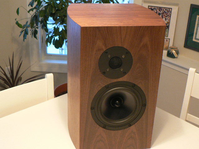

      Very nice indeed - what's the veneer?

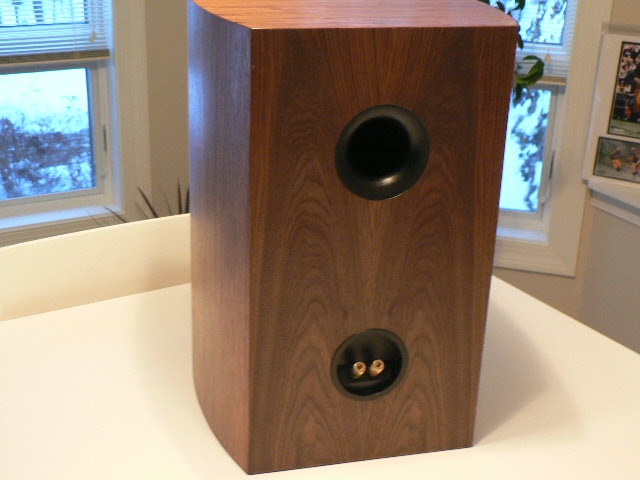

        The larger flare is the one that is supposed to be on the inside, according to the directions.

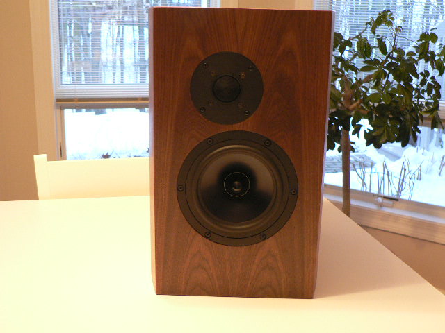

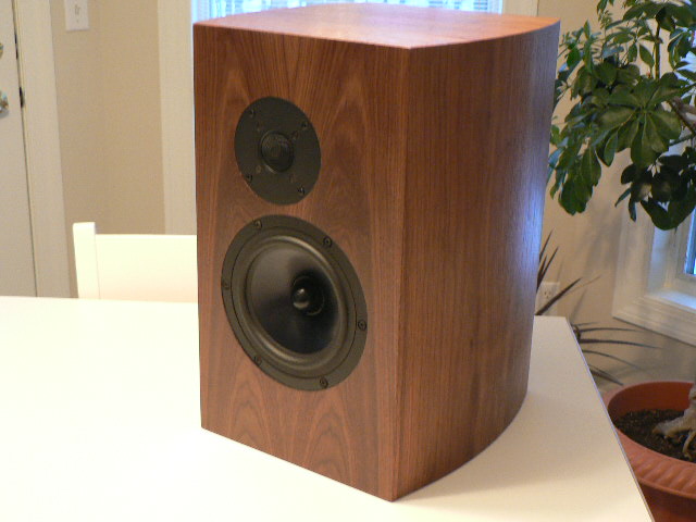

          Wow
          Outfitter,
          Those are Drop Dead Gorgeous! 8O
          A fitting finish for such great sounding speakers. :T
          Cheers, Bruce

              I was looking at your pics and thought, "those are the cleanest looking backs with just the flared vent" and then it struck me....I can't see a terminal cup or binding posts.
              So how do your connect them?
              Cheers, Bruce
              "While we're at it" - the four most dangerous words in Home Improvement
              • EDS
                • 45
                Still need to add the binding posts.
                this is between the third and fourth picture
                • Outfitter
                  • 66
                  Binding posts on the way....
                  I was debating a terminal cup or binding posts, I've decided to go woth the binding posts. :T I've got a handful of gold posts from Madisound, but I may add a couple pair of the satin nickle at PE on my next order-wanna keep that silver theme.
