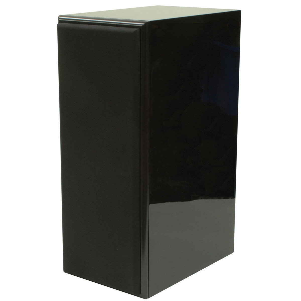

    I'm almost posative that the prefab enclosure for the Nat P's is the same as the Modula MTM which is the 1Cu Ft Parts Express enclosure seen here
    Its either this one or the .75 Cu Ft enclosure....I'd have to look again to be sure.
    Edit: Ok I just checked and yes its the 1 Cu Ft enclosure
    Last edited by theSven; 12 August 2023, 22:12 Saturday. Reason: Update image location

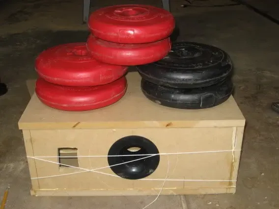

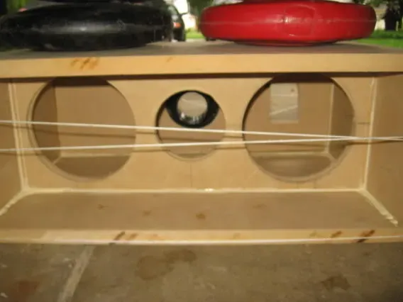

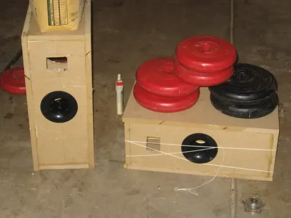

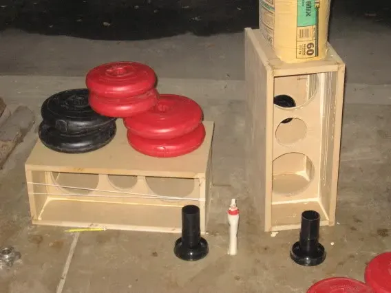

                                                                                Ok I finally gave this project a shot and I'm pretty happy with the results. I don't have the drivers yet so I haven't cut the baffles. There's still a small amount of trimming around the edges to make everything flush.... THANKS to all of you for the help! I'll be finishing up in the next 2 weeks and I'll post more pics when I make progress....
                                                                                Drawing everything out on the MDF...
                                                                                I used the port cut to length to figure out where the brace goes. The port is only there for reference, it's not glued in or anything yet...
                                                                                And the end result with the hole cut for the terminals on the back...
