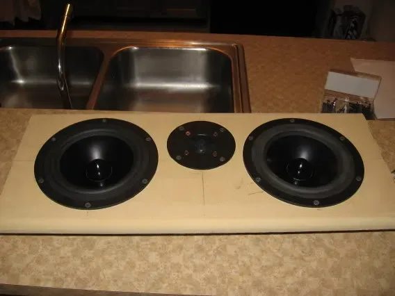

                  Hey guys, I'm about to order my next batch of parts from PE so I can finish the cabinet this weekend and get going on the XO.
                  I've read several posts concerning too much or too little dampening material. What would be the optimal thickness, size, and location of dampening material for this type of enclosure? I've never owned a speaker that cost more then $50 so I really have no point of reference to know what the speaker is supposed to sound like....
                  Also, I'm going to purchase a 1/2" flush cut bit for trimming the sides, is the 3/4" flat bottom bit what I need to cut the back of the baffles around the woofers?
                  Thanks!!

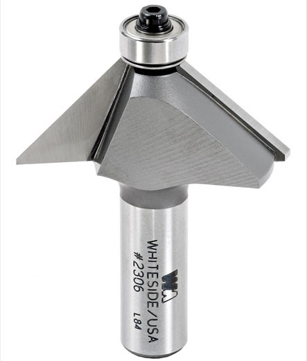

                    • stidrvr
                      • 49
                      Something like this will work. There called a "Chamfer Bit' I sure a 45 degree will be enough.
                      Last edited by theSven; 12 August 2023, 22:25 Saturday. Reason: Update image location
                        Thanks!!
                        That's what I use. Just remove small depths at a time.
                        One question, what router bit do I use to cut the recesses behind the woofers?
                        Either a chamfer bit as illustrated above or a 3/4" round-over bit

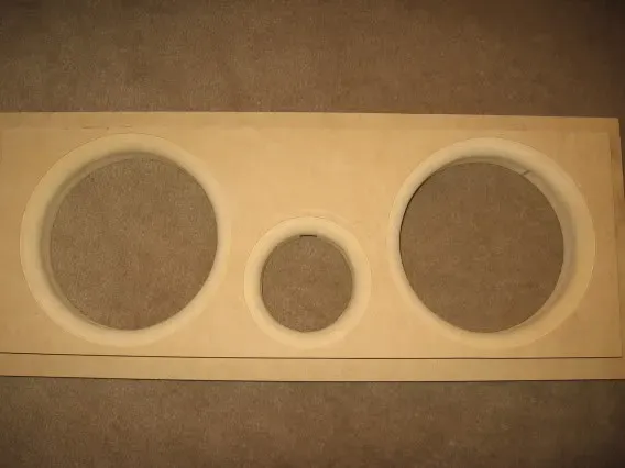

                            Hello again! A quick update:
                            My order from PE arrived in just over 24hrs (just about the only good thing about living in Ohio ).
                            I checked and the recesses for the drivers fit just right on one baffle and not at all on the other. Convenient that I only have the parts to assemble 1 speaker ) No matter, practice makes perfect and I'm actually looking forward to cutting another baffle using everything I learned the first two times around. This afternoon I picked up a round over bit to round the sides of the cabinet and the rear of the driver holes. I'll be working on completing my first NatP by the end of the weekend. I'll be posting pictures soon.

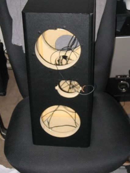

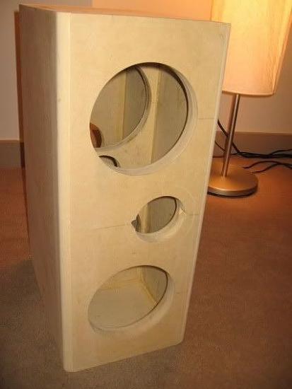

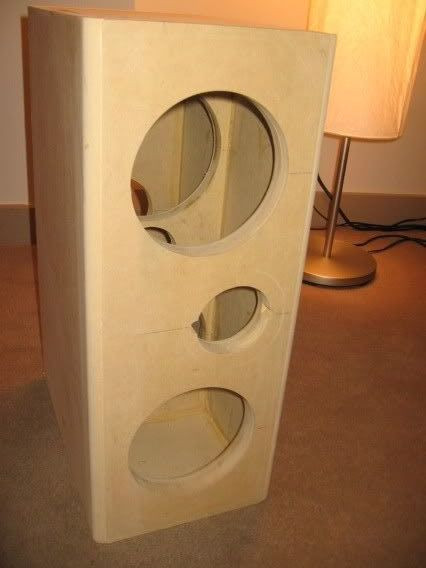

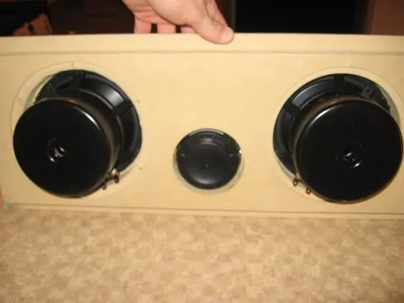

                                Ok, after many trials and tribulations I have finally finished all the cutting on one enclosure and have the drivers mounted in it so I can start building and testing the XO. Here's a few pics of the baffle with the drivers in it. Wish me luck with the XO.
                                Last edited by theSven; 12 August 2023, 22:18 Saturday. Reason: Update image location

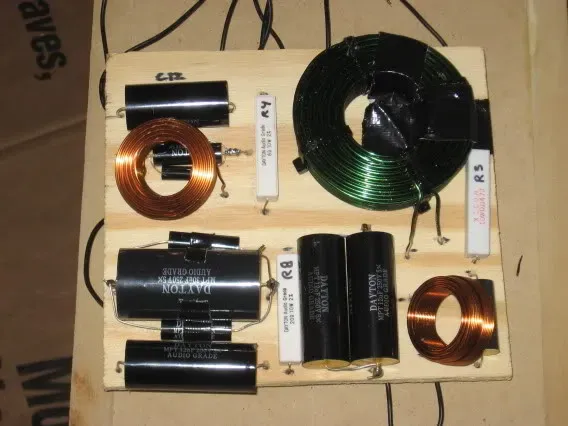

                                      Well my first XO is done and I'm testing it now. Even with only 1 speaker the natP is pretty darn sweet. I can't wait to finish the other one!!

                                        If possible I'd place both the small inductors on edge instead of having them lying down. There's less interaction with the large inductor that way.
                                        Sorry but I don't have a clue about the vinyl and rounded corners.

                                          I've been constantly testing my 1 completed NatP over the past few days and I have to say, it's quite amazing. A few developments:
                                          I decided to cut a new baffle because the one I had was a few mm off on all sides and I have a feeling that's going to look bad once I apply the laminate. This time I'm going to cut the front 1/8 of an inch bigger on all sides and then use my flush trim bit to shave it down perfectly flush. Doing that tonight! :T
                                          I spent a good hour with my ear about 2" away from each woofer and playing with the settings on my amplifier. I noticed some distortion in one of the woofers when I was listening at low volume. I eliminated the possibility of a wiring issue by connecting it to the other woofer's lead. Called PE, turns out the voice coil is rubbing or something... but PE customer service was AWESOME. The guy said he'd test the new one to make sure it works and send it out asap with a box to send back the old one. LOVE THAT! I should have one cabinet completely sealed and laminated this weekend... I'll post pics.
                                          EDIT: I also stood the small inductors on edge as Thomas suggested ;x(

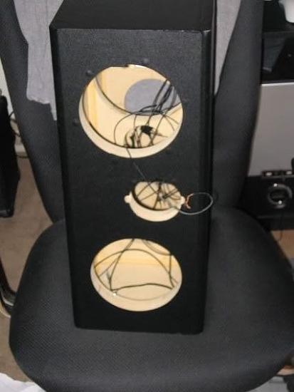

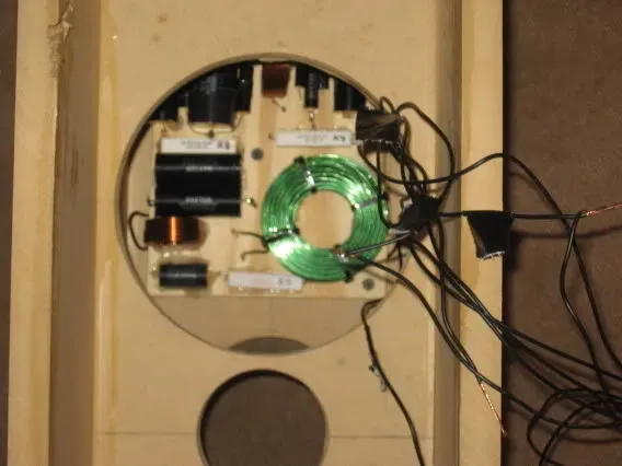

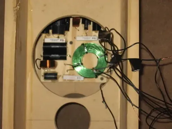

                                            Well guys, it's 2am and I just completed my 1st natP. WOW. I can't wait to hear what it sounds like when I have both done. Anyway, I recut the baffle and I'm pleased with the results. Some pics...
                                            New baffle
                                            The whole package dry fitted
                                            Crossover after hotglue and secured to cabinet
                                            Getting close...
                                            Yay!
                                            Last edited by theSven; 12 August 2023, 22:21 Saturday. Reason: Update image location

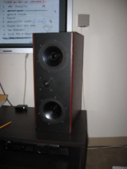

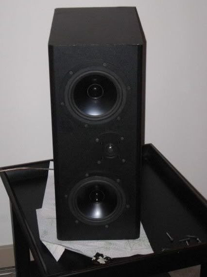

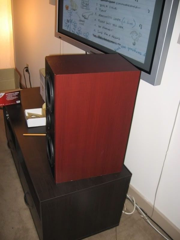

                                                        Ok all my parts came today. 2am.. work in the morning. For now, 1 cabinet 100% done, sealed, and tested. The other one will be done tomorrow night. Holy cow these things sound awesome.
                                                        Some pics of the final product. Not perfect but not bad for my 1st try.

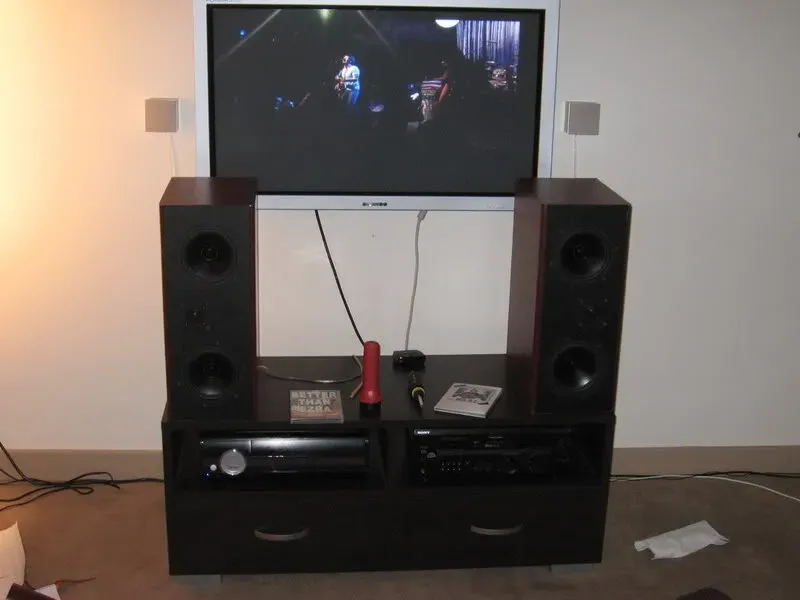

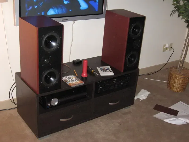

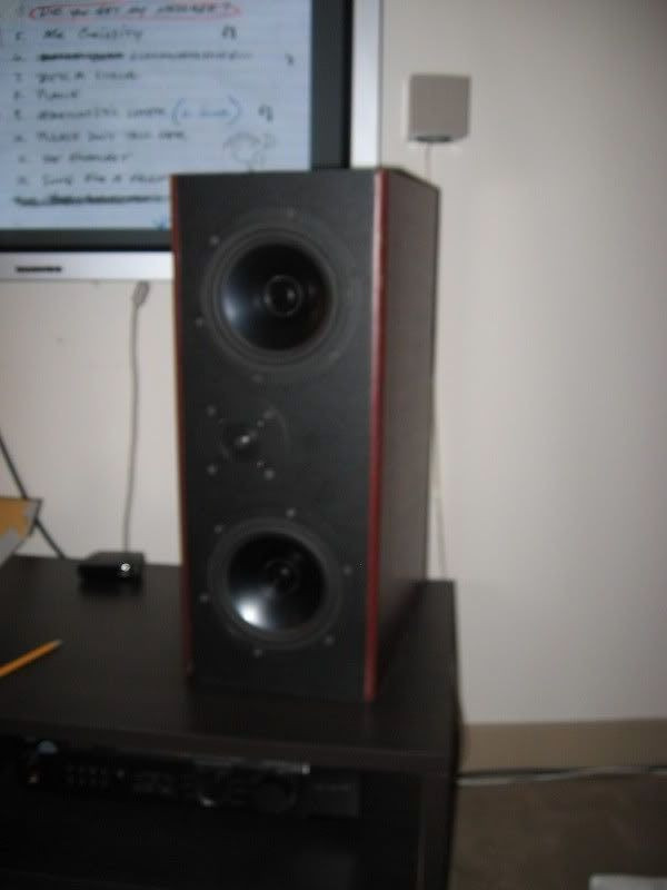

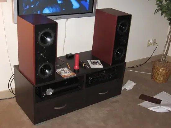

                                                            OK, IM DONE.. Excuse my language but, holy shit. ;x(
                                                            I can hear every little twang of a guitar string.. and parts of songs that I never knew were there!! You can see the little cubes hanging on the wall next to the TV.. that's what I'm replacing if that tells you anything. I'd like to thank all of you for putting up with me for the past 2 months. I really appreciate it. :T

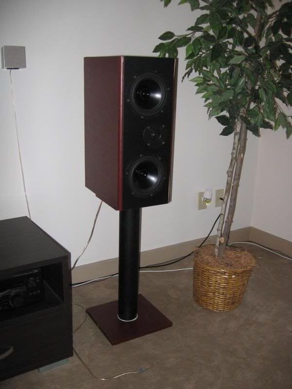

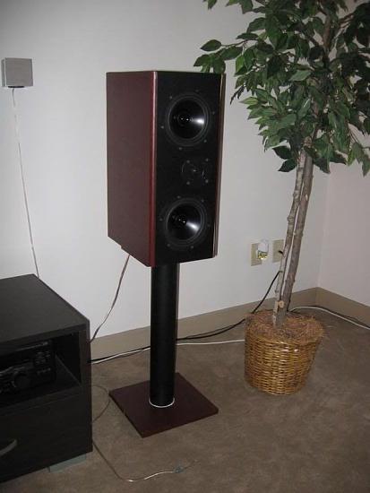

                                                                                  Okie, I made myself a pair of speaker stands for around $28. They work great! 3" PVC filled with sand.
                                                                                  Last edited by theSven; 12 August 2023, 22:14 Saturday. Reason: Update image location

                                                                                    Those stands look great for $28. :T
                                                                                    But what do you think of the NatPs now that you have been able to experiment with better placement? Any new thoughts?
                                                                                    Experience is a hard teacher because she gives the test first, the lesson afterwards.
                                                                                    -Vernon Sanders Law
                                                                                    • Frank2808
                                                                                      • 40
                                                                                      Sorry for the delay, I wanted to give it a week or so I listening until I posted any impressions. You'll have to excuse my crude descriptions but I really have no idea what I'm talking about
                                                                                      I finally understand what people mean when they say "front soundstage". One of the biggest differences I noticed over my cheap speakers is that it sounds like the sound is coming out of the entire wall and can't be localized to the speakers. That is just plain awesome to me.
                                                                                      I also noticed what a HUGE difference a set of nice heavy stands make. The bass is much "punchier" and it gives the impression that the sound is really "anchored" to the floor, if that makes any sense.
                                                                                      These speakers seem to reproduce the recording perfectly. When the source is average (either due to how it was mastered or because the mp3 is average quality) the sound is average.. But when you get a really well mixed Dolby digital 2.0 source is where these speakers really shine. I happen to have a Dual Disc of John Mayers new CD lying around. The DVD side has the whole album in Dolby Digital 2.0. COMPLETELY AMAZING. I must have listened to the CD 100 times in a week and I don't even care for John Mayer that much
                                                                                      Overall I am more then pleased. The speakers sound excellent and I feel really good that I was able to complete a DIY. THANKS so much to everyone here for all the help.
                                                                                      The next stage: I build a 2 cu/ft sealed enclosure yesterday for the Zaph 12" sub project mentioned above. Next week I'm going to order the sub and then the plate amp the week after. I'll be posting pics of course.
