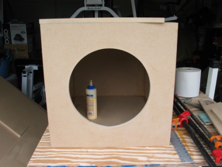

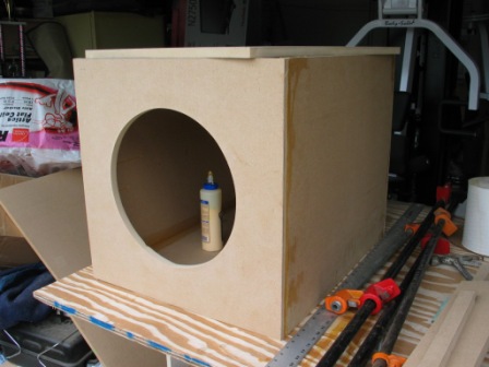

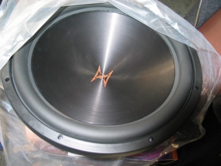

    Well Ive done it, inspired by all the posts decided to give DIY a try. Built a 22"x22"x26 sealed cabinet and installed a Sound Splinter RLP15 powered by a EP2500. Just hooked it up and like I have read several times it seems like very little bass is coming out. I have the EP2500 turned up all the way and it seems very light. I think like others I am not used to such clean bass and seems maybe a little break in is necessary. Looking forward to tomorrow to try a little more volume cause its only been 5 or 6 hrs since the top was glued on. Hehe

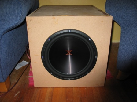

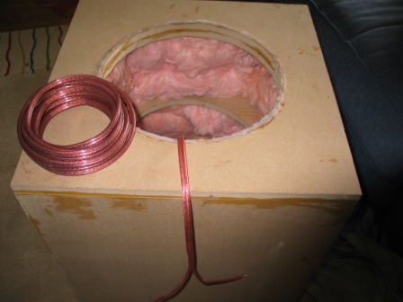

    Several more shots.
    Last edited by theSven; 01 October 2023, 18:51 Sunday. Reason: Update image location

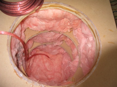

    • dyazdani
      • 7032
      Nice... did you just stuff the insulation in there, or use spray adhesive?
      Danish
      • nick77
        • 88
        I used some staples that are normally used for romex to secure the insulation. Hey Danish thanks for all your help!
                                              Wow! Nice work and that's a good sized sealed! I know it's kind of a pain in the rump, but you might want to try pulling half of your fill out and then take it from there. It's very possible in that size enclosure there is more to be had with backing it off some? Very nice though. :T
                                              • nick77
                                                • 88
                                                Steve your right about the the pain in the rump part, what am I losing or not gaining with the amount of fill? The box came out so dang big I guess I was trying to take up some volume. I think maybe it also looks worse than it is??
                                                  It doesn't work that way unless the damping is packed to the point of being a solid object.
                                                  The greater the amount of damping the larger the box appears to the driver. Less damping makes the box look smaller.
                                                  • nick77
                                                    • 88
                                                    Steve and Thomas thanks for the insight, I destuffed the snasauge and I have foundation rumbleing bass at lower volume on the amp. I removed close to half of the insulation and as Thomas reccomended I took a little more wood out of the brace. I am at about 1 oclock on the ep2500 compared to about 3/4 before. The bass also seems cleaner. Thanks again! 8)

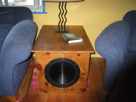

                                                              Well I watched my first movie last night. It was an action movie called state of the union and I am very pleased with LFE results. I had to turn down the bass to pacifiy the wife and dog. Cant wait to see what this thing can really do, havent had the house to myself much yet.
                                                              • nick77
                                                                • 88

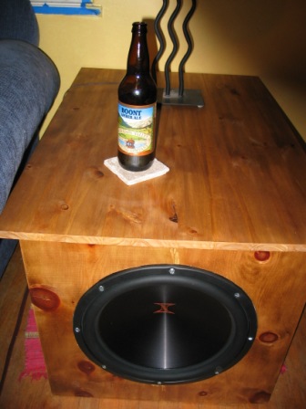

                                                                Well this thing is so big I decided to make it pull double duty as an end table. Not finished yet just wanted to snap a shot. The wife likes it so I am half way there. Not as elegant as I would like but better than mdf and the real joy comes when you fire it up. 8)
                                                                Last edited by theSven; 01 October 2023, 18:54 Sunday. Reason: Update image location
                                                                  Not a bad idea at all.

                                                                        AH! The old bass in a pine box trick Nice job.
                                                                        • nick77
                                                                          • 88
                                                                          Ya most of the materials were in the garage and made for a inexpensive fix. I don't think anyone said the project would be cheap. hehe

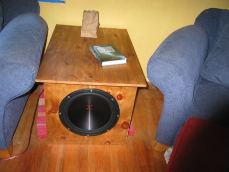

                                                                                    • Red Bastard
                                                                                      • 9
                                                                                      I like the look of that and would love to leave the driver exposed, but you obviously don't have a 2yo running around with pencils and forks in hand :E
                                                                                        You let your 2 year old run around with pencils and forks?
                                                                                        • nick77
                                                                                          • 88
                                                                                          How about "It would look better with a beer on it"
                                                                                          Don't want to disappoint ya. Hehe
