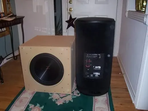

            my wife wants me to sell my AS-15 based sub for 2500 bucks Canadian.
            I'd take 1200 for it as is.
              The 15" ACI Maestro starts at $2200 for a black box. It's $2500 for the fancy wood finish.

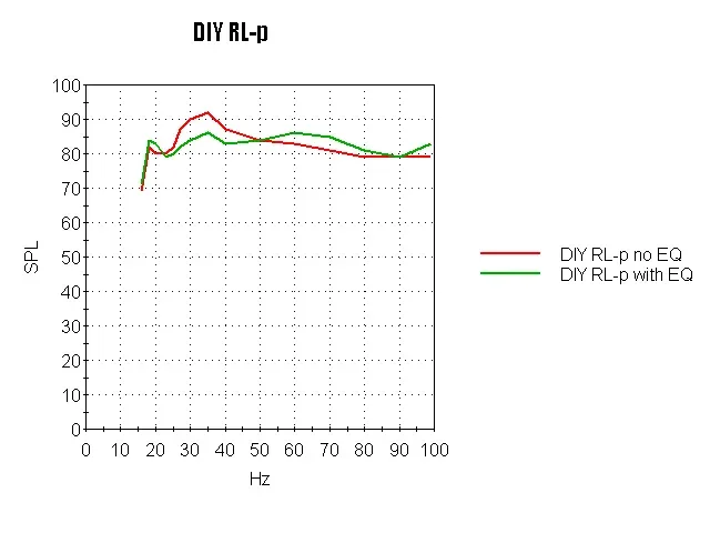

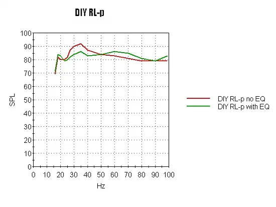

                          I decided to pull the Art out and do a little EQing and see if I could flatten things out a little. I could admittedly tweak it a little more, or attack it from a different direction, but the Art is rather wide and hard to work with when it comes to precision EQ. I have just enough $$ left over without doing the BASSIS to go with a better option that'll also allow me to adjust below 20 Hz. Anyway I'm pretty happy with the +-3.5 from 18 to 99Hz with a sealed unit..
                          Last edited by theSven; 13 August 2023, 09:24 Sunday. Reason: Update image location
                            There a very few EQ's that provide hinge points lower than 20Hz. The BFD (and it's variants) will boost below 20Hz only because one can make a really wide filter at 20Hz.
                            The Furman 1311 graphic EQ has a 10Hz filler but it's a fixed band. Rane makes a analog parametic EQ with 10Hz EQ. Unfortunately one needs test equipment to accurately set any analog parametric EQ.

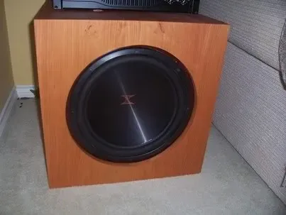

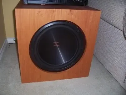

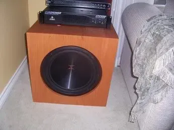

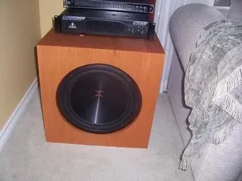

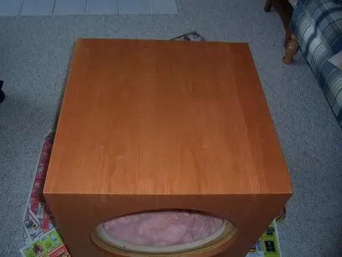

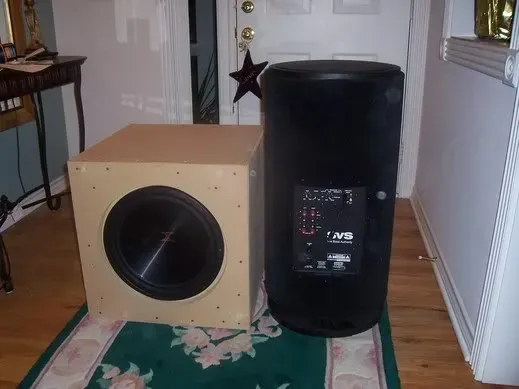

                                      I forgot to post a pic of the finished project. I also tracked down the drop from 18Hz... it's room induced. I brought the meter up to 12" in front of the driver and its solid down to 15Hz. That's as far as I can measure with my current disk though. With correction at 15Hz, I can hit 99dB 11' away in my leaky 2880 and still have room left in the tank. :blah:
                                      Last edited by theSven; 13 August 2023, 09:25 Sunday. Reason: Update image location

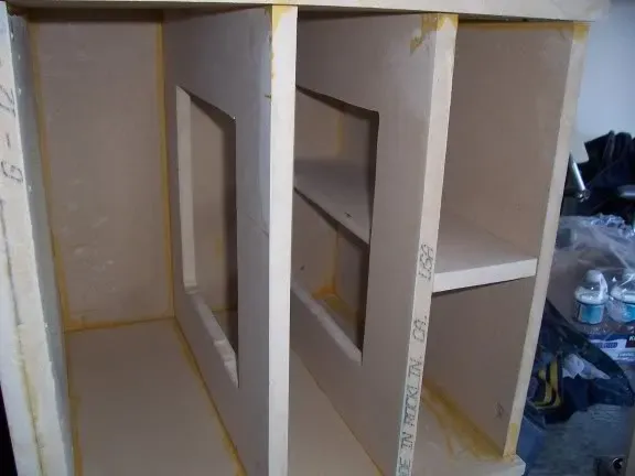

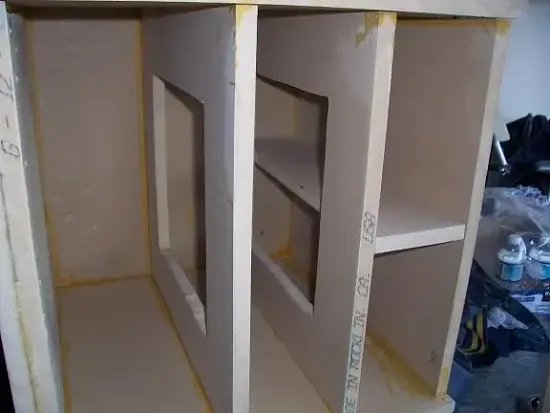

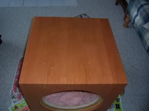

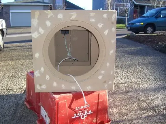

                                                  Quick question here. I decided to brace the back of the second unit and I'll most likely figure out a way to brace the back of the first unit even though SQ is good... my question is, should I take the time to hollow out the middle of the brace?
                                                  Last edited by theSven; 13 August 2023, 09:29 Sunday. Reason: Update quote and image location
                                                    Notch it out to correspond with the opening in front of it.

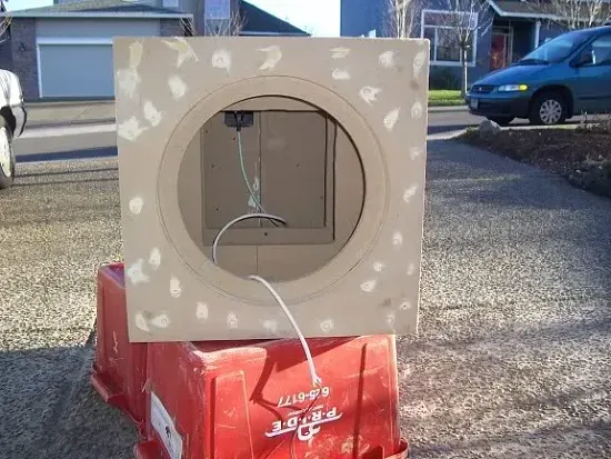

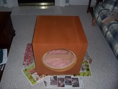

                                                            I also decided to play around with the fill today (again) on sub No 1. Being that this enclosure is about as big as Mike over at SoundSplinter will give his blessing on, I was curious about not adding any fill to very little. Something just wasn't sitting right, so I added yet again (not good) and then took the whole works out. Imo the bass had a better presentation with no fill at all. I suppose I'll try out a 1/2 to full pound next, but I doubt if I'll rest with more.
                                                            The brace worked out well Thomas. Thanks!

                                                                Nice, but cold Steve. Friday after work I had three coats on out in the garage. brrrr...Today was much warmer though.
                                                                  We use RL-p 15"s in IB subs, so putting them in a larger box certainly works.
                                                                  If you prefer the sonic characteristics of a higher Qtc that's of course a subjective decision.
                                                                  I do recommend that you line the inside with a layer of damping if nothing else it will absorb the higher frequencies that aren't completely filtered out by the crossover.

                                                                        Gosh I must have done thirty or so in the last few weeks and all looks fine. I did find by moving the love seat over a ft or so helped with the 17hz dip along with improving SQ. Remember that bass trap conversation:W :E ? No I'm starting to wonder if my kids were the culprit here?? I've had plenty of good bass in the past go bad I assure you. I made about five changes at the same time, so which one alleviated the situation is beyond me? I will be working backwards to a degree, so if it was the fill.. it will show itself again as I increase the amount.

                                                                            It appears I'm getting the full 6dB bump in headroom across the entire FR range, which is better than the side-by-side placement option...these are to wide for that anyway. That is one big block of sub! It reminds me of a couple Velodynes I had stacked years ago. I really need to think of something nice for my poor wife though. :frypan:
