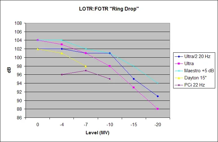

                                                    Well I hope your able to get to the bottom of your crackling sound your experiencing. I had intended on trying to address your question, but one thing lead to another and things took a different direction. Some of the numbers I'll be sharing are numbers I have been kind of holding on to with plans on a Thread over at AVS. After thinking about it for some time, I came to the conclusion who really gives a crap! I have other thoughts regarding, but respect keeps me from posting more. I like SVS products and always will.. nuff said..
                                                    I set out to do something with the sealed design along with being DIY,.. and I feel as though I've achieved what I set out to do. Maybe you can take this as a little pep talk in spurning you on, to keep at it, until you get to the bottom of what ever problem your experiencing?
                                                    MASTER and COMMANDER time stamp 11:04 It's when the cannon fires and rolls back at you. When the cannon hits it's stops to keep it from rolling through the other side of the ship, there is a nice LFE effect that if produced correctly gives you the feeling as if you were standing behind the cannon yourself. The dual driver PB12-Ultra/2 did a very good job of presenting it along with great SPL in what my leaky room will give up. I believe it topped out at 104 uncorrected with no eq. The dual sealed 15" RL-p's came in at 106 with a little left in the tank....no eq. I have no doubt I could coax more out of the dual PB12-Ultra's that I had after the /2, but this kind of SPL with retaining proper SQ is pretty darn good. Please take note where I load my subs though..

                                                    In the LOTR 25 Hz ring drop, I can hit 105dB with a single DIY RL-p unit..
                                                    and in the SW II 30 Hz Fly By scene.. I can hit 111 to 112dB. A few days ago for the fun of it I decided to try dual on this scene and they did 116dB easily. 117-118 should be quite doable. The PB12-Ultras being down firing would not do this. Cancellations is all, (4-5dB gain instead of 6) due to being loaded side by side in the space I have to work with... The dual driver Ultra/2 in the 25hz tune was able to do 112dB.

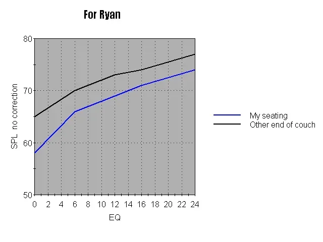

                                                      I'm just tring to see how it affects the curve, how much low end you can actually add with a BASSIS
                                                      My BASSIS is 1/2 calibrated, so if I understand this correctly.. I have 12dB of gain available instead of 24dB. I also need to apply the 1/2 calibration to my FS Hz knob which reads 30 to 130. My understanding is although it reads 30 to 130, it's actually 15 to 65. In setting it up, it seems to translate out with my limited understanding of the unit though.
                                                      It was about two or three weeks ago that I found the culprit of my 8dB drop at 17Hz from 18Hz. It had everything to do with my room and seating. If I move to the other end of the couch, I only get a 2dB drop. If I move another couple of ft, I actually start to gain. I suppose I could change seating to accommodate, but I've put my wife through so much concerning all my subs that I just don't have it in me to bring it up. She used to cry sometimes looking at what I've done to her nice living-room. We actually use it now (anyway) and over time her understanding has improved.
                                                      Here is what I came up for you Ryan and if there is anything you need clarified, just let me know. MV stayed constant, but I increased the the BASSIS 3 6 9 12dB. My starting point was at 0.

                                                        Hi Steve!
                                                        Please tell us more about the BASSIS? Of course boost means the amount of DC gain. Fs is the old resonance frequency. Qb is the new Q and Qs is the old Q. Am I right?
                                                        How steep is the 20 Hz cut filter?
                                                        How have you determined the Fs and Qs? From the simulation?
                                                        For $333 it's not bad at all.
                                                          Click image for larger version  Name:	mline_3785111B.webp Views:	0 Size:	13.8 KB ID:	947929
                                                          Which frequency did you use?
                                                          It's pretty amazing that you can hit same (or little bit more) with a single 15" sealed, that what you did with Ultra/2 (20 Hz tune) or with a single driver Ultra. :T
                                                          I can make a set of new graphs if you like?
                                                              Nice to see you make it over Ilkka,
                                                              15hz.. as a afterthought I thought about if this would translate out to the same gain up higher.
                                                              Yeah I was fairly impressed with this also including the Maestro. I wish we would have graphed some lower scenes though. Hey tell me Ilkka? Time stamp 11:04, Master and Commander..what kind of LFE are we looking at here. 20 Hz?

                                                                Yeah, I'm not quite sure what that graph is saying, but I've been a little pre-occupied to ask more questions. What is the EQ on the X-axis? And is your seat the corner loaded, and the other seat to represent the middle of the room?
                                                                You asked me to see what kind of bump the BASSIS could provide in a lower FR. 15 Hz being as low as my disk goes, is what I chose to use. The bottom and top line represent two different locations with the same eq (BASSIS) applied in successive 3dB increments..same 15hz tone at the same MV. The bottom of the graph shows the eq applied, but this being a 1/2 calibrated BASSIS, the numbers might be better represented by me choosing 1 through 12?

                                                                    Okay, with that and re-reading it, it makes sense. You were able to take 15hz from 68db all the way up to 74db at 15hz. That it pretty impressive. Do you have any idea what that did to the rest of your frequency response? I guess that is what I was thinking about. How does adding a ton of boost at 15hz mess with the rest of the graph? I'm also wondering what it does in the time domain. Everyone talks about avoiding adding a lot of boost, because you can induce ringing. But, I don't think that LT does this, I think that is the great thing about it. Don't quote me on that.
                                                                    So did you have to continuely turn up your amp? I guess I'm not entirely clear on how you took your measurements (my fault, not yours). Can you walk me through it.
                                                                    I may make pretty graphs with REQW or ETF, but that doesn't mean I've got this all down yet. Still trying to learn.
                                                                      No most of that comes with applying to much boost along with being to narrow.
                                                                      No. Maybe if you re-read what I wrote knowing MV stands for Master Volume it'll make better sense. I applied all the (12dB avalible) gain with the BASSIS.
                                                                      Ilkka> I knew I could count on you. What I need is right when the cannon hits the stops, not the shot itself. I know I have a few other questions to answer, but I want to see if you can get the stops/time down exactly. nice job
                                                                      Trust me Ryan, I go through that all the time. Look back in this Thread. Thomas had to straighten me out more than once. Ilkka knows to much for his own good at times to. :lol: ;x(

                                                                          #126
                                                                          but yet pretty strong down to 15 Hz.
                                                                          From the feel of this scene I figured it had some low content. Anyhoo it's my favorite bass scene in the whole movie. Done with conviction, it really feeds the need. Thanks Ilkka
                                                                          That's nice of you to offer. Maybe that would be good considering my graphs are a little lacking and in keeping with tradition. You could add the single and dual DIY RL-p to the mix along with a FR plot graph.
                                                                          As steep as it gets. With it engaged, I believe there is no bass below 20??? I'll double check and be sure though.
