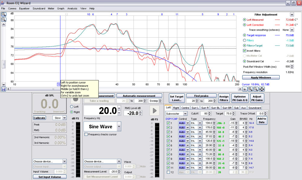

    Just a quick update, I got RoomEQ up and running, attached is what it is showing me for both subs located under the speakers. Big null at 43hz. : I got a lot better extension than I previsouly thought. Not sure why I wasn't hearing this as well, may have been I didn't have the sub level correct. I'm not quite sure how to attack this with the BFD. Add a little boost down at 20hz, but other than the incorrectable null, I'm not sure if it is worth messing with. Any thoughts, suggestions?
    I think I need to measure at the other two seating locations, and maybe experiment a bit with placement, see if I can eliminate that null. Unfortunatly, with my room, seating is pretty much locked, and now because of the subs size and shape, they can either be tight to the tv or under the speakers.
      #272

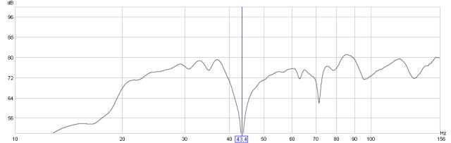

      Wow, you have the dubious honor of having the biggest null I've seen in 40yrs of speaker building..... 8O 8O 8O
      Try rotating the subs so they face any other direction and measure again. Other than that major bass traps are in your future if the wife approves...
      Now the bottom end roll-off looks like it should. You've got plenty of amplifier power so dial in boost at 20Hz. Try various filter widths to see what works best.
        #273
        Edit: missed the part where you said the seating was locked. Moving the subs (feet not inches) or bass traps are the only choices. Try running just one at a time to see if that null gets better.
          I'm Honored! When do I get my certificate?

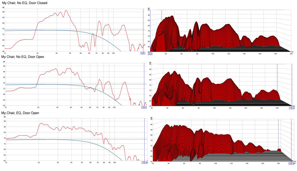

          I moved the mic forward and back about a foot or so, and it just got worse. I almost cried when I placed the mic on in the other locations where my wife normally sits. In the other chair which is slightly off center, it was nearly perfect! I then placed the mic on the sofa, which is way off center, again it was almost perfect, nothing that the peq couldn't fix! Take a look.
          My wife got home while I was crying. To cheer me up, she suggested moving around bass traps and building more. We stumbled upon another solution, that appeared to work really well. Unfortunately, I didn't save it, because we had to leave for dinner shortly there after. But, it was opening the door to the utility closet/crawl space at the back of the room. It changed the null to a smooth, wide dip. I plan to do more testing tomorrow, and will post the graph. There has to be a downside to this solution, but I'm not sure I care. My room is already leaky, with a staircase on the other side. Is there a downside to this solution?
          After we got back from dinner, we watched a stupid chick flick (with the door open), and the sound track sounded great. Had real nice bass guitar that made me get up at one point to turn off the subs to just check the effect.

            Cheer up! An open door is like a big bass trap the size of the door. Sound goes through and doesn't come back (sorta, kinda, blah blah.)

              Hey that's looking better Ryan. I've seen much worse than that I assure you. You have allot to work with there.. with the closet door open. Another thing you might try is to put a sheet of plywood right behind your recliners as to act as a boundary. If you find it helps (I think it would) you could possibly go with some sort of oriental folding wall or something to that effect??

                        If you found the open door to work well, there's no reason you couldn't cut out say 2-4 larger panels from the door which you could then frame with molding and use a fabric of your or your wife's choice to hold some compressed fiberglass in the windows created. This would make the opening a little more resistive, and probably serve to smooth things out similar to what opening the door did. Just an idea...
                        The other option would be to do a little more experimentation with placement. Just for a bit more knowledge of what is going on in the room, you might want to try moving one of the subs to the midpoint of the side wall, or one to the rear wall to at least observe what the changes are to the response. I'm a little fuzzy on what might be caused by what interaction as it isn't clear to me in your diagram what are the front speakers vs. the subs. I presume the subs are P1 & P5?

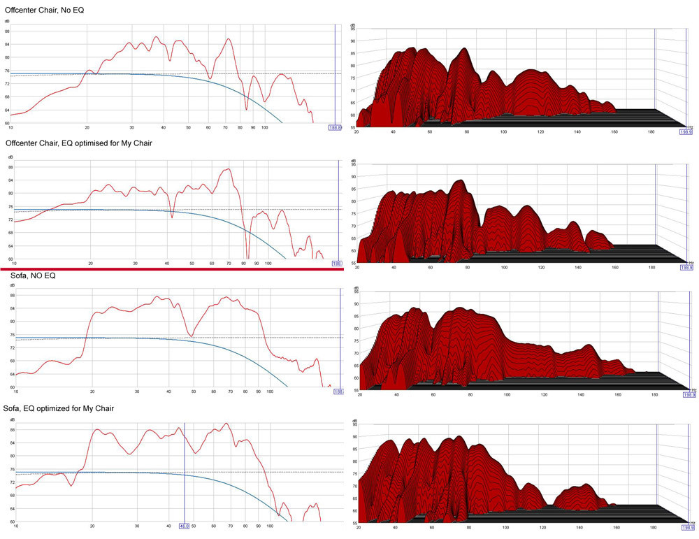

                          I played with REQW and the BFD a bit today. REQW is really slick! Wow, it has a little bit of a learning curve, but once you get it, it is easy. Anyway, here is what I came up with, just optimizing for my chair. Pretty impressive for minimal effort:

                          It ate up quite a bit of amp. I had to turn it up quite a bit, and started to get the red clip lights on the amp to flicker during Incredibles. I think it is way hot though. I need to do some more experimentation.
                          I'm listening to DMB right now, and the bass sounds a little stronger. Watched Incredibles briefly. The EQ was very noticeable. There was so much more bass. It wasn't necessarily louder, just fuller and a lot more impressive. A little bit more boomy, but I think that is the room, and starting to hit those low frequencies, where I don't have enough absorption - yet.

                            Your chair, EQ, door open looks great and it stays pretty good for the other seating positions as well. Nicely done :T

                              Some of those waterfall plots obviously arn't correct. I'm trying to fix it.
                              Edit- fixed graphs above.
