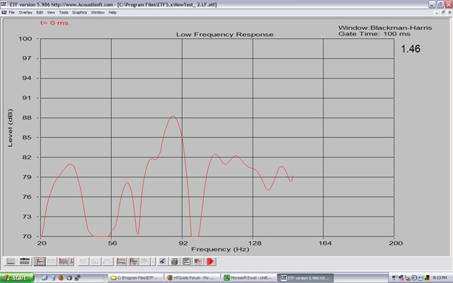

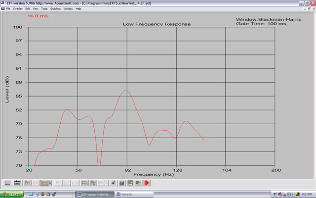

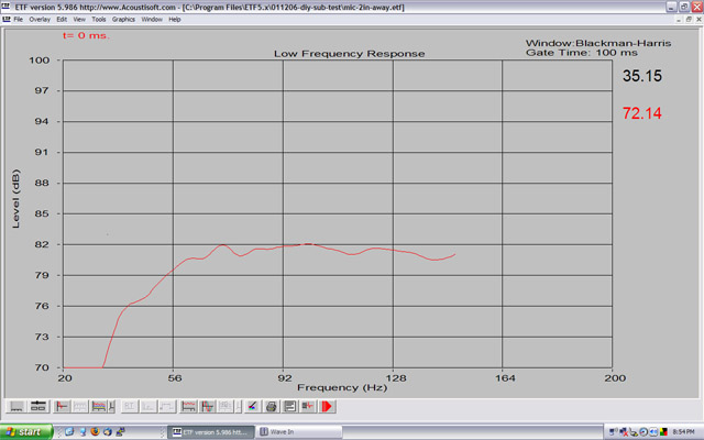

                                                Well,
                                                I got out ETF tonight. Good news, with the sub pulled out into the middle of the room and the RS meter placed about 2" from the driver, it looks like the models [Edit2, it is falling off faster. At 35, I think it should be -5 where ETF showed -10db]. The bad news is with it where I was going to place it, YUCK! Big null, and not a lot of room gain down low. Here's hoping that the second one will clean this mess up, and what's left can be delt with using a BFD.
                                                [Edit:
                                                I moved the sub over to the left side and added the FR. Double Yuck!
                                                I think I'm going to have to get out a test CD and do these by hand to check ETF. My old sub was never this bad when tested. :M]
                                                [Edit2:
                                                I know that I need to add a lot more stuffing to the box. and take more measurements. I was too depreased last night after seeing these things. When I listened to the sub, I thought that there was major lack of extension, and it seemed to be missing quite a bit, hence turning it waaaay up. I guess I got a lot of work to do this weekend to tune these things.
                                                Any suggestions would be appreciated.]
                                                    Those plots aren't a result of the boxes needing more damping. If accurate, they're purely a function of room placement and the position where you're making the measurements.
                                                    Obviously you need to boost the lowest octaves with the BFD.
                                                      #251
                                                      Steve,
                                                      No. No correction has been done with these plots, YET.
                                                      Thomas,
                                                      Yes, I understand that most of what I see is due to room placement. I only mentioned the stuffing, because I have very little in right now.
                                                      Do you have any explanation for why the sub is dropping off so fast? With the mic only about 2" from the driver, I thought that this measurement should be pretty accurate. Is there anything in the build that could cause a driver to drop off faster like this?

                                                            #254
                                                            1) rather smallish sealed box
                                                            2) driver has a relatively high Fs
                                                            3) no room gain in nearfield measurements
                                                            4) need to add in the RS corrections

                                                                            I had been listening to music all day long while I was in and out trying to clean up. It sounded pretty good. It definitily wasn't bloated or boomy.
                                                                            I watched WoW. It was impressive. Pletty of bass. But, no real deep lows. It shook the house easily. This was still with the amp at 2/3 and the receiver at -1. So, I have plenty of volume, just need the EQ to push the low end up.
                                                                            Getting there....
                                                                            I'm very happy so far.

                                                                                I listened to a couple of CDs last night. The subs way outperformed the speakers, but that hopefully will get fixed tonight. Overall, the bass seemed a little lacking at times. We've all seen the frequency response, and know that I got some work to do with the BFD.
                                                                                Before I hit the BFD, how do I go about tunning the amount of stuffing and is there anything else? I'm going to have to admit, that I'm a real beginner here. I've never had a big CD collection due to $$, and never had good equipment. I'm just starting to get that stuff now. So, I really don't know where to begin, or what I should be listening for. Am I best off just using ETF and REQ and looking at the FR graphs, or can you help me out and tell me what specific things I should be listening for? I'm willing to go buy any CD that will really show the differances.
                                                                                  • 16202
                                                                                  #265
                                                                                  Getting there....
                                                                                  Uh, now, I'm not the subwoofer guru, I'm more the two channel channel music guy and crossover tweak head. But isn't there something a little contradictory about the above? Have you tried a quick measurement to see what you've actually got? "No real deep lows. It shook the house easily."
                                                                                  There's a little bit of a contradiction there....
                                                                                  ~Jon
