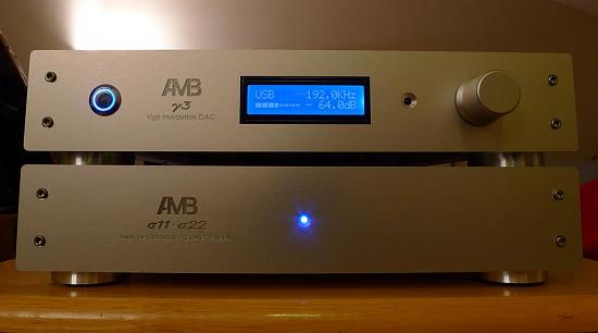

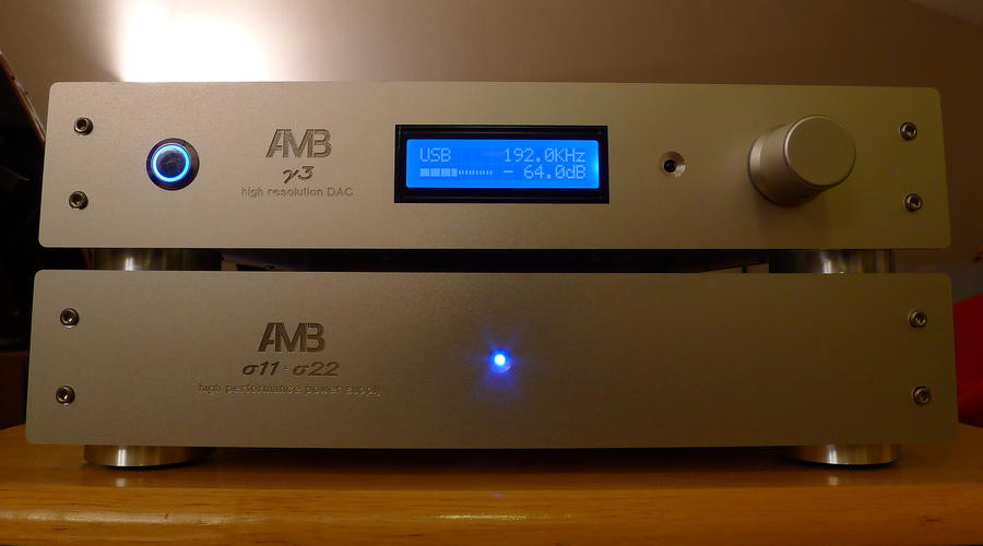

                If you're not familiar, I would recommend on reading up on amb's offerings. He's just wrapping up the latest DAC, an all out desktop DAC he's called the gamma 3.
                Lots of measurements, great track record, and tons of support on his own forum. I've built a couple DAC's, headphone amps, and preamps from him. I have zero hesitation recommending any of his products.
                  I would second AMB's gamma3 in a heartbeat. It's not the simplest of builds, but circuit boards will be available and the design is very much high end. I believe it uses the same Wolfson chips (on per channel) found in the PS Audio Perfectwave DACs. The DAC is in its final stages of development and testing, and should be published soon. I know AMB from when I lived in the Bay Area, and he's a great guy who designs some really great stuff for the DIY community. I've built a few of his designs and just finished a balanced preamp using a bunch of his various modules (here's a thread with photos). There is great documentation on the website and AMB along with others give great build support on the forum over there.
                  Definitely worth checking out.

                          Yes, the link on the bottom of that page to the forum discussion is where the meat is: http://www.amb.org/forum/gamma3-high...ent-t2656.html
                            I did not find any reasonable efficient way of finding out what price range this DAC will be in. Does anyone have a ballpark number about the build cost?
                            The reference DAC looked awesome, but I have to say I'm a bit supriced that a DAC would need to be build in not one bug TWO full size chassies.

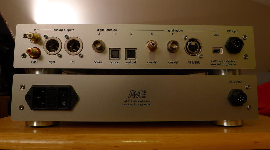

                            For me, one of the features I'm planning on taking advantages of if/when I build a DIY DAC is that I can simplify it to only suite my needs. That will mean that I will only need one single input/output (SPDIF or USB).
                            But from what I can tell by the pictures, that would not affect the build much - probably because it's just different plugs that all handles signals that have to be handled the same way anyway.
                            Also, if I read the spec correct, this is not just a DAC - but also a pre-amplifier as it's currently suggested. Is that correct?

                              Yes, that's the analog output stage. It's all modular though so you can decide not to use it if you choose. And yes, two chassis, because you always need to separate out the power supplies, right?!

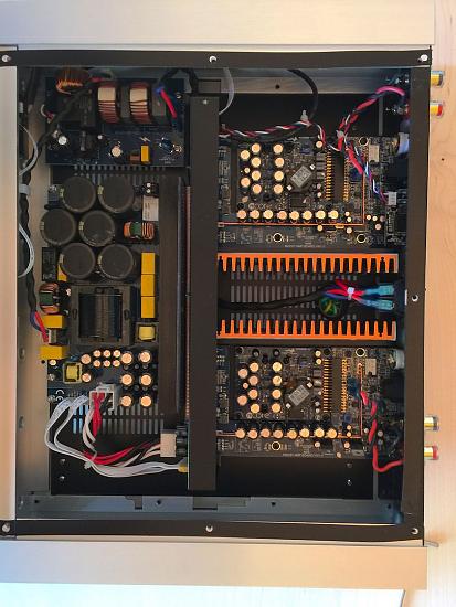

                                  I have a some modules in the mail to me. 4 amp modules and 2 PSUs. (I'll likely have two extra NC400's since I'll probably go two monoblocks vs. two stereo units if you're interested.) I also ordered the Ghent enclosures so this may be the fastest build ever! Will likely wait on the transformer upgrade that Jon recommended for now.
                                  The other question for me on the difference is in the THD. Is that because of the lack of input buffer? Or the higher power rating?

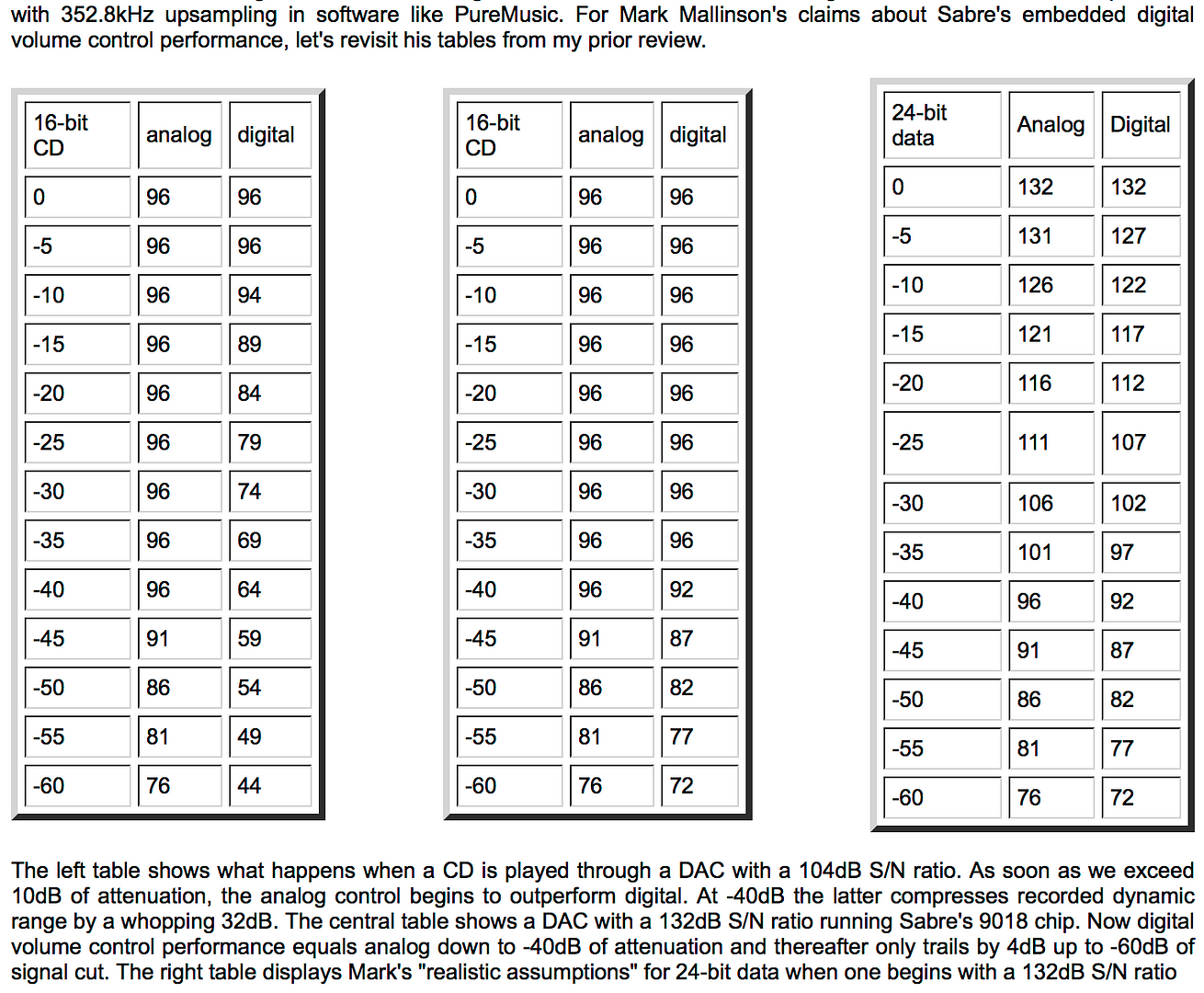

                                                    What's the consensus on whether you need a preamp between your DAC and your power amp? Is it a matter of impedance matching? Perhaps voltage swing of your source vs the input range? The specs on the volume control and output stage of your DAC?
                                                    A couple of sites have addressed this topic directly, looking at the effective bit resolution using an internal volume control (in DAC's like my BADA, M51, TotalDAC-D1) versus running the DAC full tilt and using a high grade preamplifier.
                                                    This is a data set calculated and posted on the six moons review of the AURALiC Vega, which uses the SABRE DAC and it's high resolution volume control capability.

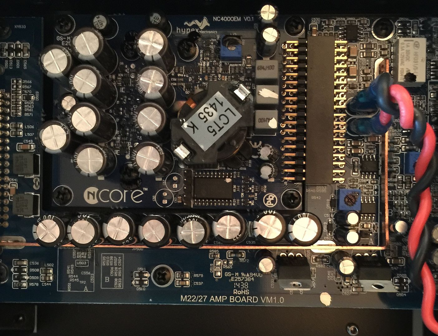

                                                          • 16059
                                                          To clarify what the NAD M22 seems to use, let's revisit this picture I posted in Audio hideout, taken of the unit I bought earlier this year:
                                                          Note the upper center area: this is an NC400OEM module, which as far as I know is based on the nCore 400 DIY circuits, but in an OEM format without the input stage and with more bypass capacitance and an interface header quite similar (perhaps identical?) to the NC500. This module is not listed on the HypexPro web site, and may in fact be a precursor to what is now the NC500, as this has been out for a while. Note that NAD adds quite a bit of additional supply capacitance immediately adjacent to the module; this is a good thing, in my opinion.
                                                          Note also the copper bus wrapped around the module; my first suspicion is that this is a low impedance ground connection, though Cambridge does some similar things that are actually power bus connection.
                                                          I think I'll need to spend some time with this on the bench with my new scope in December... :W :B
                                                          Last edited by theSven; 12 August 2023, 16:13 Saturday. Reason: Update image location

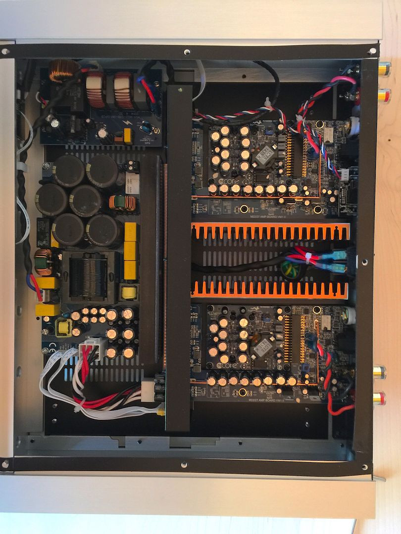

                                                            • 1670
                                                            I thing you are right about the NC400OEM being the forerunner to the NC500. I do also notice that it's version 0.1, so it's seems to be a quite early edition.
                                                            My first thought about the copper was that it was to isolate noise from the amp module.
                                                            Below is a picture from "the net".
                                                            I assume the part in the lower left corner is a SMPS power supply. Do you know if they are using a SMPS1200 or another one?
                                                            But it seems like there is another, smaller powersupply, up in the upper left corner. Any idea about why that is? The SMPS1200 have other output powers that should be able to power "different" stuff, is they do not have any very special needs. I also notice that there is a wall between the power supplies and the amplifier modules. I assume that mainly is to limit noise from the powersupply to reach the amplifier modules?

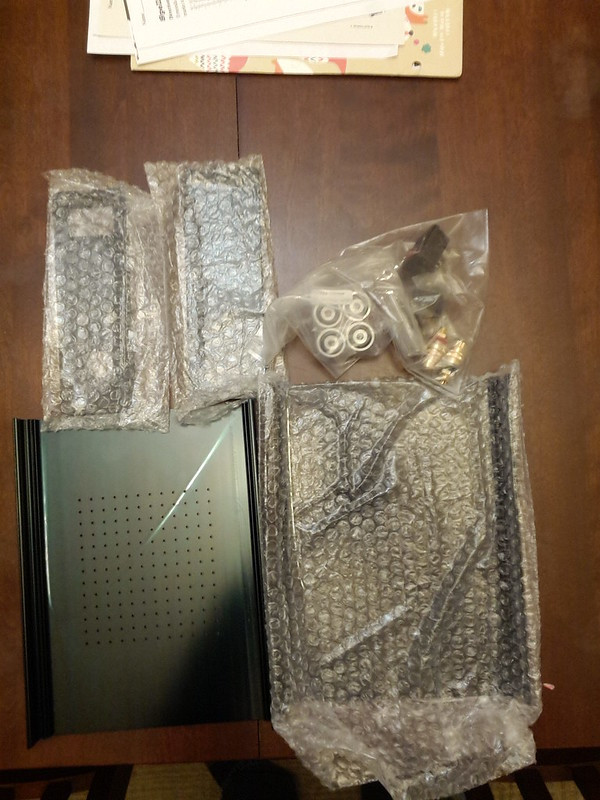

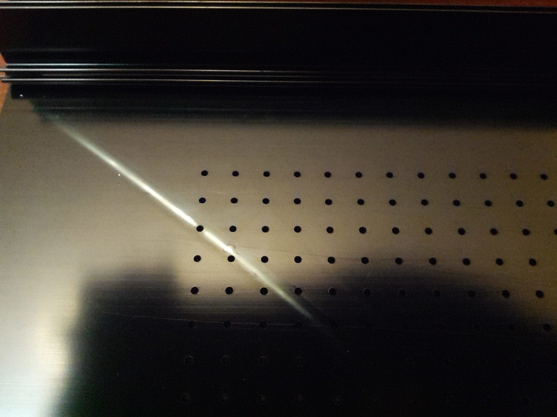

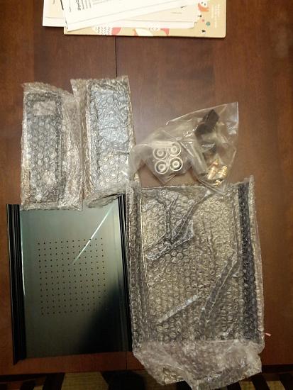

                                                            • oneplustwo
                                                              • Jan 2010
                                                              • 666

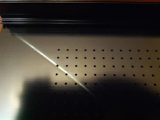

                                                              I got the ghent enclosures today. The quality is quite good and I think it's a good value given the fit and finish. The hardware provided looks good too and the machining is clean. Assuming everything fits together fine, I will be very happy with the purchase. Only minor complaint is the anodizing on the inside surface has some flaws, but you won't see it when assembled obviously.
                                                              I'm amazed how small they are. I knew class D amps were quite efficient in this regard, but it was still a surprise to me.
                                                              A couple pics of the package contents and the anodizing flaw.
                                                              Last edited by theSven; 12 August 2023, 16:14 Saturday. Reason: Update image location

                                                                    • 16059
                                                                    Click image for larger version  Name:	IMG_2023_zpstnj13unt.jpg Views:	0 Size:	235.6 KB ID:	947592
                                                                    The part in the upper left corner is the EMC/EMI input filter, between the line and the SMPS. As far as I know, the power supply is proprietary to NAD for this application. They're not using a Hypex module, and you may note that there are 6 instead of 4 of the line filter caps (usually 250V ones connected in series; 250V caps have much nicer figure of merit than 450V, even when you factor in working voltage to the calculation). (I'll post some foils about this from a recent training I gave to illustrate). Like Hypex, they use EP or ETD style cores, which are not, in my experience, an optimal choice for volume and shielding or efficiency, but they are less expensive, because they are cheaper to manufacture and gap accurately than PQ cores (my normal form factor preference, developed for high density SMPS).

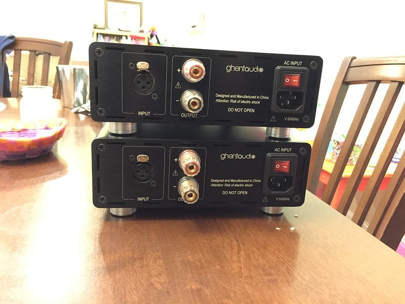

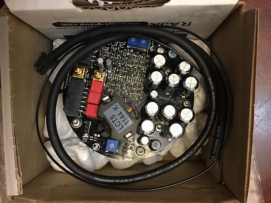

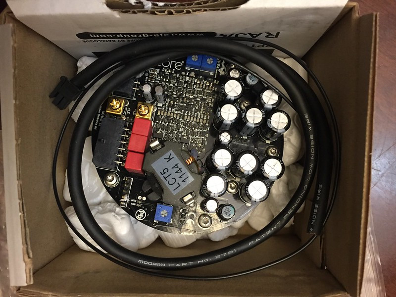

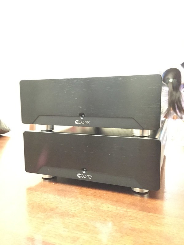

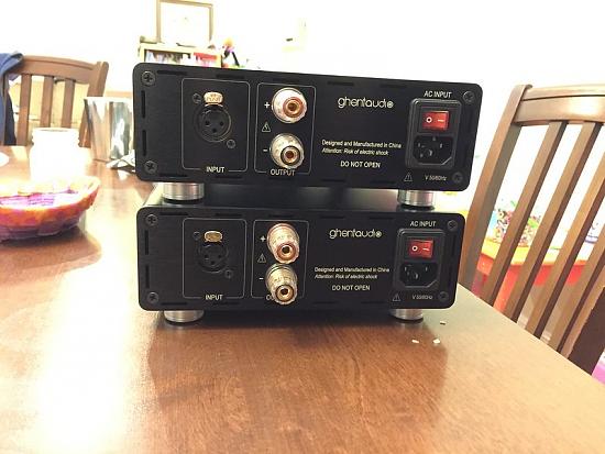

                                                                      Got my amp modules today and did some basic assembly. Which means they're about 90% done. Just need to wire up the mains, solder the input and output connections and wire up the LED. So easy!
                                                                      I have two extra amp modules and may get the SMPS1200 along with the stereo case to put one more together since it was so easy!
                                                                      Last edited by theSven; 12 August 2023, 16:15 Saturday. Reason: Update image location

                                                                        • 1670
                                                                        Sweet :-)
                                                                        I see that you are going only balanced in, what is your source?
                                                                        And what is that cable for?
                                                                          • 16059
                                                                          Yeah, it's pretty much a walk in the park. With an SMPS1200A700, I believe you'll have to modify the cables to make the right connections, as the supply and control connections are a bit different. The SMPS600 and NC400 are plug and play. Happy listening!
                                                                          • oneplustwo
                                                                            • Jan 2010
                                                                            • 666
                                                                            Sweet :-)
                                                                            Source will be a balanced miniDSP. That will likely be fed by an Emotiva XDA-2 or some TBD AVR.
                                                                            That cable is the connection between the XLR jack and the module. It carries the three pins of the XLR plus a shield. Pretty nice cable with a plug on one end and bare wire to solder to the jack on the other. That's another great thing about these... The cables that you can buy with them make the wire management very clean and easy.
