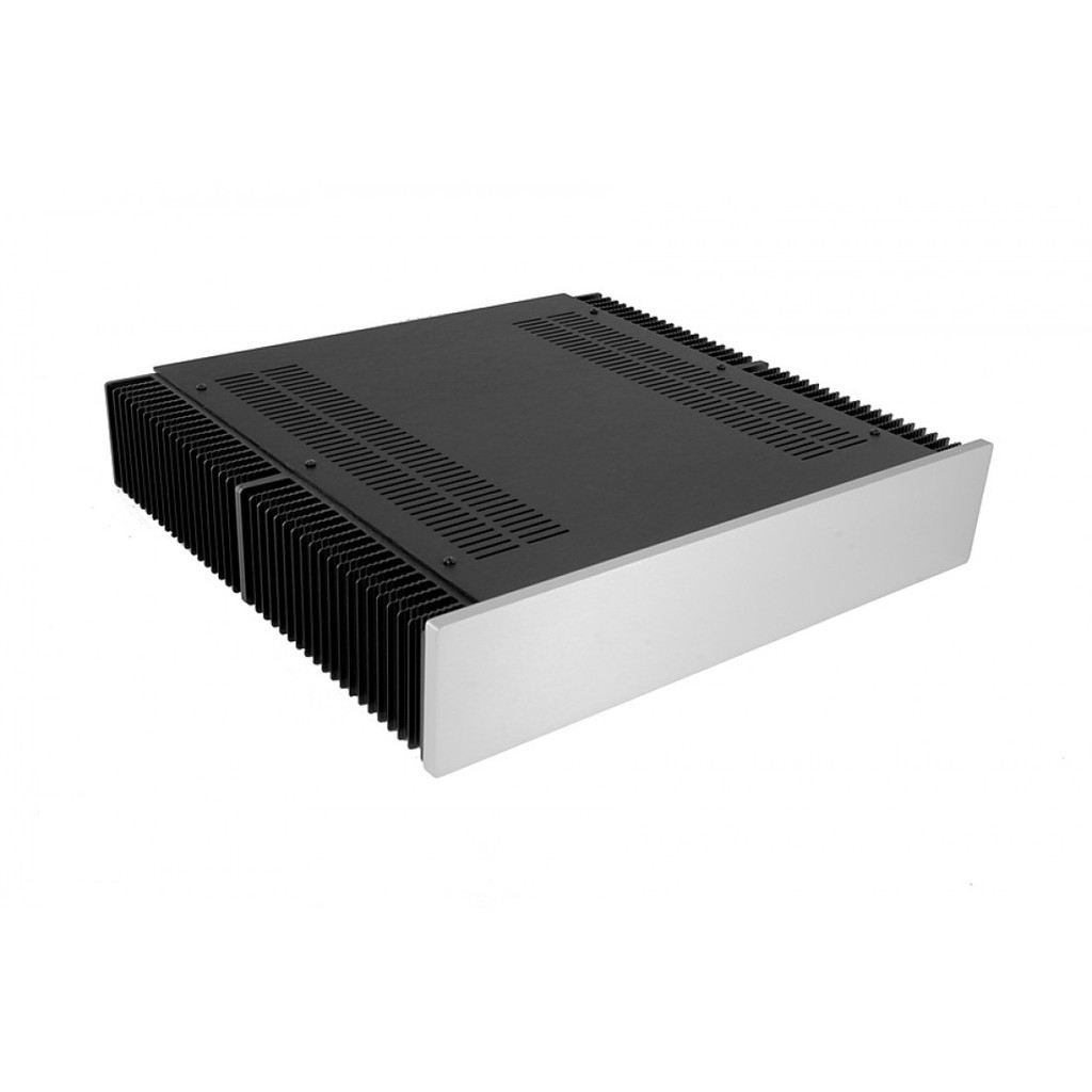

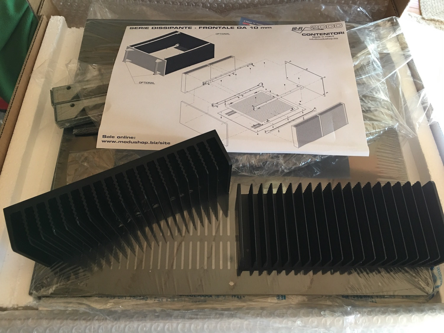

    I have need of a better 2 channel amp to plug the last hole in my down stairs setup. My current XPA-2 does double duty for music and theater feeding my Ardents but it's holding them back. Back when Ben was building his NC400's he showed me these Tenor amps and I love the look of them. The amp case has very expensive curved heat sinks that I don't want to try and replicate but their use of edge lit glass gave me an idea for the the display I thought was cool and the cherry front and trim is all me with the Ardents, my center and component stand. A version of this case with a metal front can be easily adapted as well. So the idea is to create a case that combines Trenor's amp with the sides looking like their pre-amp that doesn't have those expensive heat sinks.
Name:	Tenor amp front.webp
    Back

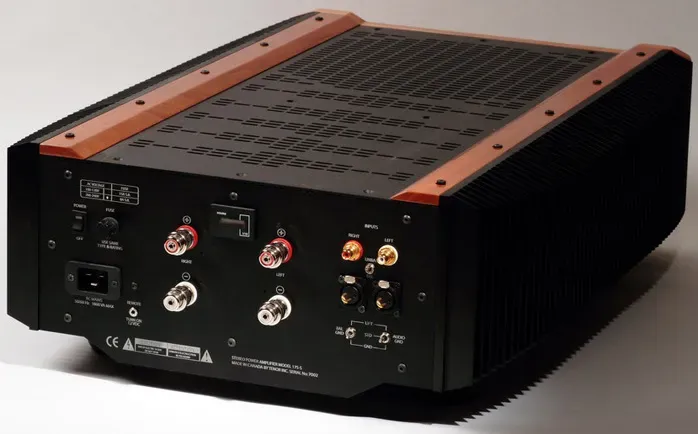

Name:	Tenor amp back.webp

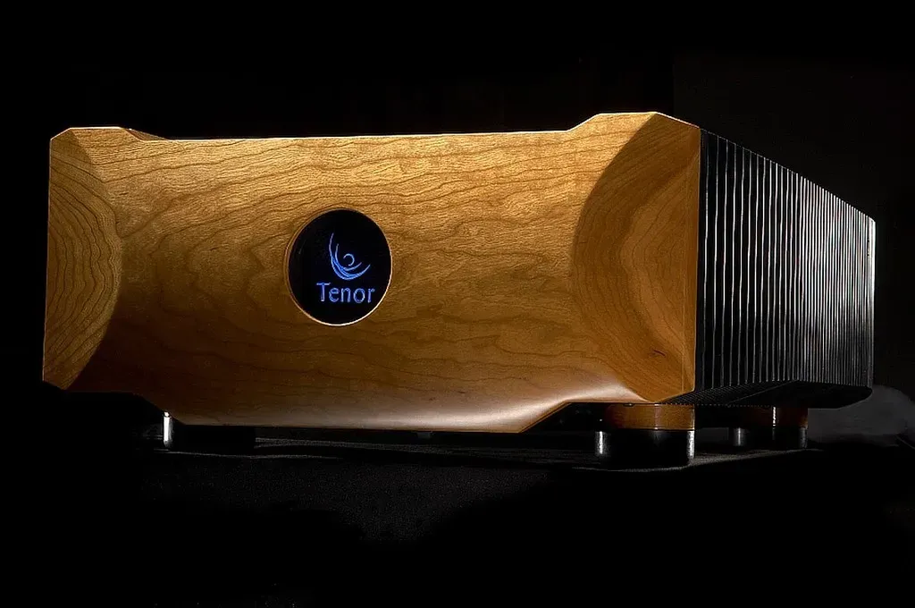

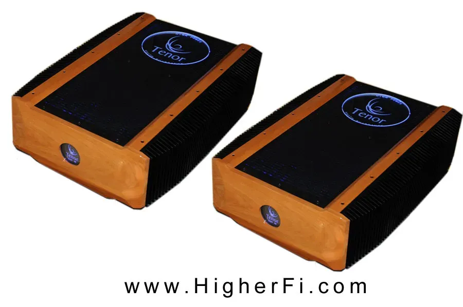

    Pre-amp sides I will incorporate instead of the expansive heat sinks not needed.
Name:	Tenor pre amp..webp

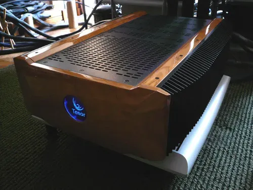

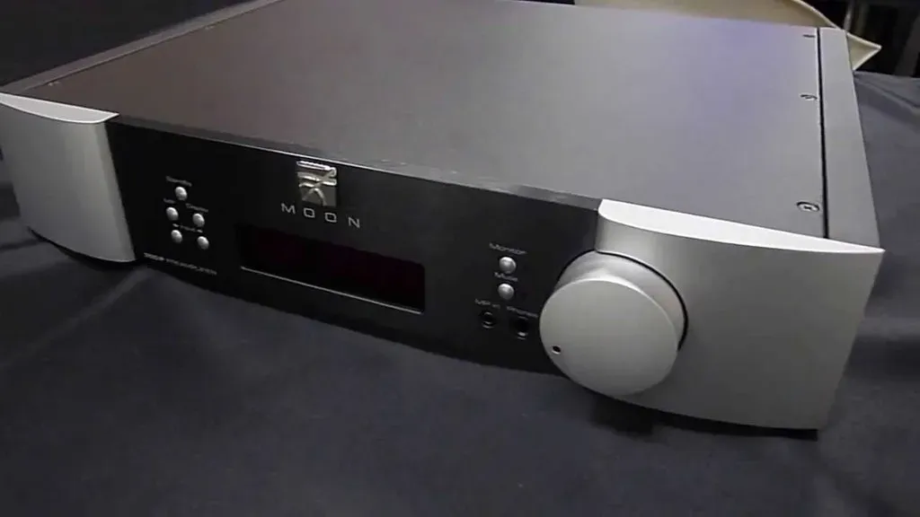

    Their new 350M even has a large edge lit piece of glass on top which I don't think we need.

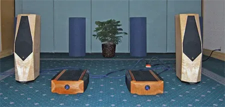

    Something tells me the Ardents will go nice with this look. :W
Name:	tenor and avalon.webp

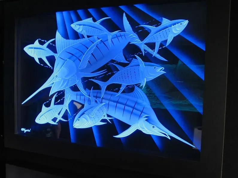

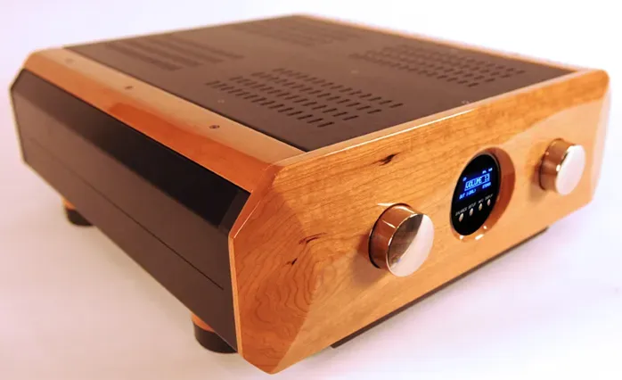

      Bumped up Tenor display
      They have just 1 piece of edge lite glass with some black masking behind it. I'm wanting 2 piece of glass, the back piece all etched and the front piece (sand basted with the Ncore symbol). here is the effect.
      The frame for the little display will be constructed from aluminum channel for running LED strips like the following and you can see the solid etched back ground in this video.
      Nothing to do if say you wanted Hypex's swoosh behind the Ncore symbol if you wanted.
      So far in Autocad a 3" display looks nice but this will depend on what U height case you want and for me the wood front has to look beefy enough to keep the look.

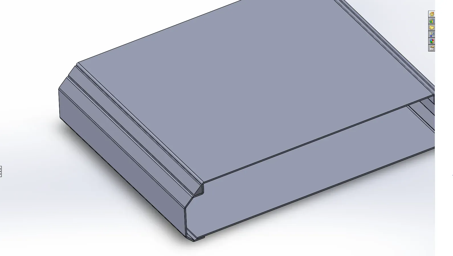

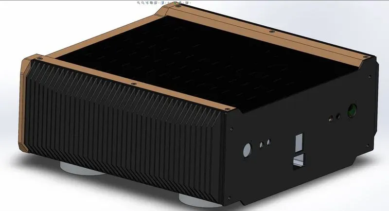

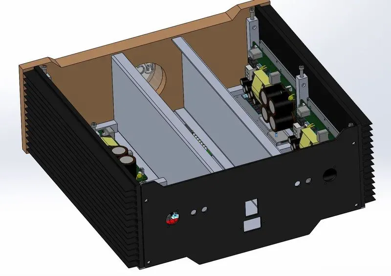

            I got solidworks up and running on the new rig. I think skipping the useless heat sinks is the way to go. Just spent a few minutes roughing out the construction. It will be a good opportunity to change somethings that bugged me about my case.
            I think as it stands I'm just going to make a case for my dad. Depending where you guys end up with the electronics I would consider doing a small production batch for a group buy or something. Ultimately anything I can contribute would come towards the end of development cycle but I'm looking forward to see where this project goes.

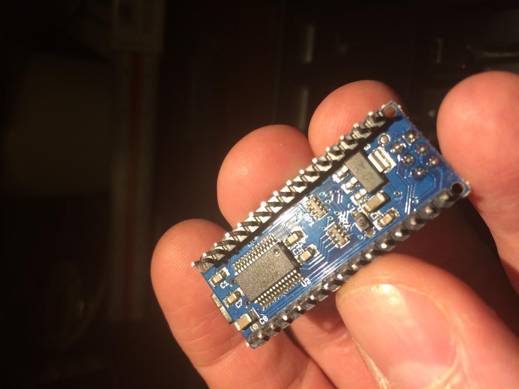

              Ben, do you know what actually controls the color of those leds? Is it the voltage passed on to them, frequencies or something else? Do you know how many amp it draws?

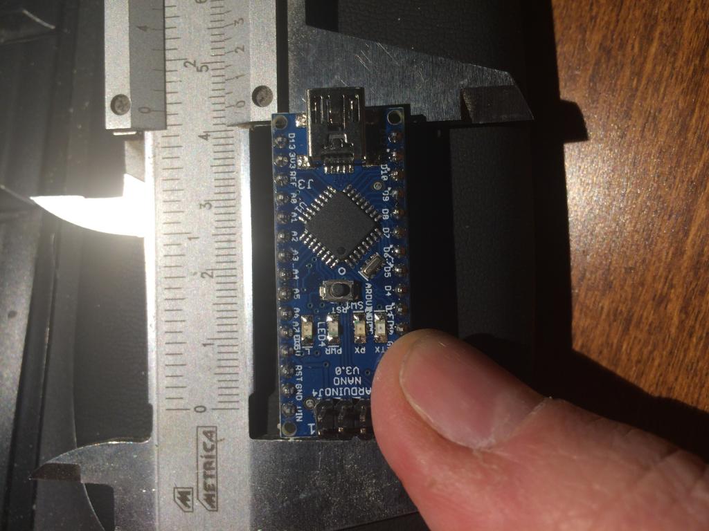

              As a basic idea I think that it is good to use the simplest tool to get the job done.

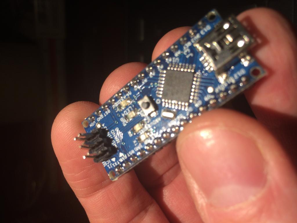

              I have some arduino nanos. They are 4cm long, but will probably work well for this. I think they were 5 dollar or so pr. arduino (pictures included).
              If the only thing we want is to read some values of the amp and show different colors (no lcd output) it might be solvable with some much simpler hardware.
              I also think that we have to be sure that we will not risk any unwanted effects on the amp itself, for example due to radio signals glose to the amp.

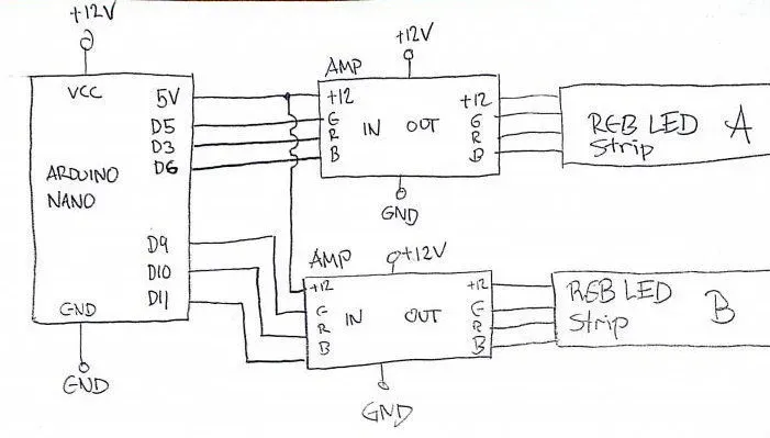

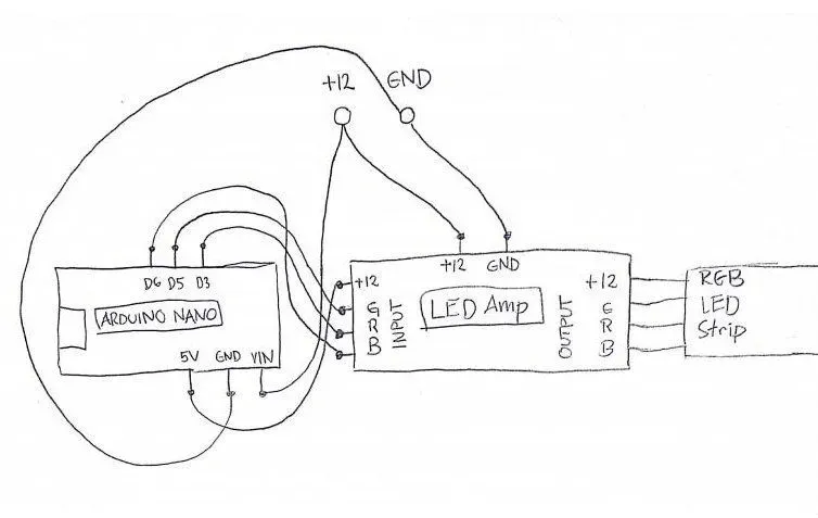

                Yes saw those and it is a great option for a static display when power is on you get 1 kind of look. Run a sketch for each strip and store on the Nano (limited memory). Just need to add a LCD amp before the strip and our strips would have no more then 6 lcd's on one glass edge, as the display is no more then 3" in diameter. Probably get this to try out.
                Wire like this for one strip but the 5v out with 12v into the Nano may be more then enough to power 12 led's without the led amp.
Name:	nono 1 strp..webp
                Wire like this for 2 strips we need.
Name:	nono 2 strips.webp

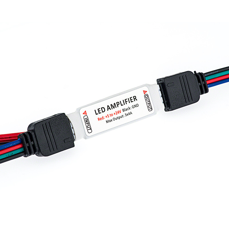

                Add a strip led amp

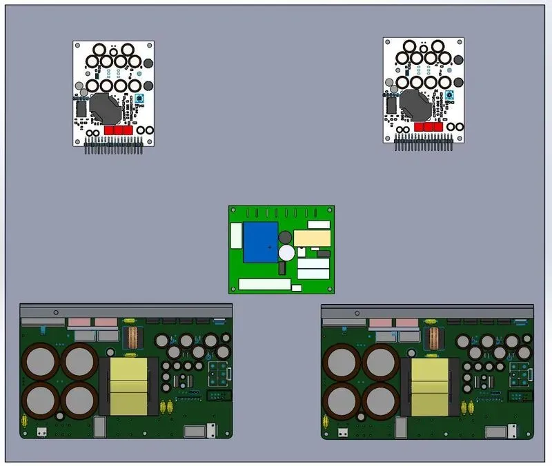

                              Need the details for whatever input board you want to use, even a 2D drawing just so I can locate the standoffs.
                              Last edited by theSven; 20 June 2023, 19:09 Tuesday. Reason: Update image location
                              • benthe8track

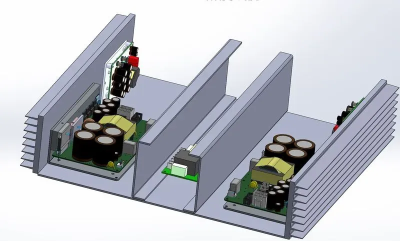

                                • 371
                                Conceptual view
                                Last edited by theSven; 20 June 2023, 19:13 Tuesday. Reason: Update image location

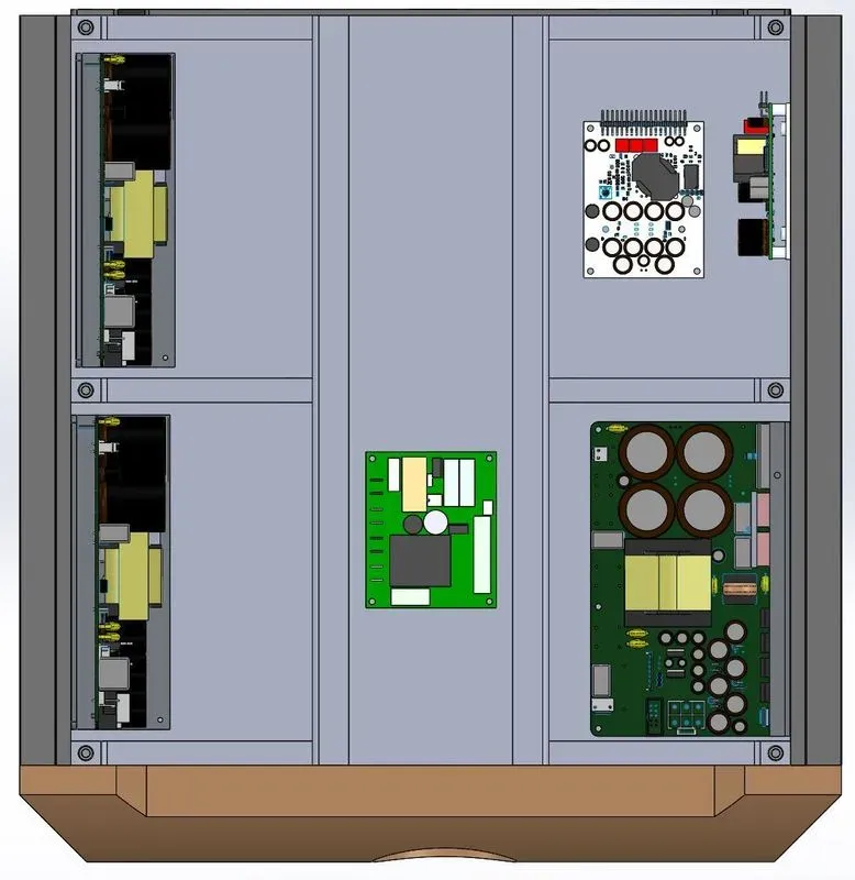

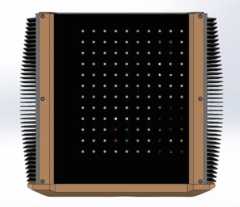

                                          I scaled it up a bit, there should be enough room if your board and the SMPS have a similar foot print. These are in no particular layout, just demonstrating the space.
                                          Originally posted by TEK
                                          For your information. The oem coverter cards has the same size holes as the smps as far as I recall. But while the smps and the nc500 has a metal plate below, the converter board does not.
                                          Noe it would be grest to have some ideas about the size of the input board Jon is cooking up...
                                          Ben, do you think it will be doable to stack 5 input boards and 3 smps into a box?
                                          I'm thinking about a 5 channel amp, using a dedicated smps for the center channel and then two and two for the other 4 channels.
                                          I think dar is thinking about a 3 channel amp.
                                          Maybe it is possible to have a base design that supportd adding more amps?
                                          It looks like that would fit. You would mount them vertically along the braces, just with different spacing.
                                          Getting closer:
                                          Last edited by theSven; 20 June 2023, 19:17 Tuesday. Reason: Update image location
                                            Jon, so glad your over that and feeling more comfortable.
                                            Not bad with a little conference design time, Ben did this in 3 hours! I pushed for 4u height and full depth as the front wood and portal hole for the display will look close to the Tenor. I wanted angled sides but I think his straight heat sinks will work well. Top trim pieces may get a little thinner as the model now looks a little chunky to me but I do like. This will need tall feet and I may combine wood with something like the Tenor. Front wood based on a 2" wood slab but it may get a little thinner based on a rotary cut piece of cherry I can source.
                                            TEK, I think this can be altered with steel front and maybe brought down to 3U but it does look like you could do a five channel 2 power supply or at least a 3 channel. Open to any layout ideas? Jon ordering amp parts this week but can wait to see how big your input board is.
                                              I like it and are getting more and morr sold on the wooden front.

                                                      Well my take is we are starting ahead of the game with TEK's nice OEM prices, Thanks again:T I am building a case that seemed simple at first until I had to source that cherry slab. Had a 12/4 flat cut piece with great growth ring showing with no knots or checking in my hand for $150. Put it back as I felt bad I would be shaping most of it in the garbage. I can't go with the ebayer's as they claim low price but have high shipping and it's not in my hand for careful inspection. To bring a piece in, it will be longer and probably more money. So maybe that's why Tenor charges so much. Along that line the front is going to be a lot of work to shape a perfect front like Tenor. I sold my 2 channel and my pre is soon to be gone as well and I'm probably going to add a Moon NEO 350P (can't go anywhere near the evolution series) as I want nothing in the way of the Ardents being held back. This is $3,700. just for the pre. Highest end with theater bypass and sub out, 10 year warranty. This is a great price for this new pre where I am.
                                                      So for the dual mono yes lets do something that improves sound and has no anomalies in the measurements. As far as I'm concerned lets start with (it is what it is) to beat Ncore 400 and NAD. We are considering coming from a wall and we know the target they are pushing. This will put me in a great position to evaluate any dac for the future. I will always have a pre in front and a clean amp now just evaluate dac and only upgrade if it's better! Not sure on storage caps pushing the SMPS700 is this for speed or something else? Connections as clean as possible is worth it to.
                                                      Tek if you going with our case concept we should try to get a layout for Jon's input, 2 SMPS and 3 amps in a 4U case. For the dual mono in 1 case I would bet we need to stop those dividers short somewhere or take them out. Jon if you can get a estimate on you maximum foot print we can arrange from there. So is the input more then say $250. as I will play the game Jon cause you can now show me the money with measurements, haha.

                                                        Being an old school kind of guy without a lot of spare time for chassis construction, I ordered the parts to make this for my Dual Mono chassis today.
                                                        you can tell I grew up in the 70's... :W
                                                        Pondering if I'll install SpeakOns as well as binding post terminals (probably will use the same Vampire posts I prefer on the speakers...)
                                                        Inputs will just be balanced Neutrik.
                                                        Last edited by theSven; 20 June 2023, 19:20 Tuesday. Reason: Update image location
                                                          Ah, have to give us the dimensions as it looks smaller in depth then mine? If you can squeeze into that I should be okay.
                                                            • 16156
                                                            Full rack size width, 400mm depth. Hopefully I'm not going to have an "oops, I did it again" moment after I go back and recheck dimensions.... :W

                                                                        A little bit of refinement yesterday and today. I may get the heat sinks machined if I can't find an appropriate blank:
                                                                        Last edited by theSven; 20 June 2023, 19:22 Tuesday. Reason: Update image location
                                                                          Very good Ben, your bringing Minion to a whole new level! When you get a chance you should post up the metal front option. Only thing on the model is easing those sharp corners every where on the wood. Wonder if little slots or dots is easier for venting. Now if those heat sinks aren't $500 to produce we should be good to Go.
                                                                          Funny how when we swapped parts in and out you can pretty well lock in on what Tenor did. I don't know if they were working in metric or not but they like the number 3/8. 1 3/8" thick finished front before rounding and the top strips are 3/8" thick.
                                                                            • 16156
                                                                            Very classy, Ben... I don't think I'll be able to match that just by slapping a piece of Cocobolo over my silver front panels... :W
                                                                            Very 21st century, with all the organic curves. Who will make that heatsink with the variable width fins? the beveling on the top of the fins is a nice touch, too!
                                                                            Too bad I'm mired in the 70's.... :B
                                                                              Very nice Ben!
                                                                              The fins really up's the layout I must say.
                                                                              But there are something "strange" about the first render. For me it seems like the lower part of the fins are straight, and not variable with as shown on the lower rendring. Probably just something with the angle that throws me off. I'm a bit curious about how the lower part of the fins look. Could you make some rendering from other angles as well?
                                                                              I'm also a bit curious about manufacturing those fins. Looks complicated (and therby expensive...).
                                                                              Dar: What kind of wood are you thinking about using? You mentioned cherry in a previous post. Is that because that is what you think Tenor is using - or some other reason?
                                                                              I must say that if I'm going to build these I'm wondering about using Walnut. That would go nicly with my Ardents :-)
                                                                              I do however think that it would have to be regular walnut - and not burl - dont think I will be able to get my hands on a pice of walnut burl - like this guy for example:
                                                                              Last edited by theSven; 20 June 2023, 19:45 Tuesday. Reason: Remove broken image link
                                                                              • benthe8track
                                                                                • 371
                                                                                Thanks guys, maybe this pic is more clear.
                                                                                Jon, once all the geometry is locked in I'll send the STEP files out for quote on the fins. I may eve try eMachine shop, I've never used them before.
                                                                                Last edited by theSven; 20 June 2023, 19:23 Tuesday. Reason: Update image location

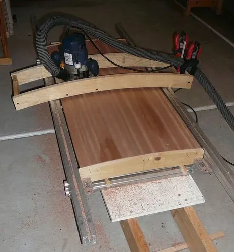

                                                                                  Yes Tenor uses flat cut cherry and my speaks and stand have cherry. Glad you are thinking Walnut as Ben may do a walnut one as well. I have got to make my plan for a Gantry router jig to rout the curved front. With this I'm going to get some metal rails cut to match the radius of the curved front. I can get you some made for you too or get a front 90% made for you as I have a feeling I am making at least 2. I could do one for Jon to if he was willing to step out of the 70's, haha.
                                                                                  The Jig will be similar to this.

                                                                                    Going to send my pre-amp to the new owner on the West coast so I'm back to just a Marantz AV7005 and EMO 5 channel amp. More Netflix less music, the rack looks empty.
                                                                                    Ordered the new Moon Neo 350P but that's a 4 to 6 week wait as I went with the 2 tone. All silver is 6 Months, guess those are very popular in the far East.

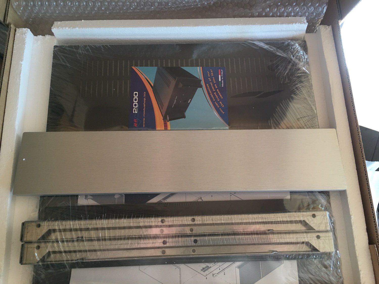

                                                                                      The case from HiFi 2000 in Italy just arrived- color this 70's guy impressed!
                                                                                      Film at 11...
                                                                                        • 16156
                                                                                        Surprised how fast it got here- very nicely packed. If I did more DIY electronics I'd probably be going nuts over these guys...

                                                                                        I think ET might be interested in one of the bigger versions of these....
                                                                                        Last edited by theSven; 20 June 2023, 19:32 Tuesday. Reason: Update image location
                                                                                          Ah, nice bolt and go! Still think you should do a Tenor and I bet the girl friend would like that in the living room with that sub. :W

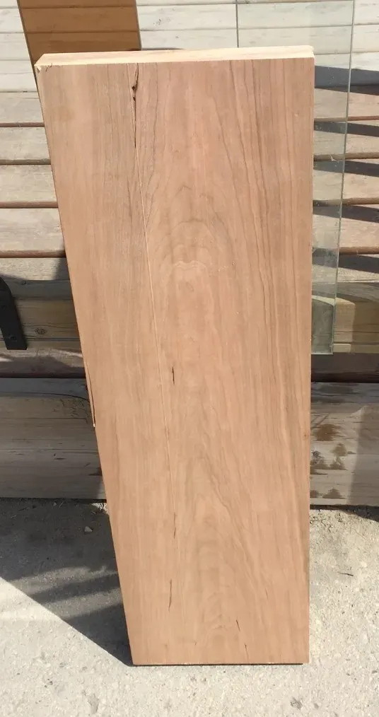

                                                                                          Finally sourced some 8/4 cherry with a great flat cut grain. They had 2 pieces 8' x 9" wide and a 10' x 8" wide. He said take what you want as long as there is 30" left off either end. I took 30" x 9" right where the grain was the best. $50. bucks! I previously went back to another place that I put a 12/4 piece back on the shelf that was $150. I didn't want to murder it and throw all that cherry out. This felt like Christmas as I was thinking I might have to order in a 8/4 x 8' piece in and couldn't see the grain before it was payed for.
