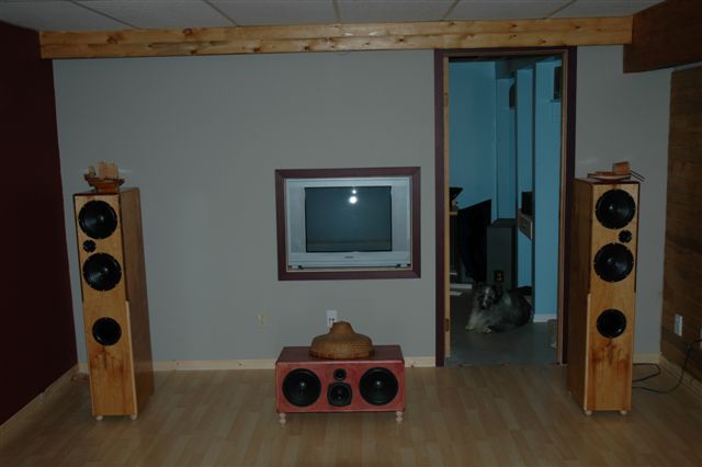

    While I like the response of the current incarnation of my home theater/listening room for two channel music, I need a sub for movies. Is there anything stopping me from building a box in an adjacent room with the speaker and vent fitting between two studs but isolated from the wall. I am planning for the driver to be above either speaker in the pic, possibly two subs depending on what kind of amp I decide to go with. Any thoughts or suggestions?
    sounds like you need an IB sub
    the cult
    since you've already overcome the biggest hurdle( willingness to cut up you house) you owe it to yourself to at least consider one
    "The appreciation of music is subjective.The reproduction of music isn't."-Bill Dudleston
      Is there anything stopping me from building a box in an adjacent room with the speaker and vent fitting between two studs but isolated from the wall?
      Nope, not a thing. In fact, IIRC, Andrew Pratt did something similar in his theater room. You might drop him a PM and see what he has to say 'bout this. It could have been someone else, but I believe it was Andrew. Having said that, Robert's comments about the IB are dead on. If you have the access from your theater to a large area such as the attic, basement or other un-used space look into it.
        Yeap go with an IB. You'll find lots of examples in the Cult photo gallery pages

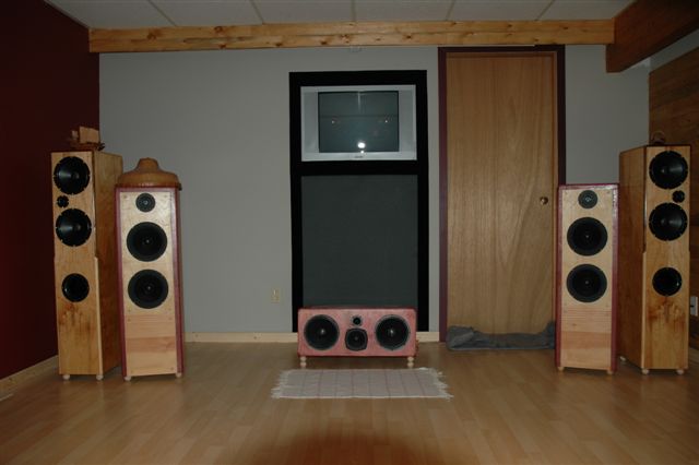

            Ouch. That has got to be a bright room, Taz. Anything in there to absorb those reflected soundwaves? No rug, etc... nada? That could really improve things in that room.
            BTW, I hope the IB thing works out for you.
            I've got it on a to-do list myself. I might actually tackle it as a sooner than later project, as it won't take too much time or fabrication to do.
            I'm thinking about one of those Behringer EP2500 amps and a pair of the dB PL15D4 subs to start, with a manifold than can house four of them if I feel I need more. I'm probably going to skimp on the BFD at first, and then add it in later (before adding two extra subs for sure). It's starting to cool off in this Texas heat enough to where I can probably crawl up in the attic early this weekend (before it gets too warm) to take some initial measurements of the crawl space area and scout it any probs that could get in my way.

                Bright, I just wear sunglasses
                Yeah, bright would be a kind word and the work needed to change that will be happening this winter. In other words probably starting this month.
