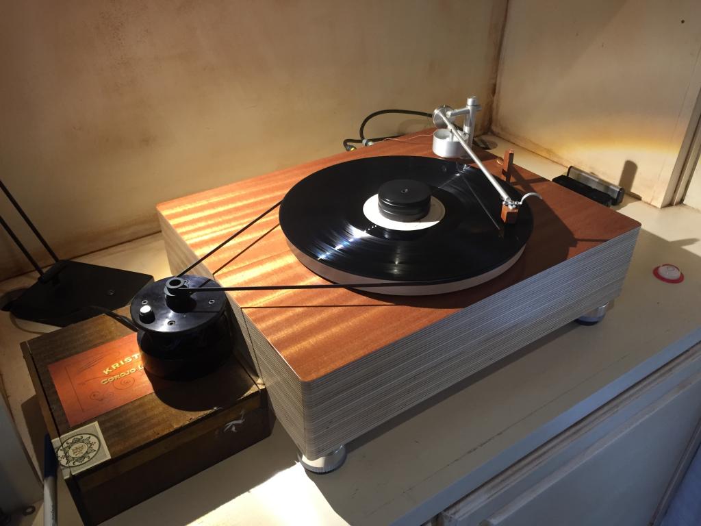

    Well Tempered Turntable Makeover
    I still need to build a proper motor mount and would like to find, or build, a speed control similar to the no longer available Phoenix Engineering Falcon. But, really pleased how this taking shape
    frik'n gorgeous!
    what tone arm & motor did you use?
    • FastTimes
      • Feb 2015
      • 7
      it's a well tempered tonearm & motor
        nize!
        i also approve of your cigars.....
          Very nice - and the cigar box adds character.
          • Kevin P
            • 10812
            Very nice. The cartridge looks like it's made out of a block of wood.
            • FastTimes
              • Feb 2015
              • 7
              It's one of the wood body Grado cartridges

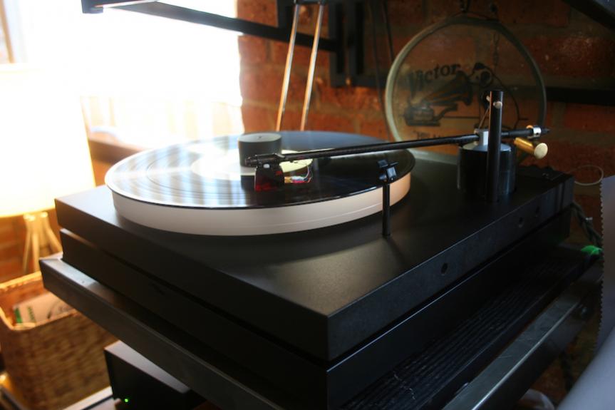

                Here's my Well Tempered rebuild
                Here's my Well Tempered Simplex rebuild. We've renamed it the WT "Complex."
                Bought it as just a plinth with motor and bearing off eBay, adapted WTRP bearing, spindle and platter purchased off eBay to it by building a lower base. Moved the squash ball feet to the lower base, bought an AC adapter, built the arm and arm suspension, counterweight, arm rest and designed 3 parts that a friend printed 3D for me. Originally tried to adapt the 5-pin DIN plug to the plinth that WT Lab uses, ID'd by another Simplex owner, and tracked it down in China ($40 for a $10 plug...) but it was a slightly different part than used on this particular Simplex plinth, so I wired directly to the PIB box. Took some time but sounds very good.
                "Click image for larger version
                • flamethrower1
                  • 392
                  Here is a link to a controller that works well.
                  It is designed by the the original designer of the Falcon and Roadrunner.
                  Not to difficult to build and works very well.
                  http://www.diyaudio.com/forums/analo...tor-drive.html
