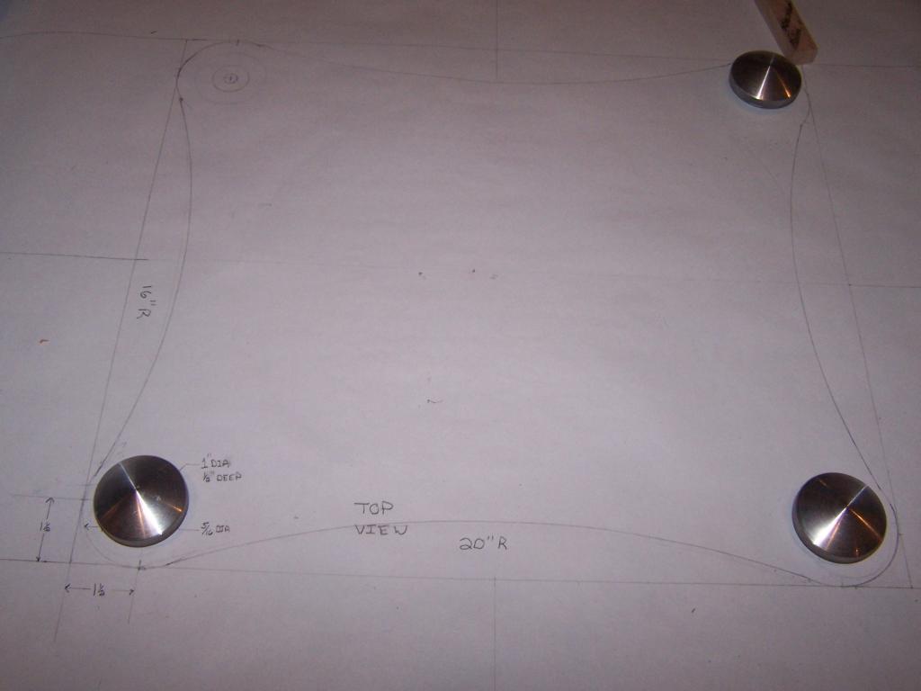

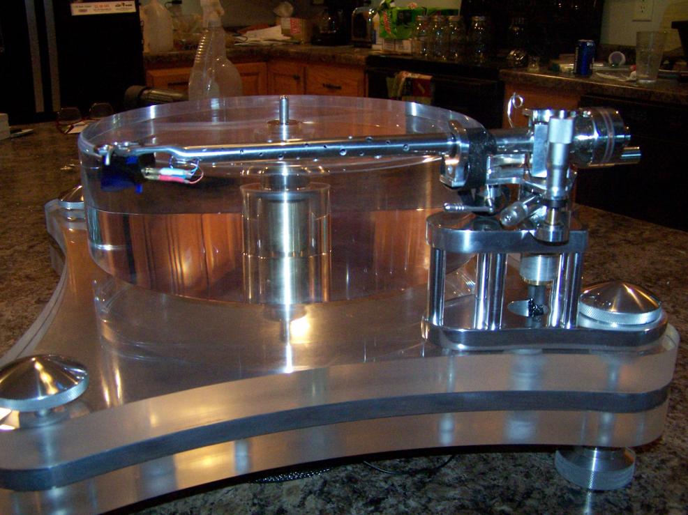

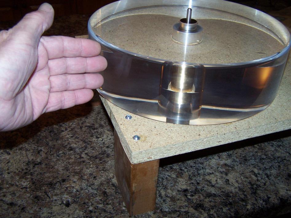

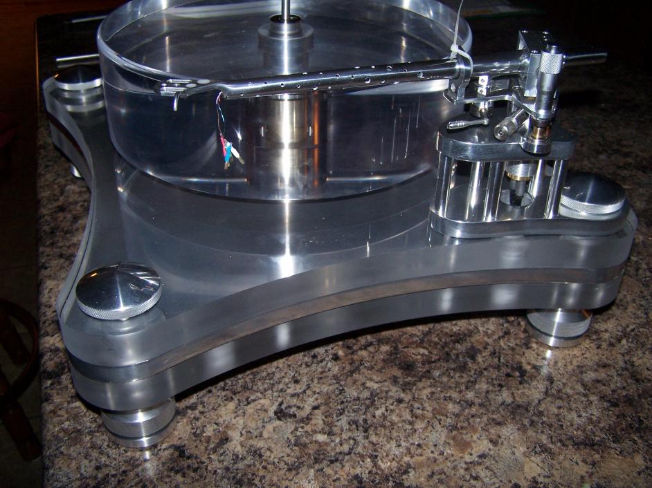

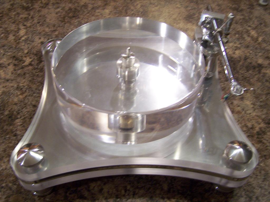

    So in my quest of audio nirvana from from a record lathe, I came up with this design.
    I have only run it with my test cartridge which is an Ortofon Blue and it sounds very nice.
    Have yet to build the motor housing and controller for the BLDC motor, it sounded great even with the VPI motor.
    It has a custom made bearing and platter Audiomods arm and, will end up with a ZYX 4D cartridge.

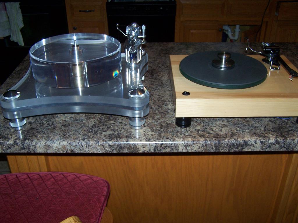

    One more pic

      Beautiful! That's one ambitious project, I'm very impressed. :T
        • 2142
        Very cool!

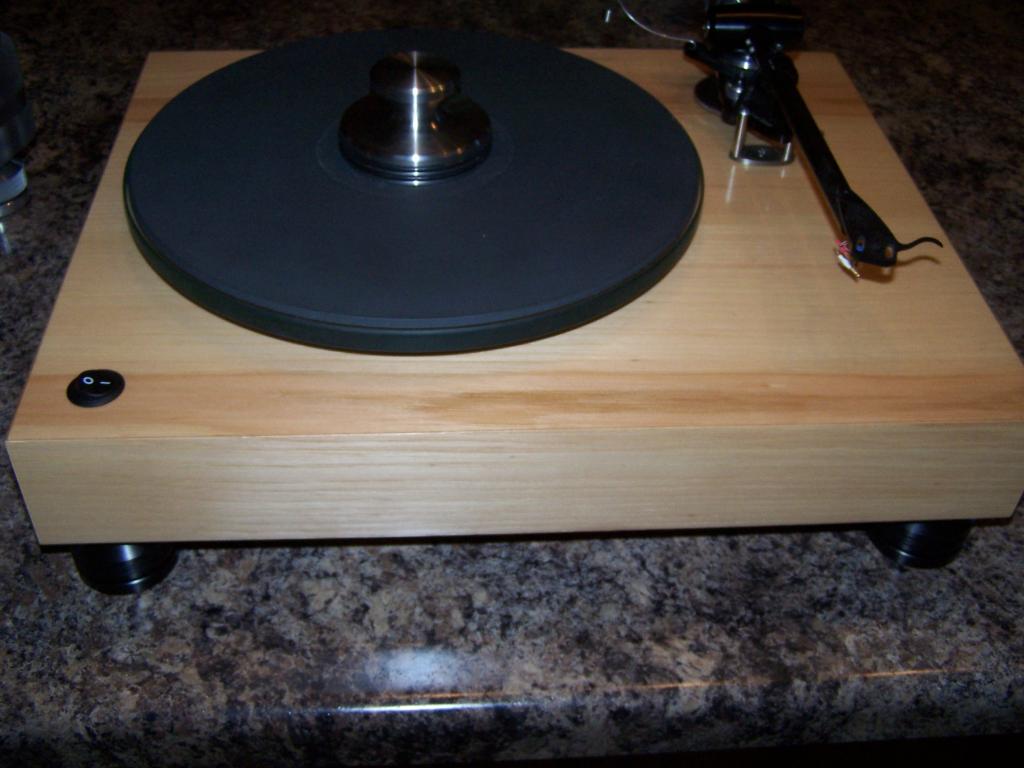

              classic vs contempory
              I just finished up another deck, thought I would post a pic
