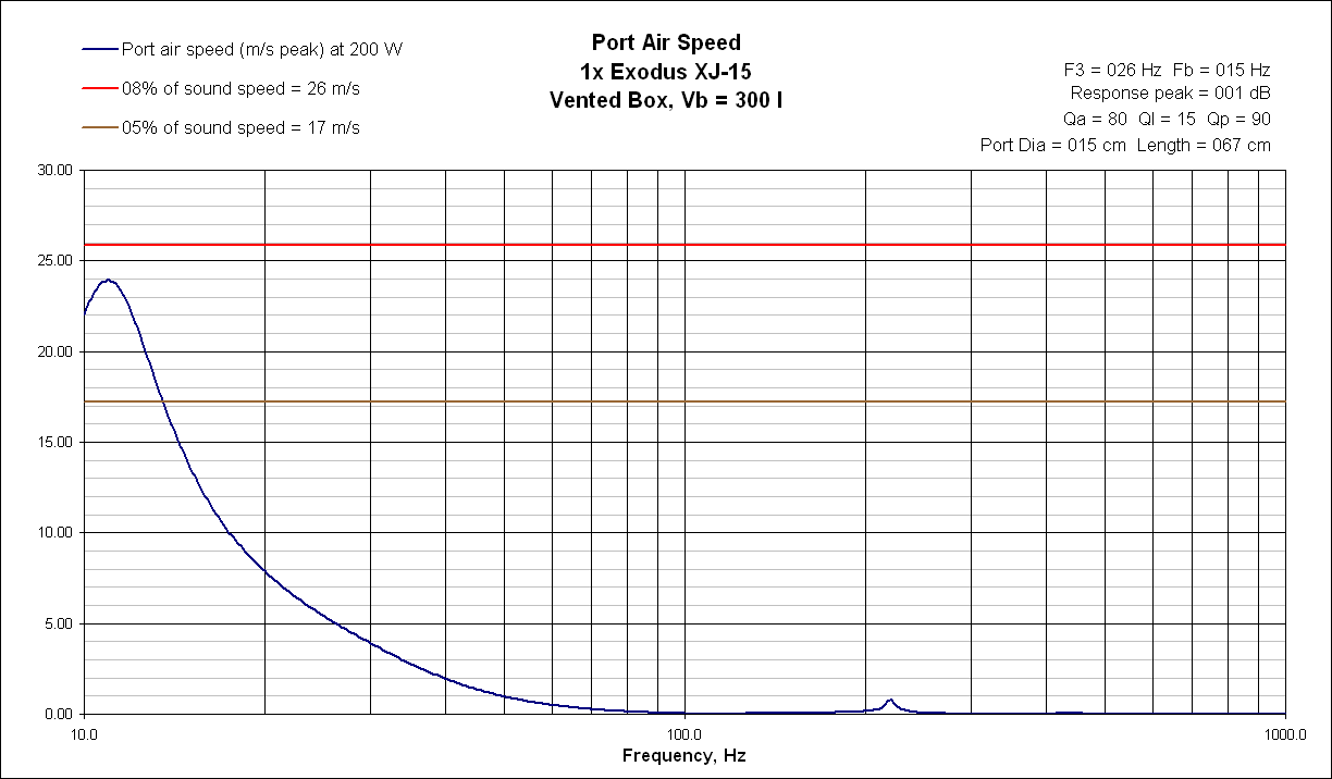

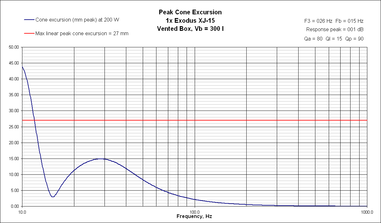

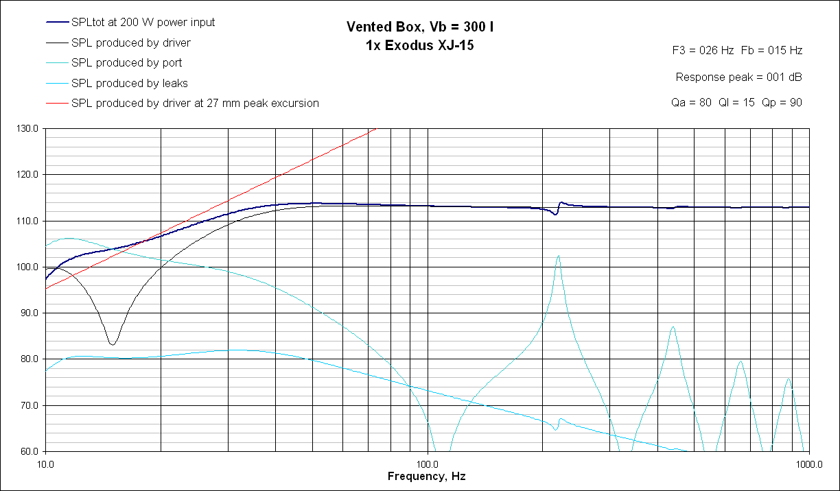

                                            Just modeled that exodus xj-15 in winisd and it tells me that I need a box enclosure of 930.5 L (32.8 cubic feet). I used a dia (I presume a diameter) of 15 inches for winisd, that correct? Probably makes little difference for modeling anyhoo.
                                            Frequency response is FLAT down to about 15 Hz. Now the question is can I build that monster enclosure?

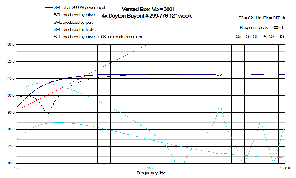

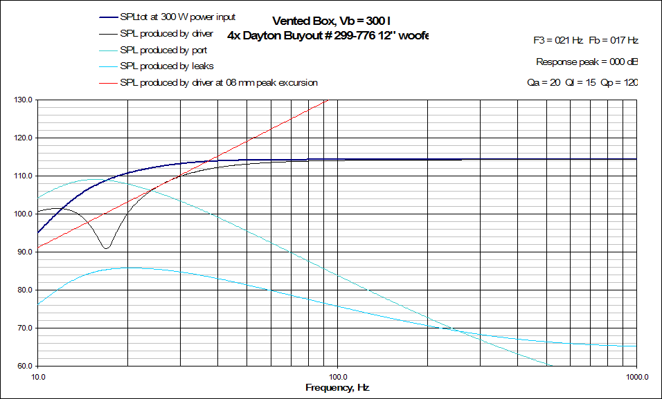

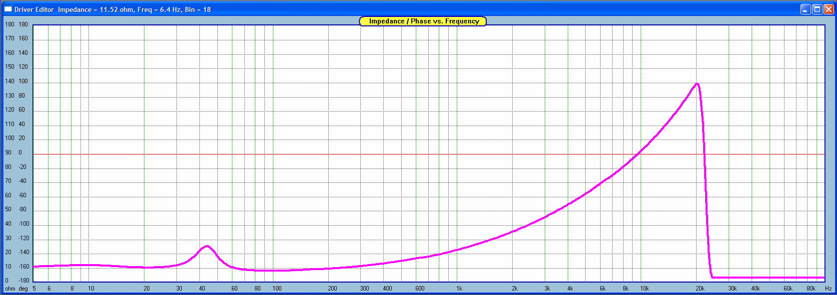

                                                FWIW, here is another inexpensive approach that I'm considering. I picked up four of the PE Buyout 12" drivers and considering using them in about a 300L cabinet, in a 2x2 series/parallel setup. They were a DOTW awhile back and only cost me $60 for 4. Still, they are only $20ea. now or $18ea. for four.
                                                PE 12" Buyout
                                                They only have 8mm xmax, but below is what I get at an input of just 75w per driver, with a 6"dia. x 19-11/16" long port. Also, I measured one in a 1.4ft3 sealed cabinet and the FR and impedance are below:

                                                  Interesting... how much ampage would be required to exercise these babies?

                                                      • 1456
                                                      That Unibox model was with 300 watts into an 8ohm load.

                                                                Well, that was 300w total, all four drivers, mono. Since that is a 2 channel amp, I would think you could power two pairs of parallel drivers, one pair with each channel. Each channel would be presented with a 4ohm load. You would have 400w available per channel, and the drivers would be reaching their XMAX limits at just 150w. Seems like lots of headroom to me. You could also make it two boxes of 125-150L each, each box with a parallel pair of drivers. That would give you flexibility in placement and orientation and much lighter boxes to handle.
                                                                However, at just 50w/driver, a total of 200w into 4 drivers from one channel, you would just lose a couple decibals (see below).
                                                                FYI, 4-12" driver has a little more driver surface area than 2-15" drivers, by way of comparison.

                                                                        Thanks Thomas!! The driver models VERY well in a 300 L box (using unibox) which sizes out to about 33 x 33 x 18 (w x h x d). See attached plots.

                                                                            Hi Adam,
                                                                            I'm planning on a 300 L ported box with a tuning frequency of 15 Hz. It will have a 6 in diameter port which is 26 1/3 in long. The dimensions will be 33 (w) x 33 (h) x 18 (d). The unibox model graphs are attached to one of my posts on the 1st page of this thread. They look ok to me.
                                                                              Z,
                                                                              That does look good.
                                                                              Could you post a plot or two with the tune raised to 17-18.5hz - ish. Even better would be to use the "save graph" feature so that they are over-laid. I'm just curious.
                                                                                  Hi Adam,
                                                                                  Try modeling that with the Nady amp in bridged mono (900w). You're not even coming close to pushing that driver with only 200 watts.

                                                                                    • littlesaint
                                                                                      • 824
                                                                                      Isn't that Qts on the high side for a ported box?
                                                                                      Santino
                                                                                        • 16060
                                                                                        Yes.
                                                                                        And I'm not doing a ported box....
                                                                                        Trix are for open baffles, not for rabbits.
