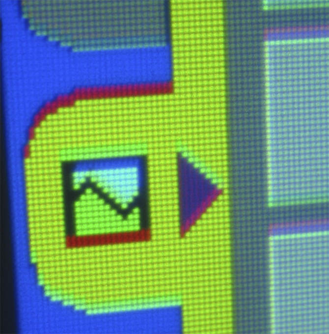

    Dear All,
    I have a 6month old PLV-Z2 projecting about 2m to a 6ft screen.
    Recently I have begun to see a red halo, about 1-2 pixels wide above OSD menus and also from a component signal from a DVD. This is accompanied by
    a similar blue effect below.
    Not sure what the technical term for this is, perhaps RGB convergence?
    I believe this is probably due to the alignment of the 3 LCD panels within the unit. My questions is:
    1. can this be corrected thru one of the 500 options in the service menu
    2. does it mean a back to base for a service engineer fix.
    Any help greatly appreciated.
    Cheers
    Adrian

          Thanks for the replies. I am now in contact with the vendor for a warranty repair or replacement. If anyone is interested I've attached a screenshot of the problem.
          Cheers
          Adrian
            • 16118
            Whoa!! Definite panel alignment problem! And we thought only CRT projectors could have these kinds of problems! at least in that case, they're user adjustable. They should fix this under warranty. Hope it goes smoothly for you.
            ~Jon
