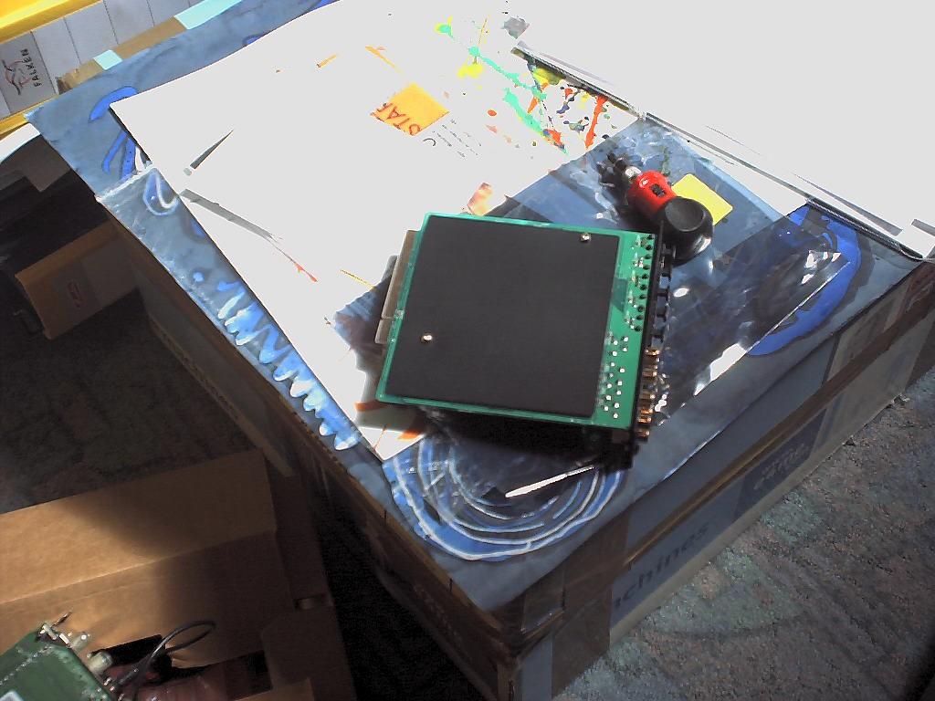

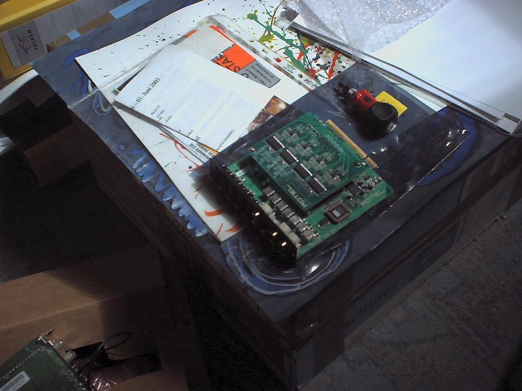

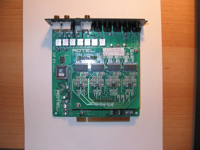

                              The shield is placed directly on the DSP board. It is a thick metal plate with a thick plastic foil on one side. This side is put on the board so that no electric contact between the parts can occur. To place the shield you cannot just remove the DSP board, but have to remove the top cover and then the metal cover of the board (many screws!). This is due to the fact that when you replace the DSP board back in the unit, you have to support the board where it goes in as rather strong force is required. It is also easier to remove the DSP board if you go this way round.
                              I have done some picture of the DSP board with shield that I could send you if you like. Unfortunately I have no way to post them online as I didn't find any free picture hosting yet. Give me a mail if you like to have the pics.

                                Are the pictures too large to post them here by means of the attachments? If you want to show them in full size in your post, then use the "insert image" button in the toolbar and enter the address of each picture in your thumbnails. That´s the way I chose to show my pictures. Or just restrict to the thumbnails only. Then you have to click on each pic to get a full size view.

                                    • Ossi
                                      • Jul 2003
                                      • 53
                                      Let's see... Hm... not the best quality, but you get the idea.

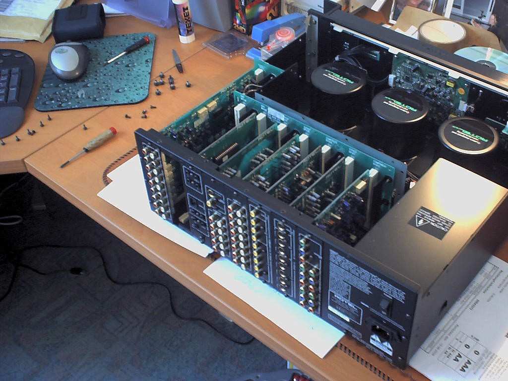

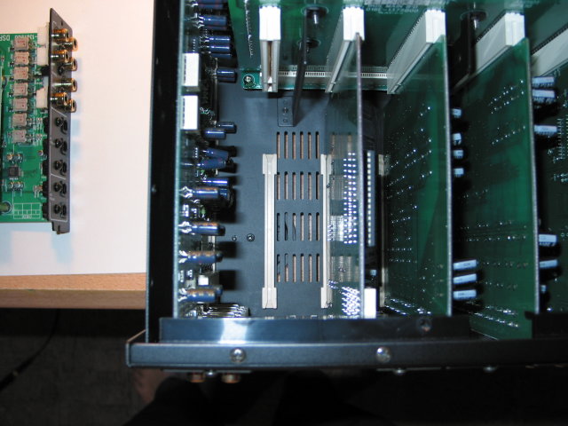

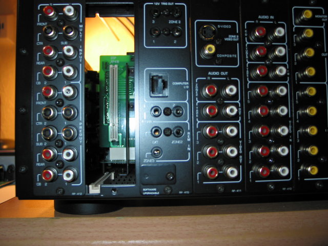

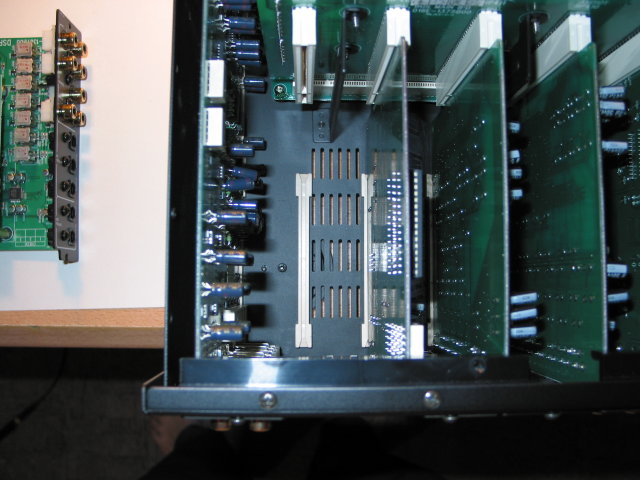

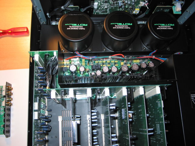

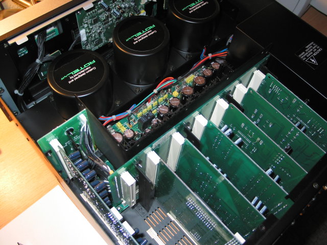

                                      • Wolfenstein 2k2
                                        • 86
                                        Hi!
                                        As I had nothing better to do, I wanted to exercise myself in opening and closing my 1098. After all I will have to do that anyway when the shield plate arrives. While doing that, I made some pictures of my "naked" 1098 as well! 8O By the way, warranty won´t be lost - Rotel promised it :T

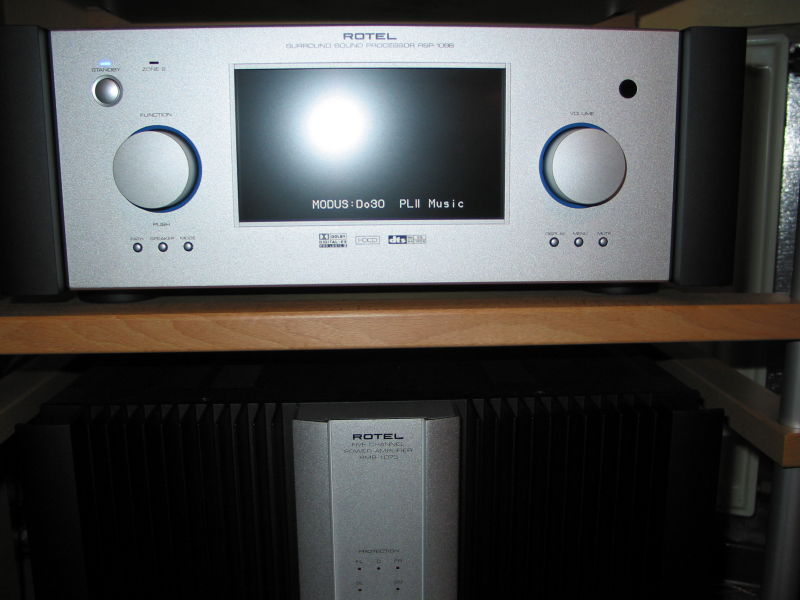

                                          Still I wonder how it's possible that some people can turn volume up to maximum and NOT hear any hiss at all (unless it's muted or something, which it does sometimes)
                                          And I also have that display bug, they better fix it in V2.1.3 cuz it looks really stupid on a €3500 processor.
                                          I definitely agree on the hiss thing, it shouldn't hiss that loud for it's price.
                                          And maybe it's true that you'll never reach volume level over 70 in a small room (I don't either), but in a medium size living room I can imagine reference volume being around 85 or something like that.

                                          • DrBoom
                                            • Dec 2003
                                            • 325
                                            Seeing that chassis open again reminds me what a great machine this is, and what possibilities it must have for tweaking.
                                            I wonder why no company has started modifying it with better components and offering it as an upgrade pack.
                                            Power supply is already great, perhaps a few expensive Black Gate capacitors in the filtering stage could improve it a bit more.
                                            Also, I notice a huge amount of small capacitors on the output boards, I think if you'd upgrade those with better ones it can make a huge difference.
                                            I've even read someone who wanted to replace the opamps in the pre-outs, something they skimped on a bit at Rotel by using cheaper ones for the center and surround channels.
                                            But I guess it's byebye warranty if you do that, so maybe in a year or 5
                                            • Bing Fung
                                              • 6523
                                              OH-maw gosh that is beautiful looking inside. Thanks guys! :T

                                                    I'm starting to ask myself the same thing, why aren't the new owners complaining but just the "old" ones.
                                                    I got mine in December 2003, and it came with v1.1.6 which was the most up-to-date version at that time.
                                                    But I did notice the box had been opened and re-taped, so perhaps it was updated at Rotel Europe after manufacturing it.
                                                    I can rule out a store or demo-model, it certainly isn't.
                                                    Regarding the hiss after shield install, I didn't notice any change (or not enough to notice it anyway).
                                                    The parasitic noise is way less, but you can still hear it very faintly from really close to the speaker.

                                                                    @Wolfenstein
                                                                    I did check this morning regarding the hiss another time with the shield installed. My unit is setup to a max output of 76 which is already way to loud for me, but sometimes you like to have a little room to push it, don't ya? :B
                                                                    Anyway, in bypass mode, cd player is switched on, I here at 76 no hiss from my sitting place, 3 meters away. To here is I have to go to the speakers and can here it at that level at about 30 cm.
                                                                    With the multichannel input in bypass, just the same.
                                                                    When I switch to the DVD input which is set to a digital input, at a volume of 70 I can only notice the beginning of something like hiss. However in this case, my surround speakers are only 1,2 meters away from the listening position. At a volume of 76 I can now hear hiss at a very low level which is in my case not a problem.
                                                                    I am not sure if the shield does affect the hiss, but it sure does in my case get rid of the parasitic noise to 100% at this noise that could be heard mainly from the centre channel is gone.

                                                                      Hi!
                                                                      In case it´s right what you´re saying, then the shield HAS helped. Why? Because at a volume of 70 the hiss is already clearly starting, above 80 the hiss is more than clarly audible. At a level of 99 you get the impression as if a river is floating through your room. I´m going to describe my experinces with that shield installed once it has arrived here.

                                                                              I got my shielding yesterday and installed it immediately onto the DSP Board.
                                                                              Results: The center channel problem is solved, but there is no change concerning the hiss (I somehow expected that). At maximum volume level the hiss is still as loud as before -sounds like a high speed water jet or so. Hiss level still starts noticably to increase at about 65/70, at 80 you cannot fail to hear it (unless you are deaf), and at 99 we have the water jet or river-like sound again. Although I will never ever listen to that extreme sound levels (OK, I´m repeating myself :wink: ) at my home, I though want to know why there seems to be such a difference (no matter if some might think it´s irrelevant due to the killing volume levels we are talking about) between older and newer units. :roll:
