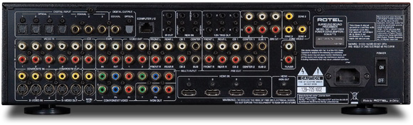

    I have a 5.1 home theater system set up with a Rotel RSP-1069 (RSP) as the processor. My video out is to a 720p, 1080i, 525p
    480p projector via s-video.
    I'd like to introduce a new (latest gen) Apple TV (ATV).
    The ATV has HDMI 2 output that I have connected to the RSP with a HDMI cable to HDMI 1. I have set the RSP "VIDEO INPUT" to "HDMI 1" and the RSP "AUDIO INPUT" to "HDMI Audio". The settings under the RSP's "VIDEO/HDMI" are set to:

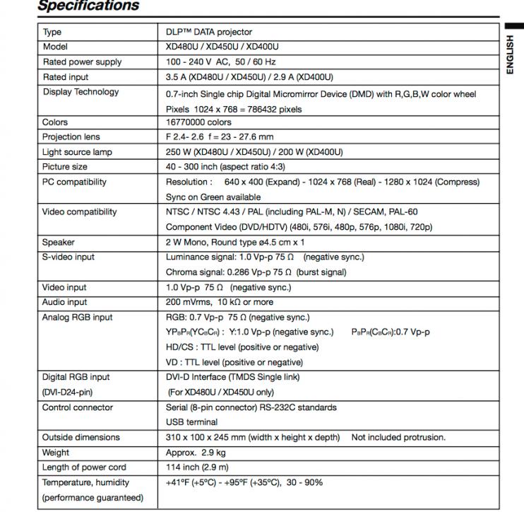

        • The aging projector is not compatible with the ATV.
        I have a Mitsubishi XD480U http://www.projectorcentral.com/pdf/...anual_2502.pdf
        • The S Video out from the RSP to the projector is not compatible. The projector does not have HDMI. Is the RSP not able to do that conversion??

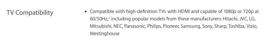

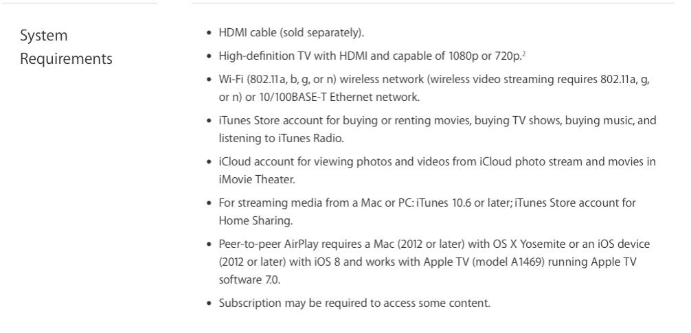

            After extensive back and forth with Apple and Rotel it turns out this is a resolution problem.
            The conversion from the ATV HDMI to the RSP-1069 MON OUT svideo to the projector would require that the ATV have a 480i output setting which it does not have (I believe previous generations of ATV have it). If my old Mitsubishi projector had HDMI or component in, I'd be all set.
            Alas, it looks like it's time to upgrade the projector to one that has HDMI and/or component input.
