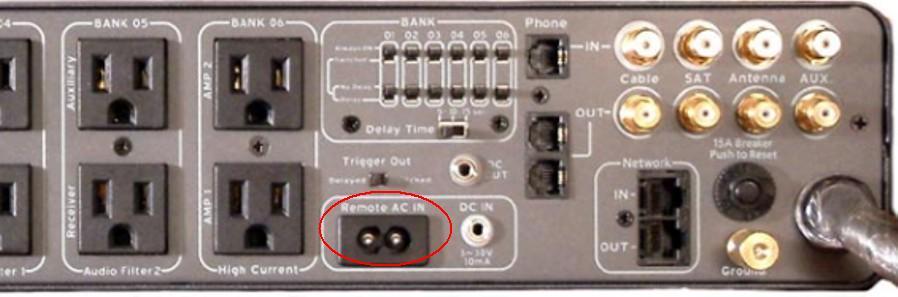

          My Belkin PF-60 conditioner has triggered outlets that work with a standard 12V trigger or control power cord plugged into a switched preamp or receiver outlet. I use the feature with my vintage Phase Linear 400 Series 2 amp that has no power switch. It works nicely, turning the amp on last and off first.

              I'm using the "remote AC cord" triggering option. A C7 style power cord goes between a switched outlet of my AVR and the power conditioner's remote AC trigger input. When the remote AC input detects power, it triggers the switched outlet bank of the power conditioner. If you leave your RB1090 power switch on, you should be able to use the Furman to switch it on/off.
