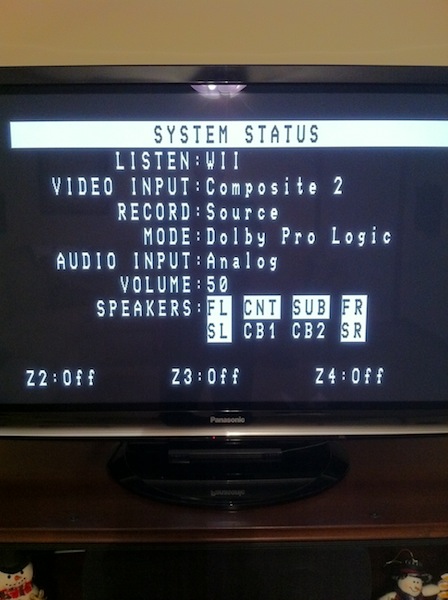

            Alright, I hooked up the Wii to the television to see if there was audio being sent from the unit via the cables. There is sound. In addition, I hooked up a dvd player to the 1570 (checked it first to validate it was working) and experienced the same problem. I have video but no audio. In addition, I experienced the same problem on composite 2 with video but no audio. I have attached a photo of my input setup. Not sure where to turn after this. Does Rotel have a support line I can contact to discuss the problem? It's only 3 days old.....
            I have the correct triggers assigned as well. You can't see that in the photo I took
            Last edited by PSUfan; 22 December 2010, 09:35 Wednesday. Reason: Add trigger information

              The configuration looks correct. All I can say is to double check that your audio wires from the WII are plugged into the correct audio inputs on the back of the Rotel. There are a lot of inputs on the back of these Rotels and it would be easy to have incorrrectly plugged them into the wrong inputs!!.
