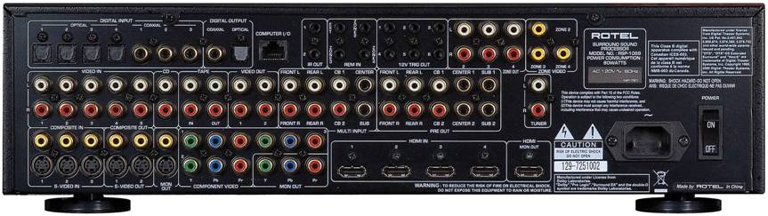

Nash - can you tell me if the 1058 defaults to pass thru for one of HDMI inputs when not powered up? In other words does the device connected to say HDMI #1 input get passed to the HDMI output when the 1058 is powered off?Originally posted by nashMy 1058 has 4 optical inputs, so I would assume the 1069 has the same - being the same architecture.
I'm asking cause I assume the 1069 would work the same way.Dave- Bottom

No, you need to power it up to get any output. FYI, when it powers up, you see a brief system status (the OSD basically) before it starts showing the input source. In other words, it has a very brief bootup.Originally posted by wb2fcrNash - can you tell me if the 1058 defaults to pass thru for one of HDMI inputs when not powered up? In other words does the device connected to say HDMI #1 input get passed to the HDMI output when the 1058 is powered off?
There's no passive pass-through, even if the device is in standby (I never completely power it off).- Bottom

Not to dispute what's written here but, is the NO HDMI 1.3 confirmed? I was seriously considering this unit to go with perhaps a 1095. I might decide to go with an AVR now, maybe the Denon 4308CI, and use that as a Pre/Pro perhaps. There's no point in waiting for the 1069 to be released if this is the case.
- Bottom
100%, it works just like the 1058 receiver.Originally posted by Steady TeddyNot to dispute what's written here but, is the NO HDMI 1.3 confirmed? I was seriously considering this unit to go with perhaps a 1095. I might decide to go with an AVR now, maybe the Denon 4308CI, and use that as a Pre/Pro perhaps. There's no point in waiting for the 1069 to be released if this is the case.

Dave , from the reading I have done it appears there is no need for anything above hdmi 1.2 unless you want the reciever or pre pro to decode the compressed bitsteam signal from a hd-dvd or blue ray player.From what I understand bitsteam decoding must be done in the player rather than the amp ,as part of the BR and HD-DVD spec, making this feature of 1.3 redundant.Originally posted by davewolfsI am still trying to understand why we do need HDMI 1.3?!?
1.3 also includes 'Deep Colour' in the spec however this again appears to be of very limited usefulness because of the lack of software and hardware that can make use of it now and for some time to come.

No DD-TrueHD or DTS-HD is a bummer .... also less bandwidth with the 1.2 vs 1.3 makes future upgrades less likely ... basically a 1068 with basic HDMI functionality and upscaling... not bad I guess but not ideal .. maybe they saving it for the 1099?- Bottom
Excuse me, again, but I'm confused here. Most (or all) of the HD video players will pass their "HD" sound sources thru analog cables ala DVD-A/SACD. The 1068 handles it just "peachy". Those formats are still shaky to say the least. What already exists in so-called HD sound format: DVD-A, SACD, DTS 96/24, is su-*#%&ing-perb already. Movies are not really a music source; they are a sound-effect source which doesn't exploit the higher attributes of hi-def sound anyway. The key here is to wait and see what the MUSIC industry will do with these options. My bet is they will not ignore any avenue for hi-def reproduction including the existing formats. More likely, they will focus on wide distribution formats to sell units; ie, the existing formats and likely (IMHO) 96/24 for convenience. The newer "hi-def" formats will be hard pressed to improve on what's already available now (in music) at a much cheaper price considering all of the licensing fees, etc.Originally posted by StevebezNo DD-TrueHD or DTS-HD is a bummer .... also less bandwidth with the 1.2 vs 1.3 makes future upgrades less likely ... basically a 1068 with basic HDMI functionality and upscaling... not bad I guess but not ideal .. maybe they saving it for the 1099?
Disclaimer: (again) If you're the guy watching "Batman Begins" a god-zillion times in some HD format, this will not make sense to you. Read on until the thread gets back to normal. Rotel sells music stuff!UFObuster, an audio gourmand....some is good, more is better, and too much is just about right.
Rotel RSP-1068, RB-1080, RMB-1075, RT-1084. Denon DVD-3910. Klipsch RF7,RC7,RF5,RC-35,RSW10.- Bottom
OK thanks help me out here then ... so will a bluray / ps3 output DD-TrueHD or DTS-HD via their analogue outputs ... ? Or can they be passed through as PCM and be processed by the RSP processor.
So there are 3 ways to get this source then from a suitable player, HDMI 1.3 (1069 cannot do it), PCM (1069 cannot do it) and anologue output (1069 can do it) correct?
So you would use the TrueHD source via anolgue through the 7.1 analogue inputs?
