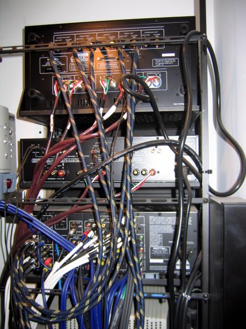

        I'm using Middle Atlantic rack rails with their custom cut rack shelves. While there's only 1 rack space between the Rotel units (roughly 1.75") the shelves have vents and there is no back, sides, or top to the rack.
        The whole closet did get pretty hot, but I've since variable speed exhaust fans that adjust depending upon the volume level (and source, 70 on CD isn't quite the same as 70 during a movie).
        Sorry for the mess of wires, I haven't cleaned them up since the last shake up. But you can see in the pic how the units basically 'float' in their spot:
