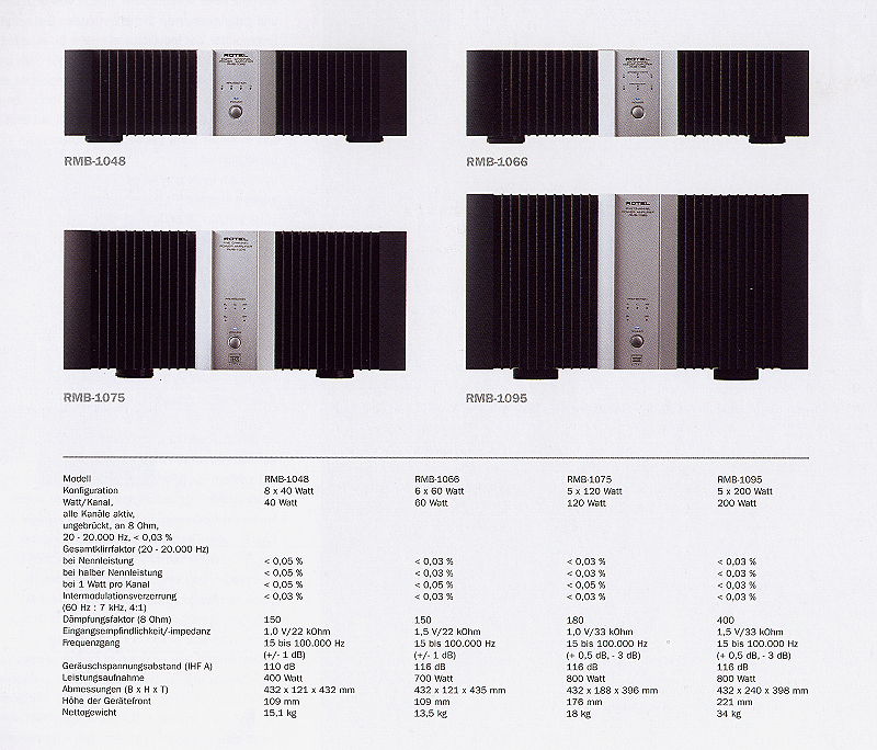

    Hi all,
    I'm a newbie to this forum but thought I would post one of my concerns to see what all of you had to say. I just purchased the RMB-1095 last week. Great sounding amp paired with my Def Techs and Denon 3805.
    However, I have one concern which Rotel doesn't seem to want to address. I am sure many of you are aware that the manual for the 1095 incorrectly states the "Power Consumption" as being 800 Watts instead of 1200 Watts. Initially I wasn't to concerned about this until I actually got the amp home and took it out of the box. Right there on the back of the amp etched in the "Power Consumption" block was the same error "Power Consumption" 800 Watts!
    Rotel acknowledges the error in the manual. They told me they have no plans to issue an addendum to the manual or post any updated information on the web site. I pointed this out to Tech support and told him the same thing. I said I wouldn't even question it if the amp itself had the correct information. But when both the amp and the manual say the same thing I became somewhat suspect. He said he emailed Rotel and is awaiting an answer. That was last Thursday. I haven't heard back yet. I emailed Rotel tech support so I assume he must have emailed the engineers.
    Here's my concern. Down the road when I upgrade my system and try to sell the amp claiming it's rated power is 200 Watts X 5 the potential buyer could question the fact that both the manual and the amp state it's "Power Consumption" is 800 Watts.
    How can an amp consume 800 Watts of power and out put 1000 Watts? Why would they not want to correct this problem? What does that say about their Quality Control practices?
    Has anyone else questioned Rotel on this issue?

              So off the website
              Max Cont Pwr Output 8 Ohms; Power Cons; Rough Rel Efficiency
              1075; 5x120; 800 Watts; 600/800 = 75%
              1095; 5x200; 1200 Watts; 1000/1200 = 83%
              1080; 2x200; 550 Watts; 400/550 = 73%
              This kinda makes sense to me.
              You cannot have CONTINUOUS power output greater (or even equal to) Gross Power Cons as no amp is 100% efficient.
              Only way to check is to put an amp meter on the power cord feeding the 1095 / 1075 at full tilt and we can settle this - sorry but I dont have a amp meter of the type that uses the field effect of the cable to do the reading.
              Makes you wonder about shielded cables - but I won't go there now ... one issue at a time!
              Using P = I x V
              P =Power (Watts)
              I = Amps
              v = volts (eur vs us)
              and we should be sorted.
              Rgds Steve

                                                Okay! I now have the answer to all my questions concerning the Power Consumption issue. Here is the email trail between Rotel and myself concerning power consumption on the RMB-1095.
                                                Sorry for not doing any editing prior to posting this email trail but I thought it was important to let everyone know the whole story. Remember to read from the bottom of this post first so you can read how it all started.
                                                We have all been involved in this. It is something that has just never came up before so we were scratching our heads a bit too. Once we got answers from Rotel engineers then it all started to make sense.

                                                I understand the manual being a misprint but what about the back of the unit itself? The physical unit has 800W etched in the Power Consumption block on the back.
                                                Where does common sense come into the picture? The manual and the back of the unit itself say the power consumption is 800W. Without the website information everything indicates 800W not 1200W.
                                                As a technician, I would rely on what's etched on the back of the unit and assume the manual was a misprint. But in the RMB-1095's case both the unit and the manual are incorrect.
                                                Somewhere down the road when I sell this unit the information won't be readily available on your web site and I will have to rely on the printed manual and the physical unit for documentation which are both incorrect. If I were the buyer I would question why I (the seller) was claiming 200W x 5 when the power consumption rating in the manual and on the unit state 800W total.
                                                I know it's power consumption is 1200W but I have no documentation to prove it. And from what your telling me Rotel doesn't either. If the unit had the correct information etched into the back I wouldn't even question it.
                                                Do you see my point?

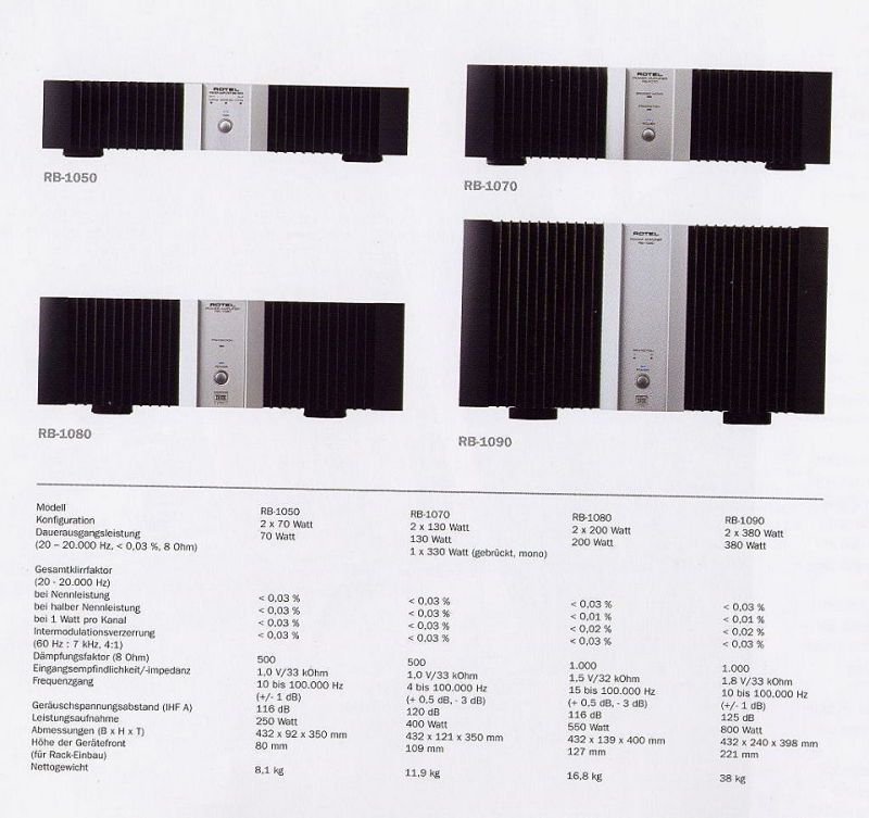

                                                      I don´t assume that Rotel will update their manuals, websites or brochures too soon Just have a look at the latest Rotel brochure available here in Germany. Both the 1095 and the 1090 are (still) accounted as "800 watts power consumption" amps. Hmm, concerning the 1090 this could be true as it is "only" a two-channel amp, or what do you think? However, we all know that the 1090 can deliver more than 1000 watts/ch at a 1 ohm load and it is also equipped with two 1,2VA transformers which can be compared to those used in the 1095. Thus, in my view I strongly believe that both amps are without doubt able to deliver at least the wattage they are accounted for (actually more than that). Many review magazines throughout the world confirm this. In the end, I would consider the "max power consumtion" to be of secondary importance - and Rotel certainly did not put two 1,2VA transformers into the amps just for fun :T Another example: A German review magazine recenty tested my 1075 and measured 5x 255 watts @ 4 ohm load. Having in mind that the 1075 has a 1,5VA transformer this sounds plausible to me (although "800 watts power consumption" is labeled on the back of the amp).
                                                      PS: Does anybody know why the 1095 is much heavier than the 1090? Does the 1090 also have a power consumption of 800 watts or 1200 watts?
                                                      • DrBoom
                                                        • Dec 2003
                                                        • 325
                                                        The RMB1095 is built around 2x 1.2 KVA transformers, the RB1090 has slightly larger 2x 1.25 KVA transformers according to the Rotel site.
                                                        Power consumption at idle (amp on, no music playing) is 190W for the RMB1095 and 120W for the RB1090 which seems logical since the latter only has 2 channels.
                                                        Maximum power consumption should be around 2400W for both, but that would be really pushing everything it's got into a very very heavy load all channels driven at the same time.
                                                        Which is not a very likely situation
                                                        I think if you manage to draw 500W at any time you're pushing it quite good already
                                                        If you assume the 120W idle for the 1090, and let's say the amp is about 60% efficient which is a very plausible number for a class AB amp, if you were to pull 500W from the mains that would mean you were running 114W into each of its 2 channels.
                                                        500W - 120W idle power (transistor bias current etc.), leaves 380W but it's only 60% efficient so it's putting out 228W at the outputs, divided by 2 gives 114W.
                                                        I'm not saying this is how it is, but that's the theory
                                                        So I wouldn't worry about whether it draws 800 or 1200W, because chances are you'll never even get close to those numbers.

                                                            I got the response back today. The power consumption figure that is stated on the back panel and in the owners manual is an "average" power consumption. It is not stated as the max power consumption due to the fact that there should not be a scenario where you are actually driving all 5 channels at full power. The power consumption varies with output power, so the test is carried out at a lower figure using "pink noise" to get an average.

                                                              It did answer my questions. The manuals and the back of the amp list the correct Power Consumption based on average power consumption not maximum power consumption.
                                                              The only discrepancy left to correct is the specification on the web site which reads 1200 Watts vice 800 Watts. Rotel also indicated that they were going to update the specification sheet on the web site.
                                                              I am satisfied with Rotels response and as far as I'm concerned I consider the case closed.
