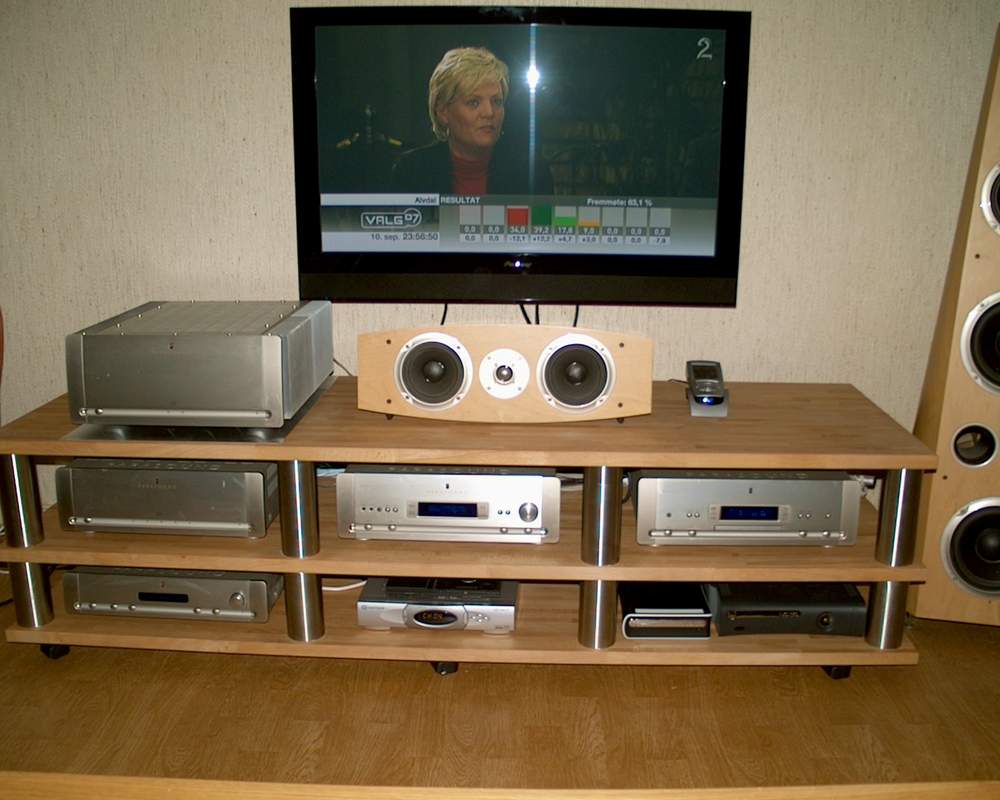

                              And I would allso like to thank Jesse and Peter (again) my JC1's are now on the way over the pond wired for 230v :T
                              I will also have a Zcustom ZHD soon so I guess my setup is near complete 8O
                              Here are the components :
                              Parasound :C2,D3,T3,A21,A52(JC1,ZHD),JBL: Ti10k,Ti6k,Ti2k,Tik Center,2 x Tik Subs,Nevo SL,Pioneer PDP 428xd (soon to be LX508d) and a Infocus 7210 (trying to find a good 1080p unit) Cables are mostly Kimber with the Trifocal XL on top.
                              Sorry for the bad picture of my rack, the JC1's will be on each side on the top shelf and the A21 in the middle,I do not know where I will put the center speaker yet ops:
                              And thanks to all for the good help on this forum.

                                Sweet... your pics bigger, now:
                                • Aubi
                                  • 34
                                  I'm a bit confused now. It's mine amps that is on their way over the pond at the moment. h:
                                  Besides that, does anyone know who the woman in the picture is. It's red Kristin. The norwegian minister of finances. 8O
