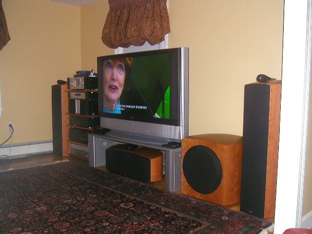

                                      Here is a real quickie photo of new setup. I hope this works.
                                      Stan
                                      Stan
                                      • watchthewaves
                                        • 43
                                        System setup
                                        Hi gostan,
                                        Am new here, having been following things on this forum for a couple of weeks only. If you don't mind me chipping in, after having seen a pic of your setup, there might be some things you wanna try:
                                        First off, get your N804s out of the corners, or at least away from the side walls (try your speakers away from the side walls, with the distance to side wall different from the distance to the front walls behind the speakers). You could do this by moving your equipment rack to the side wall, thus giving you more space up front. Simpler would be just to swop places with the equipment rack and sub, but may not get as significant an improvement.
                                        Also, might want to try tilting your centre speakers upwards so that the speakers are firing at you in your listening position.
                                        Are your speakers on spikes? If not, might also want to try that too.
                                        I think you might find a difference when your speakers have more space to breathe.
                                        • gostan
                                          • May 2003
                                          • 445
                                          SimonS
                                          It is my intention to modify this initial setup. The centerchannel speaker would not fit on the bottom shelf of my Sony monitor stand, so I had to remove the bottom shelf to fit the HTM1 in. I am either going to construct some type of lift-tilt-up device to fit under the HTM-1, of locate a new stand that will better fit the larger center. My wife would prefer that I make a modification to tilt the center, rather than a new stand - as this last upgrade was significant $$wise. Without the bottom shelf, I still only have about two inches total to play with
                                          As for getting the speakers away from the corners is concerned: my only choice in this room is to move the equipment rack to the side wall and flip the sub to where the equipment rack was and move all down to the right with the speakers relocating out of the corners a little. I will require some longer interconnects to the monitor(and possibly speaker cables) to accomplish this. My speakers are on the floor and not the carper, so I do not see what spikes would
                                          I expect to be in a larger listening room within a year and I only wanted to do this upgrade once.
                                          Great to see your comments. I am sure that as the speakers break in that I will become very motivated to make whatever minimal changes I am able to make in this limited room.
                                          Stan
                                          Stan

                                                              I still can't believe its size. The pics I have seen always made me believe that it was some monster, and it is actually very similar in size to the as-6. I just wish the grill wasnt a circle. would be easier to hide from my fiance. heheh.
                                                              guess this is the end of my system upgrade for the next five years. It's good to know that speaker-wise, all I will have to replace are my surrounds for quite possibly the rest of my life. now receiver, dvd player and tv are a different story.
                                                              will report back once I've watched a movie or two. Is there any break-in for a sub like there is other speakers? If so, any idea how long on this beast?

                                                                  Uma looked bloody a good part of the movie.. and maybe im too critical, but that nose... anyways, kill bill vol. 2 lived up to the excellent audio of the first one. The bass was very subtle.
                                                                  I recorded star wars 2 off hbo (hd) the other night and started to watch it for some real bass in the opening scenes. Im afraid I won't be able to watch this movie. There is just too much bass, however, very clean, and low. I will be evicted.
                                                                  This sub blends in nicely with the speakers. it can be absolutely subtle, to a room shaking monster. Now i NEED a house to enjoy it. too bad i spent all the money, and then some i had for a down payment... on the bright side, when I do get the house, won't need to be purchasing a system for it. definately not a good sub for an apt, but then again, is any?
                                                                  • sikoniko
                                                                    • 2299
                                                                    I am wondering if my posts have come across overy negative towards this sub. It is definately an amazing sub, and there is a tremendous difference from my previous sub to this one and my home theater viewing will have a dramatic difference in the low end regions. My hesitency to purchase this, was never that I didn't trust you guys. I asked for your opinions, and I appreciate it. I was very uncertain how much of a difference a good sub would make.
                                                                    This sub definately needs a lot of room to breathe, so while it is not ideal for my current living situation, it will definately grow in value as my living conditions grow, and its value will only increase over time.
                                                                    Thanks for the advice. If you are ever in the jacksonville, florida area, come by for a movie. heh.

                                                                      Sikoniko,
                                                                      Double check your calibration levels...
                                                                      Then try some music - sub = ON and Sub = Off (a quick toggle with the processor). I bet you will find that even at moderate (appartment friendly ) levels it is surprising the extra depth the 805 adds to the musical sound stage....
                                                                      Also walk around the room while playing a bass heavy track - if the bass changes significantly in volume you should consider moving the sub or altering the processor sub distance setting or (last resort) the phase on the sub. When properly se-up the sub should be seamless at any volume and not be "too much" for the room - just able to play (if needed) way louder than is sensible for the room...
                                                                      If you have trouble getting the calibration just right - Your dealer can help here if needed....
