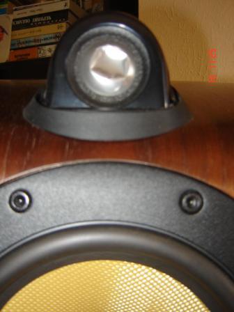

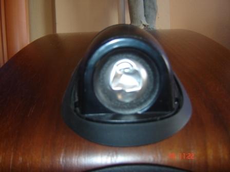

    What was happen with my 704
    Here is what was happen with my tweeter dome.
    Is it something very seriosly and can I fix it?
  • george_k
    • Jan 2004
    • 342
    Looks like somebody stuck a finger in it :-)
    Is only one speaker affected or both?
    Off hand, I believe a replacement tweeter costs around $75-100 (saw a post on here somewhere a while back ago)

      +1 for a finger.
      Don't you use the protection grid?????
      Tweeter is very easy to change on 70x series.

        While waiting for replacement you might be able to pop it back out using some scotch tape to grab onto the dent and pull out or use a vacuum to suck out the dent. 8O
          Vaccum, don't use tape.
          If you take the vacuum hose with no attachments and get it CLOSE to the tweeter, the negative air pressure will cause the dome to come back out into place. You do not and should never put the vacuum directly on the tweeter, but just keep getting it closer and closer until it pops back into place. Sometimes this works, others it doesn't, it also depends on how long ago it happened, after a while they will not want to go back to their original domed shape.
          Good luck!

            Someone (look for the nearest child) gave it the finger. Obviously it was poked more than once since its a complex of dimples rather than one. Unfortunately, that type of damage cannot be fixed. If it were a simngle superficial indentation you try to pop it out with suction, but from the looks of it your dome is doomed :cry: (pun intended). You may be surprised that sound is little affected (to the ear). However, if it is, our you just can't live with the way it looks the tweeter will have to be replaced. I feel your pain.

                You should be able to replace just the diaphragm. There is no need to replace the whole tweeter and it's much less expensive. Call your dealer and they can get just the diaphragm.

                  This is correct but I'm wondering if BW will be willing just to fix it rather than just replace it since replacement is so much simpler.
                  Rado, please let us know how BW handles such occurences.

                      Both speakers are affected.
                      O-h-h-h, these litle children fingers!

                        Wonder if I can replace just the diaphragm, otherwise can I replace whole tweeter myself, or have to take the speakers to my dealer?
                        • Iggurk
                          • 114
                          As I already told you, it's really easy to change the tweeter, just 4 screws and two cables to plug. less than 5min of work.
