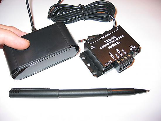

                      Well, I purchased and installed the Xantech Hidden Link system this week. After searching around and finding a local distributer in Canada it became apparent that the price online in the States was far better (by more than half), so I ordered it online from a place in Virginia called www.enhancedht.com....
                      They have a pretty good site and the price was $79.95 for the system kit which included the receiver, connecting block, power supply and four (blink type) single IR emitters. In the end I decided I wanted to control six pieces of equipment so I purchased two extra double blink type IR emitters to make up the six required. I'll use the two single emitters (that I don't use) as spares.
                      The control block I purchased allows for a total of four double emitters which allows you to control eight pieces of equipment in total. The 2 extra double emitters were $11.95 each, so with another $11.95 for air shipping, the total cost was US$115.35. It came in 8 days to my door from the time of clicking the purchase. No doubt customs will eventually send me a bill for the tax. My Canadian Visa bill shows $150.37
                      http://www.enhancedht.com/Merchant2/merchant.mv?Screen=CTGY&Store_Code=EHT&Category_Co de=IR

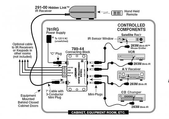

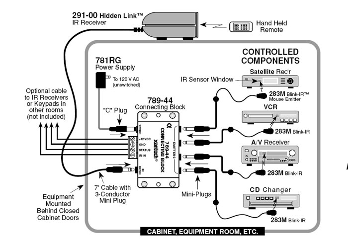

                      Here's a diagram of the hookup.
                      Click image for larger version  Name:	1-XANTECH.jpg Views:	3464 Size:	65.9 KB ID:	841053

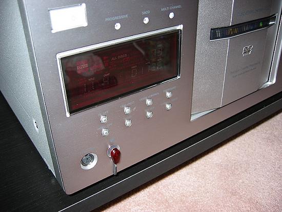

                      It's very easy to install. I put the small black tabletop IR receiver on top of my RPTV, so it is very easy from any position to hit the receiver with my Pronto. No more pointing at the equipment. In fact it has an off axis spec of 45 degrees, but I find it so sensitive, there is just no way it misses any hits from my Pronto remote unless I put a put a cloth over it. I can lie on the couch and press the Pronto screen in front of me and the system gets every command. No mirrors on the ceiling, no posters on the wall for reflections. You could hide your equipment behind doors or put it in another room and the system will take care of it too.
                      A single wire is connected from the IR receiver (fed around behind my RPTV) to the connecting block that I mounted behind my equipment rack. The power supply plugs into the connecting block.
                      Then I ran the four IR emitter wires to the pieces of equipment from the connecting block and stuck the self stick tiny black emitters over the IR receivers of each piece of equipment (mine were easy to find). The emitters are also IR transparent, so you can also still receive infrared hits from your remote and from the Xantech system at the same time. You're not likely to miss a command with this system in place. These emitters are the blink type so they also blink a visible red light each time they are activated (as does the IR receiver itself). You can purchase the non blink type, but it's a really nice light show when all six of these things blink every time you use your remote - very weird.
                      Actually, on one piece of equipment (my pip tv monitor), I had some difficulty finding the IR receiver. An easy trick is to just hook up one IR emitter to the connecting block and with the receiver and your remote hidden under a cloth, move the single emitter around on the front panel of the offending equipment until you find the best spot for reception. Seemed to work.

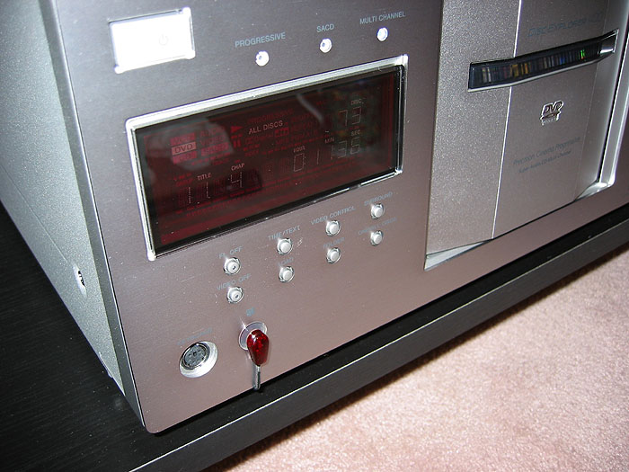

                      The emitters aren't too ugly and the wires are easily hidden from view.

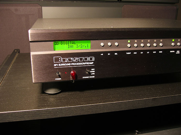

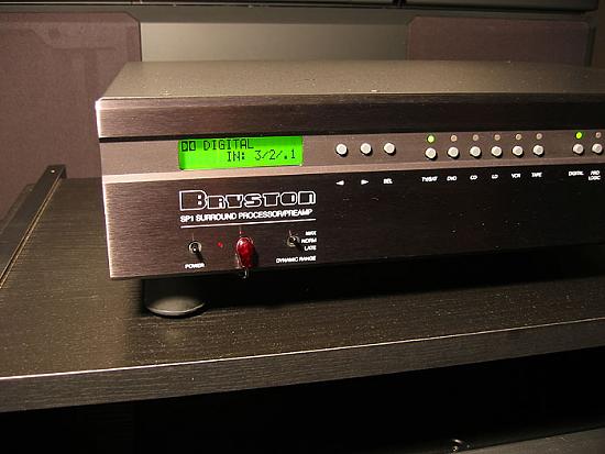

                      Here's a picture of my processor and SACD player with the IR emitters in place....

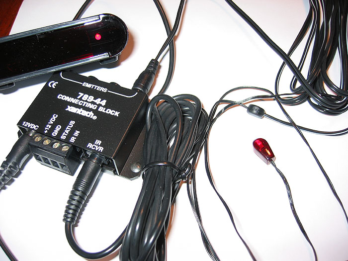

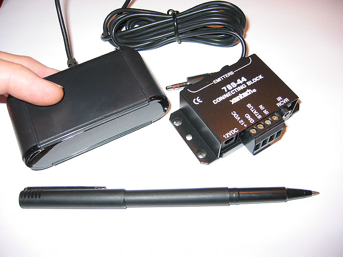

                      Here's a picture of the IR Receiver and the connecting block:

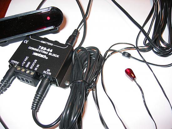

                      Here's a picture of the system hooked up with power supply and a single IR emitter. See how the heavy wire changes to a very teeny wire as it goes to the emitter. This small wire is slightly stiff and helps in the hiding.
                      Note I was firing my remote at the IR receiver and the receiver and emitter telltales are lit up.
                      Anyway, if you have any obstructed views, hidden equipment or just don't like having to point your remote directly at your equipment, this is a pretty good solution and a fun toy too..... :W

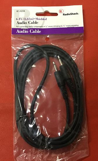

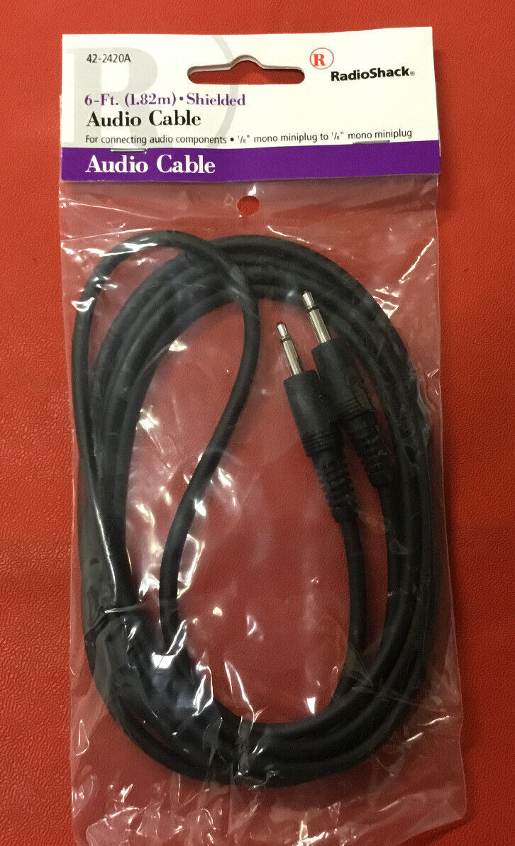

                                                Anyways, when I order the Hidden Link, what do I have to ask in order to make sure I get one (that is all I need for now) cable to go direct to the Nad Receiver IR plug ?
                                                windwaves,
                                                You may as well just order the kit.
                                                And then get the hard wire cable from Radio Shack.
                                                Any cable with mono male 1/8" (3.5mm) phone plugs on the ends will do. Here's one at Radio Shack.

                                                http://www.radioshack.com/product.asp?catalog%5Fname=CTLG&category%5Fname=CT LG%5F007%5F002%5F003%5F007&product%5Fid=42%2D2420

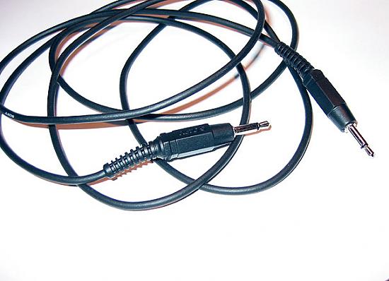

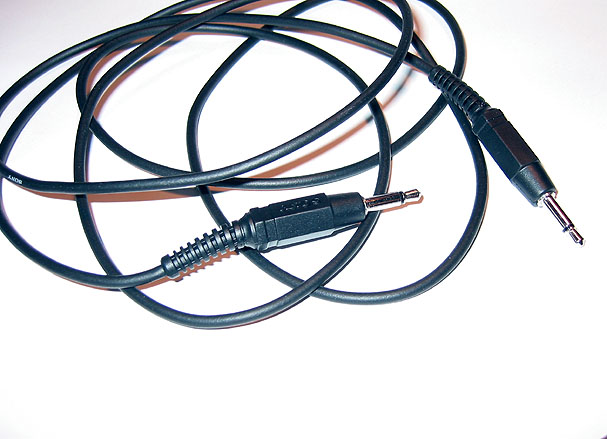

                                                Actually, most Sony equipment will come with one of these cables, so you might have one lying around. Sony includes it for their S-Link connections. Here's a picture.
                                                I used the above cable to connect from my Xantech system to the IR input jack of my processor. Originally, I used the blink emitter on my processor, since I wasn't sure whether the IR jack would be compatible.
                                                My Bryston processor manual was like yours in its rather sketchy details on this plug. I tend to think the lack of detail is simply because this is somewhat of a standard and all IR input jacks are the same.
                                                Last week I found a phone plug cable in my junk (picture above) and hooked it to my processor directly and it works fine - so I removed the mouse emitter. Still use emitters on my SACD, CD, TV1, TV2, DSS.........
                                                The next thing I would like to find out is whether I can connect the Xantech system directly to my Sony 777ES S-Link input. Has anyone tried this? I have no doubt that the S-Link input is standard IR, but I'm concerned about the bi-directional capability of this protocol. They use a Control-S, Control-A1 and Control-L protocol on this interface. I feel the input commands will work fine and the output commands should simply be ignored by the Xantech receiver and connected equipment, but I have to look into it some more before I simply 'plug it in'. I'm comfortable enough using the blink emitter on the Sony anyway - it's reliable and I like the light show it provides..... :E
