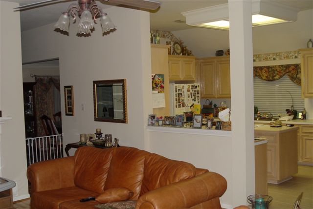

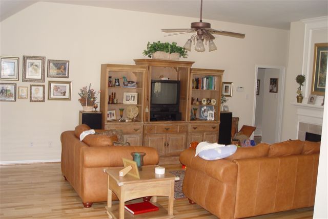

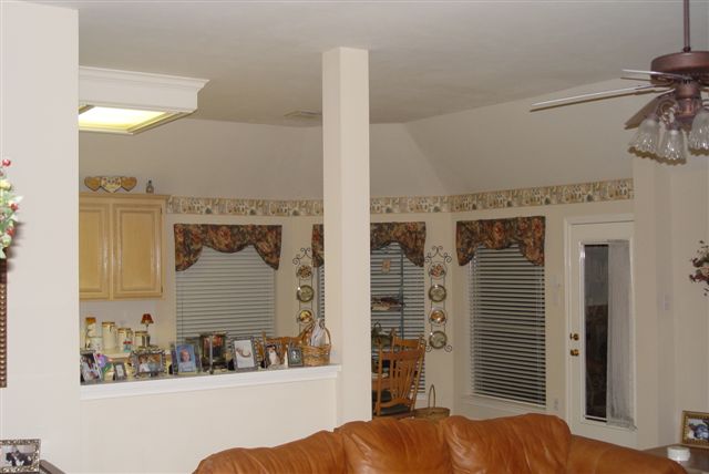

                      • Brian Barnes
                        • 47
                        number17
                        I have another question for you. I know you have recently dealt with rear speaker placement. I also have some constraints. I am attaching a few pictures of my living room. You will notice that the back of the room is open to the kitchen/breakfast area. There is a colum in the middle and then there is a wall 10' to the left and a corner wall apprx 14' to the right. If I place the rears on the center wall and the left wall, the speakers will be directly behind the edge of my sofa. Not sure if this closeness will be a problem. If I place one speaker in the corner position and the other to the back left wall location one rear would be at the edge of the sofa, unless I moved it out further, and the corner speaker would be a good 14' outsided the sofa.
                        Confused? I am!
                        Please advise how you would place the rear speakers.
                        Brian
                                        I think your layout is a lot better than mine for speaker placement.
                                        I wouldn't worry about placing the surround speakers on speaker stands directly behind your sofa. You can compensate for that with the adjustment on your receiver. My father-in-law has the same setup and I didn't notice any problem. Your surround speakers also won't get in the way of heavy traffic area and they won't even be obstructing the view from the kitchen (because there's a column / half-wall there anyways).
                                        I'd say try that, and if you don't like how that sounds then I'd say another placement you can try is to hang them from the ceiling ... but running of speaker wires could be a pain. It most likely will also have a lower WAF.
